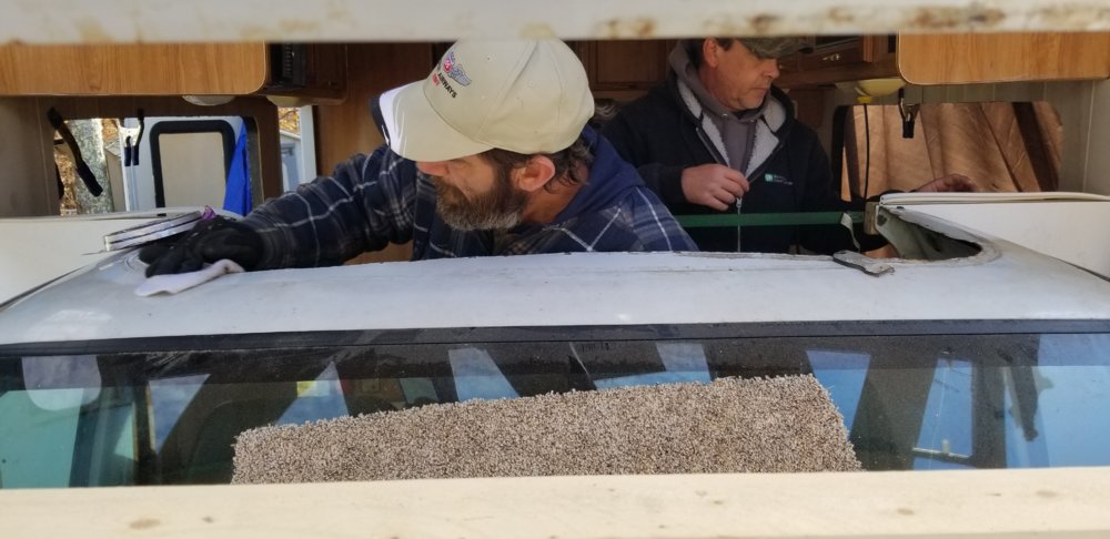

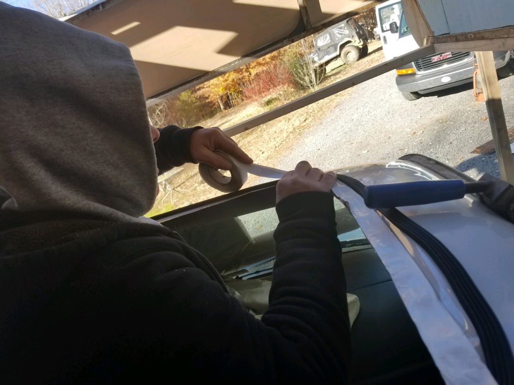

Ok..lets get the van roof cleaned and prepped with butyl tape and rubber seal.

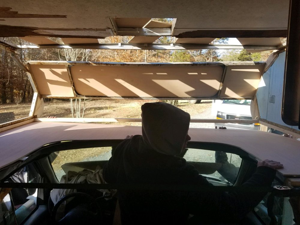

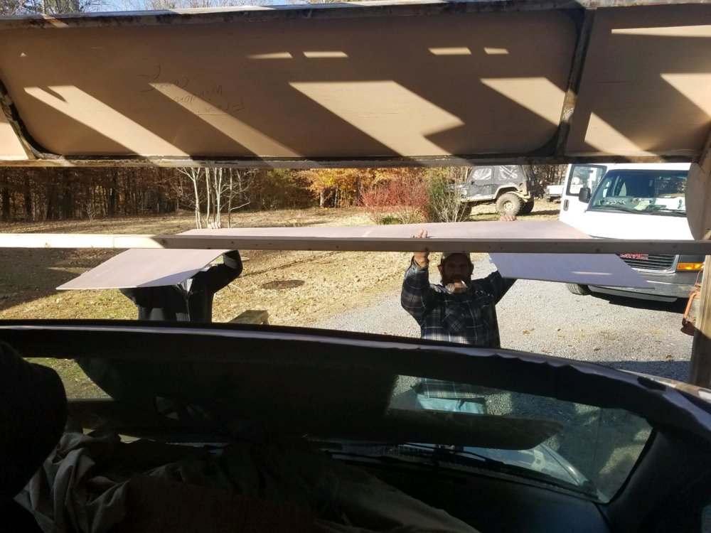

Ok, I think we're ready. Let's bring in that big boy panel we built a while back. Let's see what we got guys

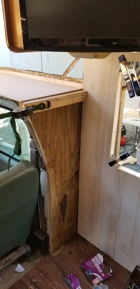

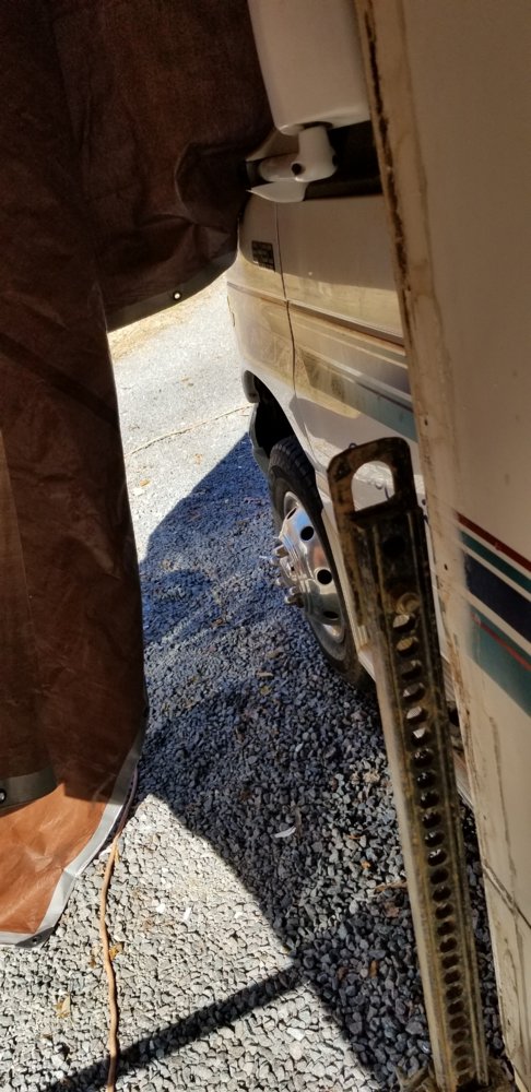

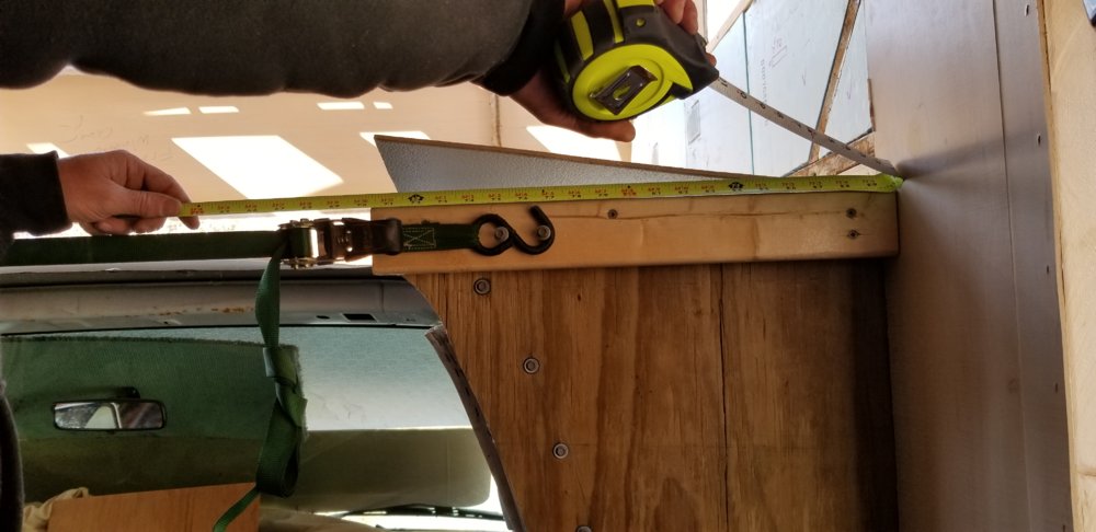

man...we gotta get this more sqarederrr than this! Its damn near a half inch off!

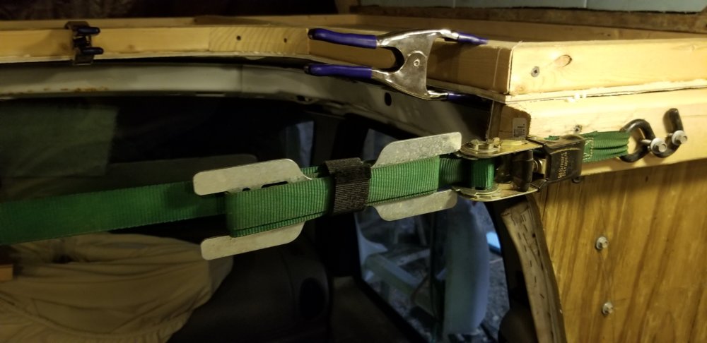

Let's screw a 2x4 to this part..grab a ratchet strap and a few more screws and let's pull this piece of shiaat back together!
Dont laugh..it worked petfectly. Once we got the floor jack on one side, and the high lift on the other we were able to square it up and add the cab screws. Pretty sure they dont do it this way at the factory..

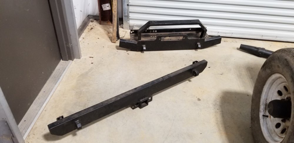

@trailhugger @Creekin We've been working on it in some fashion or another, every single day since we bought it. At least 2 hours after work on some days many more on others . Bobby is my full time employee and a great friend.Bobby is on the books for many partial days and 6 full days here and there when we have a full day off. Kieth probably has over 20 hours in, just helping when he's off work and able to ride over. I probably owe him a little more than the winch at this point..although I did snag some ok bumpers from @WARRIORWELDING for him. Nothing fancy but better than he had.
Thanks again!@WARRIORWELDING for helping me help a buddy out.

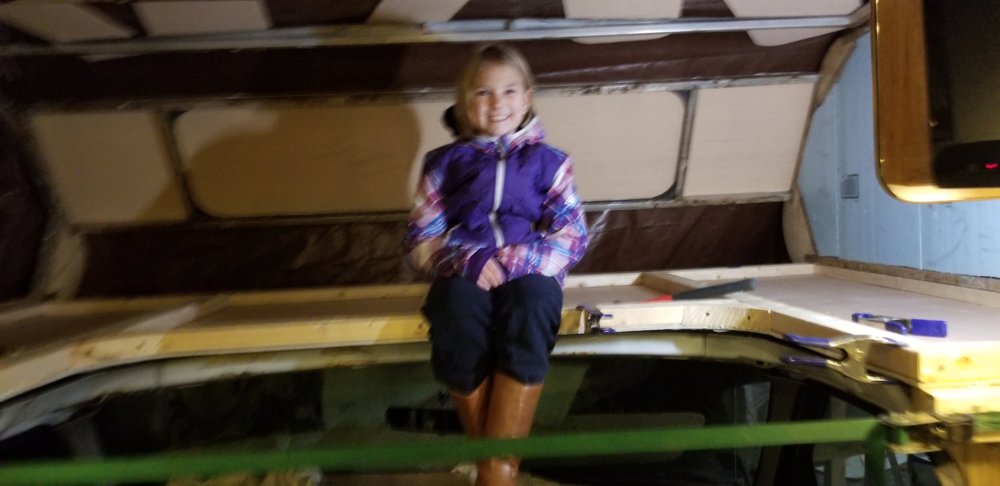

Now that we have the framework squared up ish..the big panel aka Ella's bedroom floor, is ready to be installed. This will help tie in the front and both side walls.
Everything has to be tight and right. With the installation of this panel, along with the 2 side panels, we are sealing it all up. With Butyl tape and rubber seals in the middle, this panel will be sandwiched between the van roof and a 2x4 frame that will be built on top.

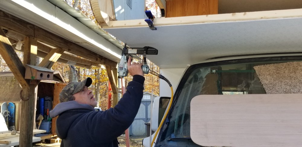

Time to staple the edges! It's gonna be stuck now.

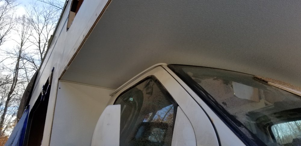

Looks like the plan is working out. Looking good on the outside.

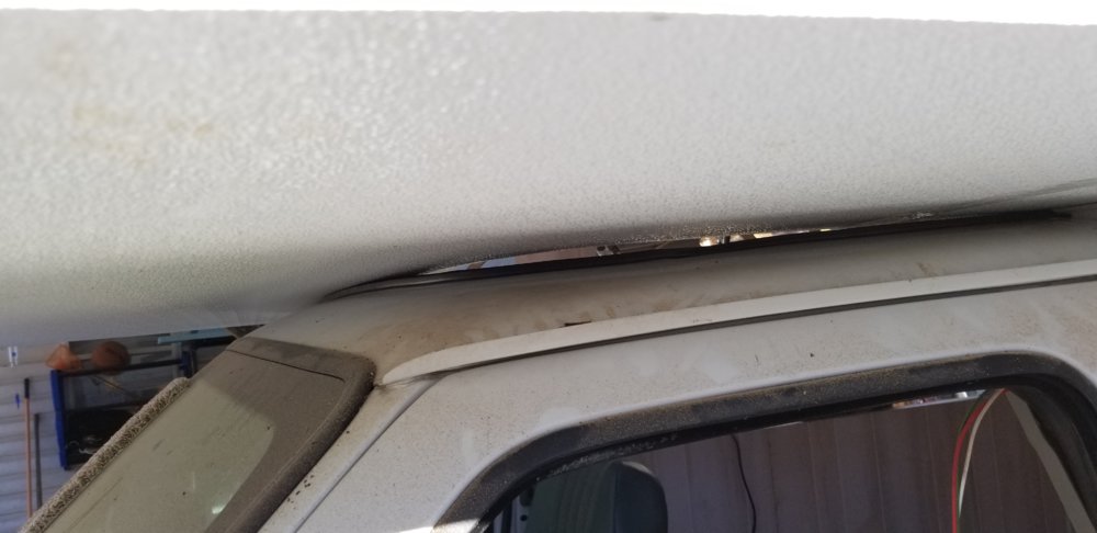

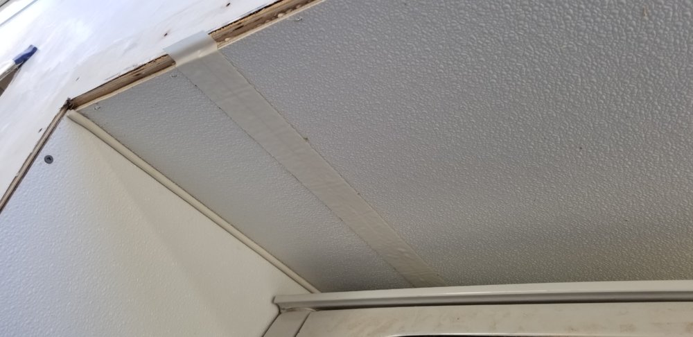

Theres one thing I'm not super happy about. Theres a seam that I couldn't avoid, just above the van doors. This panel is just a little bit too big to be seamless. I have to figure a good way to keep water out of this seam.

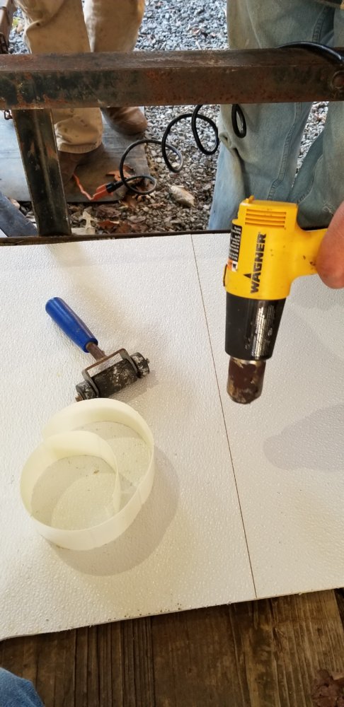

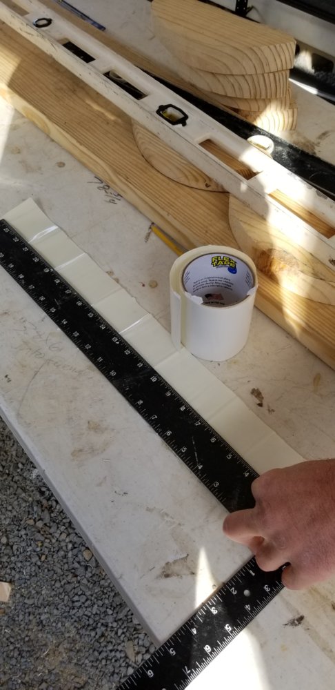

Can you believe I chose to use... FLEX TAPE?
Every thing about this stuff seems like it'll work. It might be a bit unsightly, but overall not horrible.
Flex tape is 12.oo and change for get this... 5 ft. That's all you get..5 inches wide, and 5 ft long! I'll need to split this in half!
Not sure if it helped or not, but it's cold outside so I figured adding a little heat to the frp wouldn't hurt. My little vinyl seam roller helped mash the flex tape into the panel.
Flex tape is nearly an eighth inch think. You can just tell its gonna a work perfectly for this seam. We'll have to see how it does in the long run.
Finished seam is top picture in this post. It looks a little ghetto, but it shouldn't leak. I'll keep an eye out for ways to make it look a little better.

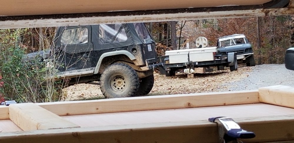

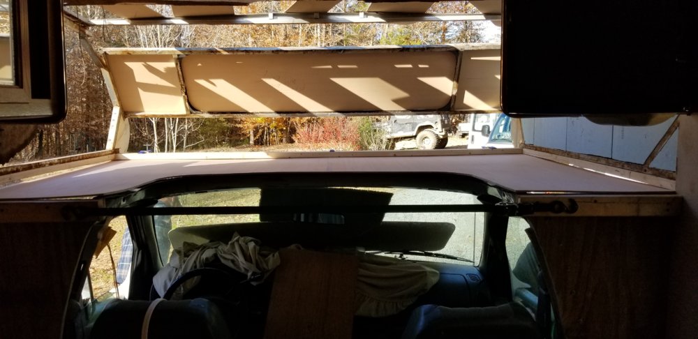

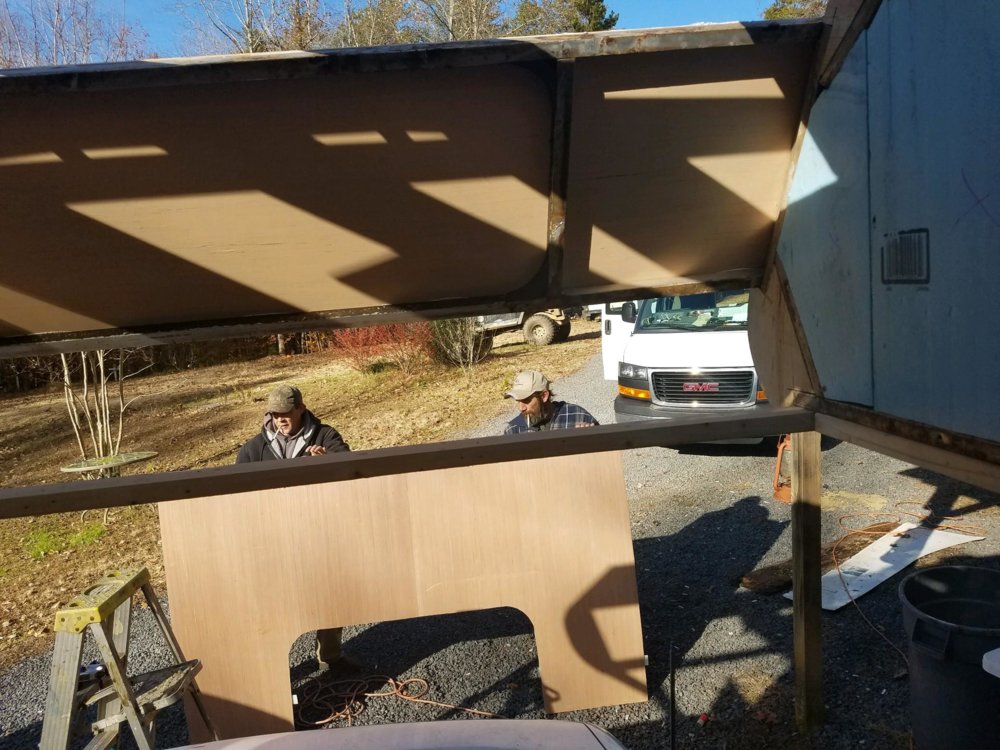

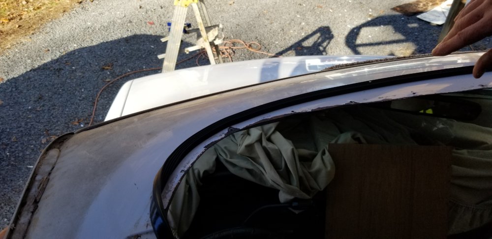

After the big panel was in place, this is how the van roof and panel looked. The camera is at a weird angle, so I could capture the daylight between the two pcs. I'll have to build the framework on topside before we'll see it tied together.

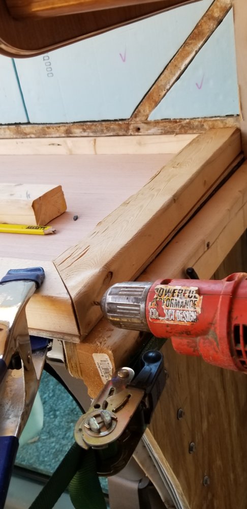

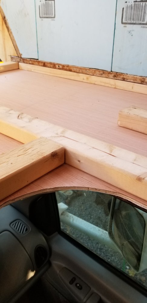

Starting to layout the framework. This panel will be built just like the walls were. Which means layers and even more glue!

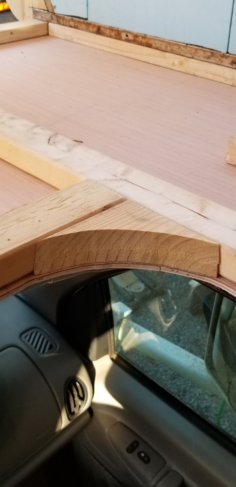

Hmmm..round corners out of 2x4s? Gotta figure this out.
Made a pattern and cut this little pc out. Yes, I think that'll work.

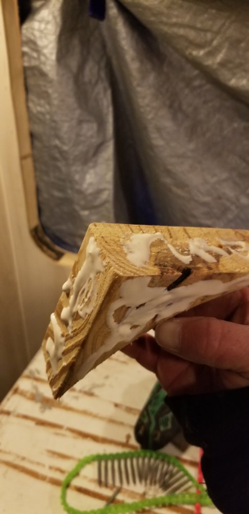

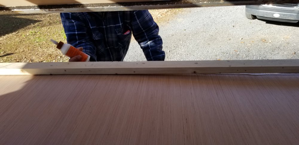

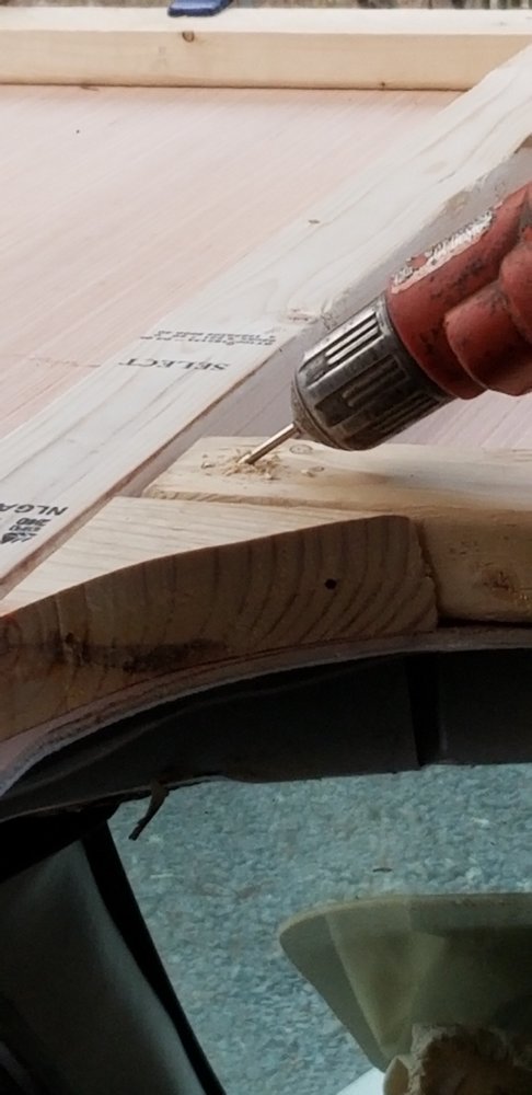

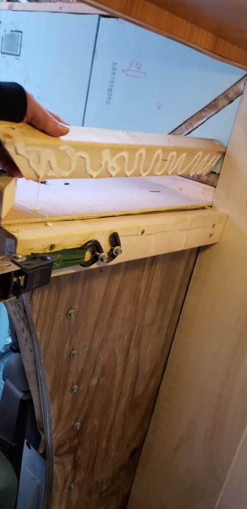

And once again it's time to glue it and screw it. Definitely want to pre drill holes in this stuff. Keep it from splitting when screws are added. Oh well....what's a little more work, right?

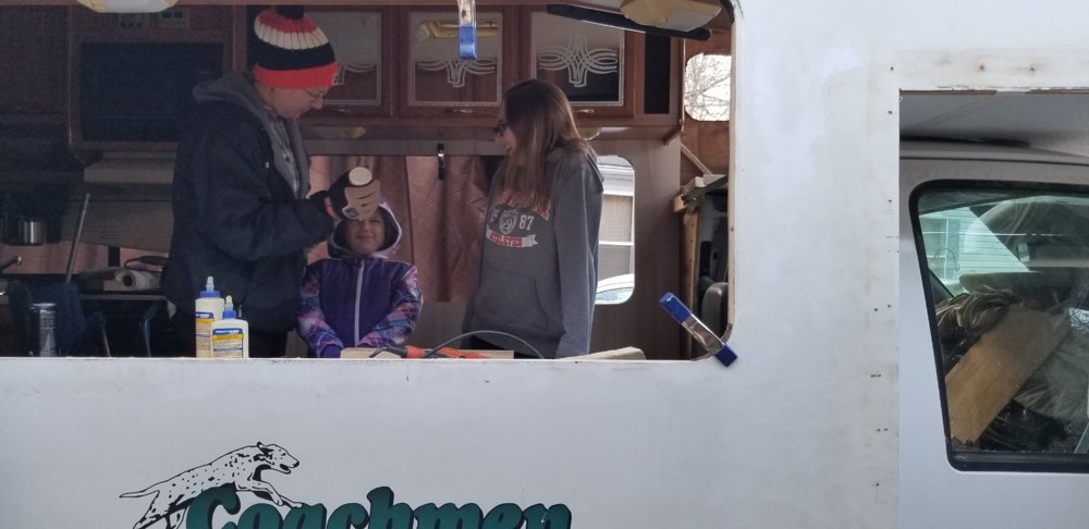

Suddenly theres a problem! Ella says the glue has become too cold to squeeze out. They think it"s quitting time.
Brooke says it'll take hours to get the glue warm again. Let's take it inside the house and try again tomorrow..she says.
Wrong answer babe! Dont worry, I got this!
Worked like a charm. :cool:
