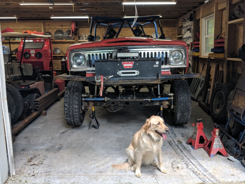

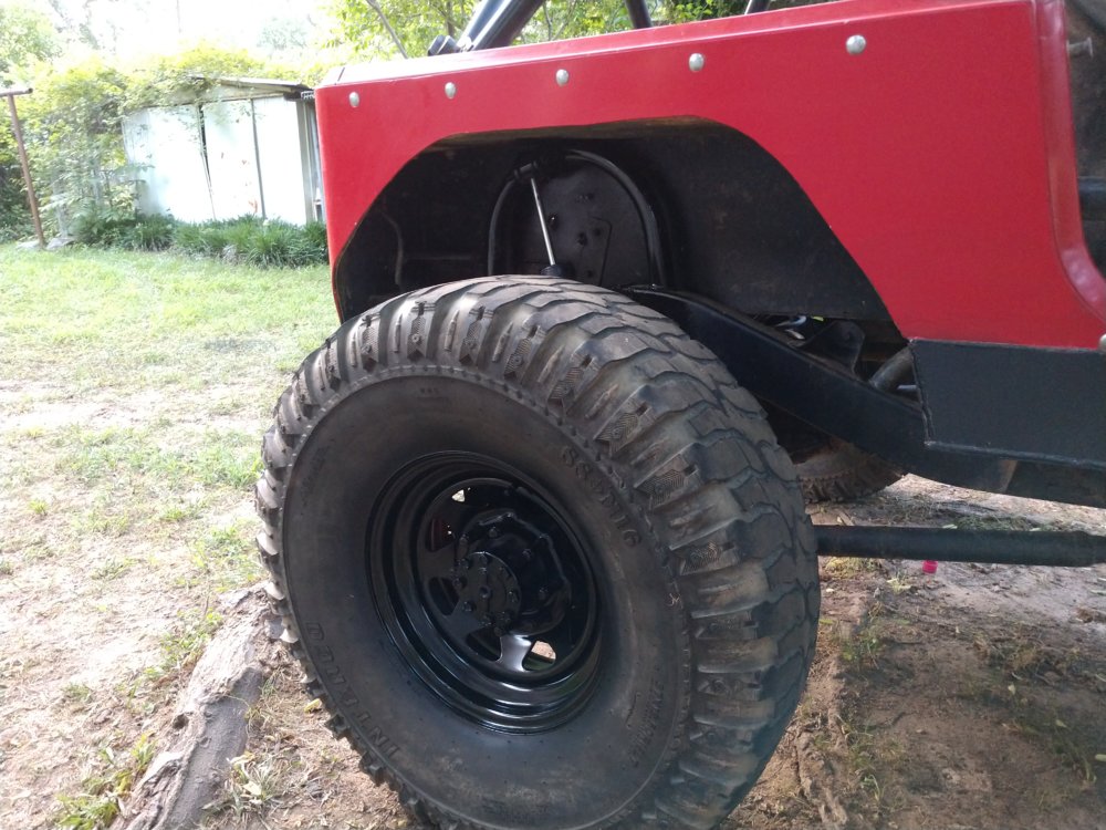

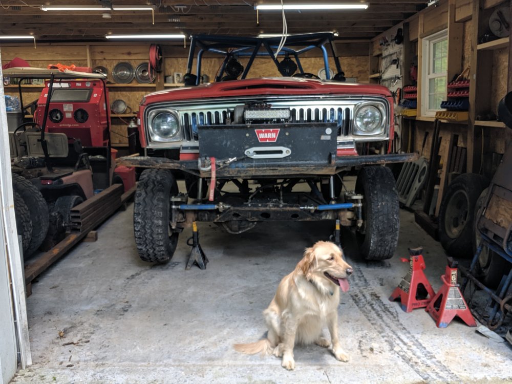

Ordered quite a few parts today to help fill this hole I created this weekend.
I changed the tires over to my super secret pizza cutting stickies. Then squeezed it's fat ass into the shop. Let the tear down begin!
I'm full circle at this point. Back in the day you built your truck/Jeep/whatever. I've seen the rail buggies turn into tube chassis turn into ultra light purpose built rigs. Now the old iron has the retro appeal. Tube chassis design is worlds better than it was but I think they're stale. Have I thought about it? Absolutely. Am I? Probably not. The frame is hanging in there but I can tell it's tired. I'll redo it again and go from there. I'm not sure it's worth going that far at this point. It used to hate my guts and now I think it's mildly fond of our shenanigans together. We're both just hanging in there to see what happens next.Have you ever thought about putting your rig on a serious Detroit steel diet, and just doing tube on the frame with aluminum floor, firewall, and sides? You might be able to lose 500 lbs. That old truck sheet metal is thick and heavy.

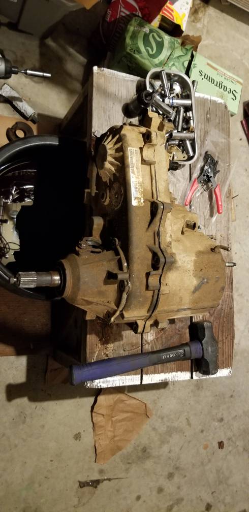

Started tearing down a 231 that's I'm gonna swap an sye from another case on too. Ive gotten the main split to open up but I can not get the tail cone to split. Yes I have all of the bolts out. Any tips? I'm afraid if I wail on it to much I might crack it.![]()

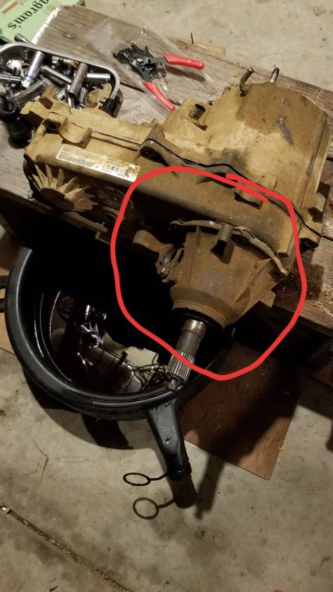

I didn't think there was any snap rings to remove before the tail housing will come off but I'll double check. I know there are some before I can take the back half off before the pump. I dont even know if tail housing is the right term. So I circled itDid you get both snap rings off the output shaft? They are both inside the housing, and the housing wont come off without taking both off.
Ask me what happens when you try to pry the output housing off with one of the snap rings still on the shaft........ ...
I didn't think there was any snap rings to remove before the tail housing will come off but I'll double check. I know there are some before I can take the back half off before the pump. I dont even know if tail housing is the right term. So I circled it![]()
Thank you so much I didn't know those were there.Check out this video, its in the first 2 minutes...
