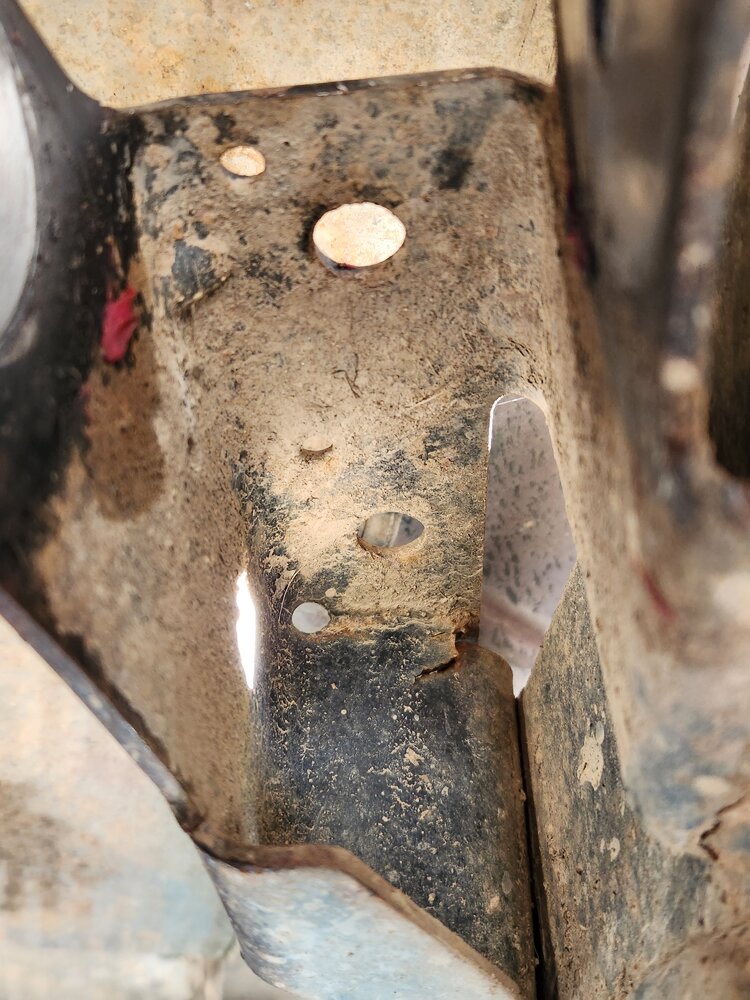

I see we were both taught sheetmetal attentiveness by the same instructor

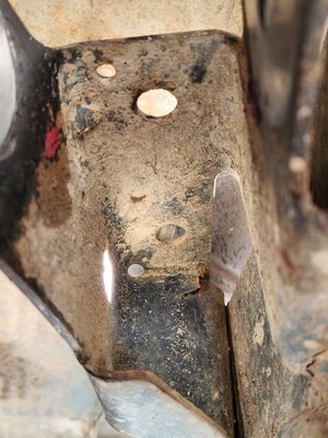

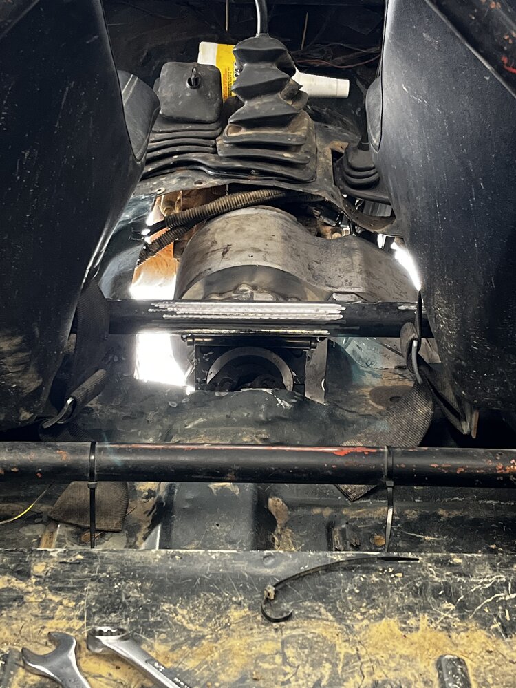

Yet another mod done BC. Before Chris. The DOT will help me with the new trans tunnel. And they replace sheets of metal all the time.

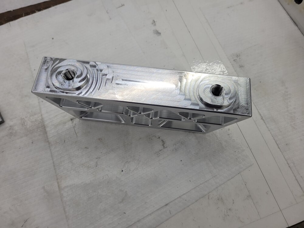

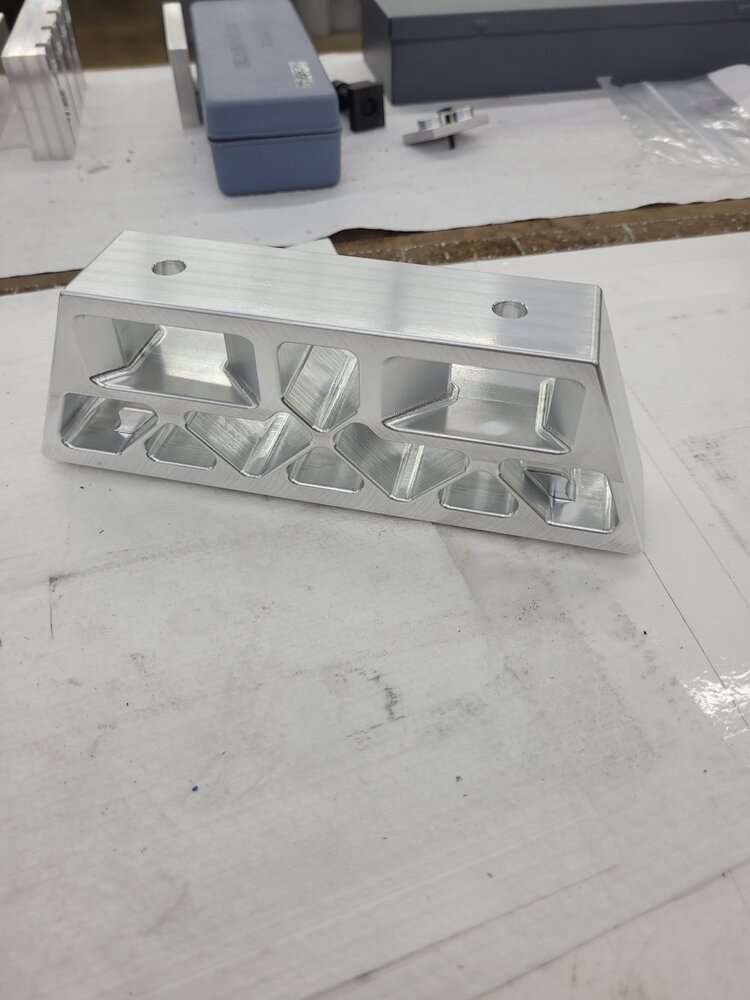

What shift kit is that for the atlas
The universal kit. It fits pretty well with a 2” standoff from the case. I have left all the threaded rod uncut for now in the chance I change some things up after the first ride. Reach, throw etc

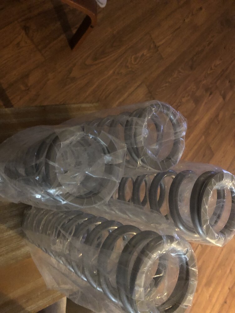

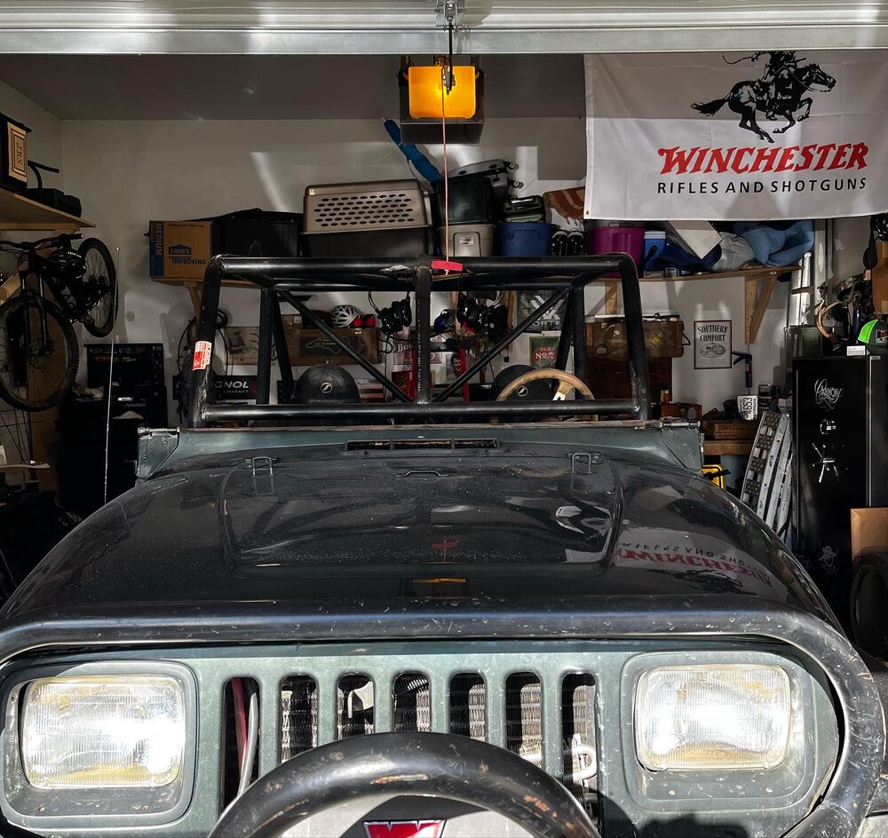

Accessorized and added some spring to my step

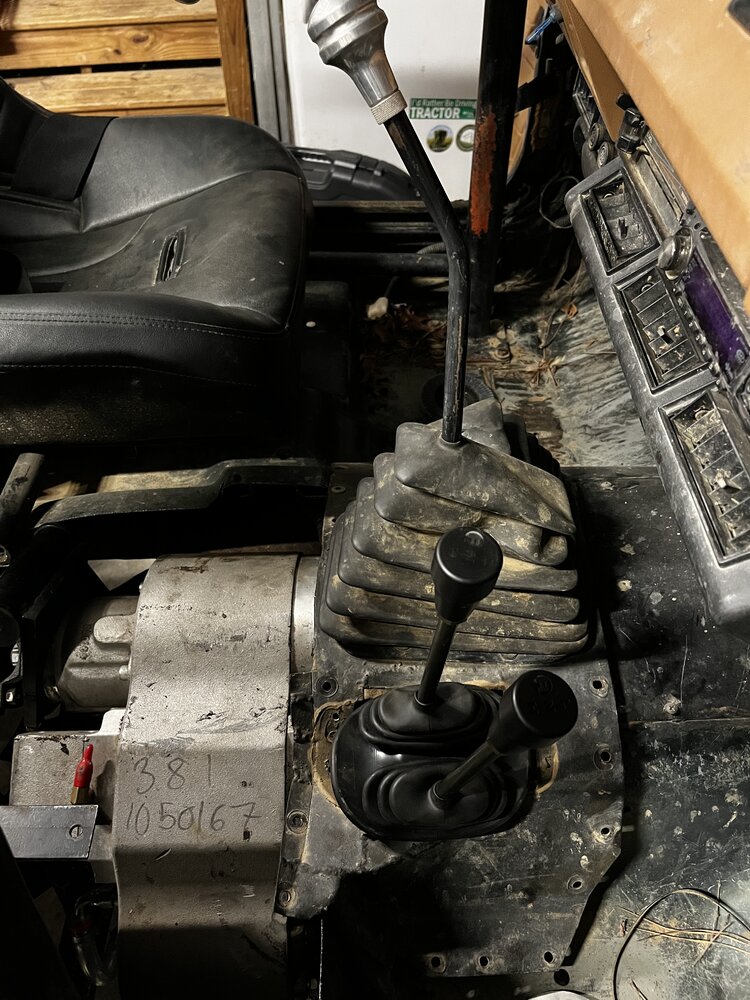

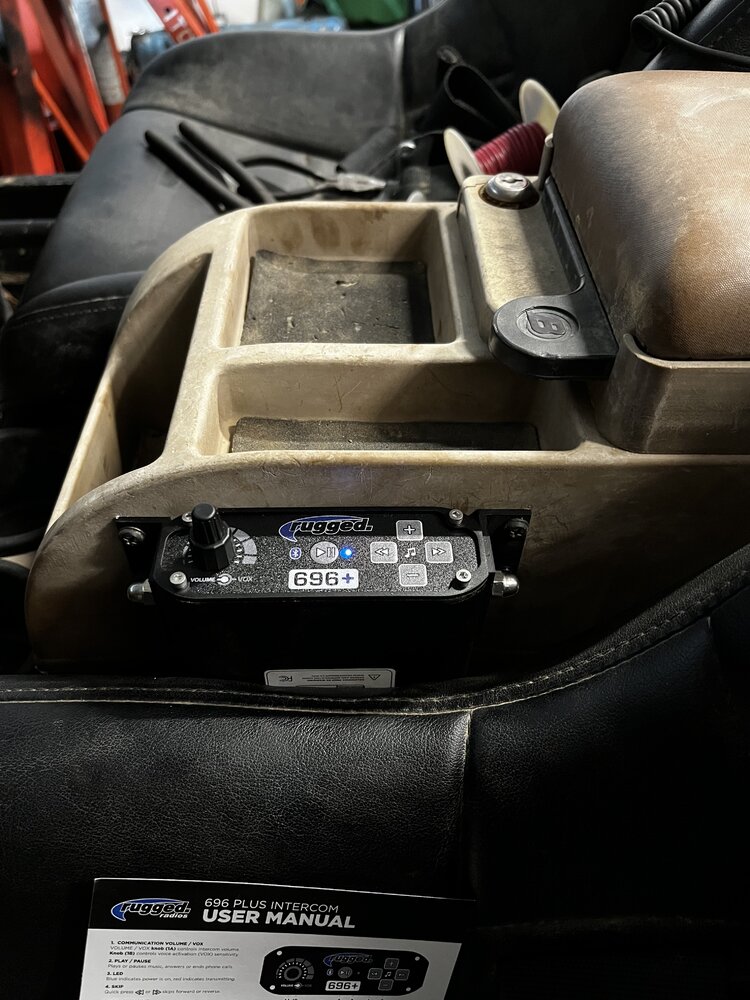

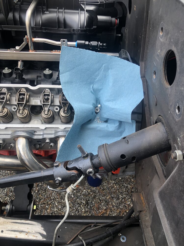

Finished up getting the tcase mounted. Trimmed the Barnes belly pan to clear the rear link crossmember and the front driveshaft. Threw the belly pan on and it promptly filled with gear oil out of the front output seal when I filled the case…I’m a dumbass and forgot to change the seal when I changed the yoke. Got
that fixed and threw the console back in and wired in the intercom.
All that is left before the ranch is finishing the front driveshaft, hanging the belly pan again and lowering the dash bar.
