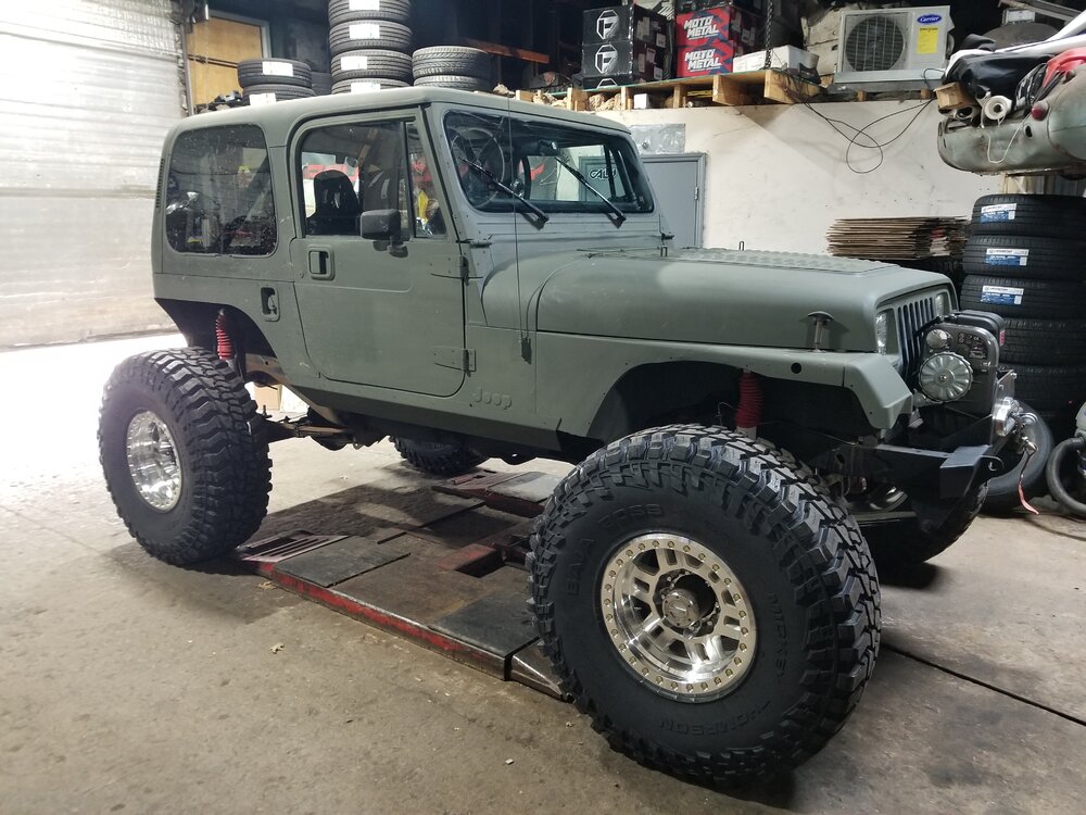

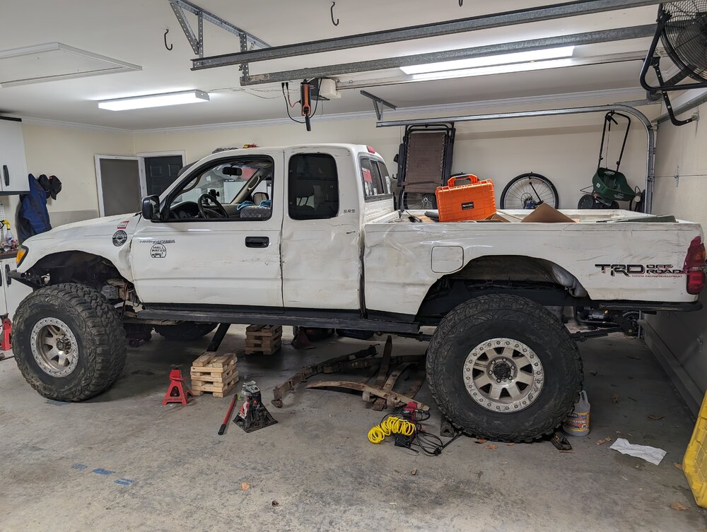

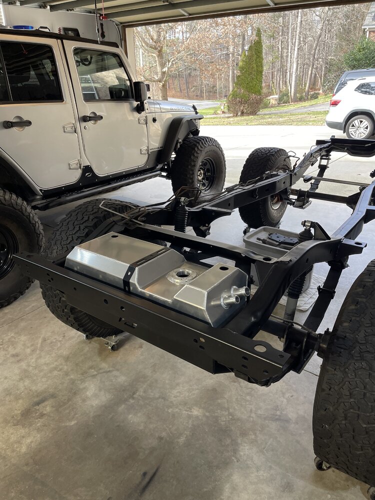

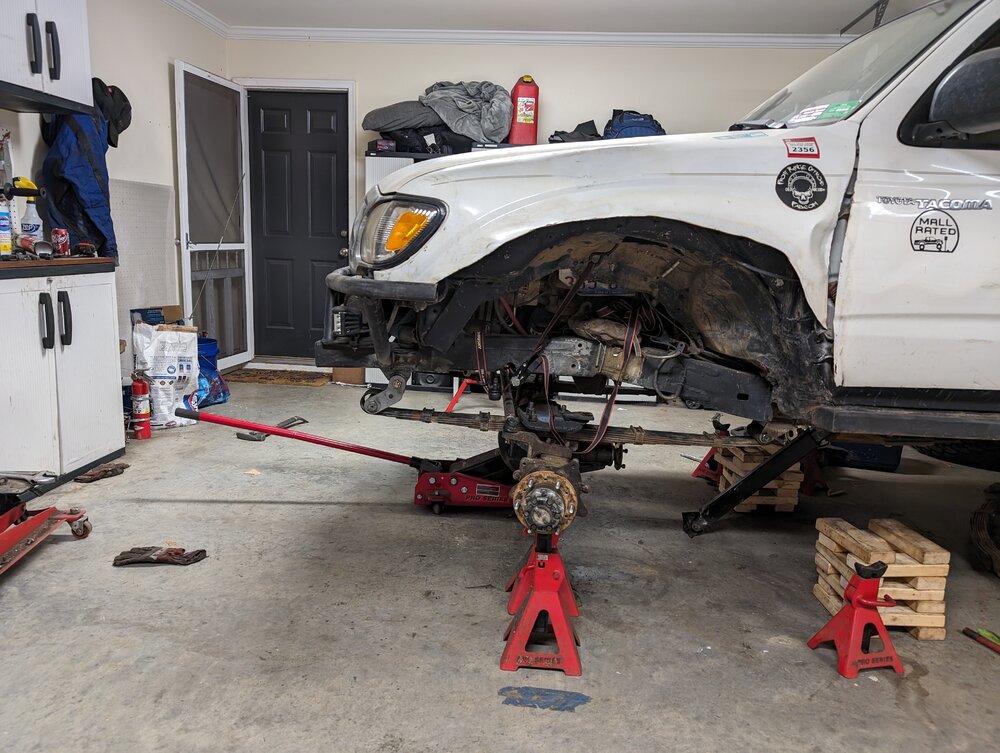

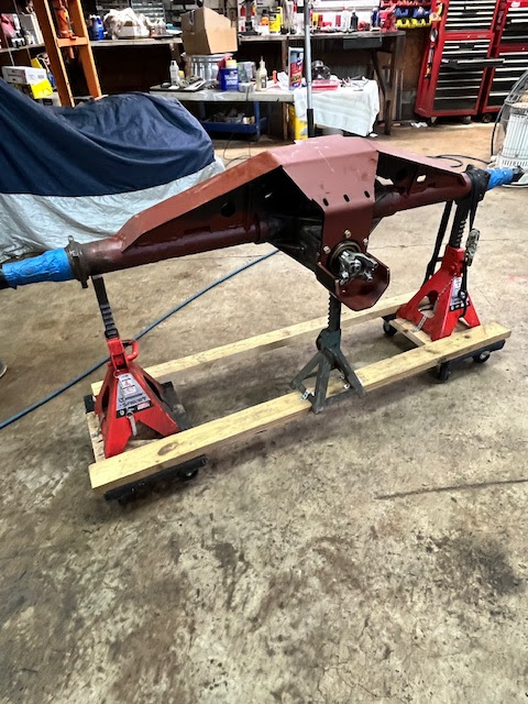

Threw the front axle under it to flex test everything, and did the required bolt tires back on and stare at it move. It all has to come back off again, but still a nice mental hurdle.
Also pulled the front axle apart for the first time since I built it in 2016. No birf soup and not bad for me welding knuckle balls on without a true bar or having any idea as to what I was doing.

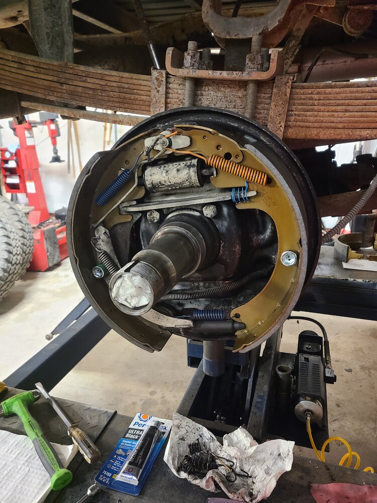

Working on some rear brakes before getting it sold next weekend.

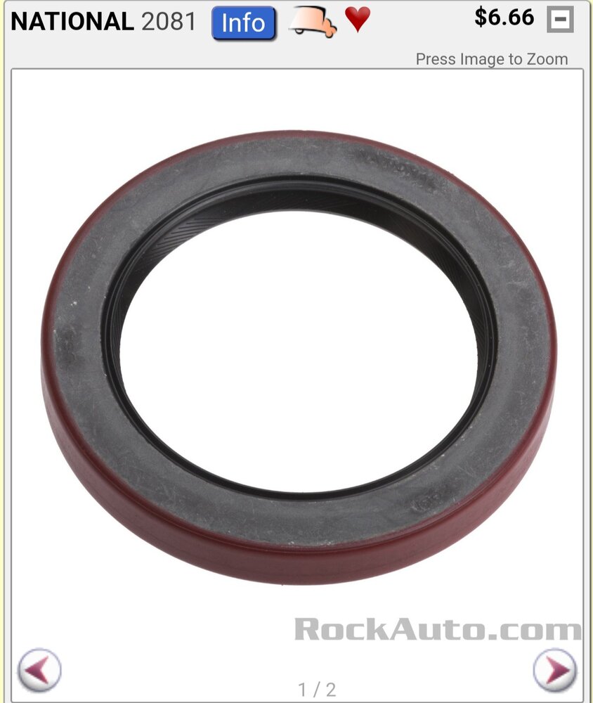

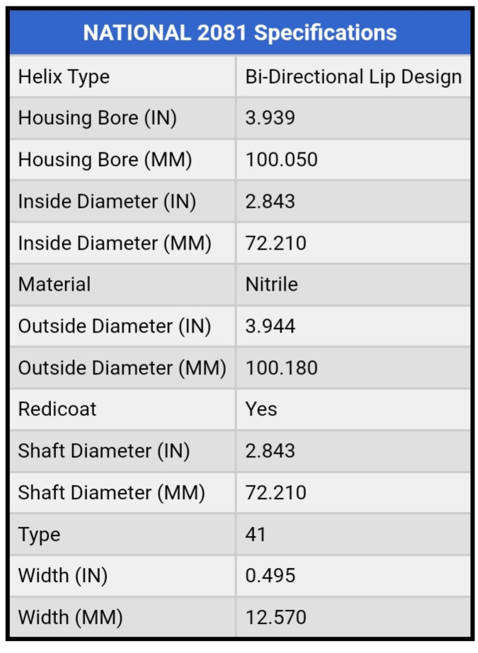

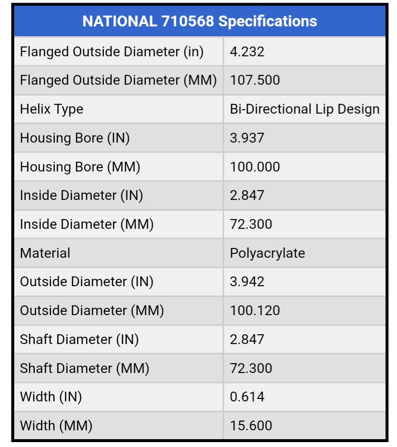

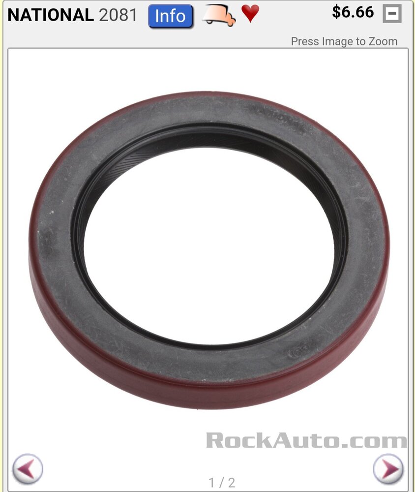

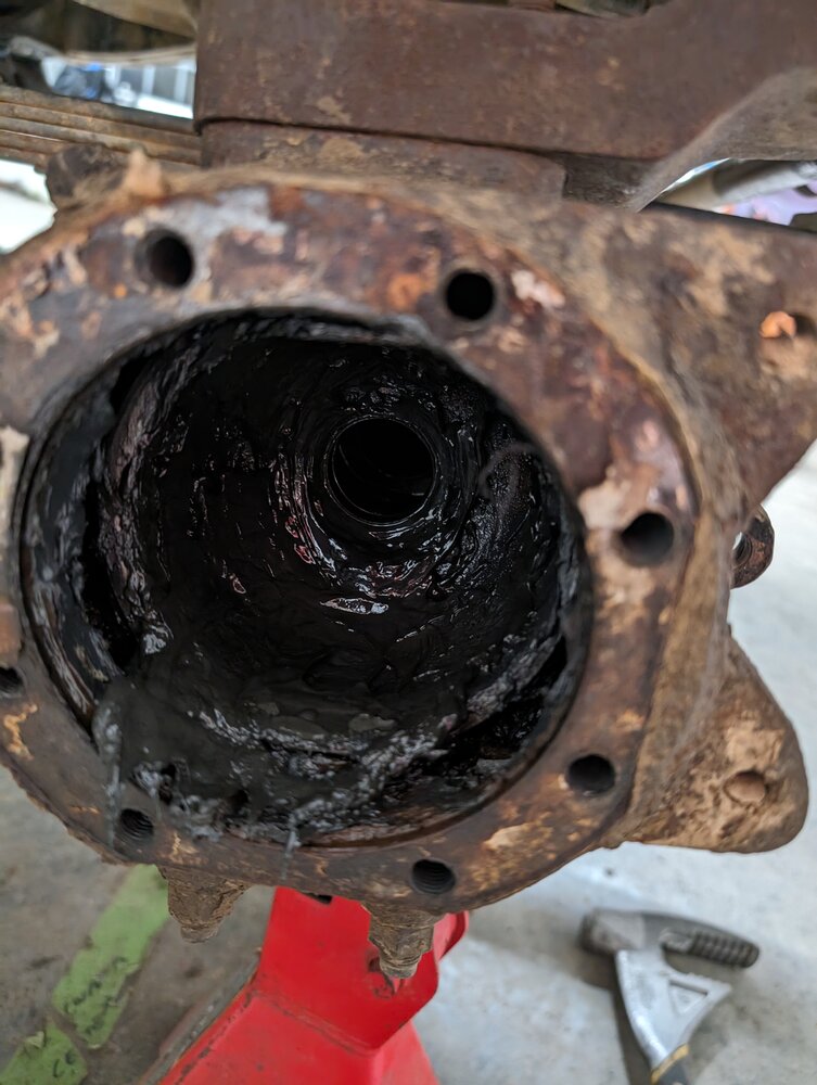

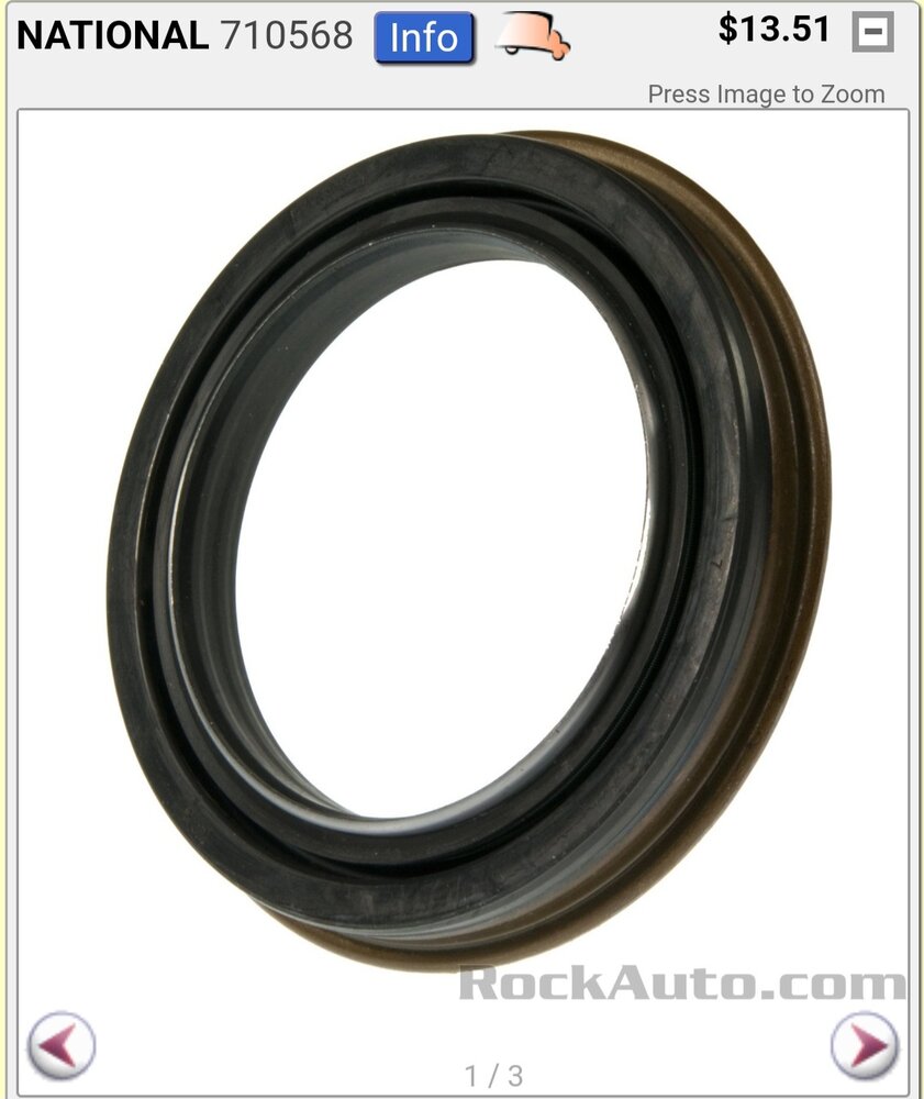

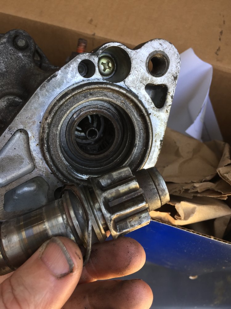

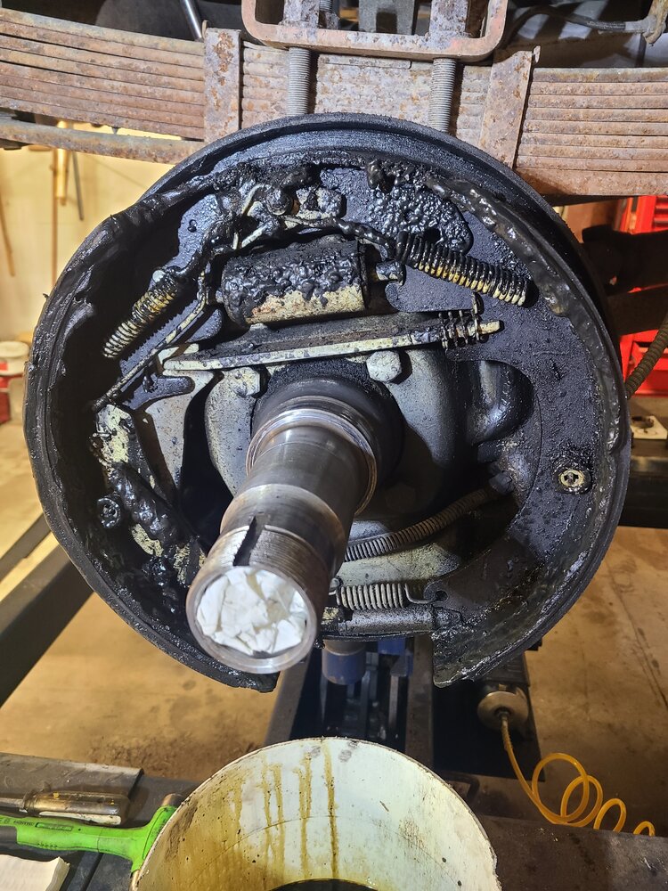

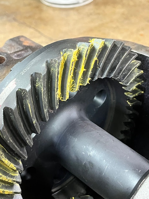

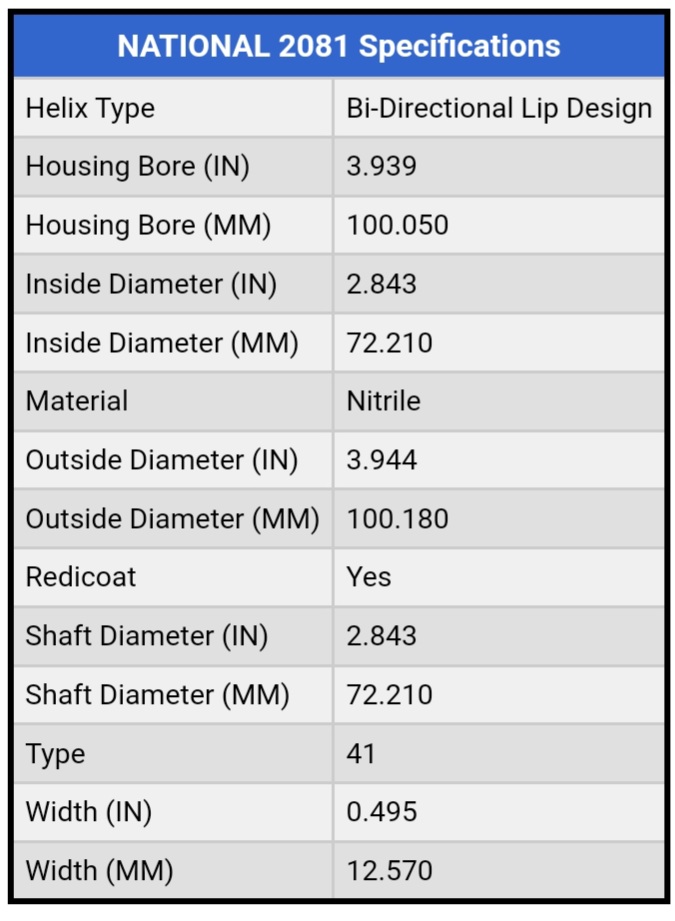

Not sure why I never knew this before, but you can 100% use the newer style, two piece, AAM 10.5/11.5 hub seals on an older 14 bolt!

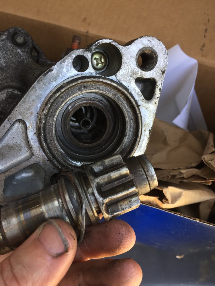

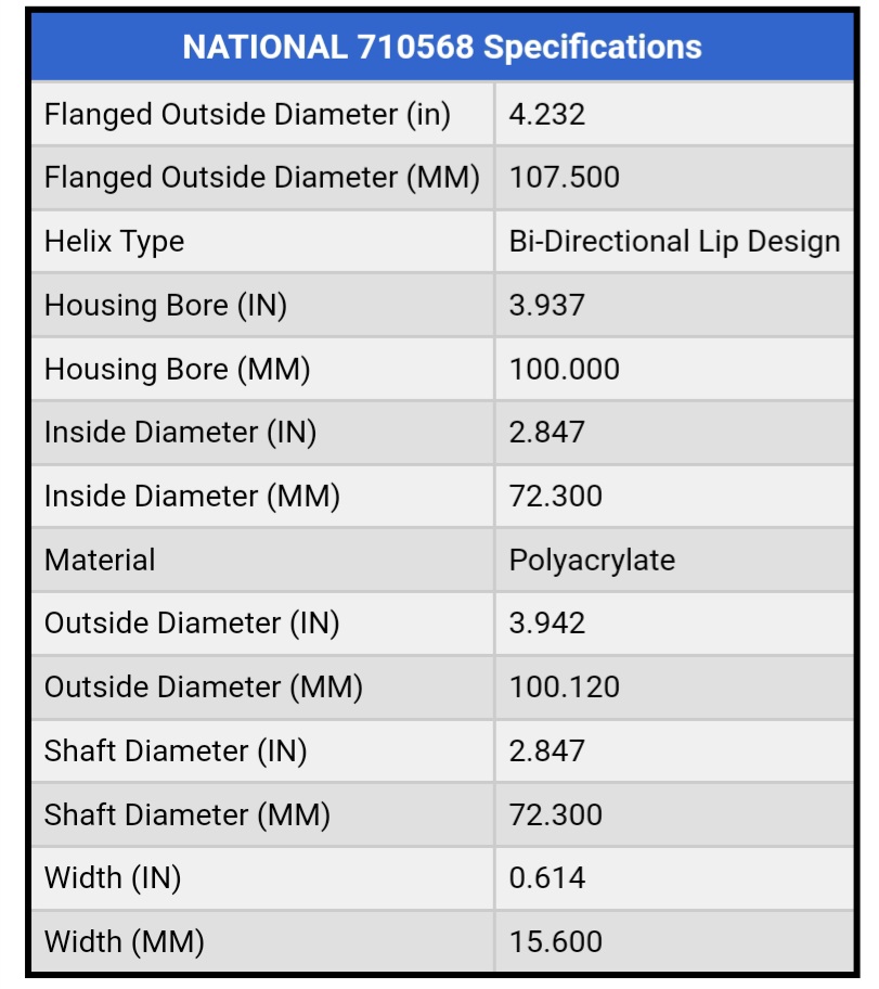

I was at work last night and the thought popped in my head. I used the "more info" tabs on RockAuto to compare the seal's OD and ID. Sure enough, they're the same! This should keep the first picture from happening again and the shoulder of the spindle will no longer be the sealing surface. Good lord, it was NASTY in there!
I had been thinking it was the wheel cylinder leaking, but I was wrong.

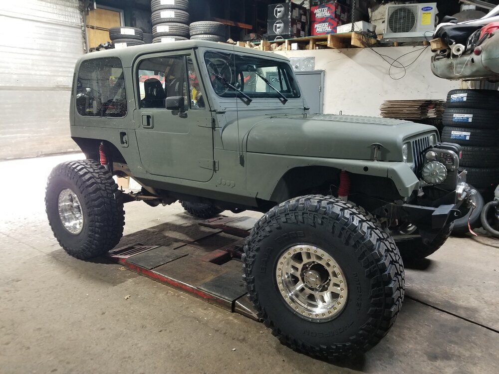

what kind of lift and capacity you working on? I've been shopping.
Ask and you shall receive :D
Old style

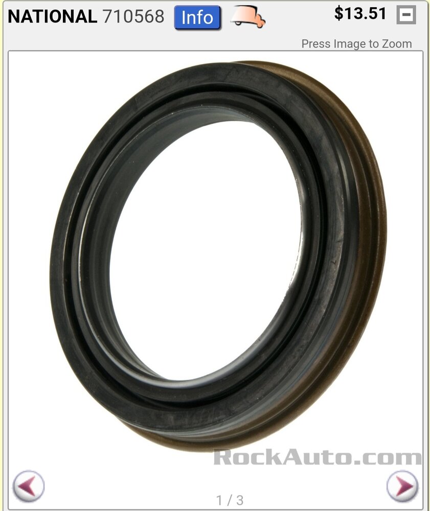

New style
Of course, it's tougher to get the hub/drum assembly off and on. On the AAM axles it's just the hub itself, but it'll be worth it!
I was thinking about how many parts the AAM 10.5 shares with a regular 14 bolt (spoiler alert...it's almost ALL of them) and though "hmm...what about the hub seals?". Boom. Winner!
The newer seals are pretty spiffy :D
The 4 post is an older Eagle alignment rack. 12k with center jacks. We have the wiggle plates in the rear and the turn plates for the front. Been looking for an alignment machine setup.
The two post next to the four post is an ALM 9k. Just put that in last week.
I think we paid 1500 for each one.
The best part being, they don't leak and the sealing surface isn't the spindle anymore! I can't believe I didn't realize this trick sooner.

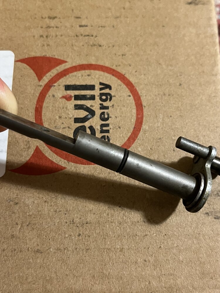

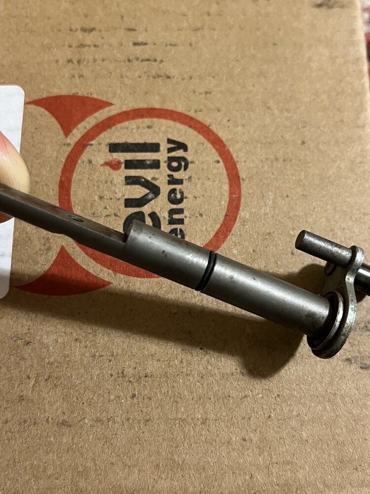

You'd probably have to bore the base plate, press fit a bushing, and then bore that to fit. You could also sleeve the shaft, but would still need to ream/bore the base plate.
I kinda dig the o ring idea for simplicity. I'd probably lightly lube it with something like dielectric grease so it doesn't make the throttle sticky. I'd think it should last a good while.

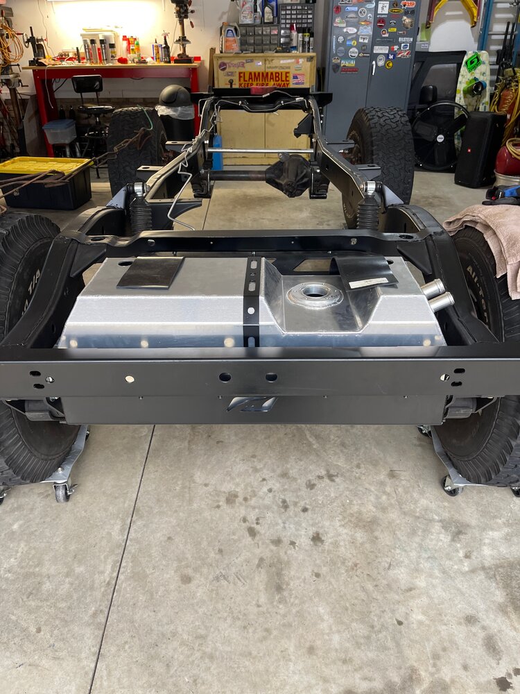

Got a little closer to the 1 ton swap

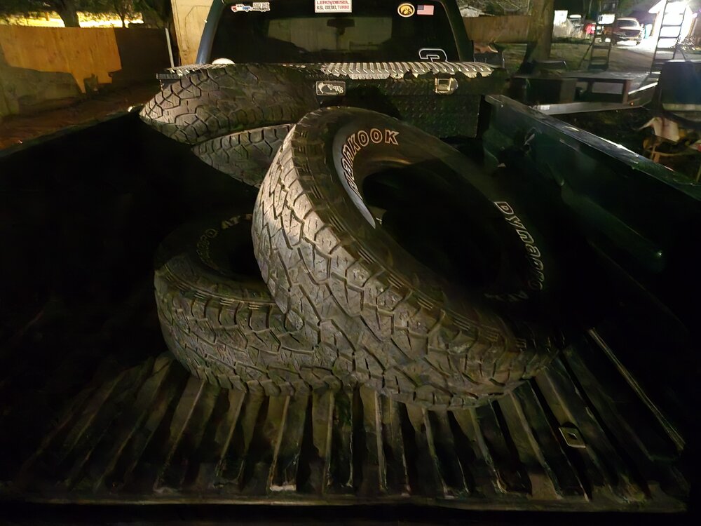

Picked up some 285s for the crew cab, they're a little older but there's no dry rot and great tread.
Normally I wouldn't get older tires but I'm so sick of the 265 mud tires, they balance out perfect but shake the truck between 35-40; these Hankooks only need to last me a couple months. The red truck is going to be getting new tires, so the Kellys will be going on the one ton
