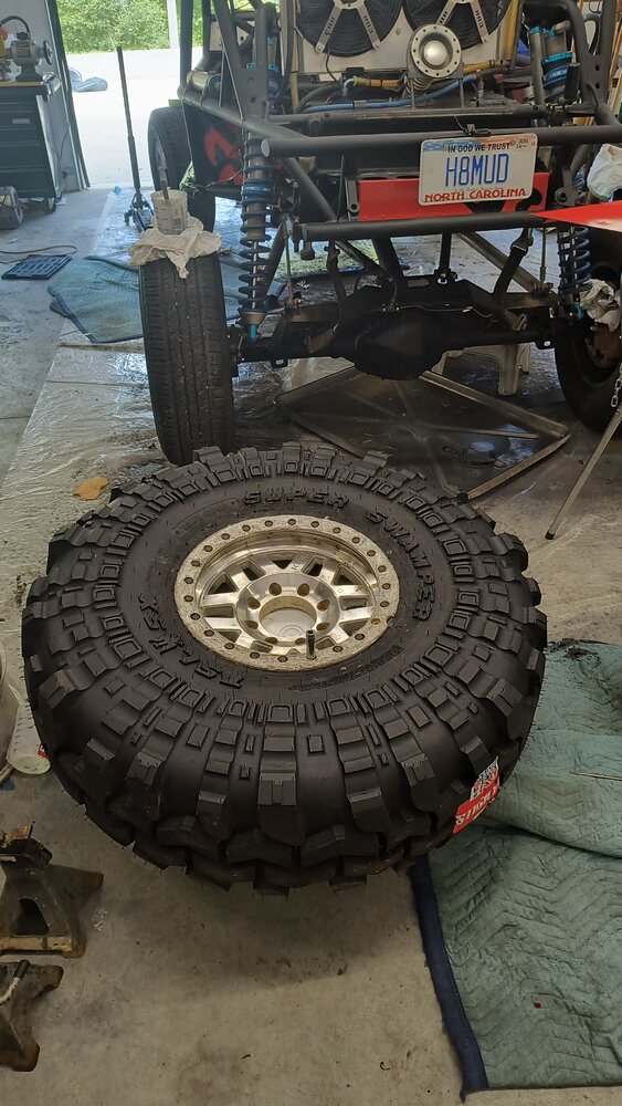

Mounted a tire
I’m looking for tires since my current ones are dry rotting on the rig.
So I had to put on the spare a couple days ago.
Funny thing is, the rotten tire looks great while the spare looks like a dinosaur chew toy.
The chew toy rides as smooth as silk!

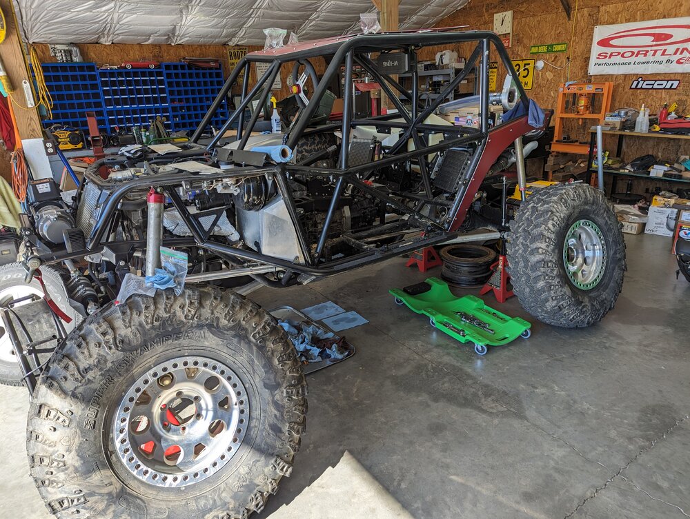

What's going on with that pile of tube on wheels behind that tire?
A little cosmetic change, some upgrades and a metric shit-ton of dirt removal 🤦🏾‍♂️

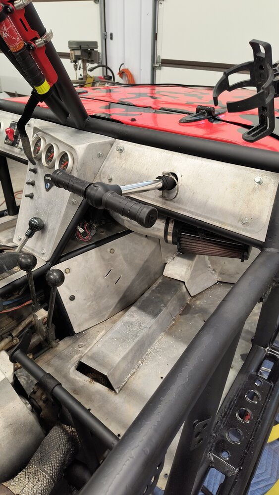

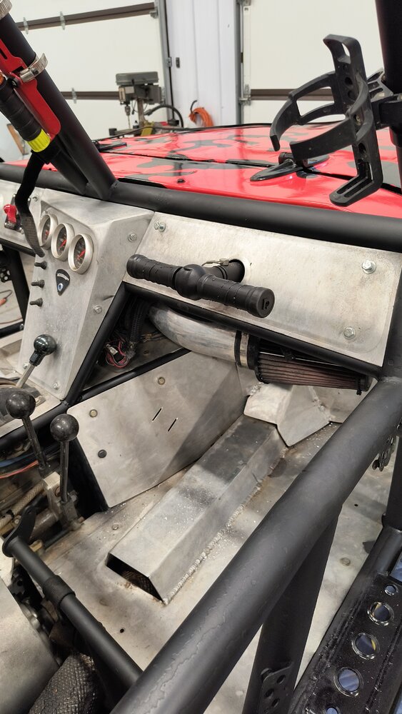

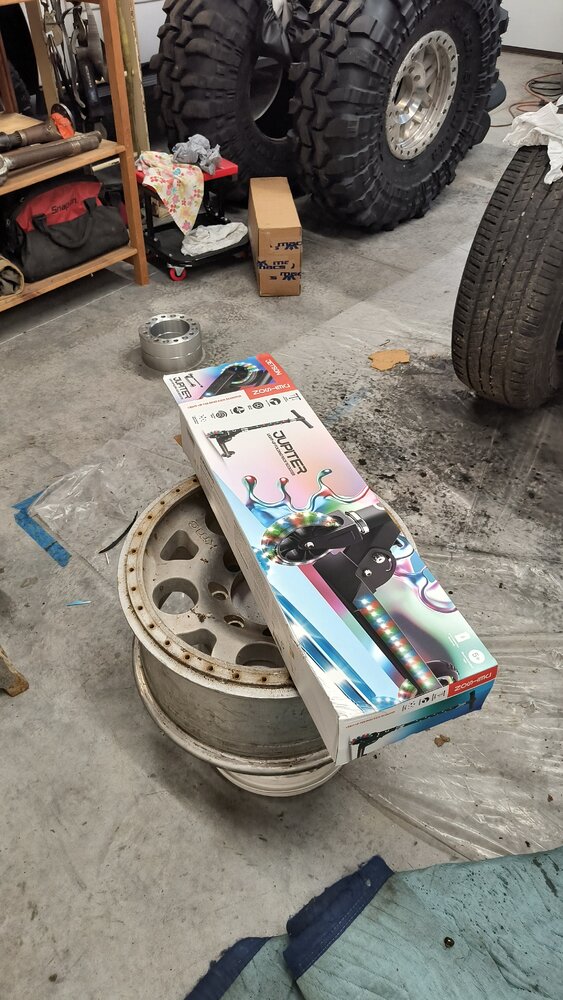

Installed an adjustable oh shit handle from a $24 donor scooter
That's both clever and hilarious. Also, mildly genius. Same type of thing that all the side by sides have in them. I like it 👌 Not to mention, nobody (hopefully) got smacked in the shin with a scooter!

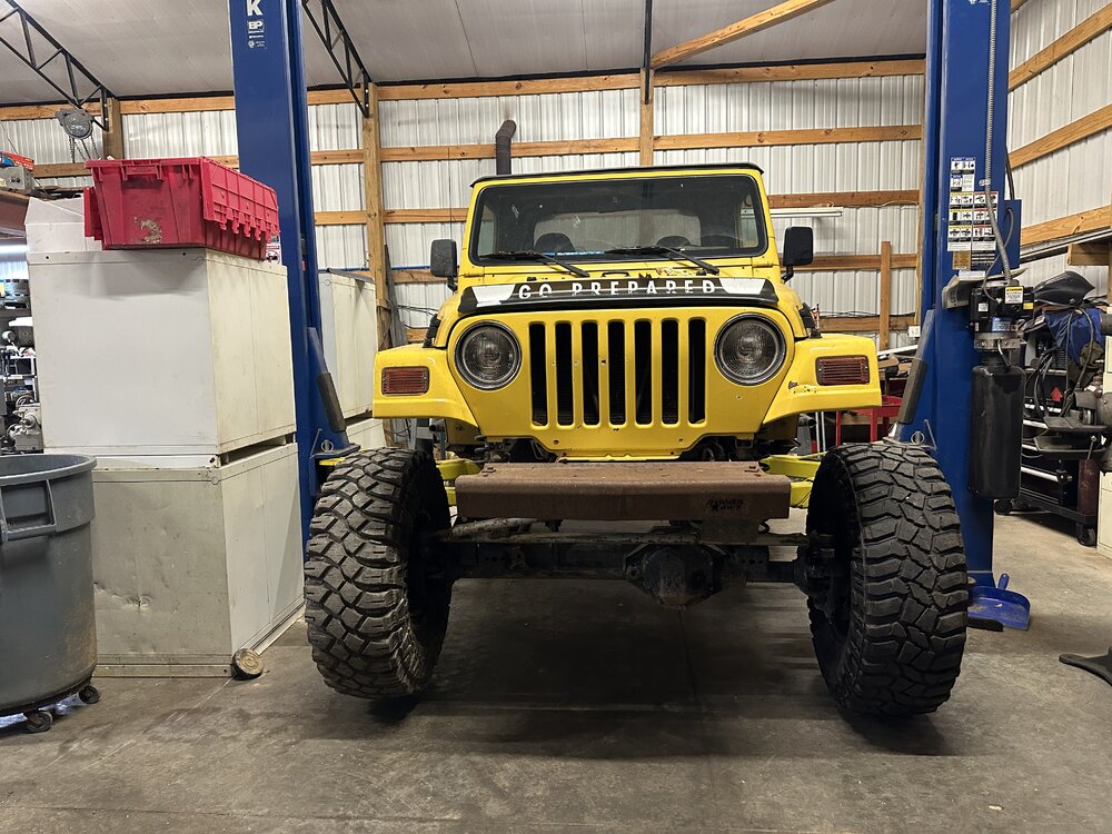

Drove it over 45mph without death wobble or even mild wobble for the first time in 8 years!!!! Actually hit a little over 60 without issue.

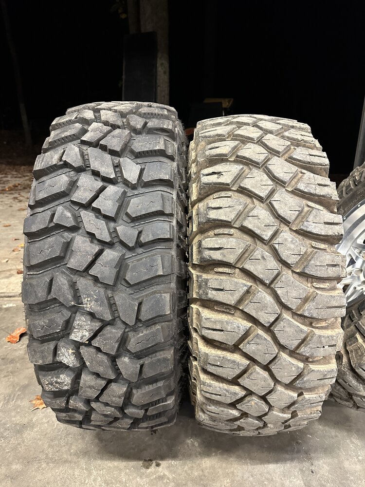

Got a set of 37” Cooper STTs from @karatejosh last week. Seems like a great decision. They are taller and wider than 37” Creepies. Biggest surprise was the Creepies were 95lbs and the STTs were 115lbs. But I imagine a big part of that is the 17” steel wheels vs 16” aluminum wheels.

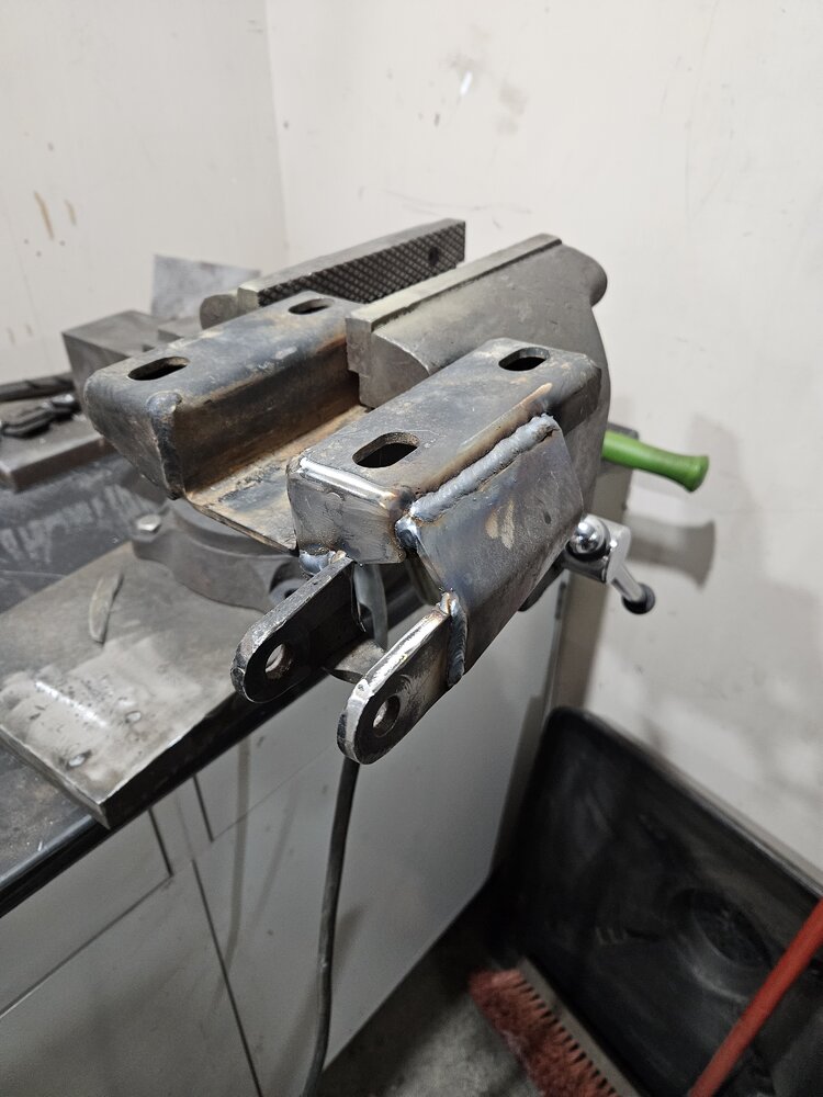

Now all I have to do before the Uwharrie G2G is replace the front driveshaft, rework the D300 shifters, raise the rearend 2”, install a sway bar and mounts, mount and wire the winch, rebuild the transmission, get new shocks, get new springs, 3 link the front, 4 link the rear, and replace the headlight switch so @1stgenxxx will ride with me (or maybe not, haha)

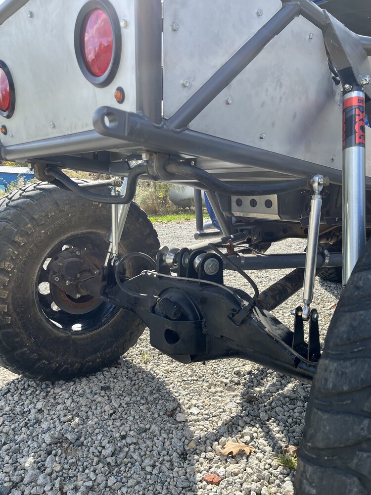

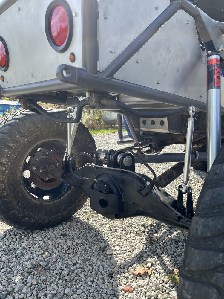

I’ve read that a rear JK sway bar is a good candidate if that one doesn’t work well in the long run 👍
The jk rear sway bar is wider than my Toyota axle 😅. Spent a while in the junkyard with a tape and ended up with a s10 blazer rear bar.

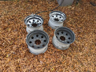

Dismounted the junk 35s last night and went for Aircraft stripper earlier today, hit em up and let em marinate and luckily whoever painted these didn't do it right! Paint just sloughed right off, going to hose them down with LAs Totally Awesome and hit em with a mild scouring pad, then probably seek out a good polish kit.
