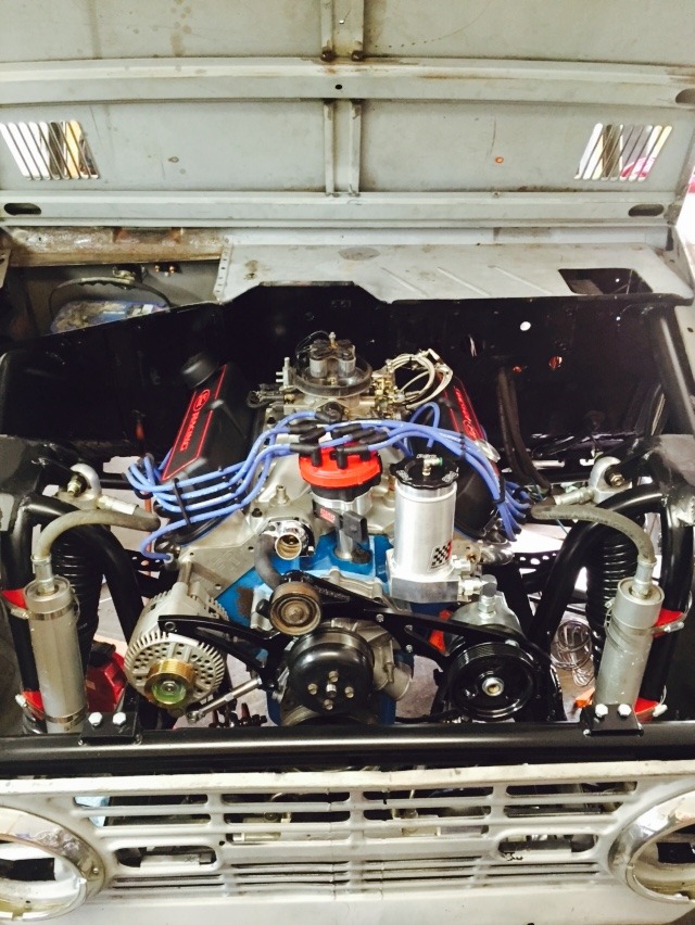

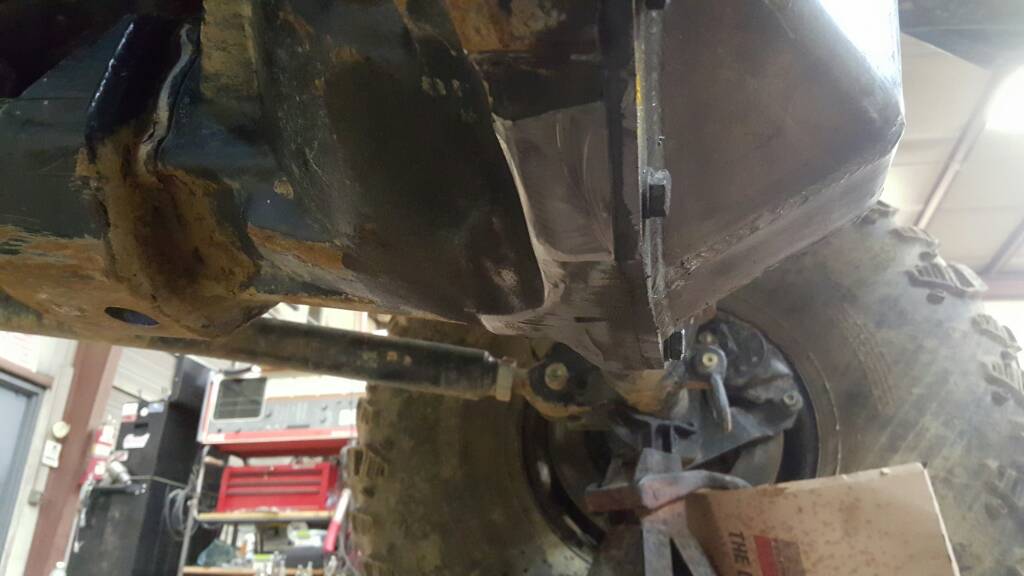

Pulled the engine to finish welding under the hood. Finished the engine assembly, painted under the hood and got the engine back in. Also fabbed up a hydro reservoir mount, installed a hydroboost and MC and finally got to do a little body work... Long weekend!

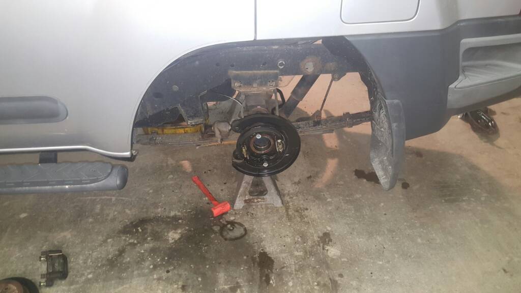

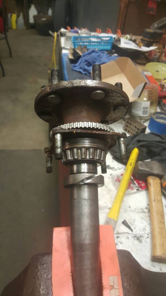

My fiance's xterra had some Brake noise,so I took it all apart to see what was going on.
Front pads were shot, and rotors needed to be turned.

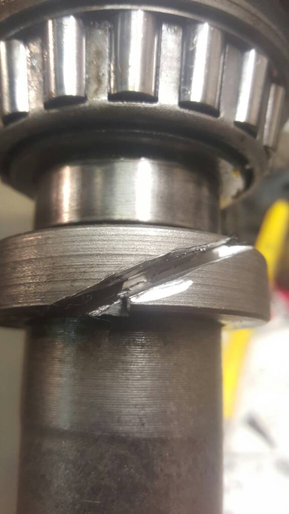

Rear brakes were near perfect but a bad axle seal on the driver rear. This reminded me why I hate dana 44 rear axles.
Have to cut the bearing retainer and crack it, destroy the bearing, then cut and crack the inner race, just to change the seal.
No room to get bearing separator under it in the press without ruining the retaining plate.
Then changed the diff oils, tcase and trans oils and the engine oil.
I found a bad ujoint in the front driveshaft at the tcase. I hope with was the vibration we could feel at 70. That will have to wait until after work tomorrow.

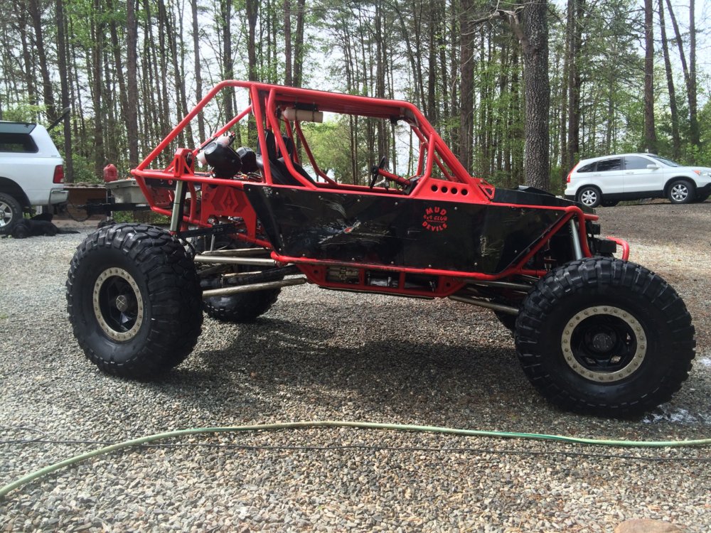

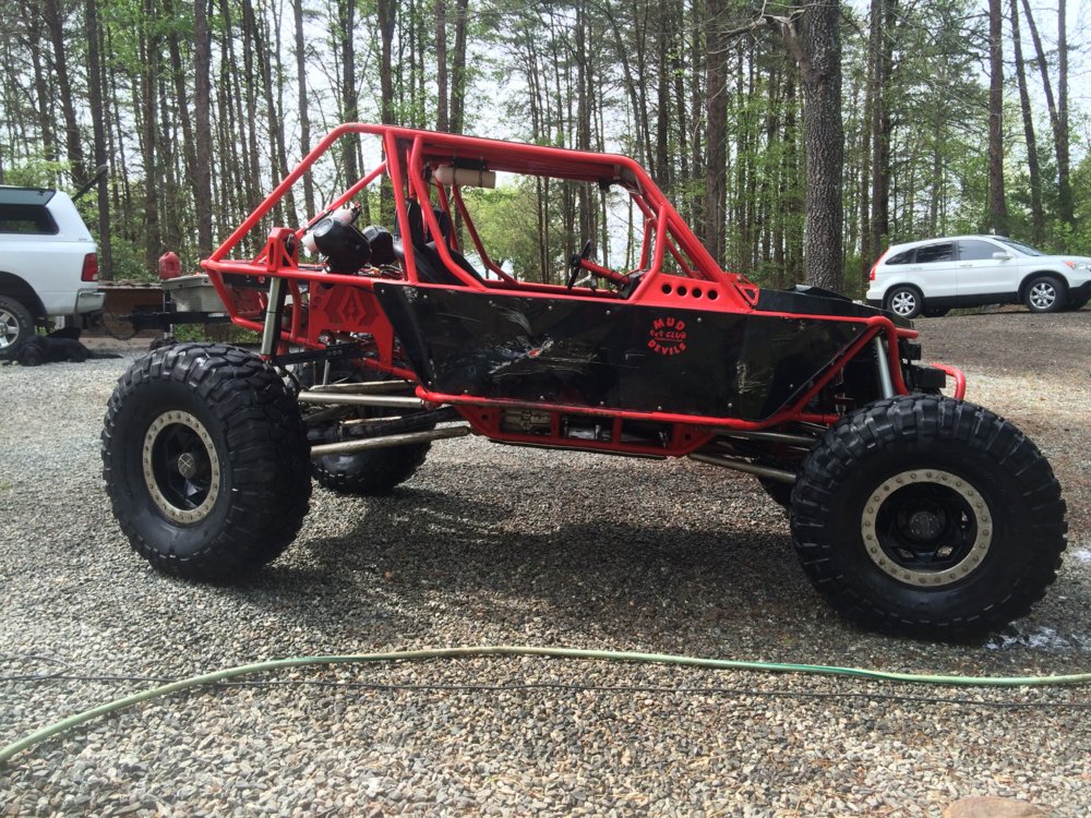

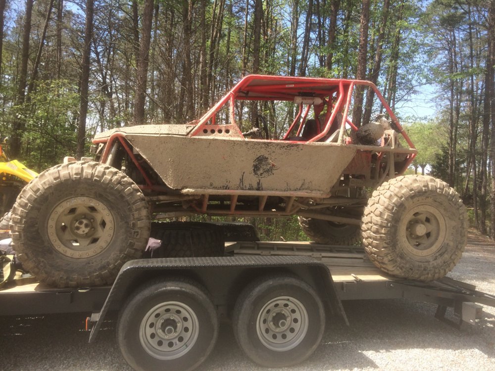

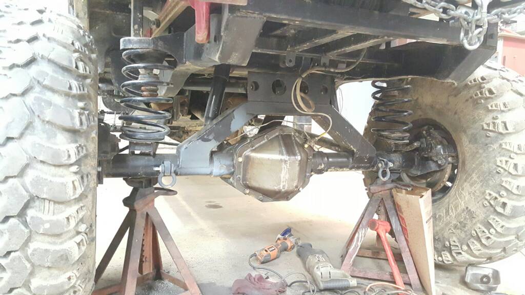

Went and picked it up from Buckeye Performance and gave it a shake down drive. Chris built me a sweet custom 3 link, track bar, 1 ton steering setup, and moved my PSC steering ram to where it should have been. I thought it drove good before but it drives better than a new one now. Awesome work BUCKEYE PERFORMANCE!

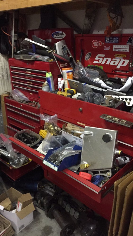

I got motivated to change all of my poly inserts on my Johnny Joints and then can't find my snap ring pliers. :(
I wonder why...

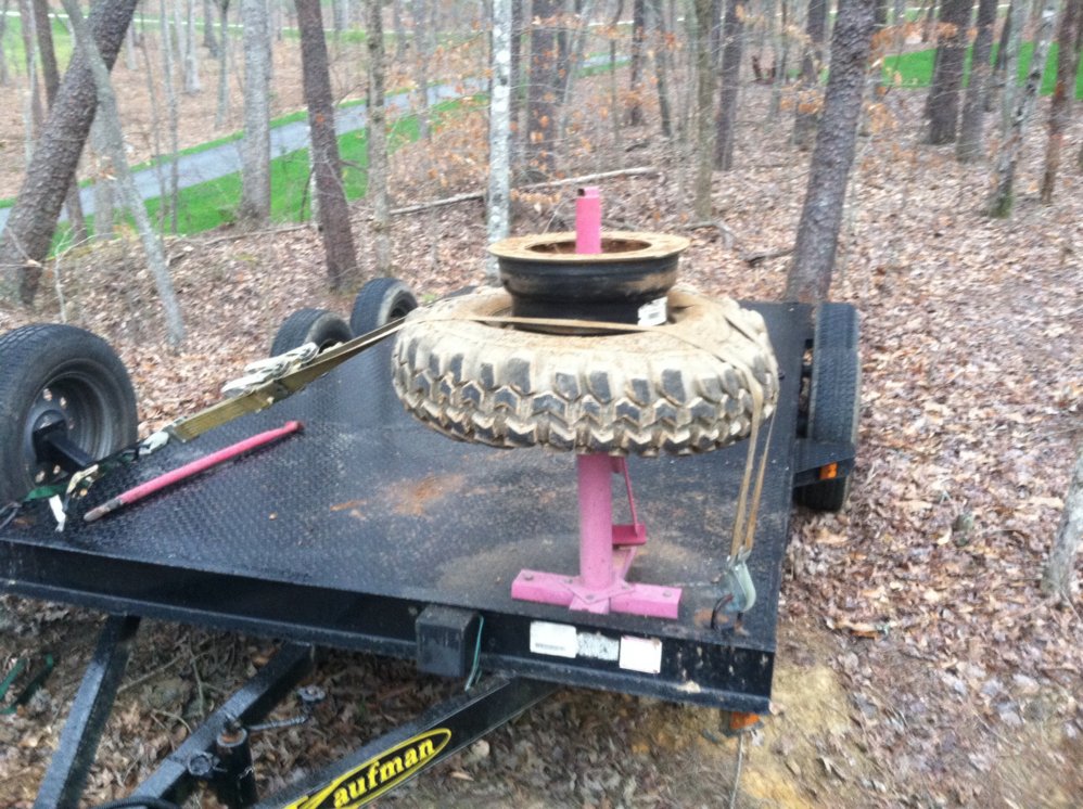

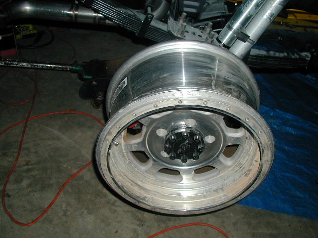

Cleaned all the debris out from the bead on my left rear tire and straightened a small ding in the rim so i wont have to pump it up every week.

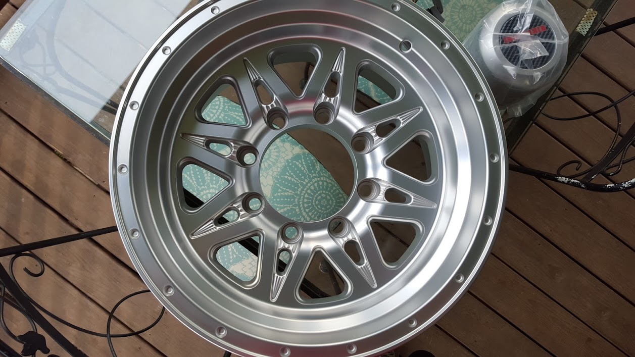

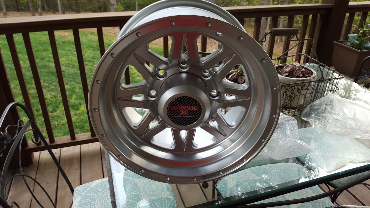

Upgraded the tow pig and trail rig with new and improved Bearcat 880's, tuned them (special thanks to @Jason W. ) then flushed the coolant in the Jeep for this weekends fun at Adventure Offroad Park.
