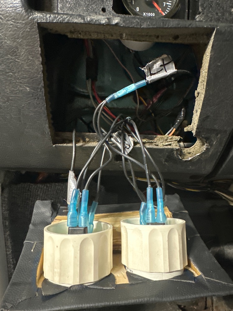

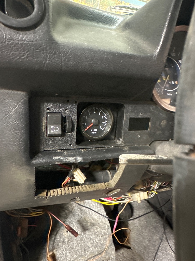

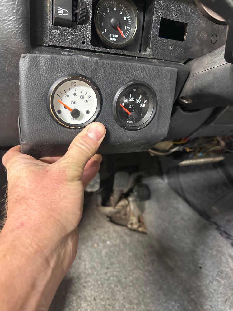

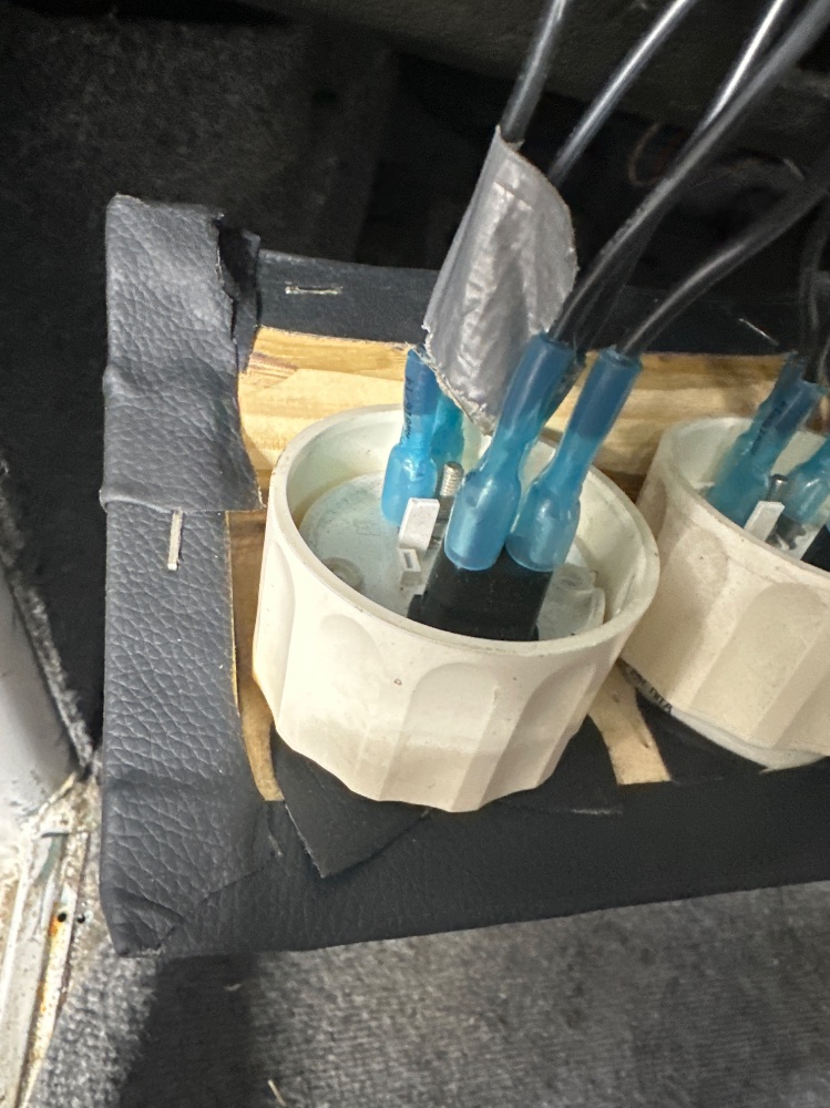

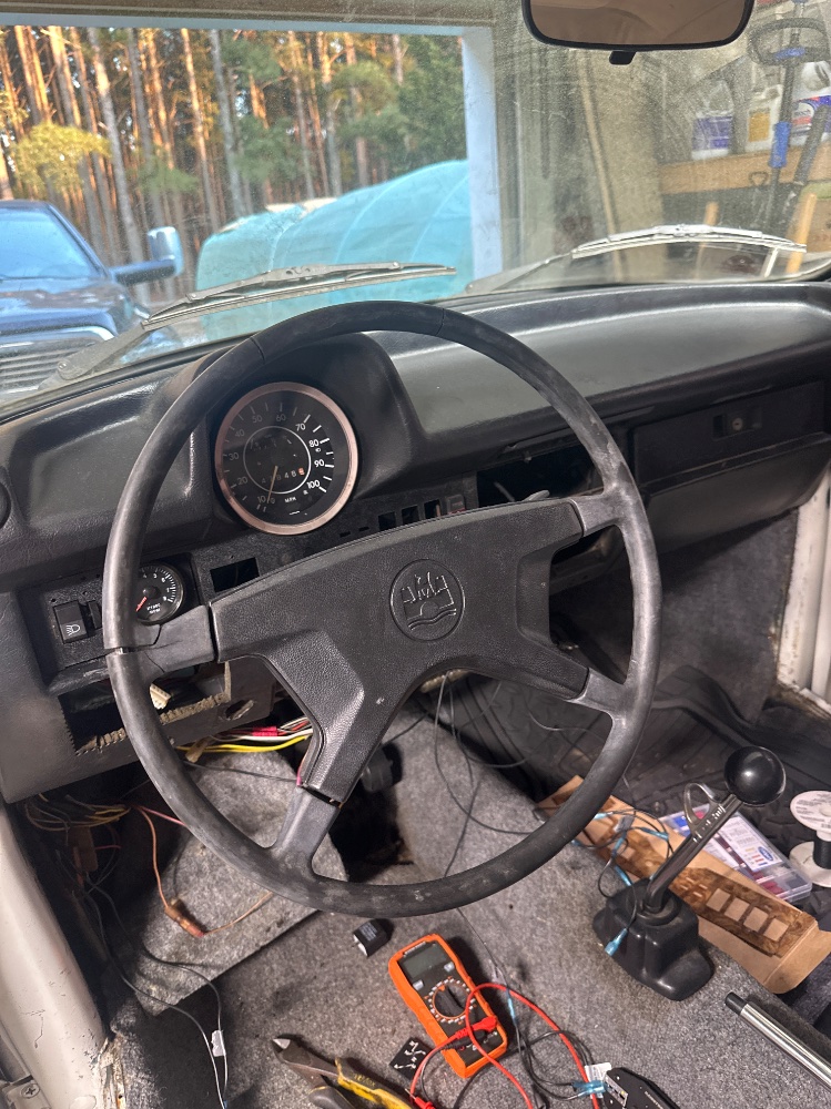

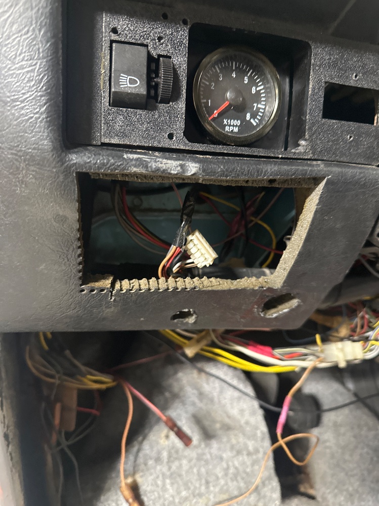

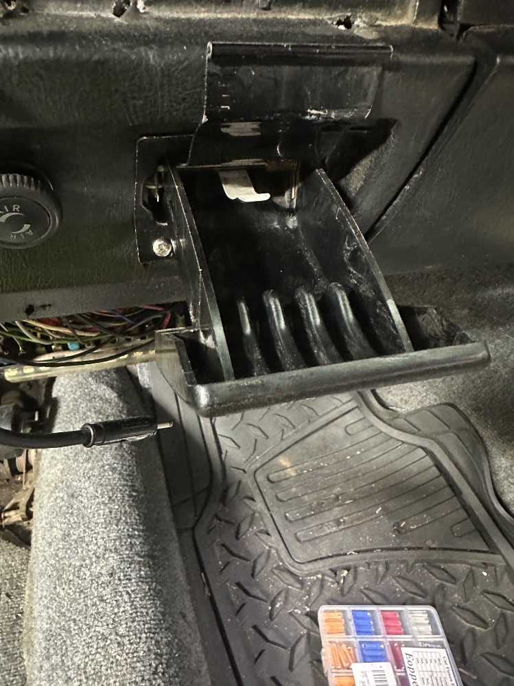

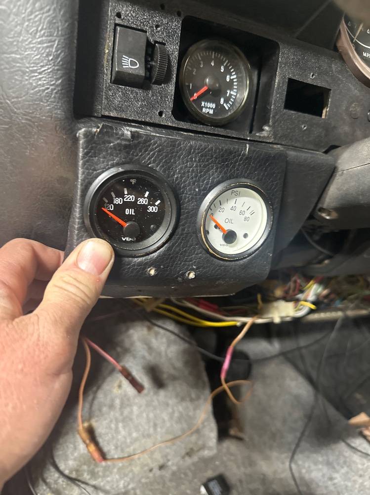

Got a factory steering wheel and cleaned it up to install today. Horn button is functional. Also got the little tachometer mounted. It sits in the cubby that originally held the analog clock (factory option). Waiting on a piece to dry up that will hold the oil pressure and oil temp. gauges where the original radio speaker was. This is just a practice piece to see if I like it and will be modified to be permanent if I like the version 1.0.

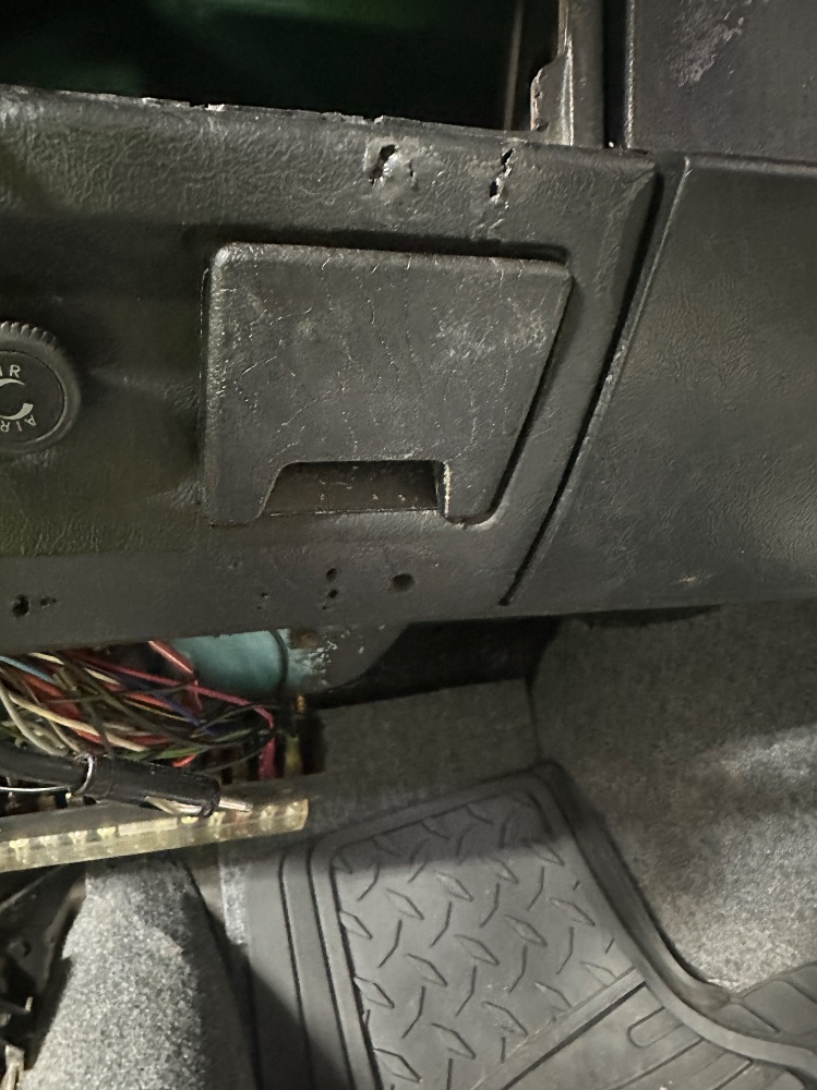

The area around the switches originally had some plastic “wood grain” but the PO had messed it all up with screws and XYZ so I’m looking for some real maple veneer to glue in place to cover up a lot of the little screw holes and switch holes that won’t get used.

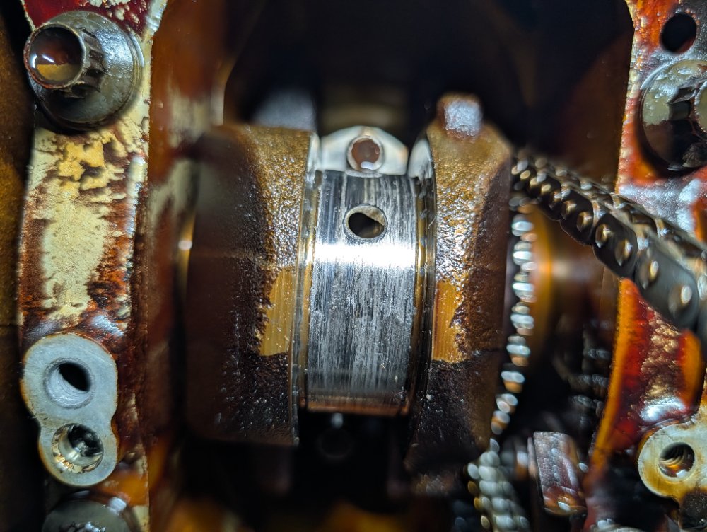

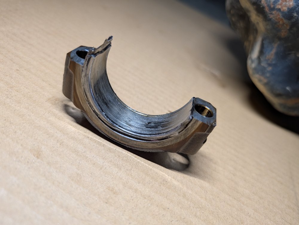

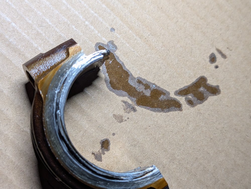

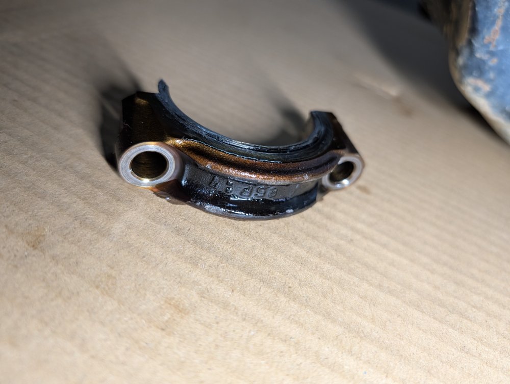

The engine in the buggy had a disco party yesterday at the Ranch. Bit too much weepow and angry squirrel noises. Ended up locking up and having to be dragged back to the trailer. Today I cleaned up the buggy and dropped the oil pan to see the damage.
Cylinder #1 rod bearing left the chat. Rod side bearing actually rolled on top of the cap side bearing.
Now I have to get one of the spare engines out of the shed and go through it to make sure it's ok to install.

Too much weepoww. That sucks.
