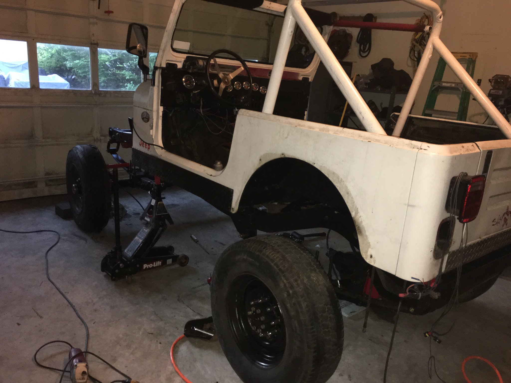

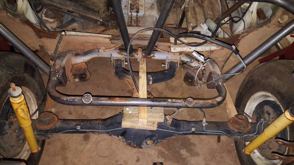

Need to move the zuk chassis out of the shop and couldnt find the stock arms, so i whipped up some JF style control arms.
Made sure to put the painted side down for extra beef.

Way to much thought and triangulation.

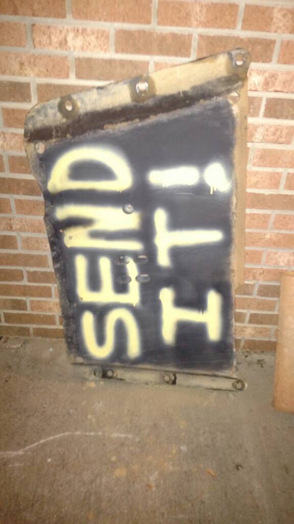

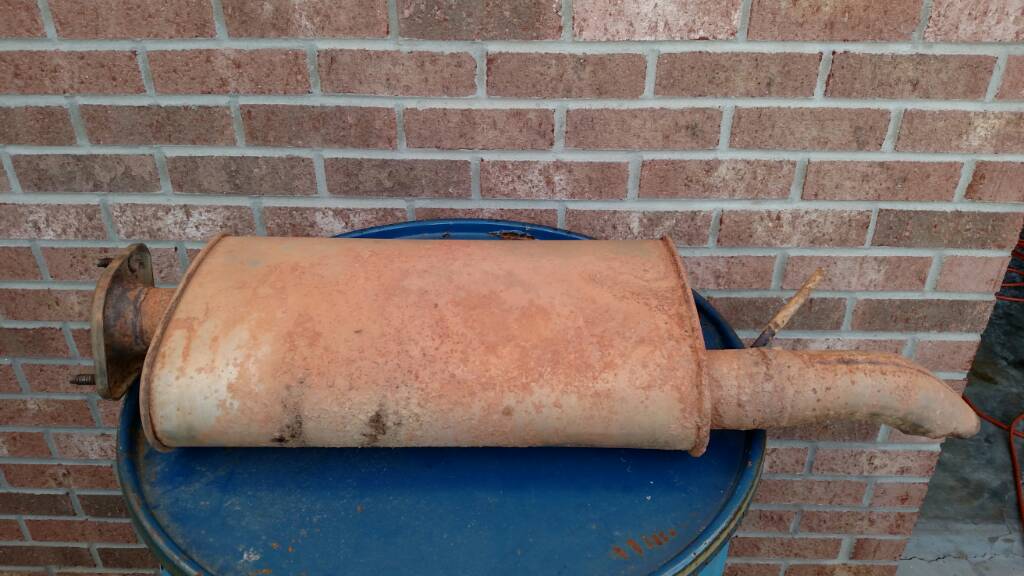

I'm boored and have a welder and case of [emoji481] so I decided to see what the tj would sound like straight piped. Doin' hoonigan fab straight up yo. Oh and my new skid plate quote.
Sounds less like a worn out Hoover vacuum now. My neighbor fired up his ole hot rod a little while ago (Chevy 454) so I thought I'd send some sweet 4.0l tunes back at him hahaha.

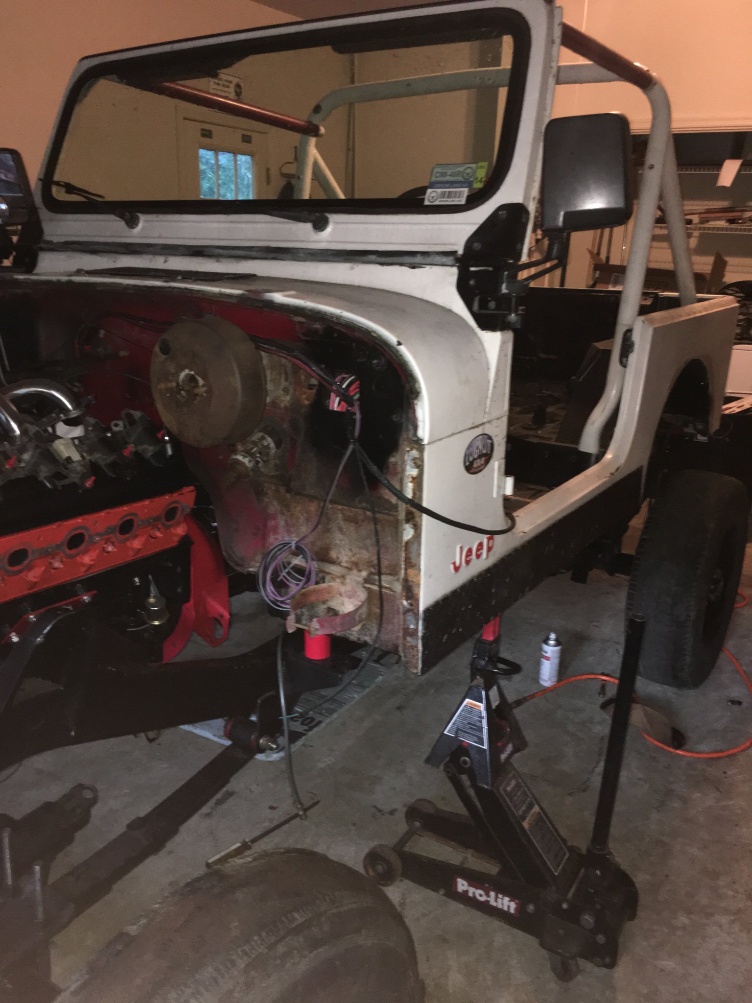

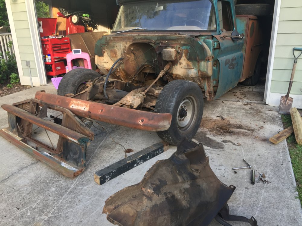

A few days late on posting, but took off the front end of the 62 to make life easier when I stick the engine and trans in to start mocking up some motor and trans mounts. I'm also hoping that seeing the exposed frame will light the fire to make me want to z the front end and get this thing down on the ground.

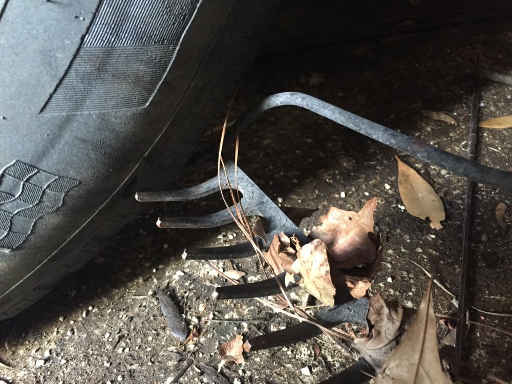

I also managed to run over the rake and blow out the tire when rolling it out so that was helpful.
@mcutler posts sweet bead rolled inner fenders and I've got a rake in a tire. I'm literally the worst. :shaking:

Someone broke your shovel too. Bastards.

Somebody's got to provide the entertainment...:p

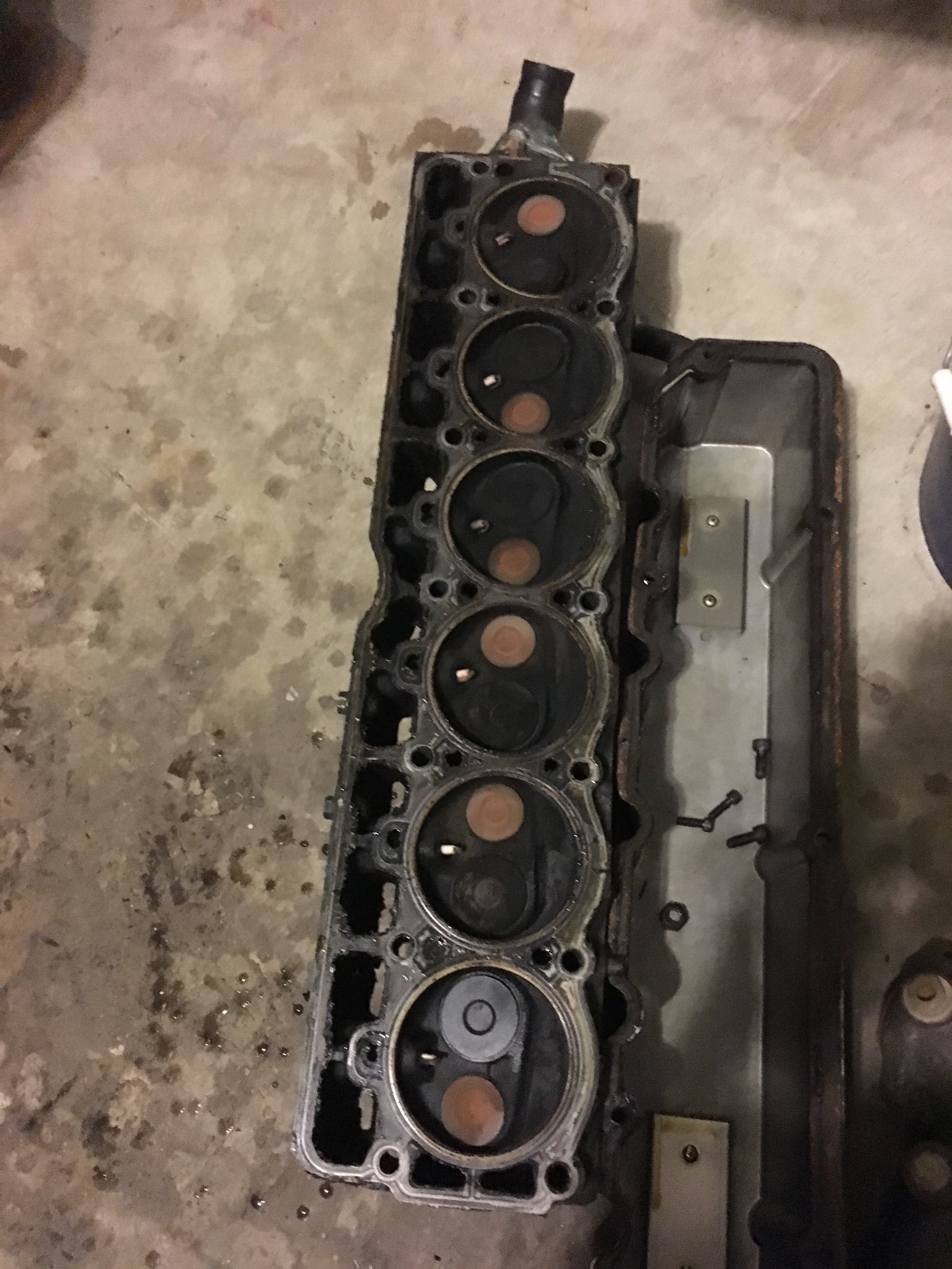

Found what appears to be oil in my coolant reservoir and a tiny bit in the radiator. No coolant in the oil that I can see. Dang it. [emoji21]

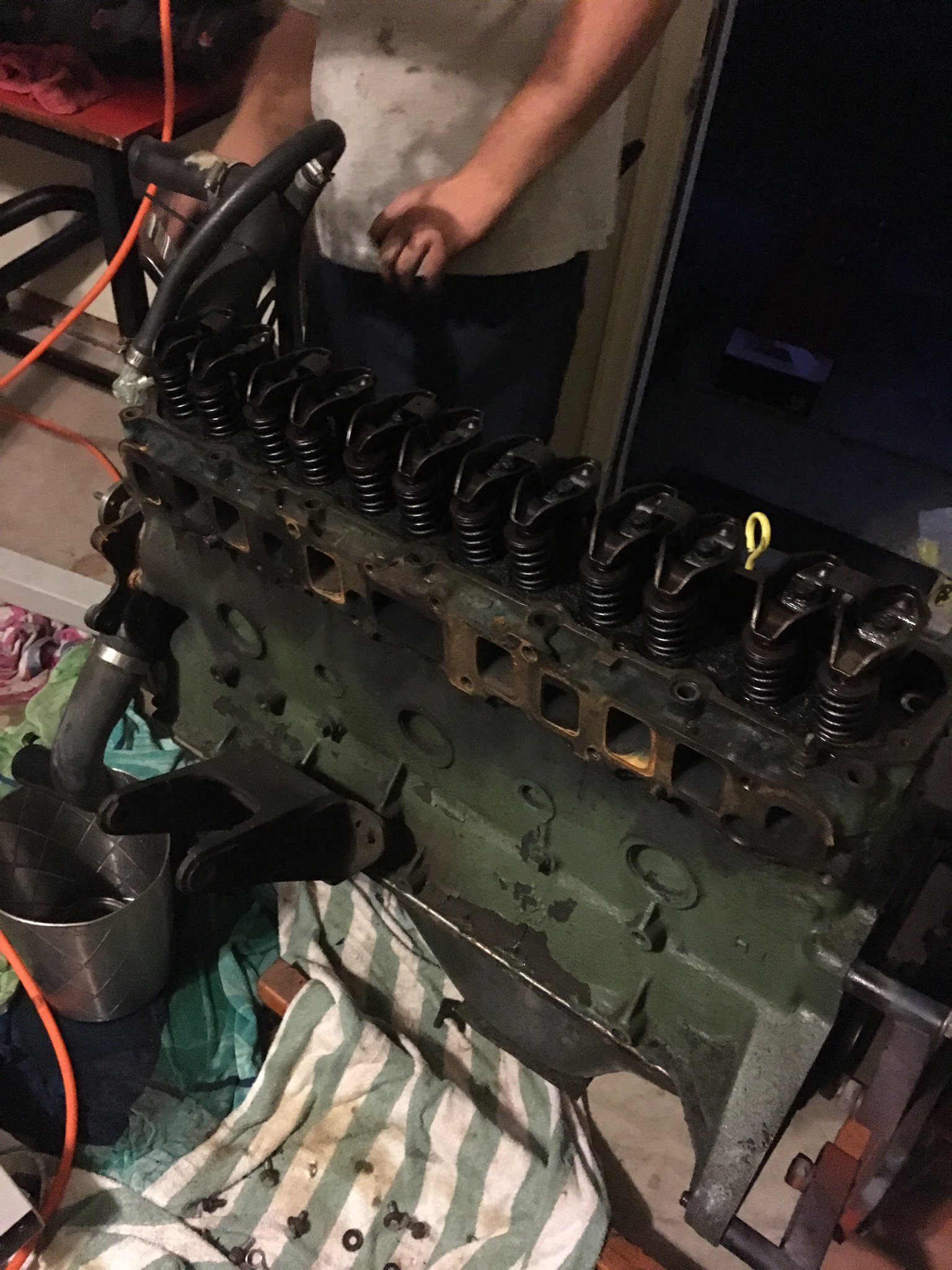

Got the engine and transmission between the frame rails yesterday. Was thinking about using the biscuit style motor mounts that came on the engine and making my frame mounts, but after staring at it for a little while, I think switching to A 73-88 3/4 ton crossmember is my best option. I can use factory motor mounts, will get disc brakes and they actually make drop spindles for those.
