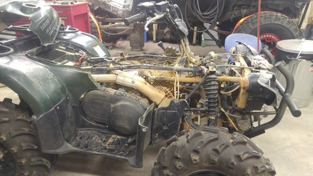

Tore my wife's bike down and adjusted the valves. Tore the carb down also but I'm waiting on the carb kit to come in.

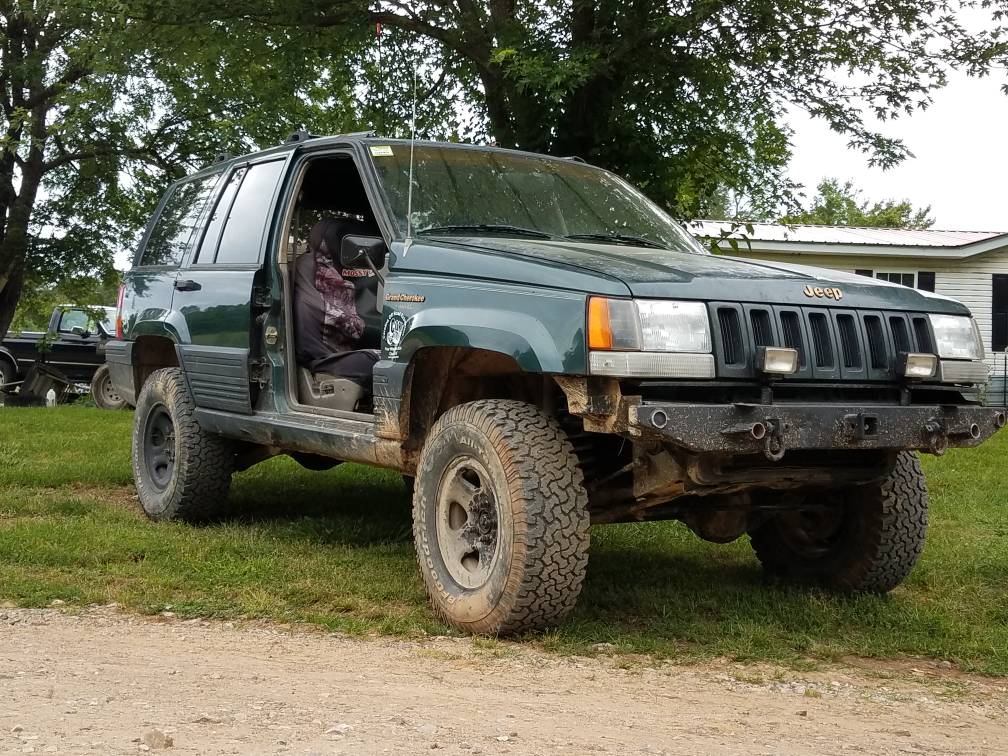

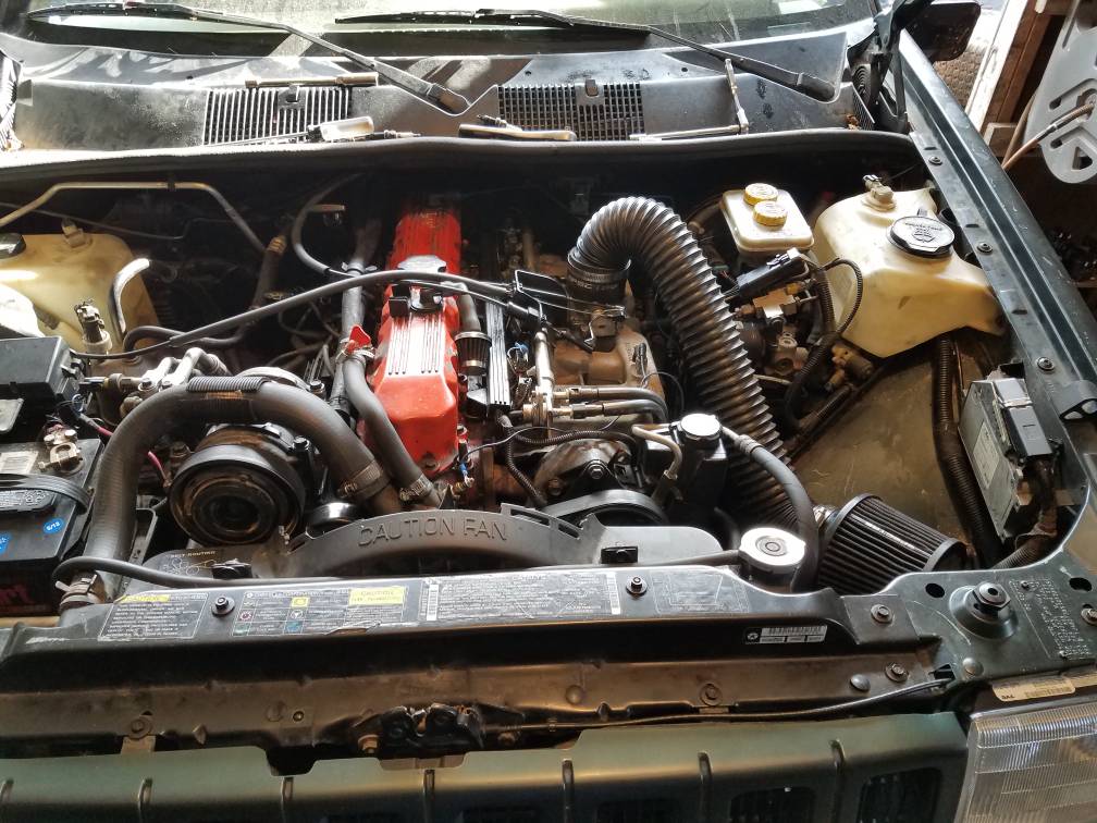

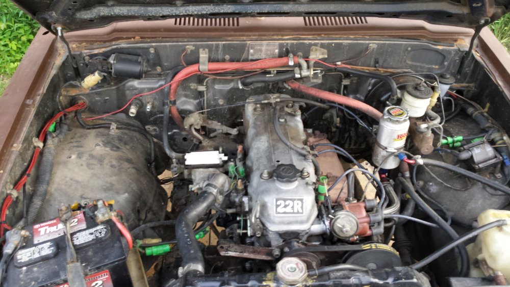

drove it for the first time with new motor

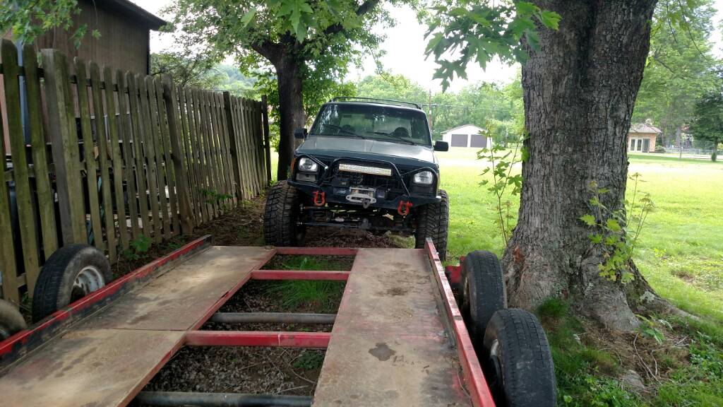

Rolled it off the trailer. Looked at it in disgust and hooked the trailer up and left
Did you give it the evil mustache look?

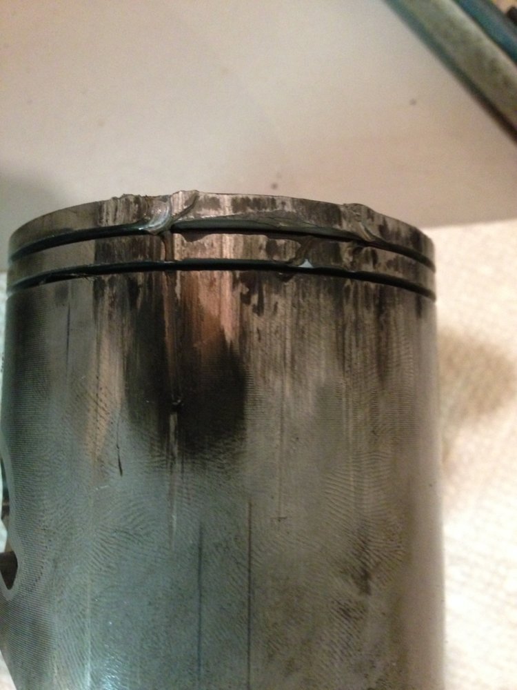

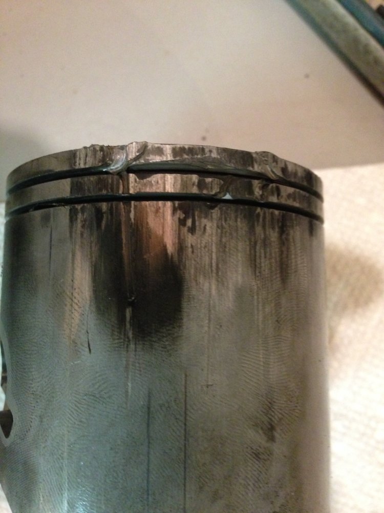

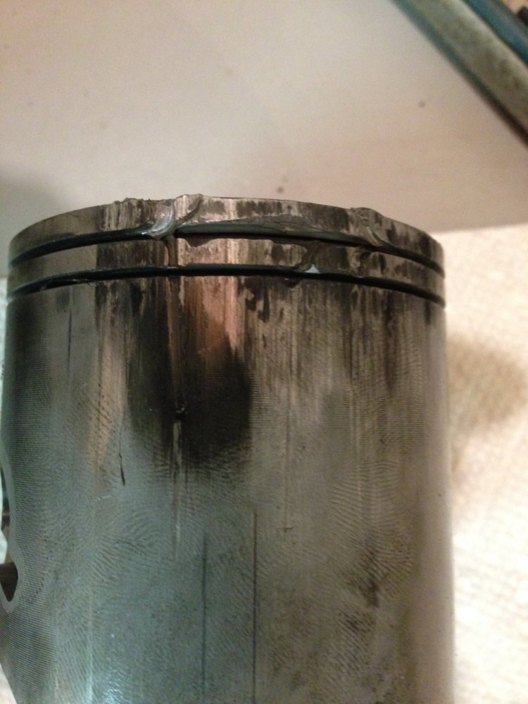

Last race the bike felt weak. It had 60hrs on it so it was due for rings so I pulled it apart for "preventative maintenance". Too late.
Bad fuel, detonation...bitch still pulled a holeshot and finished a 2hr hare scramble. Gotta love a 2stroke.
Ever try klotz super techniplate, or degummed castor oil? Stuff is amazing in 2 stroke engines. Run it exclusively in my chainsaws.. better lubrication, ring seal & anti wear properties than other oils. Other than the pinched ring land, I've literally saved seized saws that seized on non castor oils and won't seize on castor....
I used to run SuperTechniplate in my 125's. It's a great oil but for lugging to mid rpm use with short bursts at WFO around in the woods it has too high of a flash point and isn't burned optimally in those conditions. On a small bore that gets held WFO all the time it works great. Fortunately this one didn't seize. It actually kicked over and ran but was just weak right up until the moment I pulled it apart. This was a low octane detonation issue.

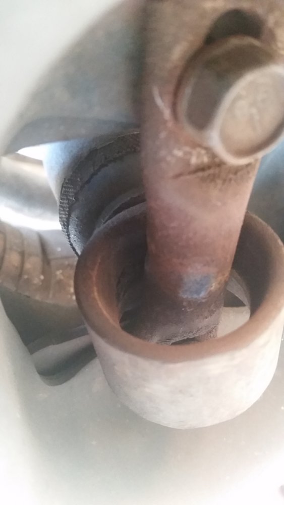

The driver's side wasn't much better. It got dark on me so I didn't get to the rear shocks. I expect they'll be about the same when I change them tonight.
Thats factory...just making it easier to pull the cab on that thing :D
And now the dilemma starts...
If I'm replacing one body mount, I should replace all of them.
And if I'm replacing all of them, I'll have the cab loose.
And if I have the cab loose, I should fix that oil leak.
And if I have the cab off and the motor exposed, I should "bulletproof" it.
And if I bulletproof it, I should put a new converter on the trans.
And if I have a bulletproofed engine with a good converter, I should turn it up more.
And if I turn it up more, I should get better turbos...
Guess I'll just replace that one body mount...
