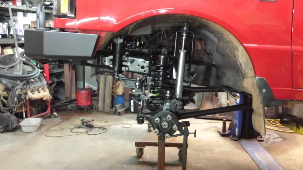

Not mine but I have been working on a 99 ford ranger that getting a solid axle swap with a 3 link.

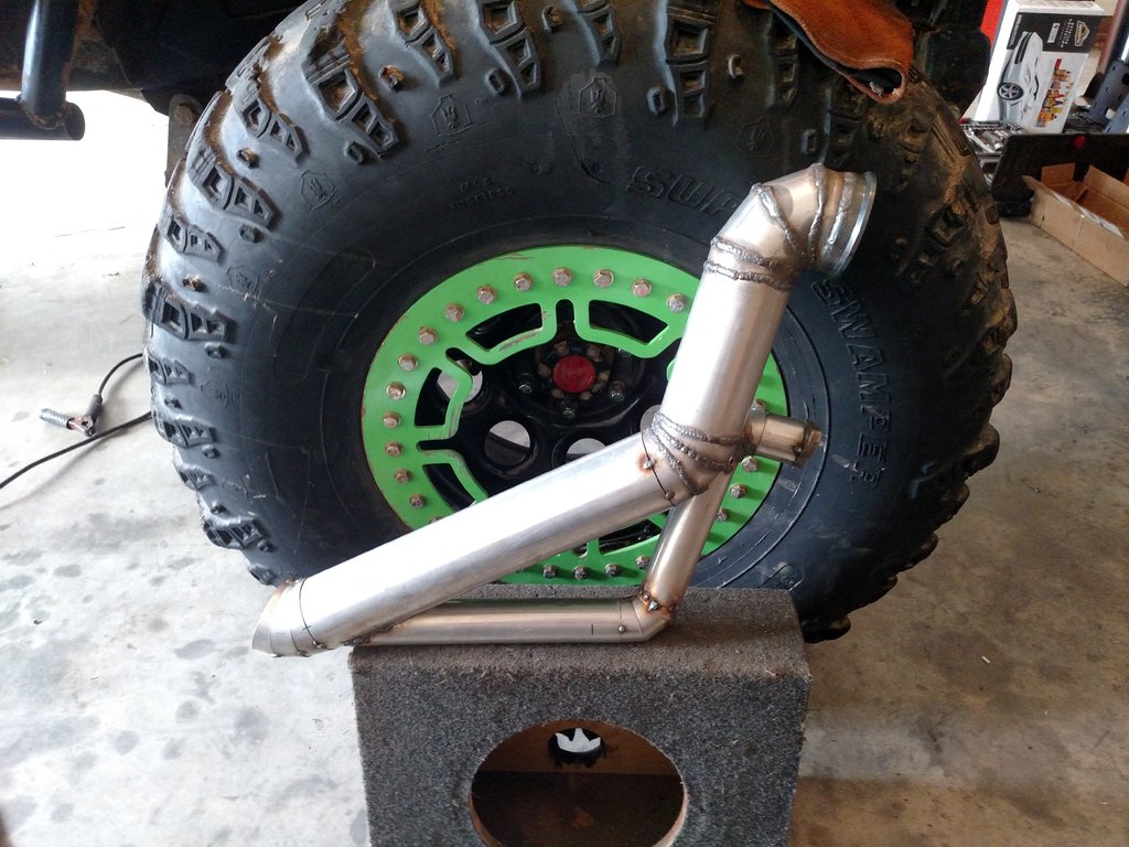

Got the charge pipe built and polished today.

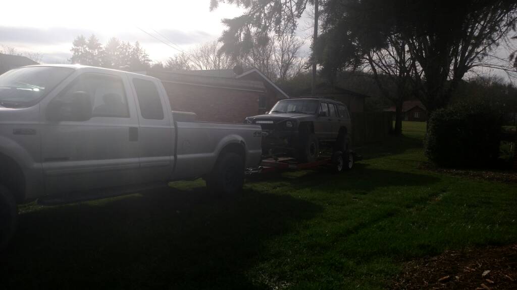

I pulled it out of the shop and used the winch to load up a Willys project onto my trailer. I then had to use it to pull my truck and trailer, with said Willys on it, out of the field because of the mud.

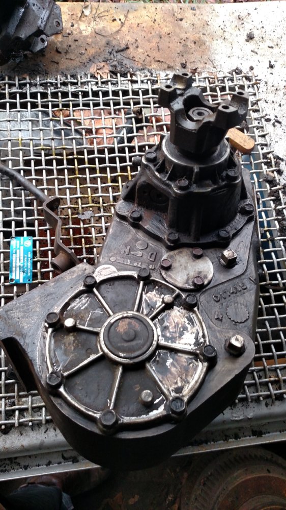

Started the cleaning process on the t-case that's about to go in it.

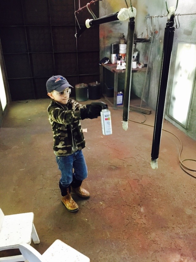

After a quick discussion about how every co-driver has to help out and earn their spot in the buggy, I got a lot of slave labor going on overhauling the fuel cell with some POR15.
And to add...
If you are running a fuel cell, I would recommend pulling it apart to check the inside as mine was VERY rusty. Another year and I think it would have rusted through and been trash... The inside of most (mine wasn't') likely isn't painted and will hold water and rust, really bad.
For new cells, I'd recommend pulling the shell off and painting the inside and adding drain holes.
