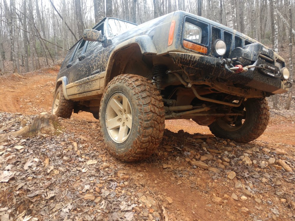

That's a pretty sexy XJ...as sexy as an XJ can be, anyway.
I'll likely get a set of 265 agressive all terrains for it soon. That's really about it aside from skids and armor.
I want a mild wheeler so my wife and I can both go with both rigs.
Also I'm dropping my Ranger off with @stinkbomb and NTK Fab next month for some sexiness, so I need a backup until it's done.

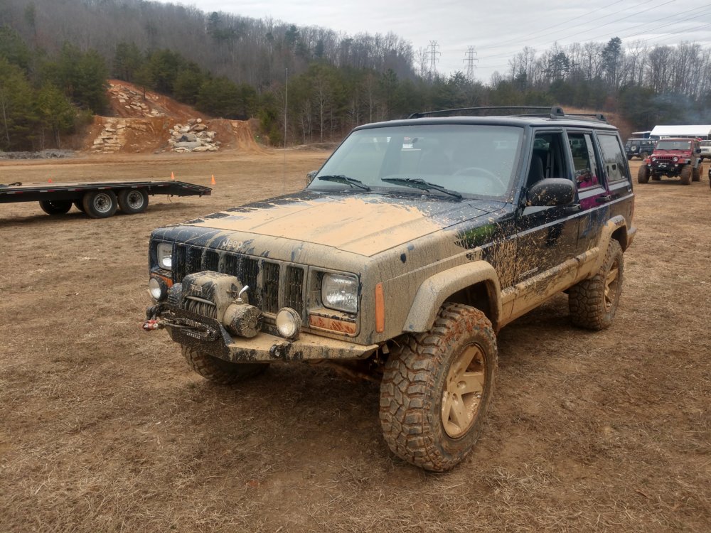

Drove it home!

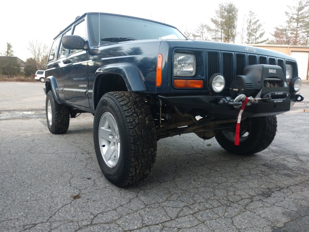

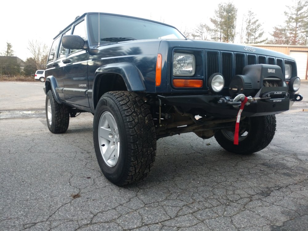

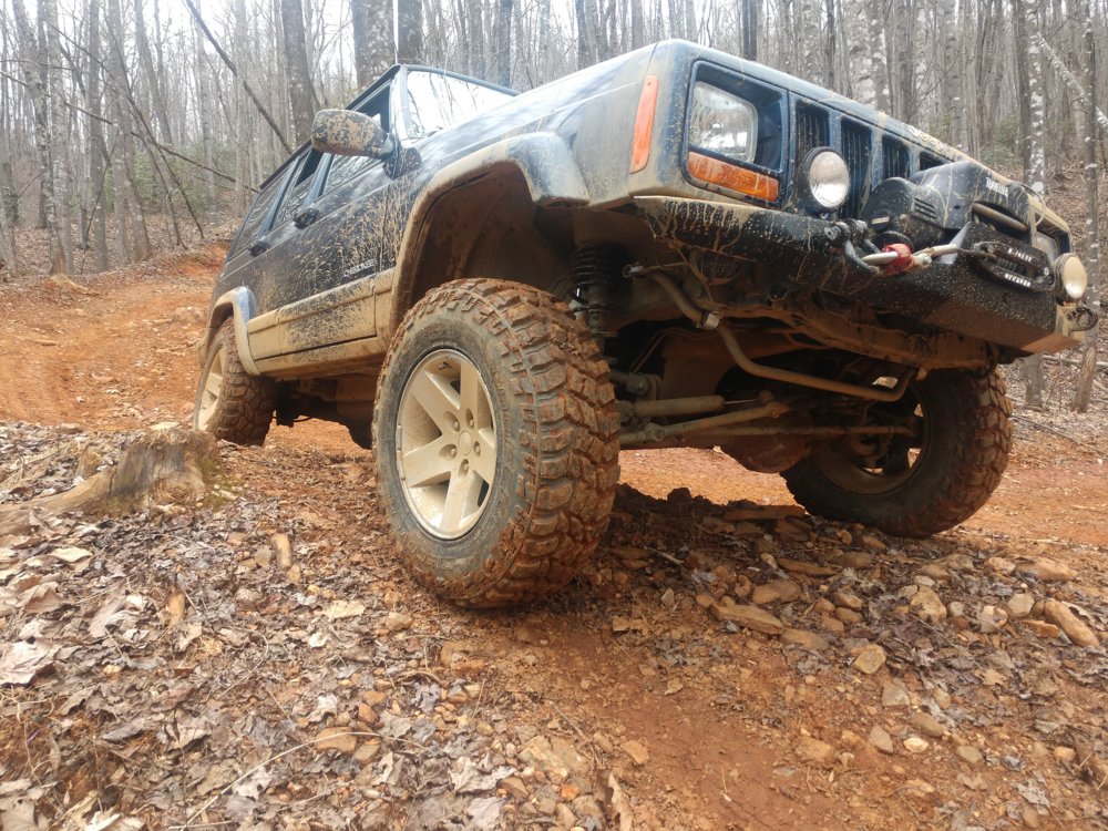

Took off the stock coils and spacer and replaced them with 3.5" Metalcloak springs. Some new Rubicon Express control arms, MC disconnects and @thebrotherinlaw's old RE track bar (new bushings).
Installed one of Ironman4x4 Fab's shackle relocation brackets along with a 2" AAL out back.
Cleaned up a bent and twisted front bumper, painted it and added a used TSC 8k winch.
Not a bad little DD/wheeler
Drove it home!

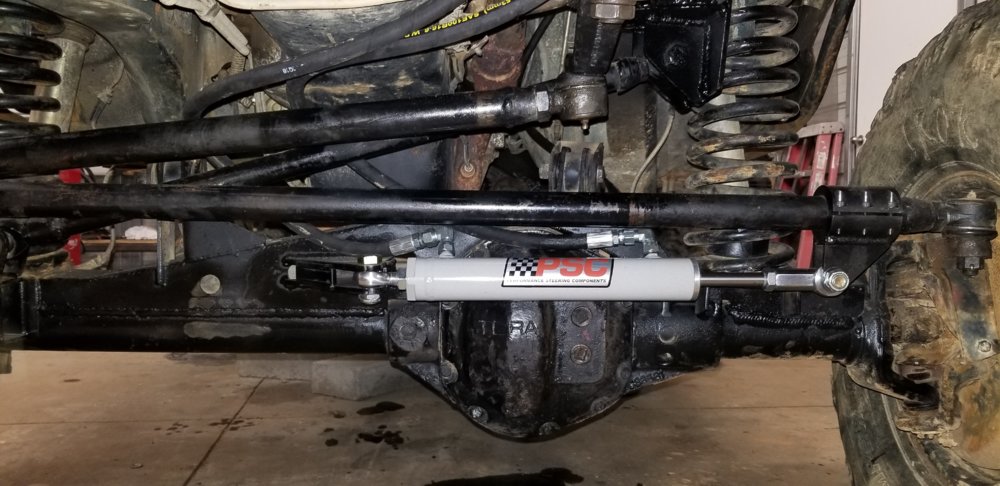

It's doing OK. But it's about to go under the knife at my shop.
Stickies, Racelines, full hydro, high steer, lowered a bit, revised link angles and mounts along with a custom track bar.
Time to make it perform a little better.

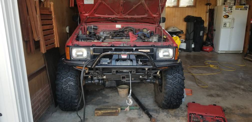

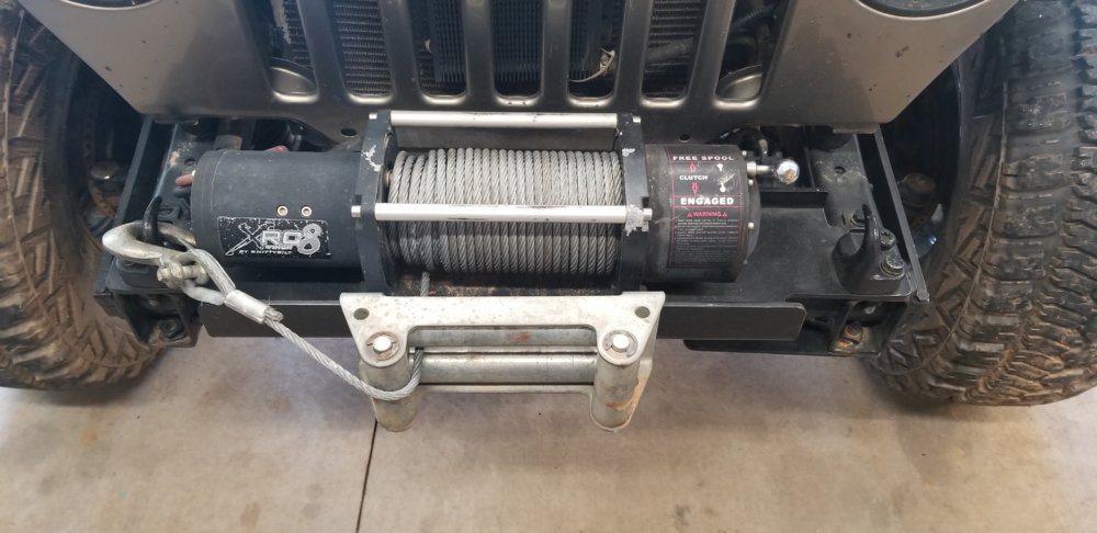

Finally spooled up the new cable, old one had quite a few bad spots.

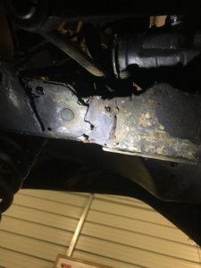

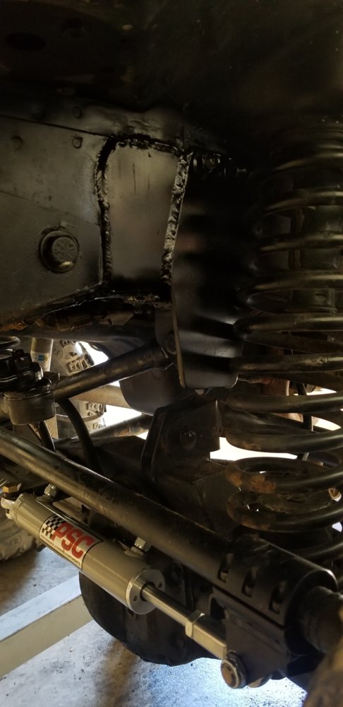

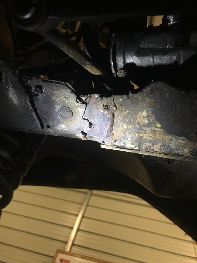

Also me and @adamk got @k5-1402 Jeep wrapped up Friday night. Old track bar bracket was trashed and the frame had a pretty large crack in it. Just waiting for the bumpstops to come in tomorrow to finish it up the rest of the way.
Pics of aformentioned crack(s)

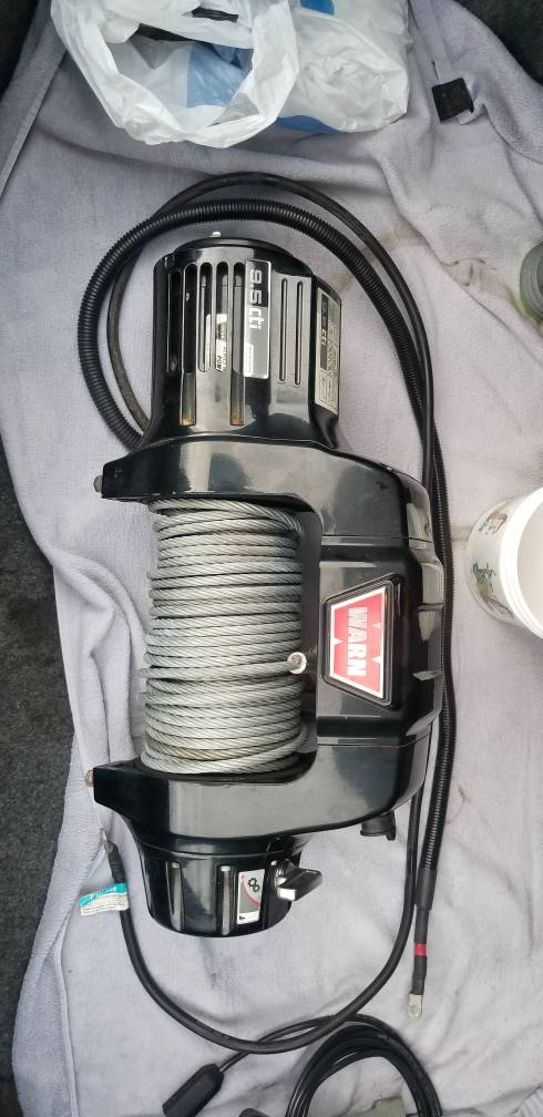

Picked up this new (to me) Warn 9.5cti this morning. Fo hundo sounded like a deal I couldn't pass up so left Charlotte at 445a and headed towards Raleigh. 5 hours round trip and back home by 1030a.
