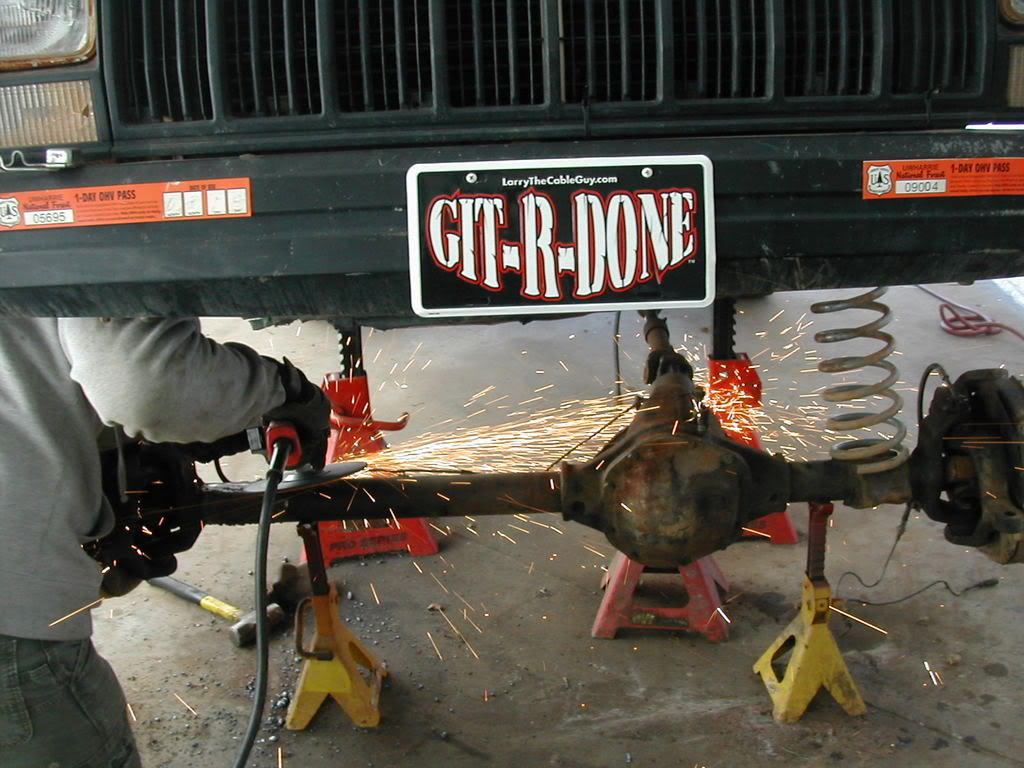

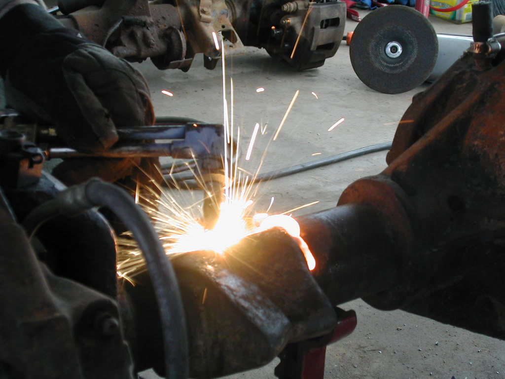

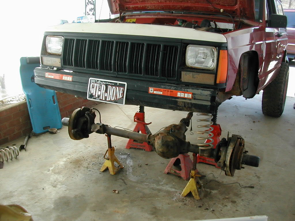

Here is the start of a beautiful thing. Putting a d44 and 9inch under the jeep. Thats the start of it. Building long arms and gonna extend the wheelbase. Makin it up as we go.

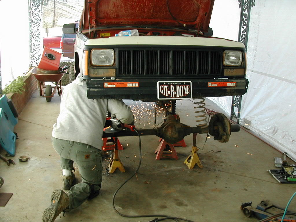

carport
i use what got. it keeps the rain out. thats all that matters.

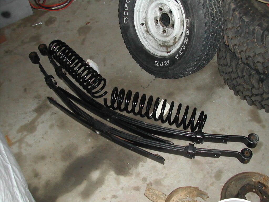

8 inch XJ coils and chevy leafs

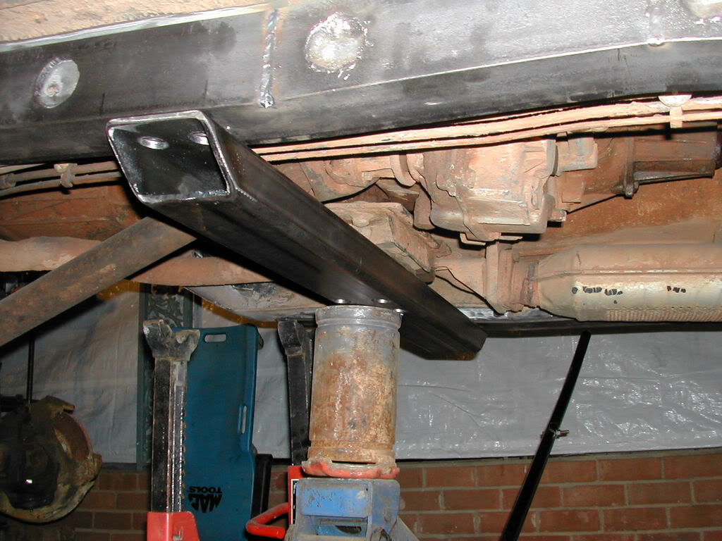

frame stiffeners

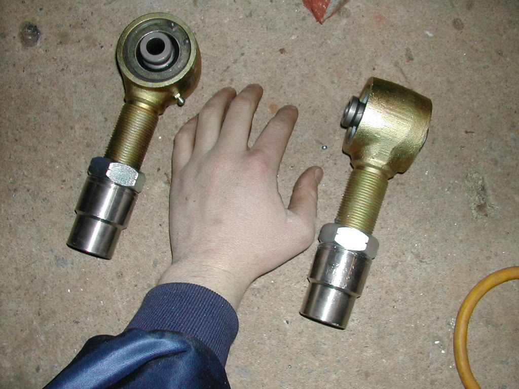

johnny joints

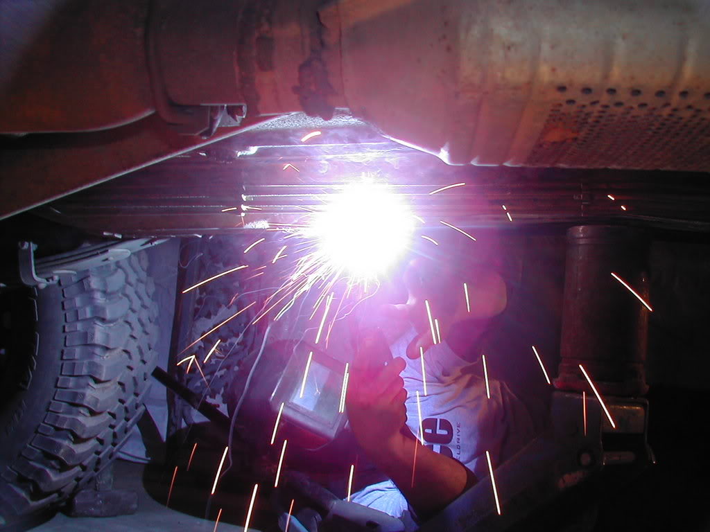

Tim welding up the stiffeners.

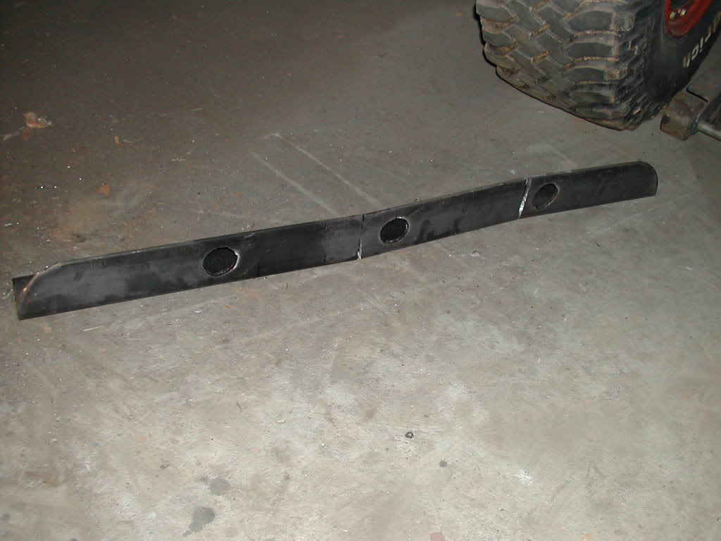

New crossmember.

Damn man, gloves and a welding jacket...or at least long welding gloves. I can only imagine how bad that sucked. Otherwise it really looks good.
Just like normal leafs. They're just longer, which means more flex.
