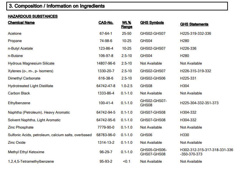

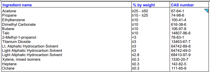

Maybe there's some chemistry geeks who can look at these ingredient lists and chime in?
Krylon
Rustoleum

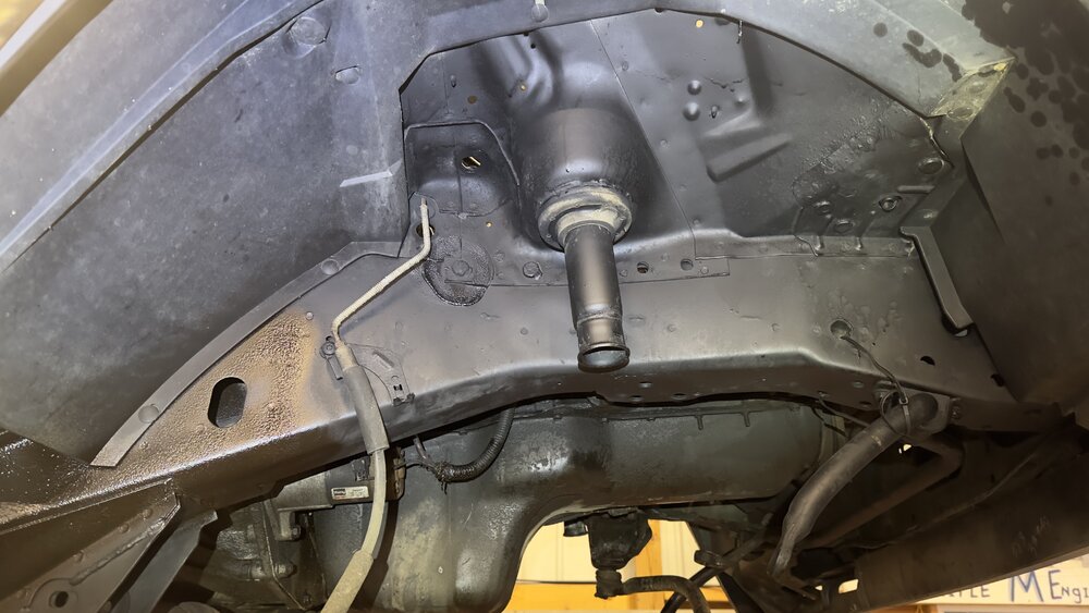

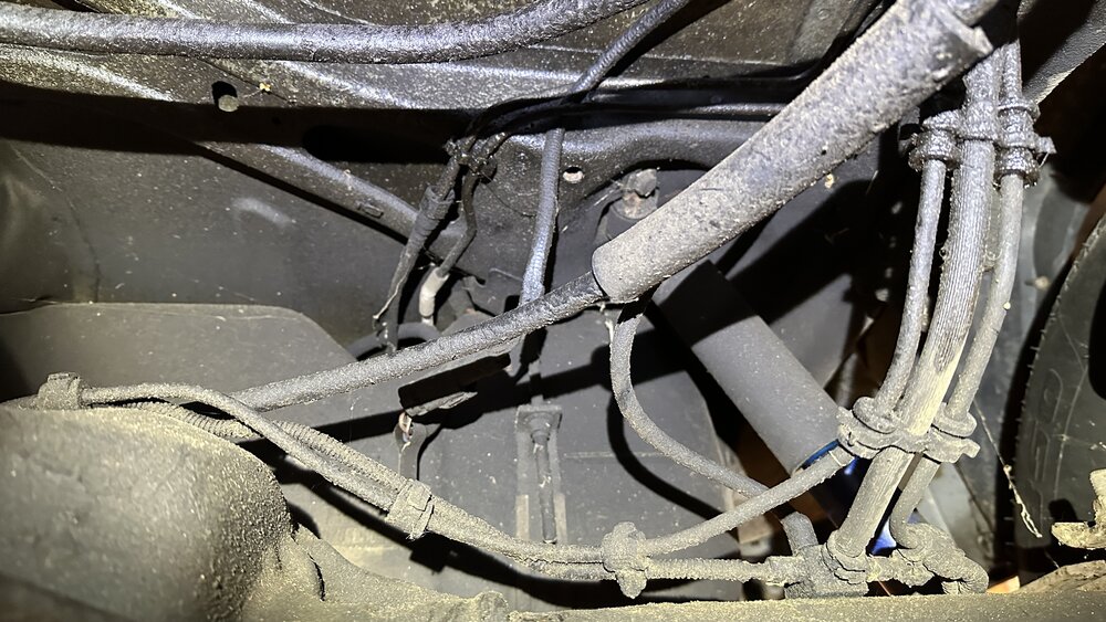

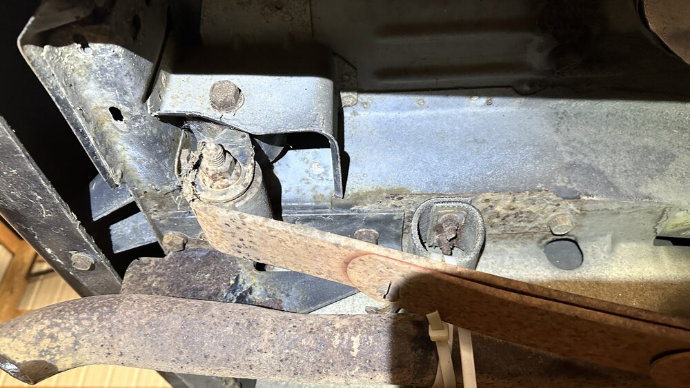

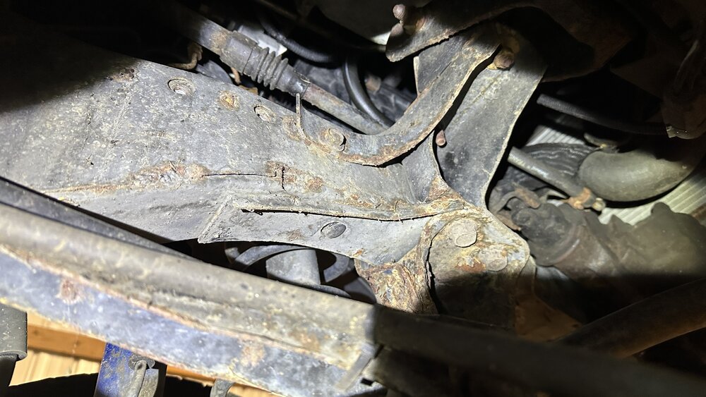

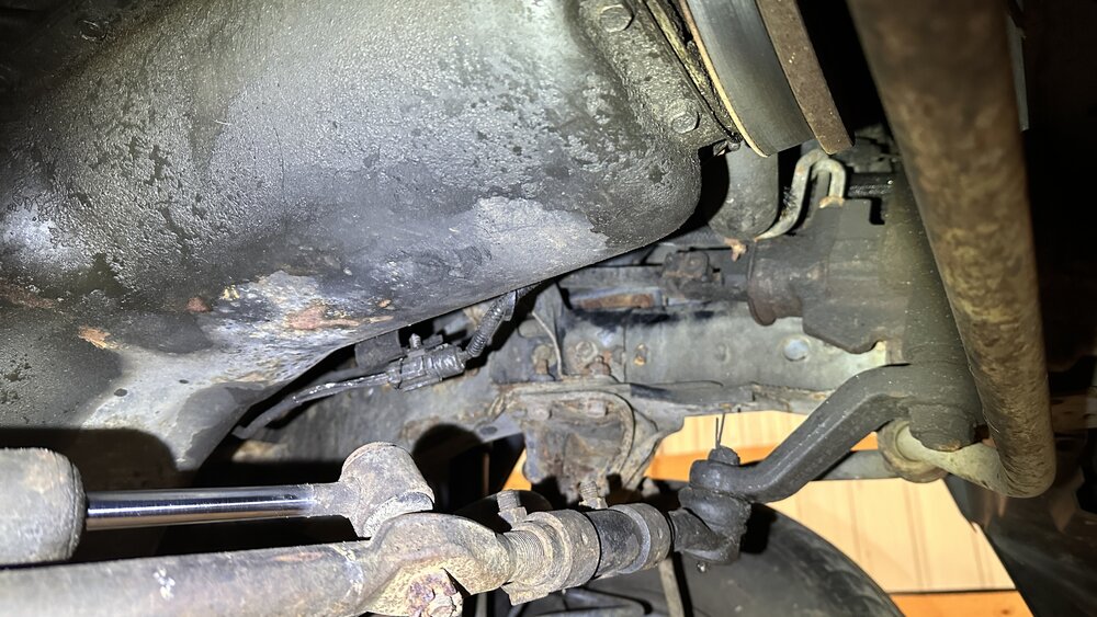

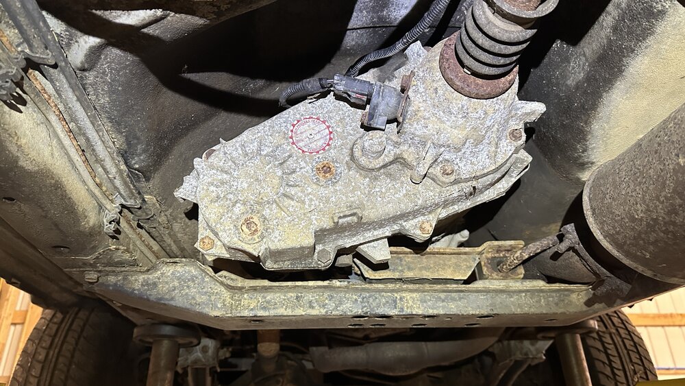

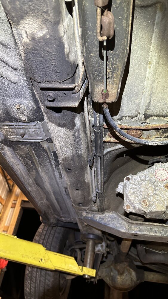

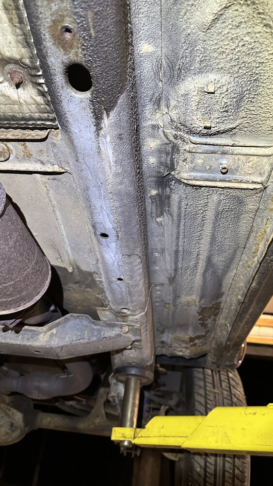

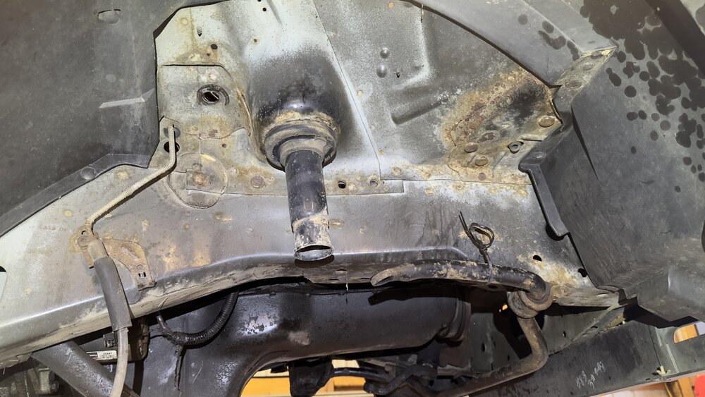

Finally got it up on the lift and got a chance to really check the underside out. Gotta say after the disappointing passenger floorboard, it was refreshing to not find anything unexpected on the bottom side.
View attachment 412766View attachment 412767View attachment 412768View attachment 412769View attachment 412770View attachment 412771View attachment 412772View attachment 412773View attachment 412774

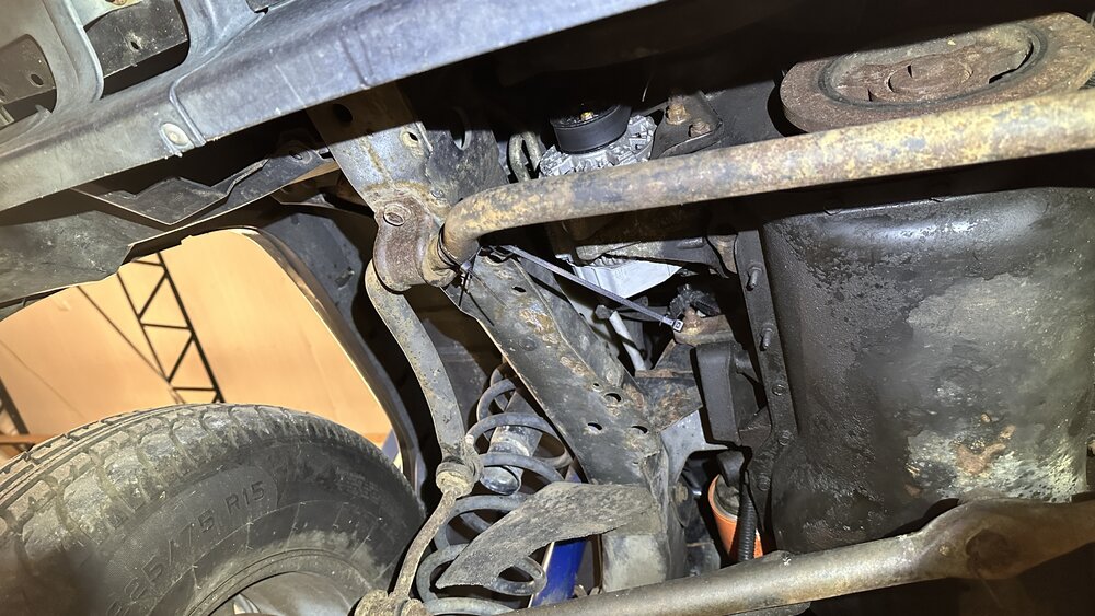

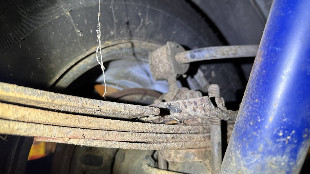

Also figured out why the left rear was sagging more
I still need that spring pack. Even if it’s broken! :D

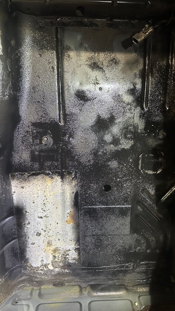

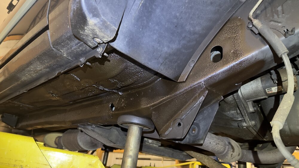

Changed the oil tonight, and got the floor pan derusted to the best of my patience (which was about 5 minutes :laughing: ) and painted.
There’s one spot on the right side of the front floor that busted through with heavy wire brushing, but it’s only about an inch wide and everything else is pretty solid, so I’ll probably just drill it out and put another drain plug there :D

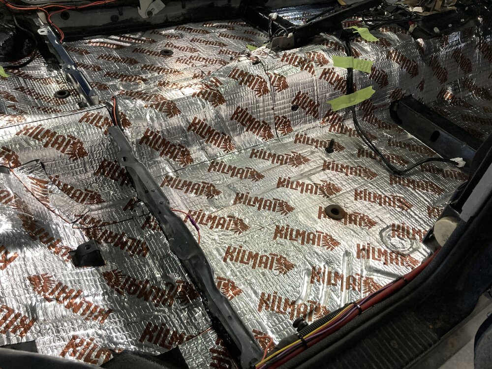

i will say that if you want to block heat the stick on butyl stuff is only marginal in helping. Its aluminum backer so it heats up too. Use dei boom mat light or something similar. The trans tunnel on xjs get super hot and i felt no difference covering my floor with the stick on stuff. The dei boom mat made a huge difference

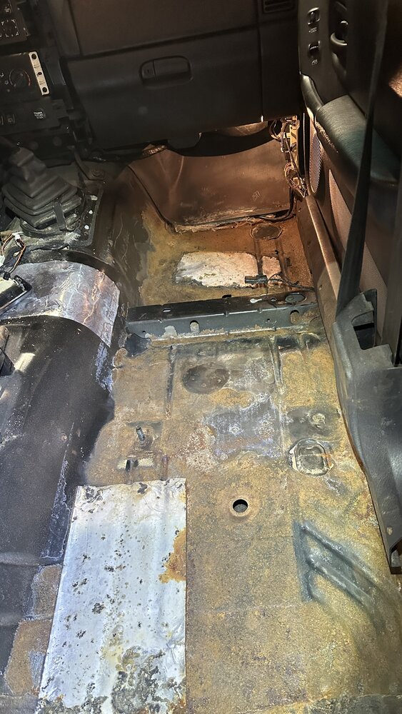

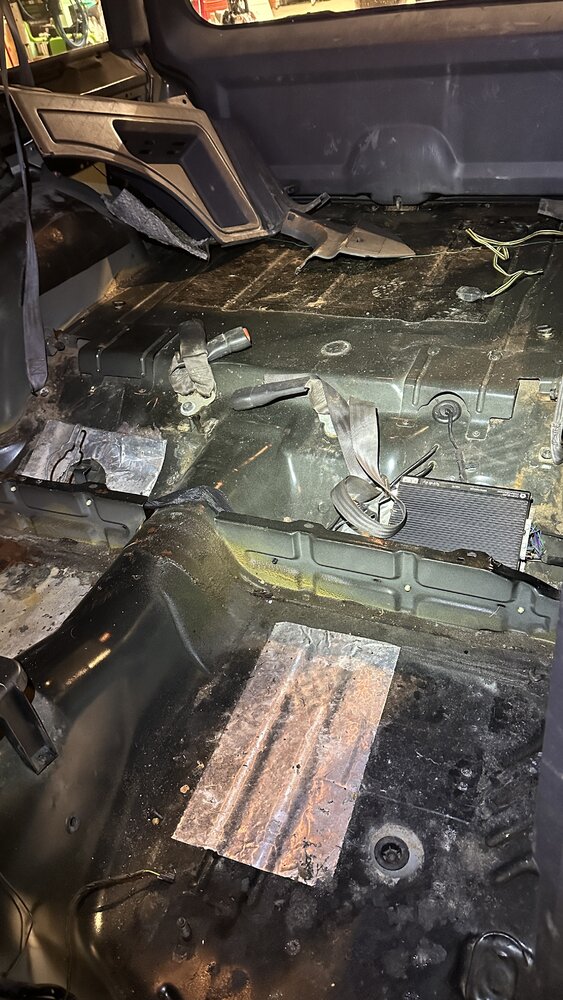

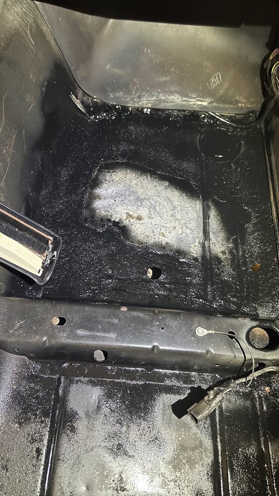

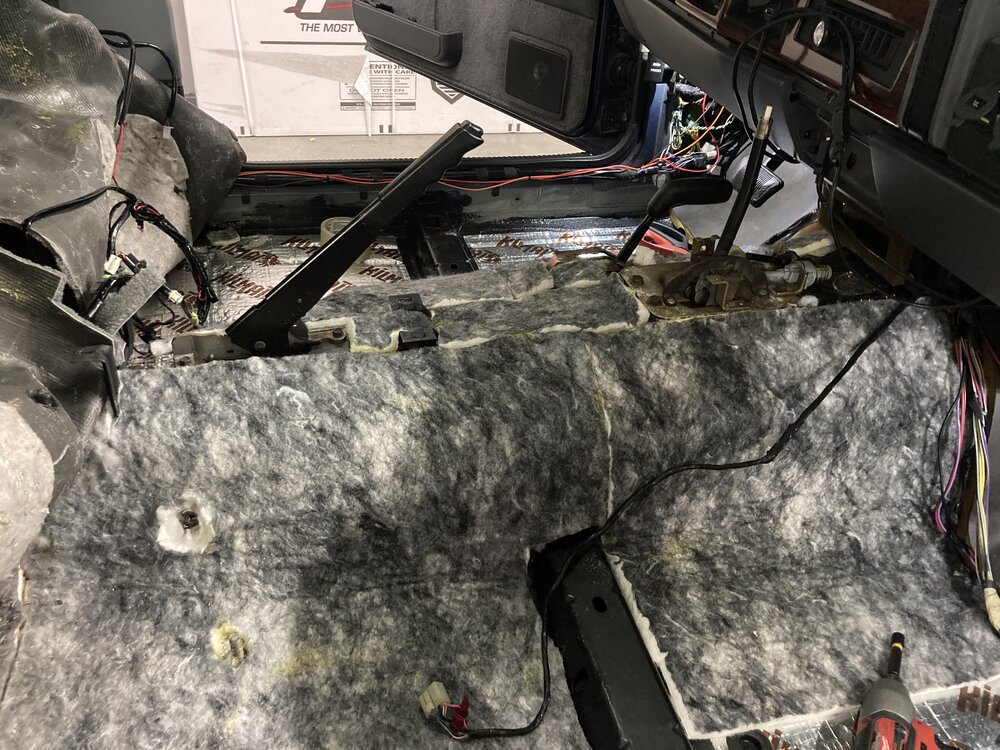

Finally got all the carpet out. Gonna just order new carpet since it’s only $265 from Rockauto for the premolded color correct full set. Back floor looks great.
Drivers side looks great

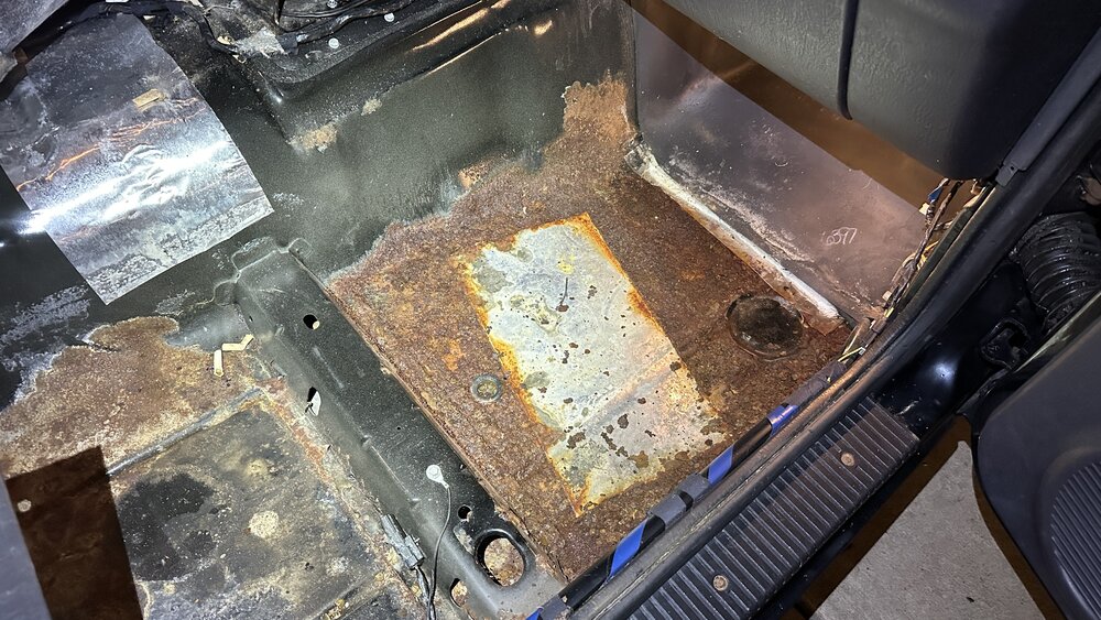

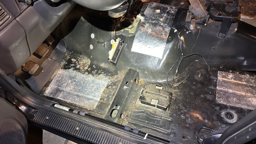

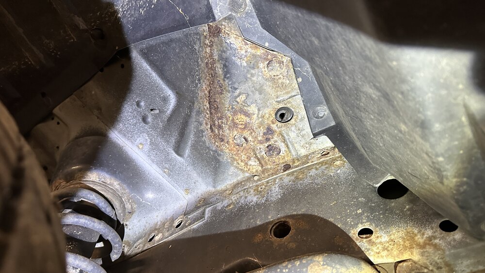

Passenger side looks just great…
Oh well, can’t all be dreams and rainbows. I bet this means it needs a heater core too, and would explain the “steam” from the vents the other day…
I’m pretty sure there’s enough metal left to wire brush it and put a fresh coat of paint on. And the heater core will certainly be easier with the seats and console already out. We will see!
While it’s exposed, cut an access door with hinges for a fuel pump replacement if you ever need to do it. Just cover it with the new carpet and nobody will know.

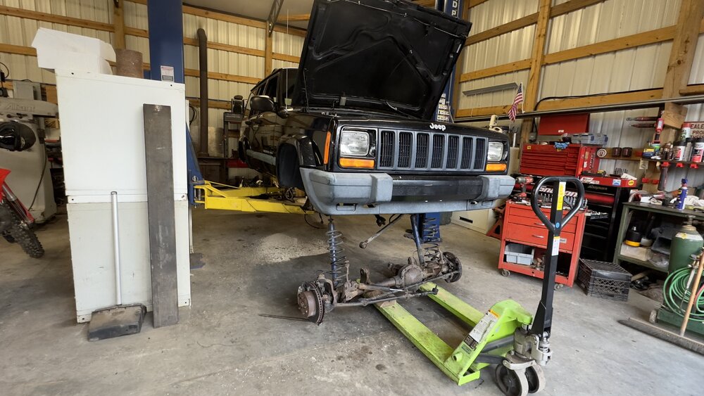

Started pulling the axles tonight.

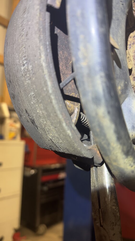

Getting the ebrake cables loose required disassembling the drum brakes, which was just annoying. But the biggest challenge has been getting the leaf spring and shackle mount bolts out. Fortunately they are all moving and not seized or broken. The front ones are finally to the point they will spin out with the big M18 impact. The rears don’t have enough access and are still too tight anyway. But doing 1/6th of a turn at a time with a 30” breaker bar fighting it snapping and releasing the whole way SUCKS.

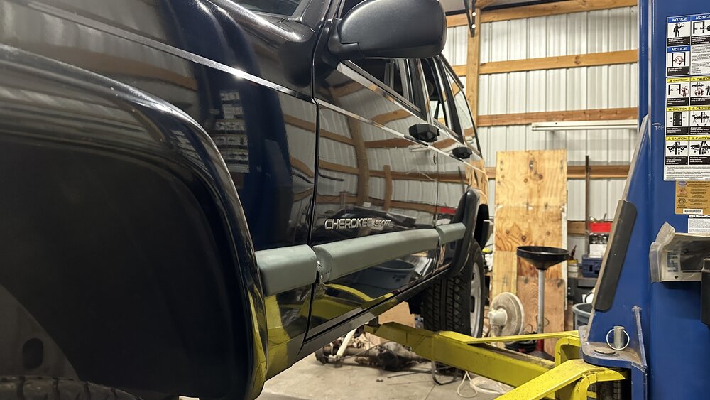

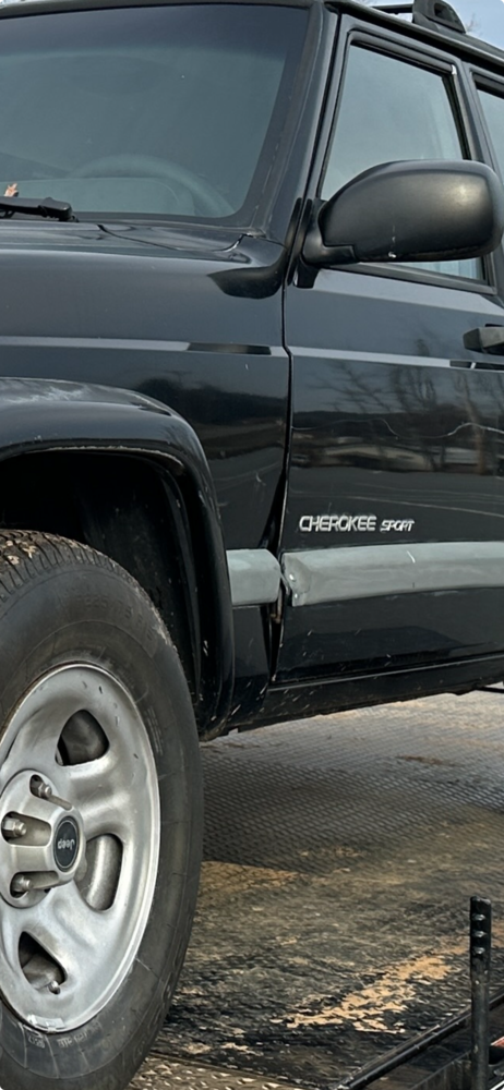

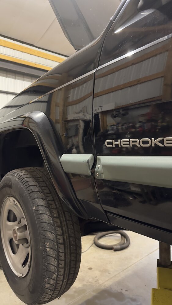

I also spent a little bit of time tonight working on the dent where the front fender meets the driver door. I didn’t get a good “before” pic but you can see it here:
I’m super pleased with how it came out with just a little bit of amateur effort. :D

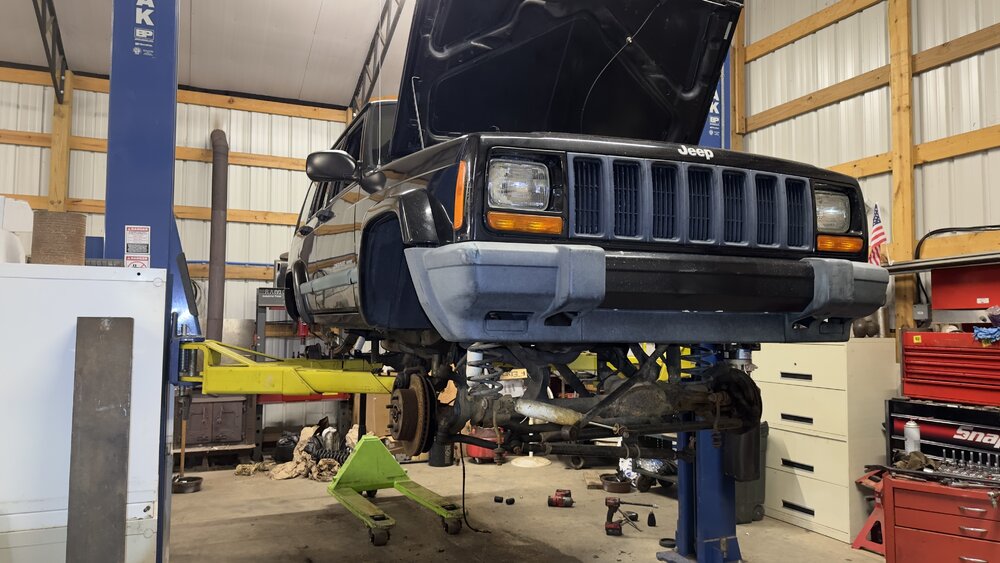

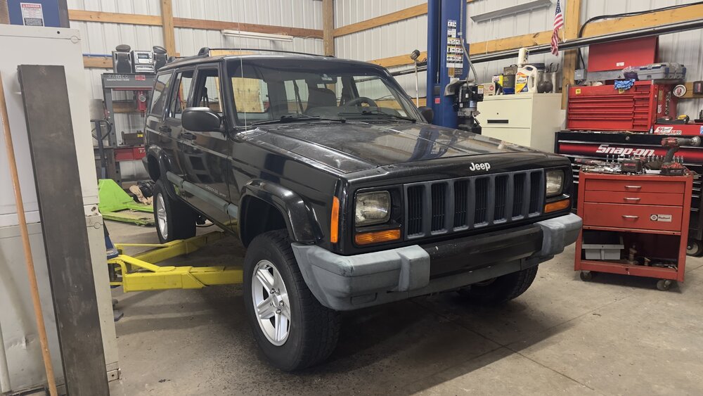

Got the 3.07 geared D30/D35 out today.
Let her hang out naked for a bit :D

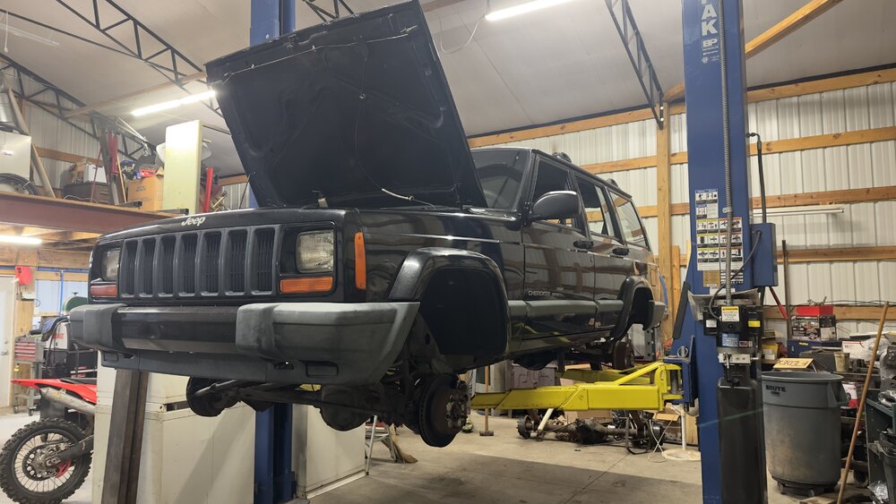

Then got the 3.55 geared D30/8.25 hung with the 2.5” springs and shocks. Put new shackles on the rear too since they were new in a box in the box the jeep when I bought it.
I also wire brushed any rust spots on the underbody
And put a coat of Rust Reformer on everything.
I also recoated the rubberized undercoating since I had 2 spray cans sitting on the shelf.

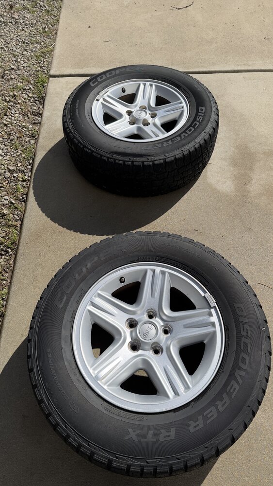

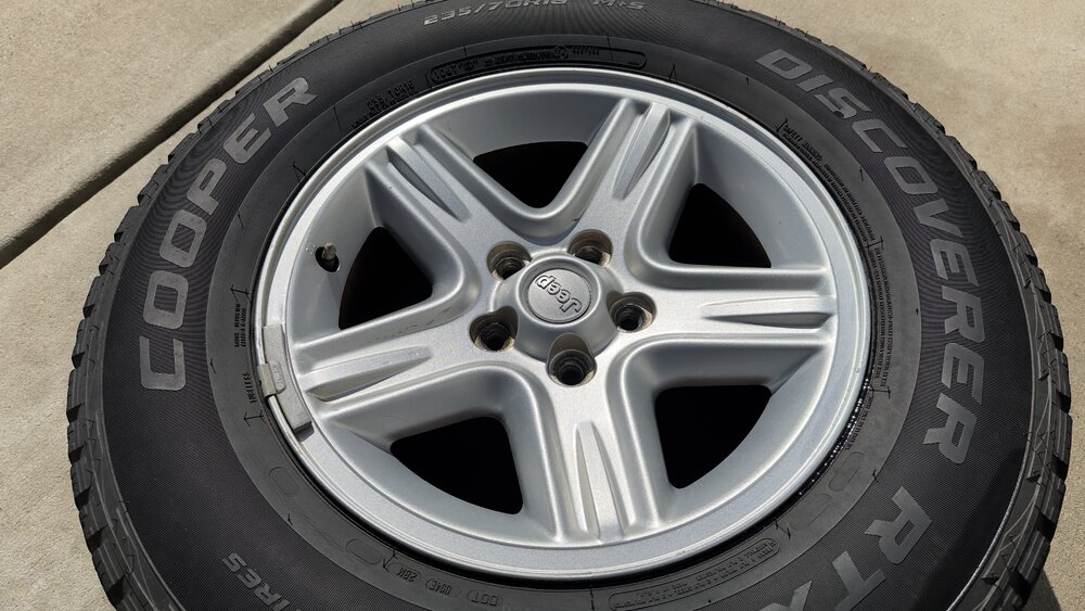

Got the wheels cleaned up.
Looks like original paint in darn near perfect condition :D

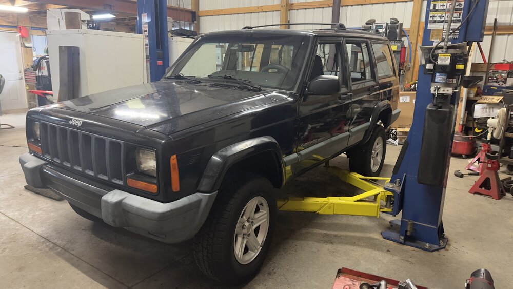

Finished getting the axles in this evening. Still need to button up a few things, but it’s back on its own feet.

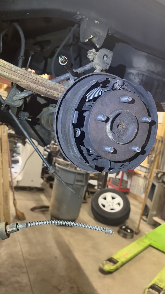

I managed to accomplish something I’ve never done. Maybe it’s a big deal, maybe not. I got the old ebrake cables off and new ones on, without disassembling the brakes.
(I did pull the retaining pin on one side so I could reach behind to get the cable on.)
The next thing to sort out is the rear looks like it’s sitting a good 2-3” higher than the front. :rolleyes:
