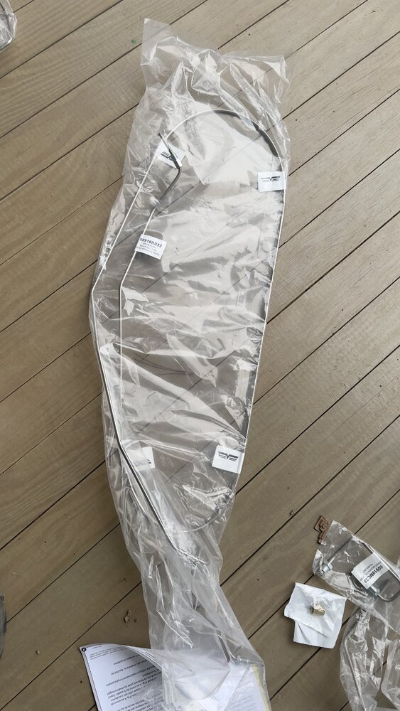

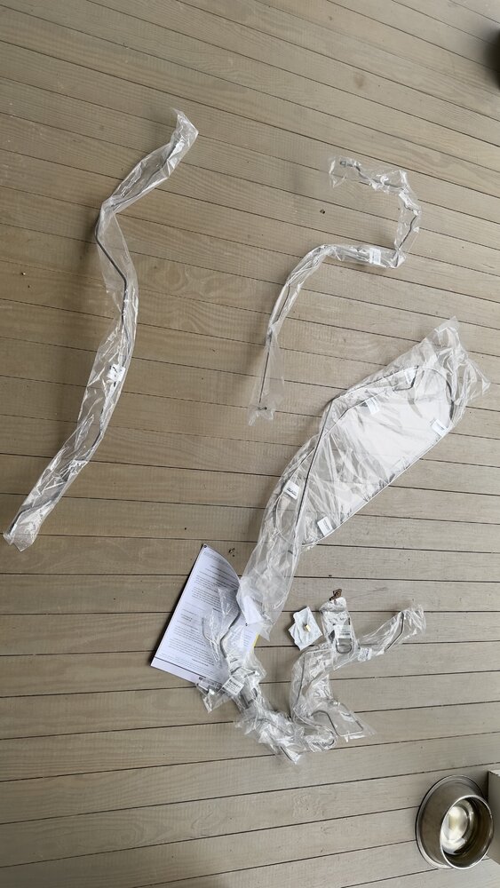

You can get a full set of stainless prebent lines for around a hundred bucks.

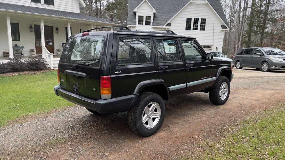

Your lift experience is par for the course, a 2.5" spring nets about 4" of lift for whatever reason.
Loosened the shackles tonight and set it down, didn’t seem to make any difference. Also even sitting and bouncing on the tailgate didn’t seem to generate much movement, so I think the springs are just super stiff.

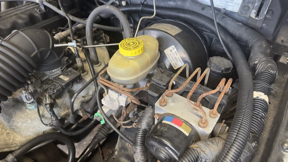

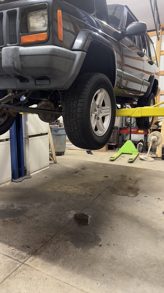

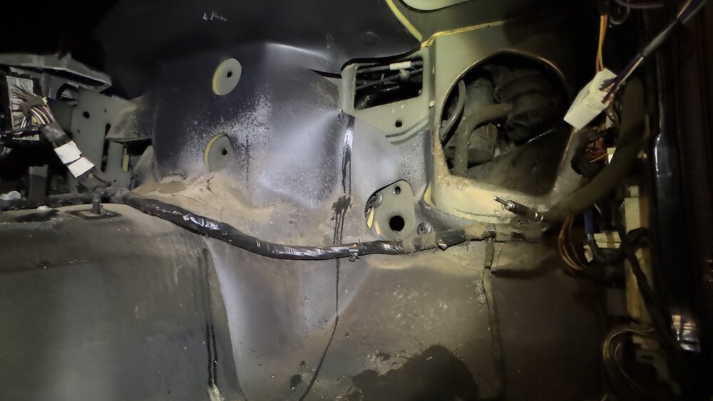

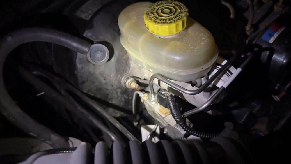

Next step was to bleed the brakes. I pumped em and the pedal never seemed to materialize, but when I got out to check fluid level I saw this…
Looks like one of the lines has rusted through. There was an odd paintless spot in the same area, and I’m guessing it’s because a pinhole leak was spraying every time you put on the brakes. Sucks, but rather find it now than when driving down the road and the brakes fail.

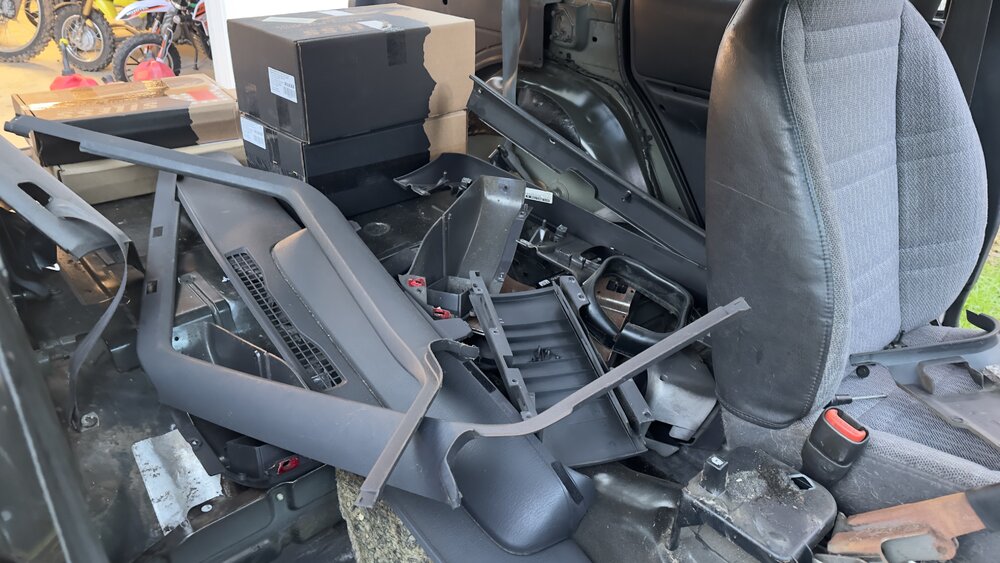

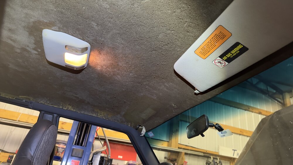

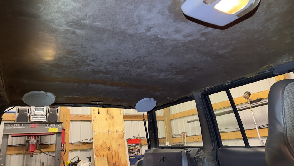

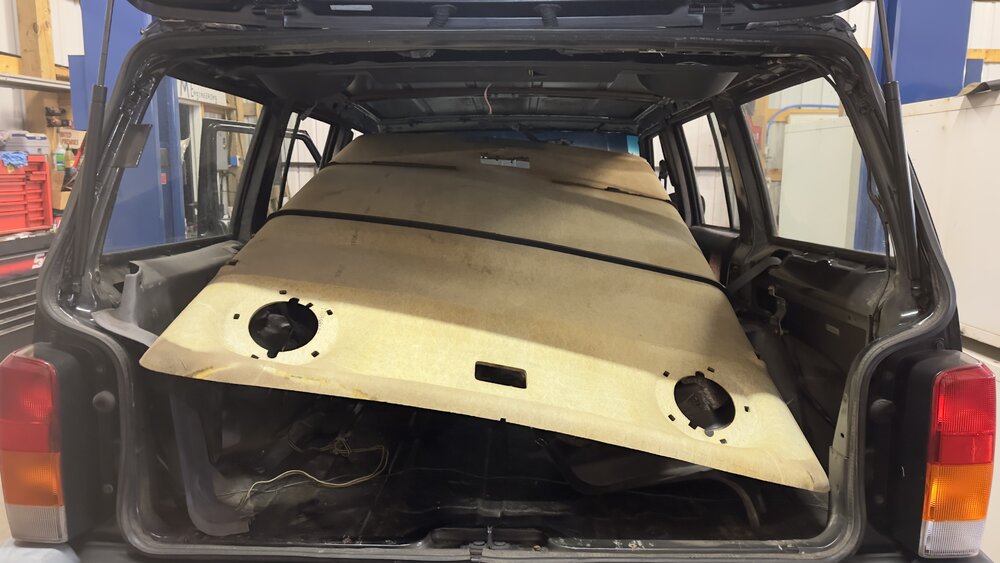

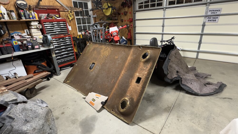

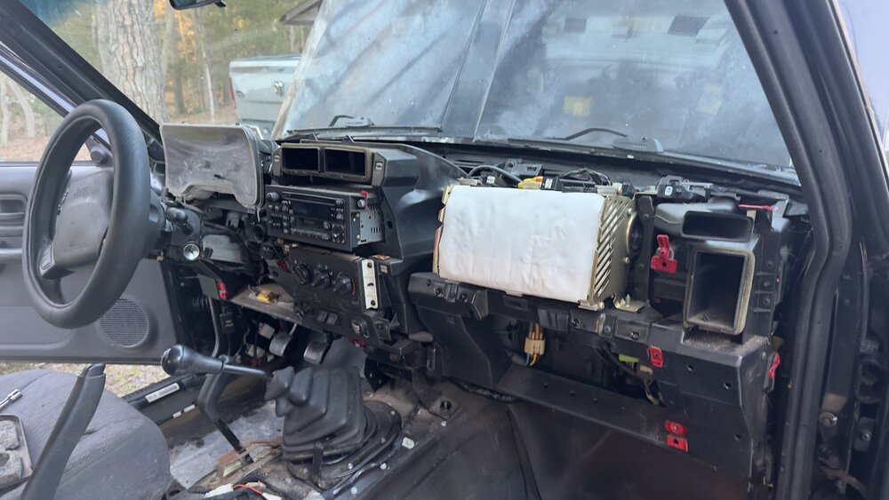

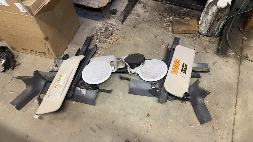

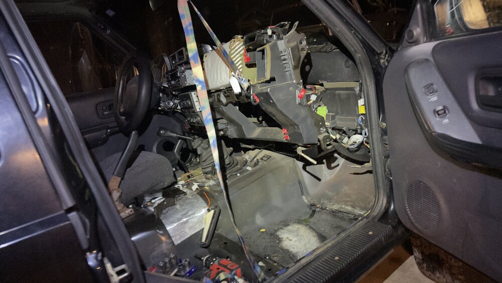

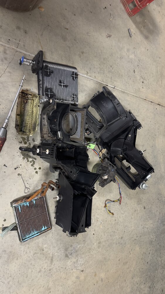

Since that was a bust, I set about removing the headliner and managed to get it out without much issue and no damage.
View attachment 413265View attachment 413266View attachment 413267View attachment 413268View attachment 413269
Jesus this progress is crazy. I feel like I’m watching a show on discovery.
Or you’re just compact weight sized :D
An empty XJ is going to be pretty light in the back. A full tank of gas and the entire interior should put some weight back there. A little bit of cargo and it should settle. Don’t give up on it yet.
rockauto, amazon, parts store
DORMAN 919236

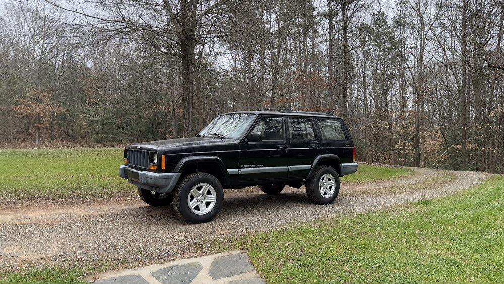

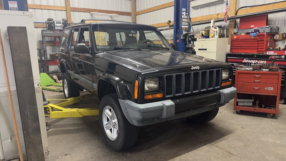

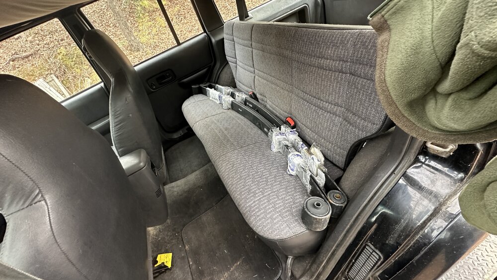

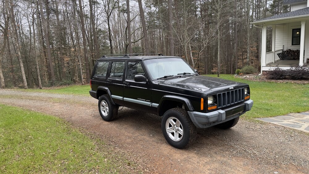

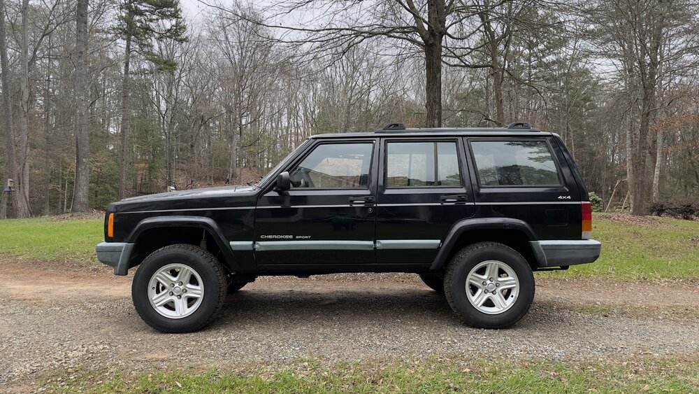

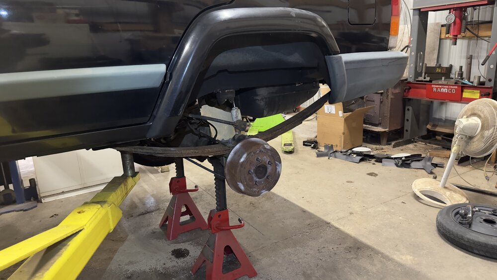

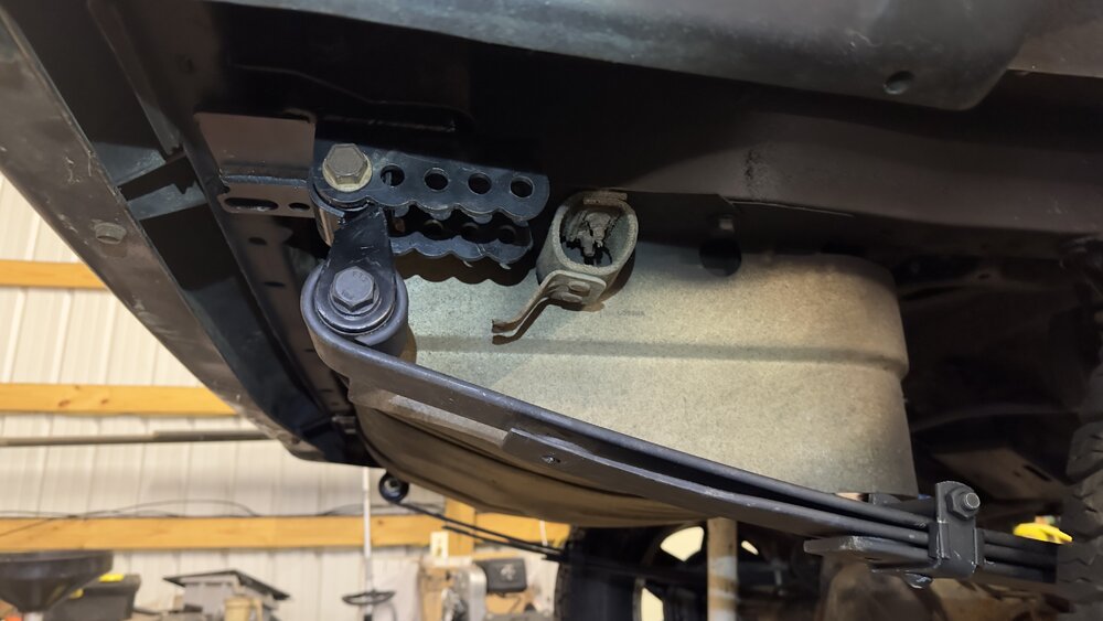

Tonight I did a little bit of measuring, and it was sitting over 2” higher in the back, so I decided to ditch the 2.5” leaves and install the shackle relocation kit. Conveniently…
the jeep came with a brand new set of stock leaf springs in the back seat when I bought it, so I figured that would compliment the shackle relocation nicely.
While I had the wheels off again, the first order of business was to paint these drums so I didn’t have to be reminded that the PO painted the old wheels on the jeep.

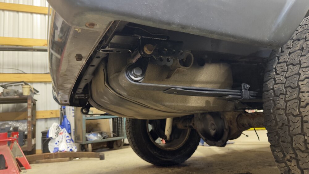

Shackle relocation kit installation was fairly straightforward, especially since I had already broken everything loose and swapped springs. I decided to go with the last hole for now.

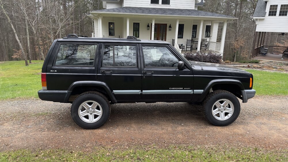

Unloaded
Loaded
I may decide to move it forward one hole, but itll be fine for now. I’ll get the rest of the bolts in when I reinstall the receiver hitch, but I flicked the spring and said “that ain’t going nowhere” so I’m sure it’s good for now. It sits about 3/4” higher in the rear now, which is perfect in my opinion. Once I get the interior back in, I may need to raise it up a little, and if so, I have a set of IRO multi height shackles ready to go.
Before
After
Before
After
Hopefully the brake lines come in tomorrow and I can get the mechanical part wrapped up enough for a test drive.

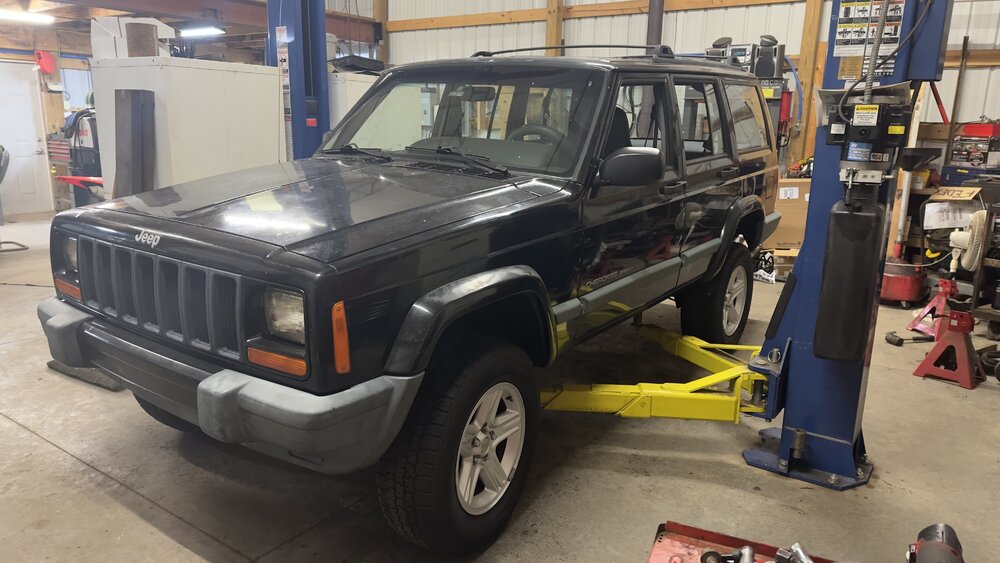

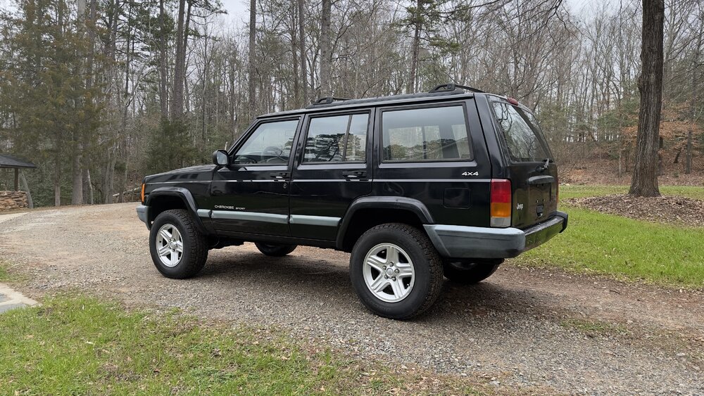

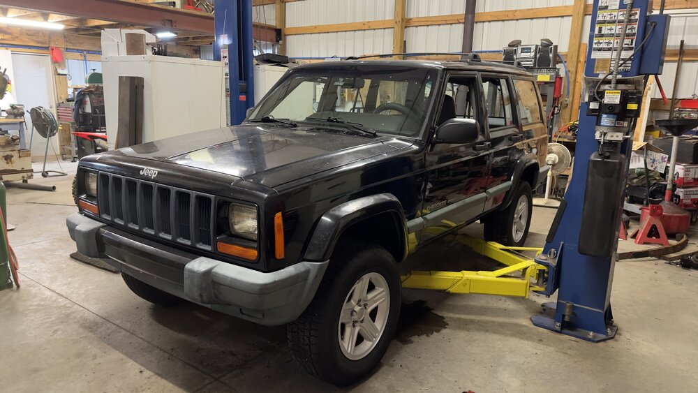

@jeepinmatt I decided to catch up on this and see if you needed anymore parts, I'm amazed at how different these parts are going on your jeep vs how they fit on mine lol. My rear was almost too low with that setup and an empty jeep. Hence the reason for having those shackles.
@jeepinmatt I decided to catch up on this and see if you needed anymore parts, I'm amazed at how different these parts are going on your jeep vs how they fit on mine lol. My rear was almost too low with that setup and an empty jeep. Hence the reason for having those shackles. View attachment 413329
That is pretty crazy how different it sits. Maybe once I put the rear seat and carpet in, it’ll come down a bit 🤷‍♂️
Yeah man I could totally use the rear hatch, doors, front fenders, hood, grille, and fender flares! :D I’d love it if mine was Patriot Blue.

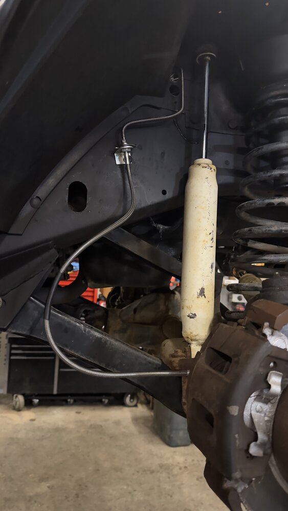

Getting all this off was fun, but at least none of it rounded off.

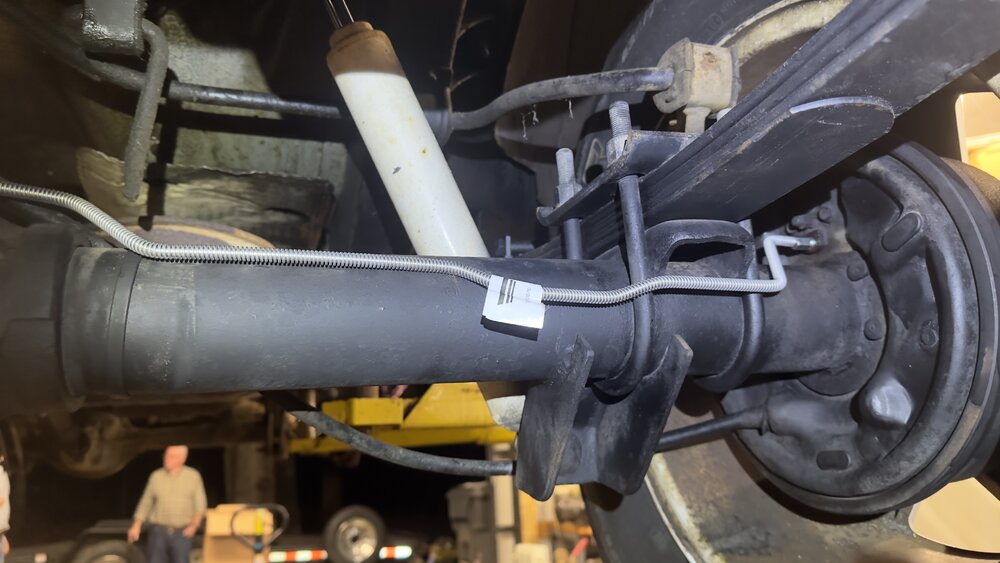

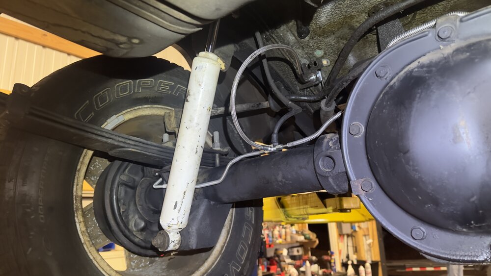

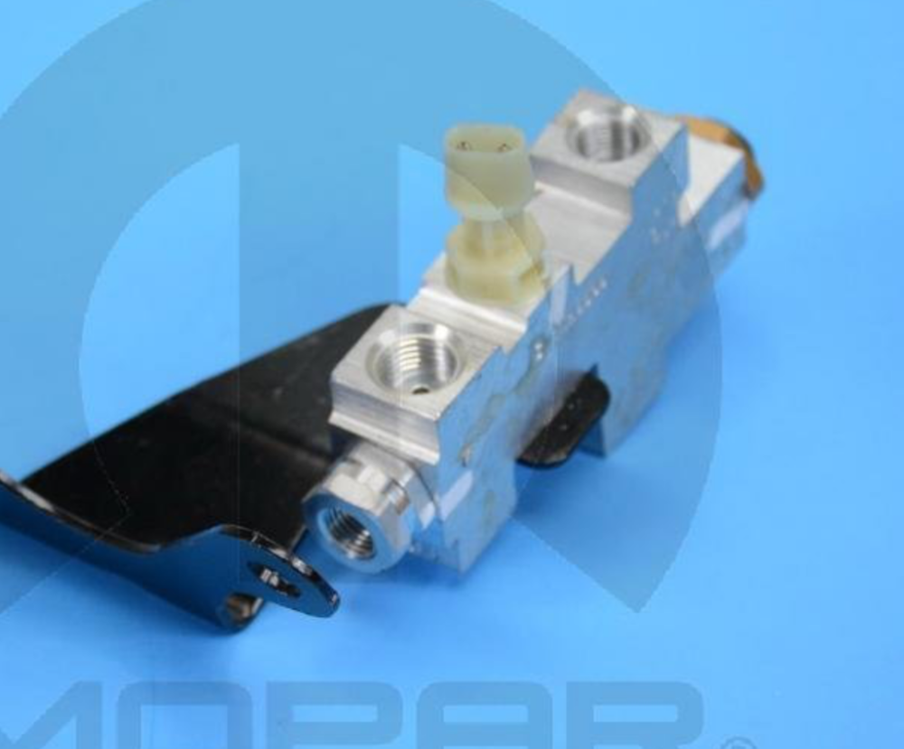

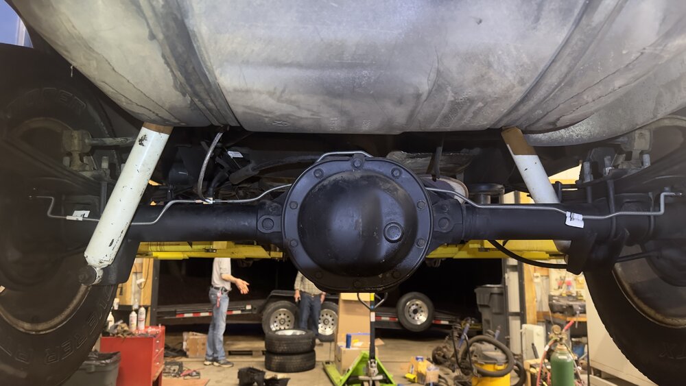

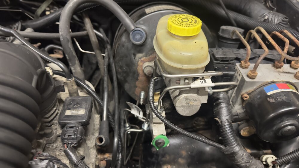

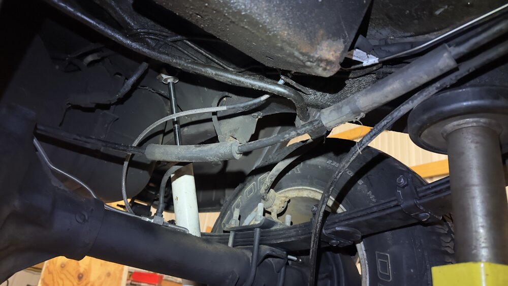

Got all the lines run. Front is done, except the SS brake lines are too wide to fit inside the alignment tabs in the caliper, regardless of orientation.

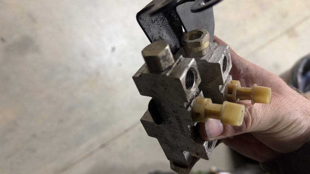

I guess I need a different proportioning valve, since the ABS on only has 1 line for the front to feed the ABS module.
Rear is 100% done and turned out great.
Actually I’m wondering if the fitting in the back that is currently blank is supposed to be threaded for the 2nd line since that’s where the line wants to go. Anybody with a non-ABS XJ confirm?
Yes on line is for the front disk and the other for rear drum. The rear drum has a thing, idk what it’s called, that holds the fluid in the line for the drum cylinder.

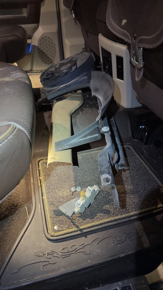

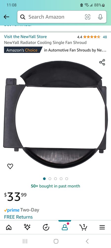

You are missing the bottom half of your fan shroud. They can be had for 30 bucks on Amazon.
