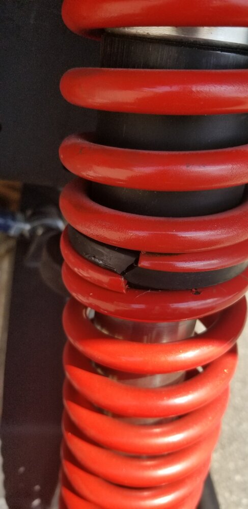

I might have lifted front off the ground few inches playing around in 2wd so is that what done this or .....cause how I unintentionally have the springs
Looks like it's just from how the springs are oriented. However, that should not cause that kind of failure unless they are using brittle plastic for the sliders.
Also, not sure when this pic was taken or the state the suspension is in, but the slider is obviously against the dual rate stop. Did you move this down since your last posting of everything being as high as possible and the rear not flexing?
Yeah I moved them down to touch at ride height just to see what it would do and big difference. I'm guessing cheap plastic, spring orientation and having a little too much fun might have broke that.
