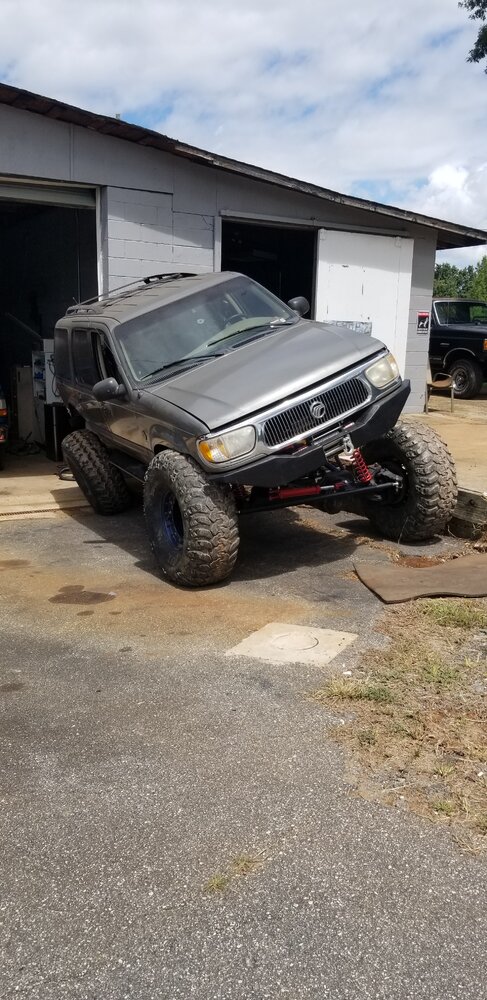

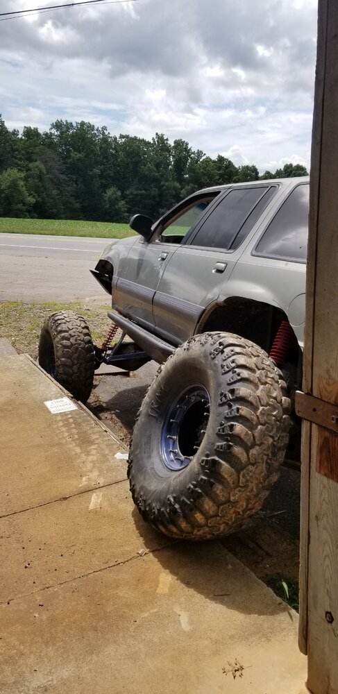

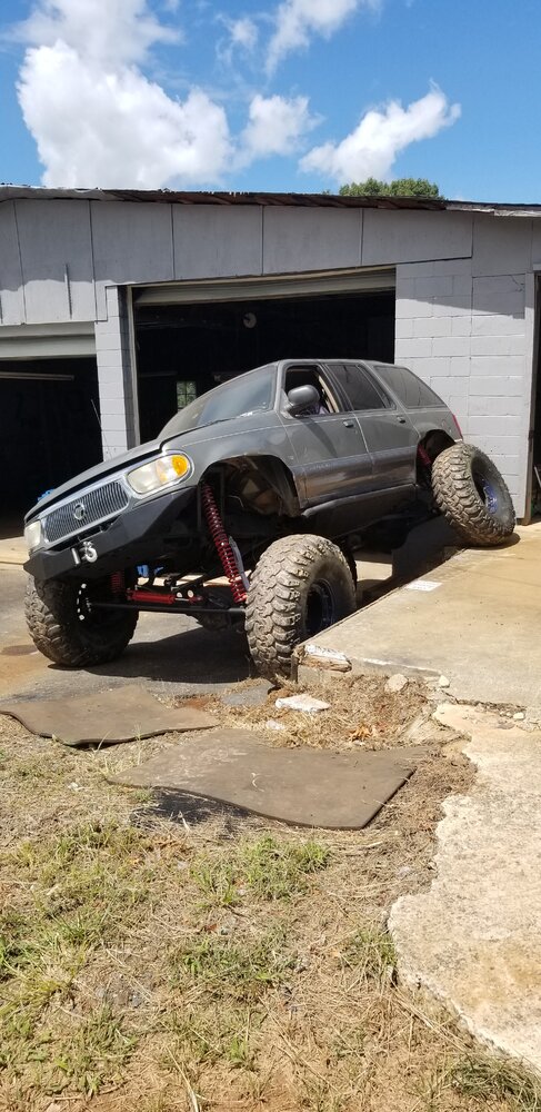

So why is this rear shock not compressing more. Drives amazing!!
I cannot believe how smooth it rides and shocks have 138psi of nitrogen only but WOW, drives soooooo good through bumps and the field behind my house
If I didn’t know any better, I’d say it looks like the links are binding up. Or is the driveshaft bottoming out? Or is there too much spring in the back? Or shocks charged too much? Could be a number of things that my armchair quarterbacking ain’t gonna help.
The proper gearing will make a huge difference. That transmission isn’t going to like those high gears.
Possible Reasons why your coilovers won’t compress
Springs too stiff
Too much oil in the shocks
Link geometry
FOA has absolutely horrible quality control. I’d pull those coilovers apart and inspect them/verify correct oil level
Link geometry is beyond perfect on this rig, that's one thing that's 200%!!
1-Pretty sure rear lower springs are too stiff
2-rides great but i believe shocks need more nitrogen, its smooth but too soft now that I've driven around through some off camber stuff, def too soft a rebound.
I dont know a lot about coilovers but I can tell rebounding is too soft..every little dip or if I just turn too sharp the suspension moves too easily.
Bruh it's got plenty of umph like daiuuuuum. I'm not talking 2wd screw that itll never see it. Regular 4lo it's got power, double low is kick straight up ass!
Did you charge the shocks with them all the way extended?
I know that's way too soft for this heavy ass pig
A swaybar doesn't really seem like marty79 style, but I'm not gonna look through 19 pages of thread to confirm
Heck no, pretty sure its lower springs. They're 200lb, started with 300, probably need 250lb or 275, and upper are 175lb, should be 150s. Some of it is also just the way that incline is too
