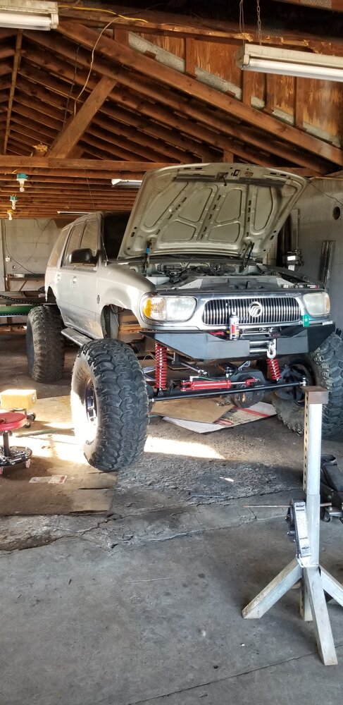

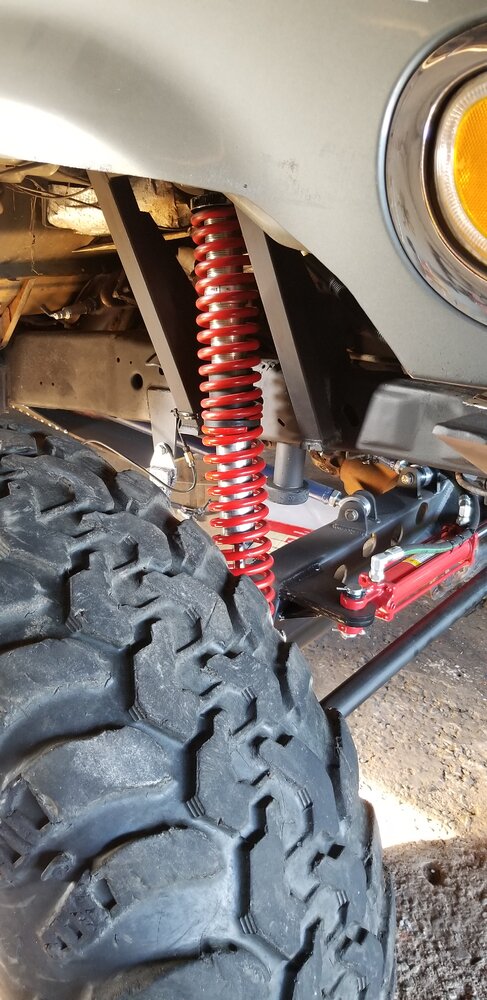

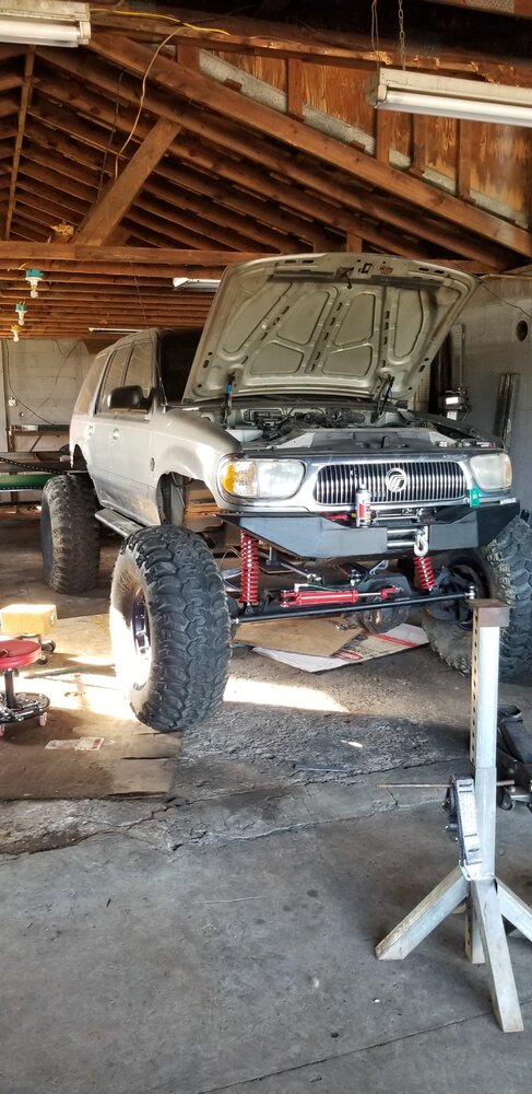

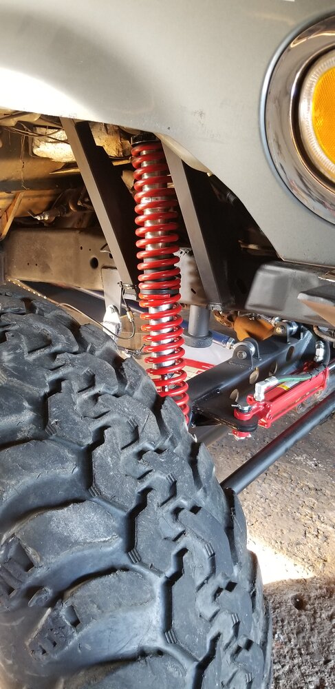

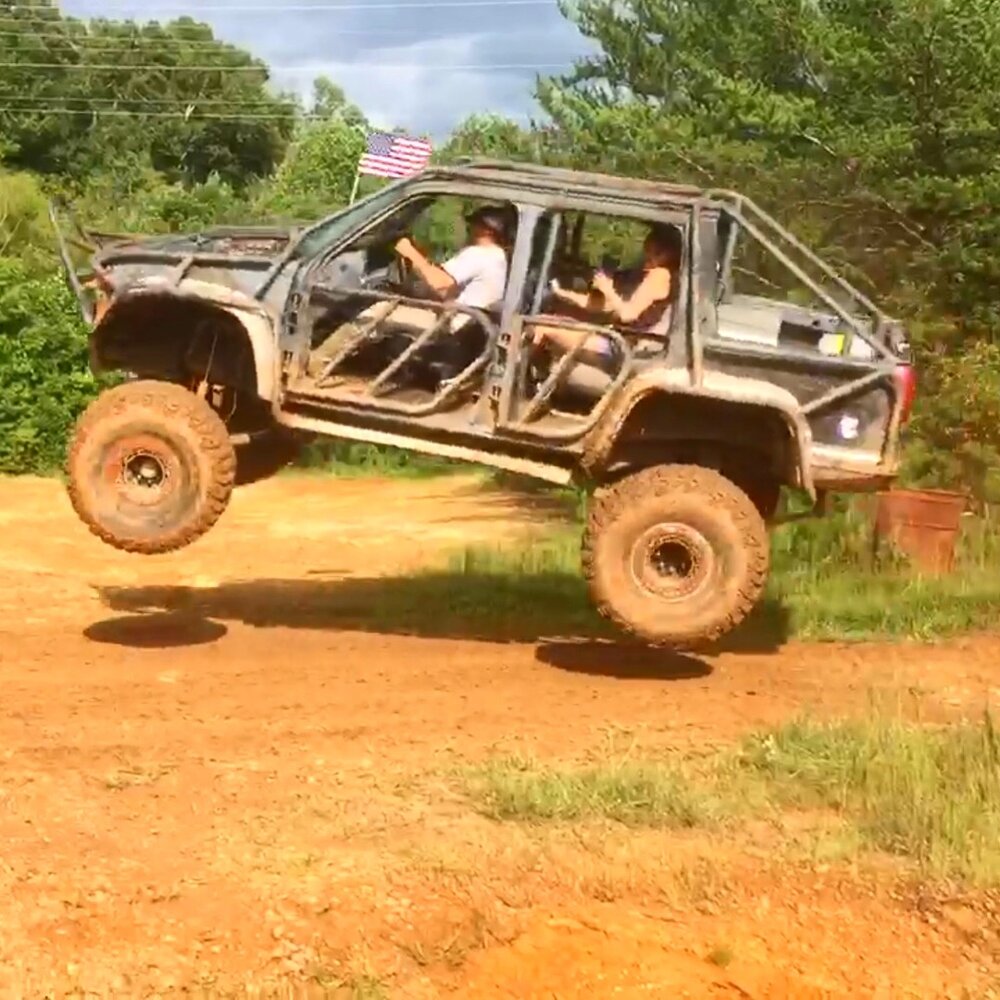

Those were with 250 lb springs? Coming right along.My new springs did the job perfectly!! Wow! 0 preload and I have my 6.5" shaft showing
View attachment 355279View attachment 355280

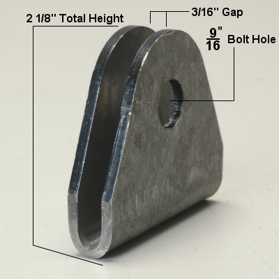

Also, that’s not really 1000 pounds of force on that strap, unless you’re wheeling gently. You droop that axle out by hopping up the front end, or stuffing one side hard hanging the other, or a dozen other scenarios, you’re talking about a dynamic load of 1000 lbs of mass… makes for much more than 1000 lbs of force. Not to make you feel you have to do extra work, but @Croatan_Kid has a damn good point.
