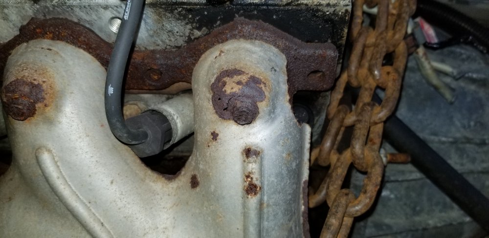

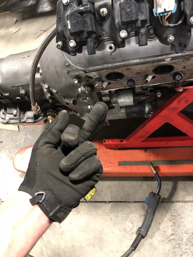

Best way to get these suckers out, especially the one broke flush to head

Remove the manifold and weld a nut to all the broken bolts.
Yeah I do but the flush broke one on aluminum head worries me

Very common for them to break on an LS. I don’t even count the number of bolts I had to remove like that.

haha yessir I know. I've always gotten nervous when welding broken studs out of aluminum heads...I've done it more than I care to but still don't like doing it.

Why does welding studs on aluminum heads worry you? Those are the easiest to remove.
Only when they're flush or recessed a little otherwise no big deal
