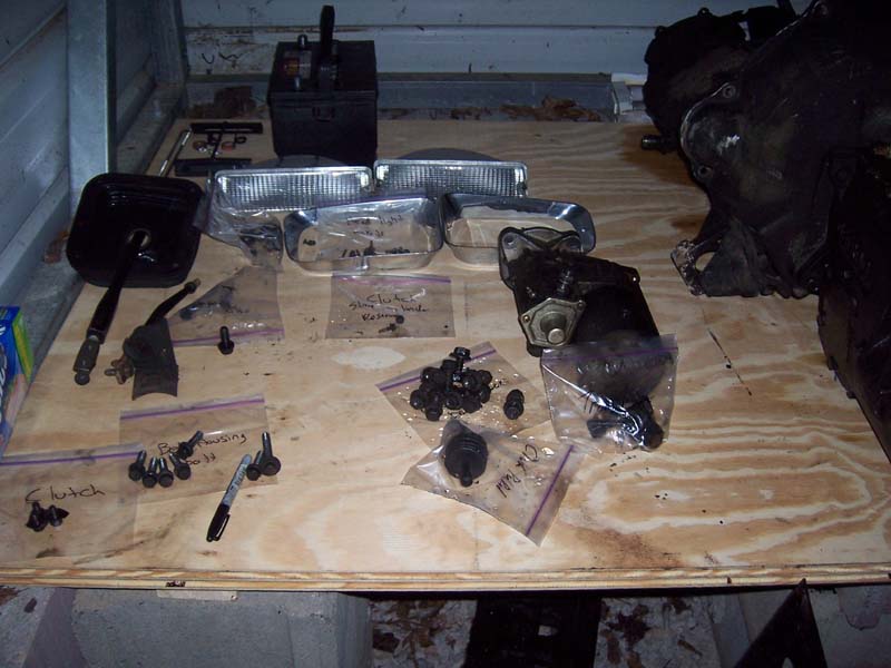

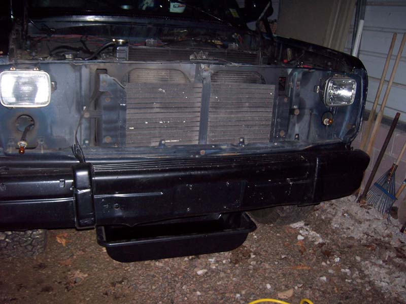

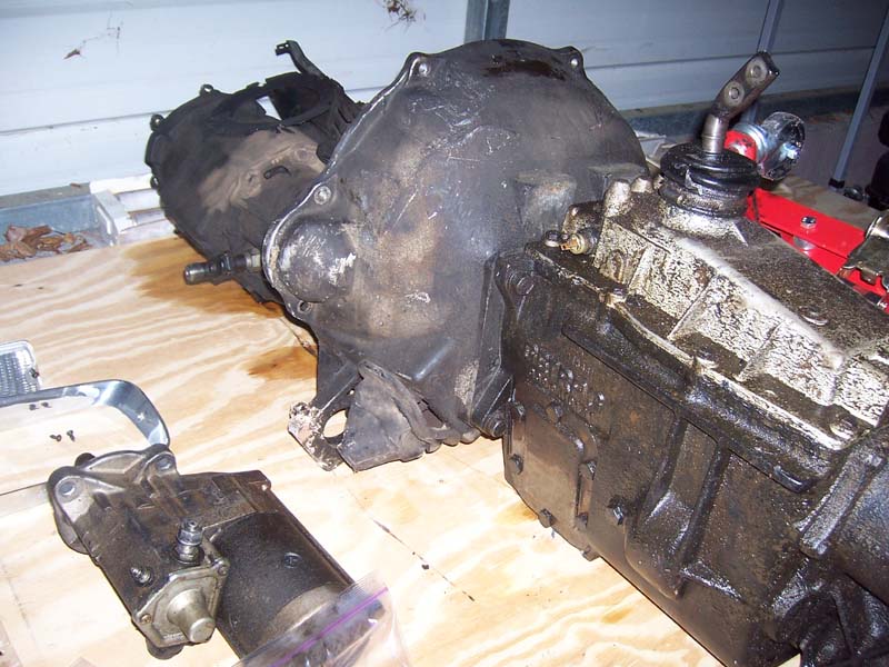

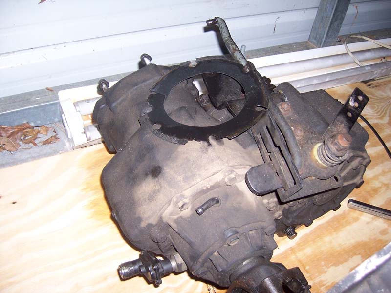

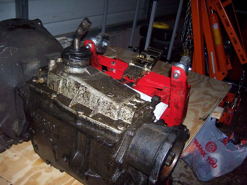

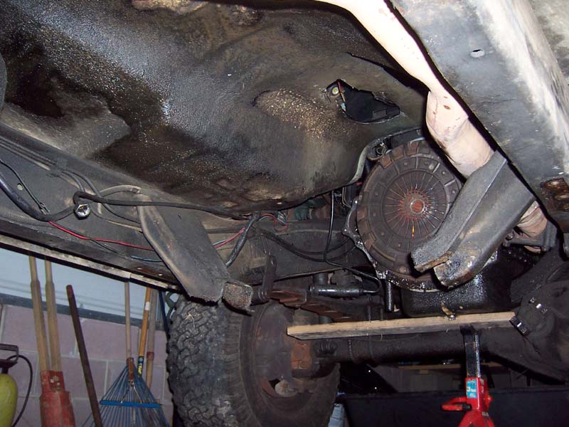

I got both driveshafts out, the skidplate off, the transfer case out, the tranny out, hood off, grill off, switched out rims and tires, and the tool box/camper shell is also gone..
pics:

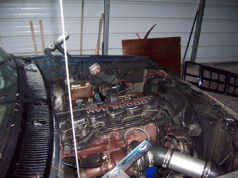

when you pull it, I would like to see a pic of the engine on the hoist. just might test it out a little bit
so i am guessing you do not think it will handle the engine?
My buddy and I swapped out a 7.3 Powerstroke with a regular size heavy duty engine hoist with the boom as close as you can get it. Just don't get crazy with it and it will work.
that is the plan...take it easy and be safe..
sorry, I have not been on here for a few days. I just know that engine is damn heavy. I am sure it will be ok with the boom not extended. It should not be any worse than picking up your normal engine, trans, and transfer case combo.

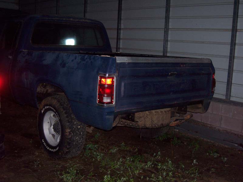

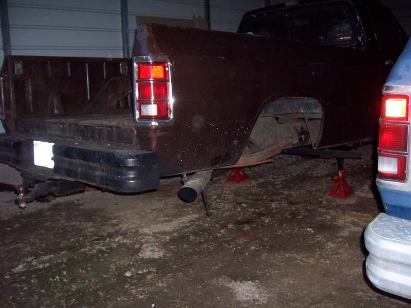

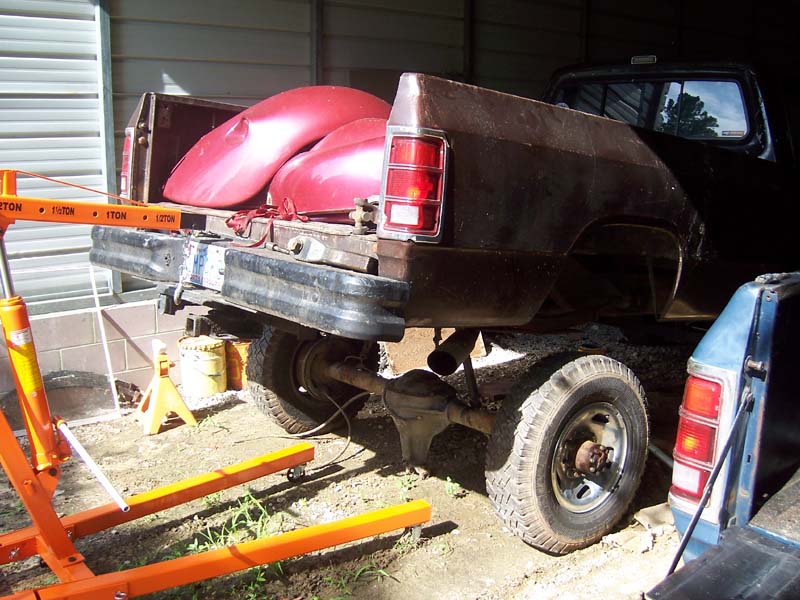

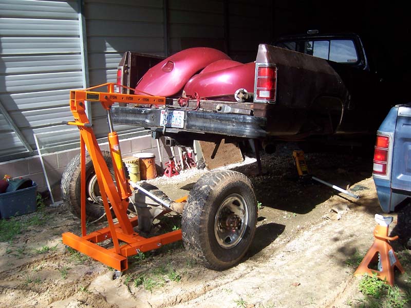

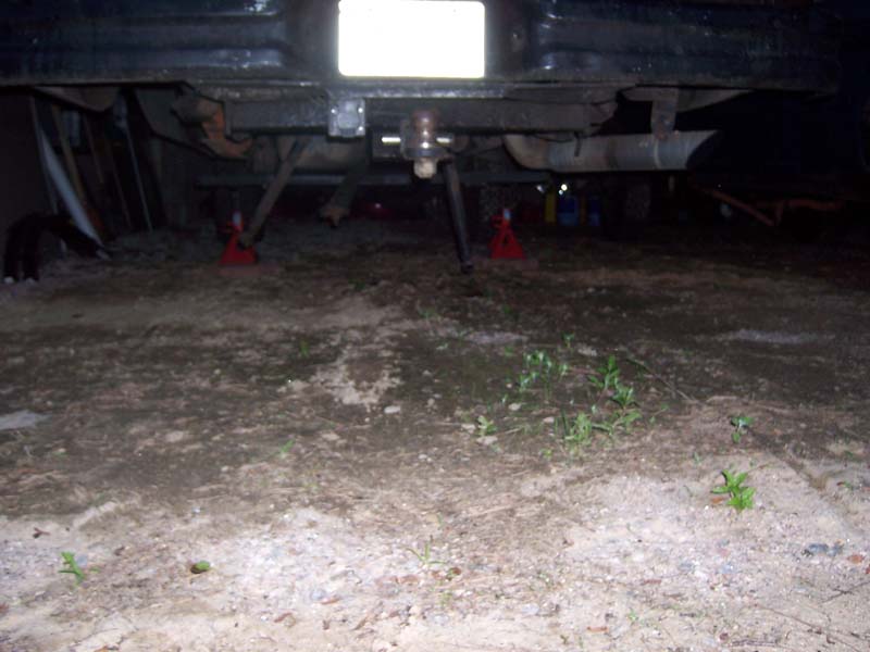

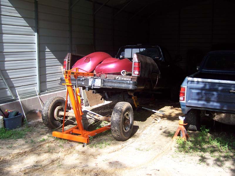

well since I need to be able to move my STD cab out of the way once engine is out to roll new 4 door in.. (engine hoist will not roll on gravel/dirt) I had to get rear axle out of my other spare EXT cab truck and put it in.
Since I was all by myself I had to think a little to get this job done.. Yes a dually rear axle is heavy as hell, especially dragging it across dirt, sand and gravel.
So to get it out of ext cab I used jeep winch and dragged it from behind building to infront of it..
then I bolted on spare tires so I could roll axle around
then I used engine hoist to lift back of truck high enough to roll axle into place..
took me about 6 hrs total to do it..
