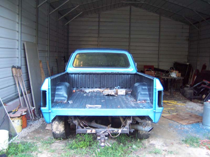

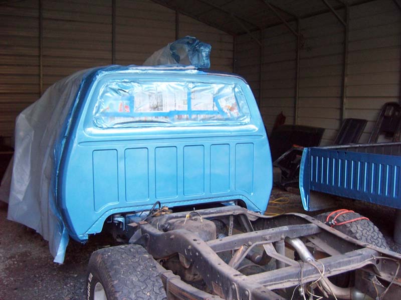

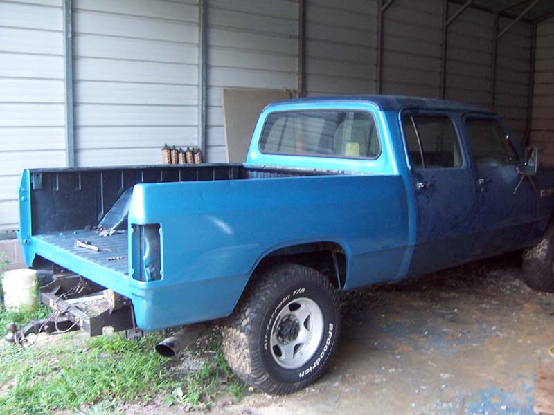

Here is the gooseneck hitch that I am gonna use to make one for my bed
these pics so it open, closed, etc
