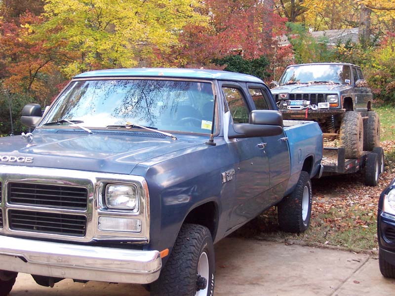

If I remember correctly it was
3840 on front axle
4840 on rear axle and
6720 for trailer weight
I can check when i get home.. but I am pretty sure that is correct..
To be honest I have no idea how I got it this low.. from last time I towed to PA.. last time I was 16,900 with my STD cab CTD and same camper , trailer, jeep setup..
only thing we can come up with is I had 20 gallons on water on board last trip(which I did not this time), I hauled up a set of 4 tires on beadlocks on trailer last time( not this time).. everything esle was the same of course different trucks
oh and for those that have not been to Rausch creek this is the best rock garden I have ever seen :)

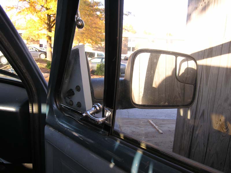

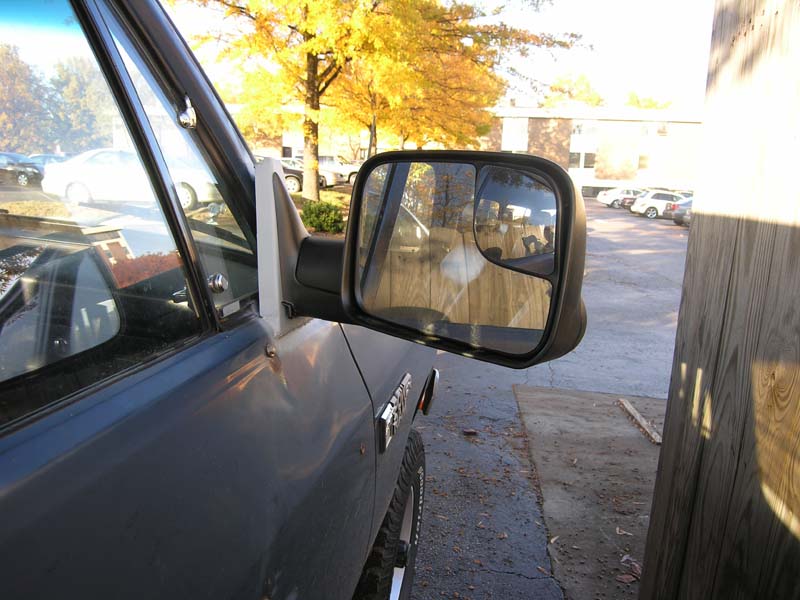

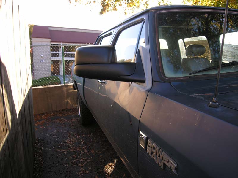

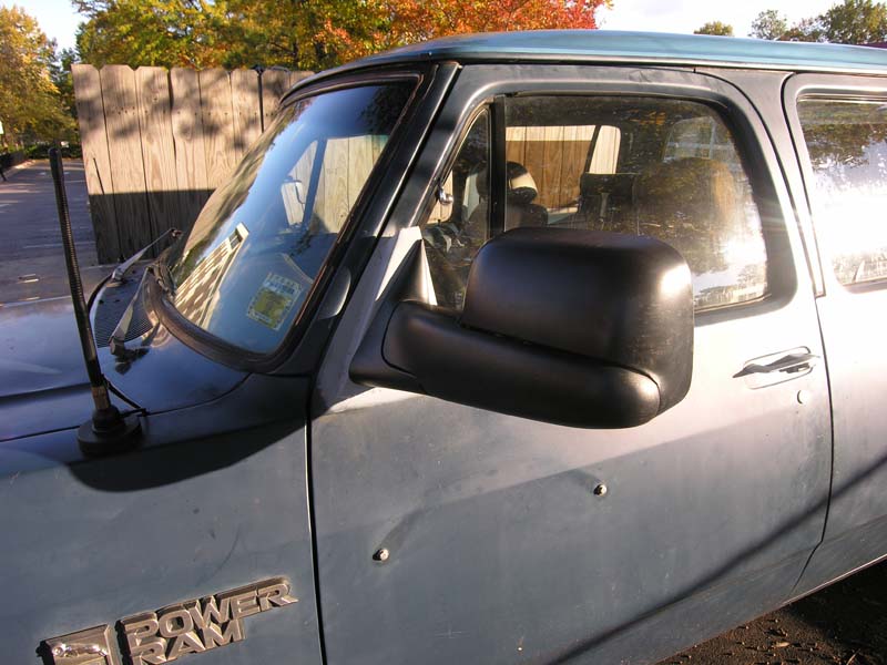

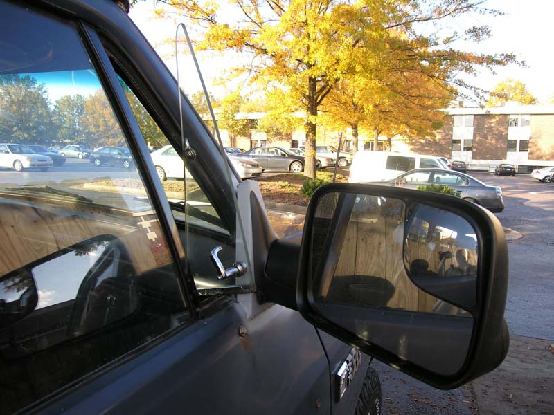

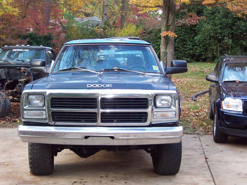

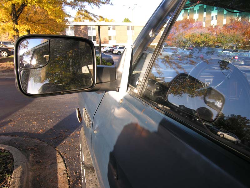

Well I know a lot of folks will hate me for doing this next mod.. but for me Good mirrors and visibilty when towing is worth it.
so yes I welded on my new style dodge mirrors.
Here is my old 1st Gen with the mirrors on it.. you can see they tilt up some..
so this time I took more time and made a new mount so they sit level, plus we braced then with some bends in steel so they woul dnot shack when driving down highway.. and so far at 70mph no shaking :)
ok on to the pics:
they are only primer for now but will be painted to match rest of truck once i paint the rest of truck..
Passenger side
Drivers Side

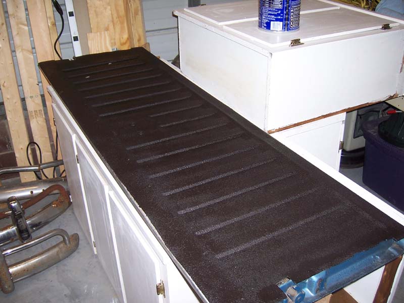

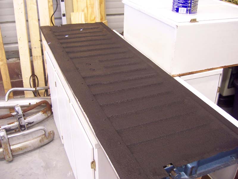

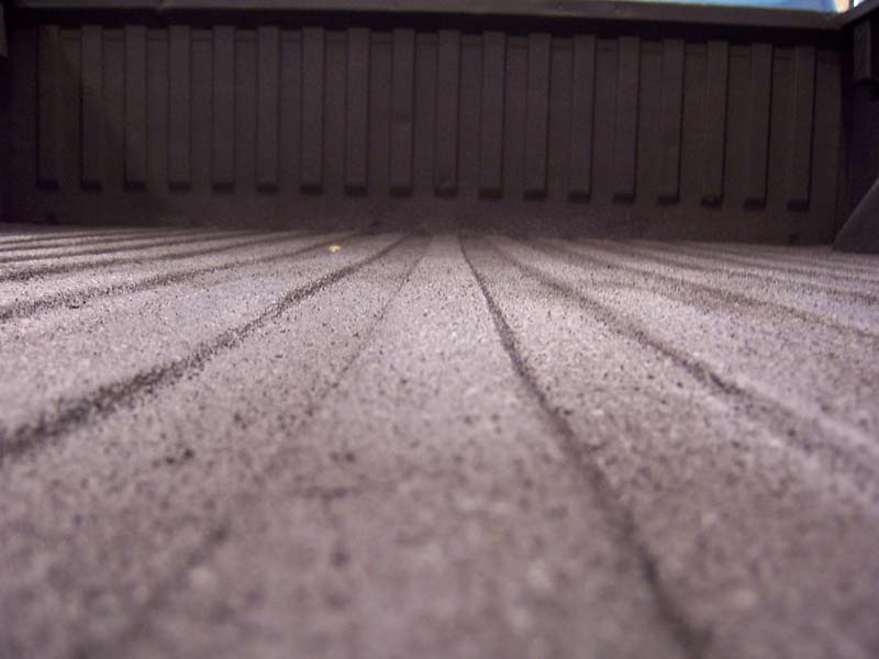

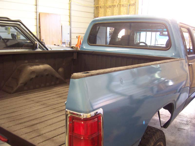

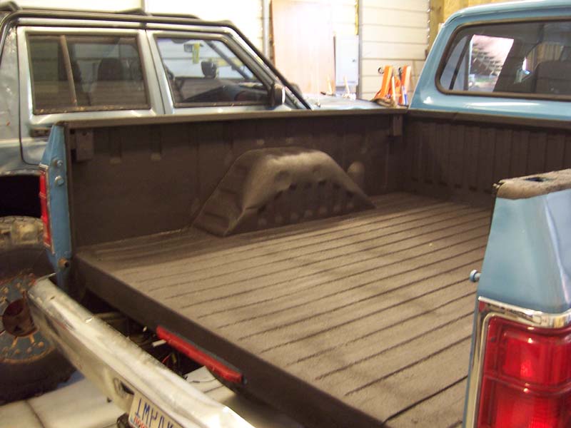

Well I was lucky enough to WIN a DIY bedliner kit on Pirate4x4..
the giveway was from Second Skin: http://www.secondskinaudio.com/products/diy-bedliner.php
so today I sand blasted my bed, since it had some thick paint already on it, then I sanded it and then cleaned it.. WOW that was a lot of work..
then I taped off the truck and got to work..

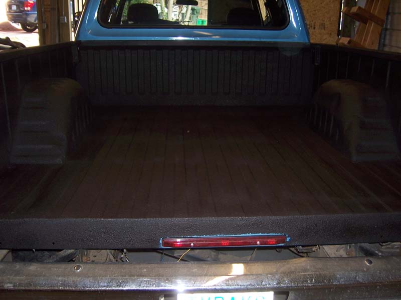

the bad news is I lost all the pics during the prep process.. CRAP

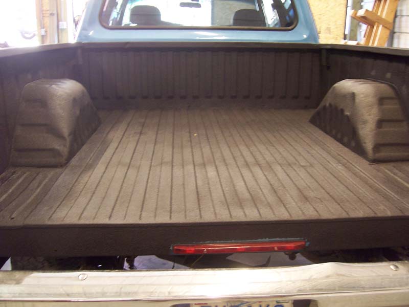

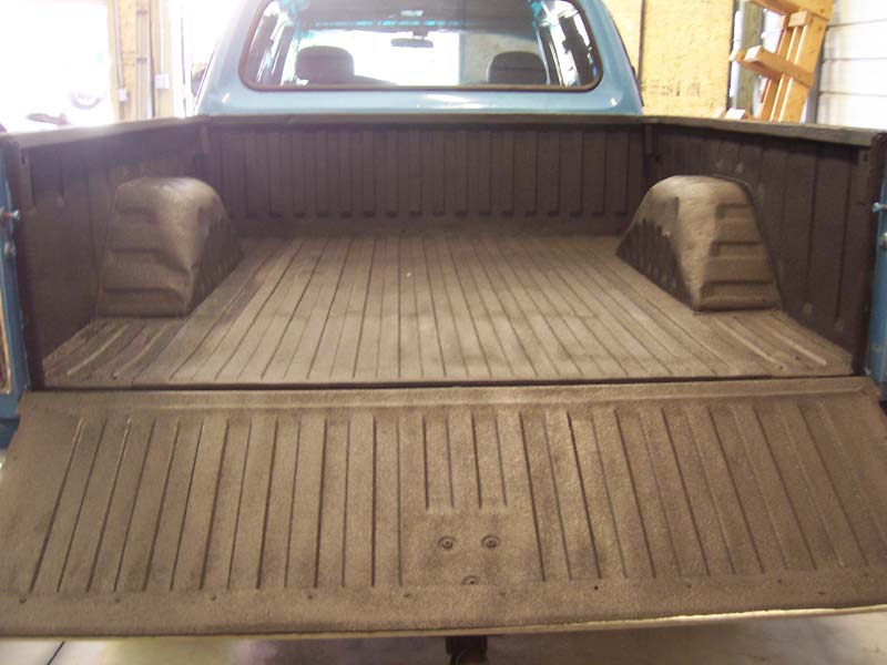

So I went back out and took new pics of the finished truck..

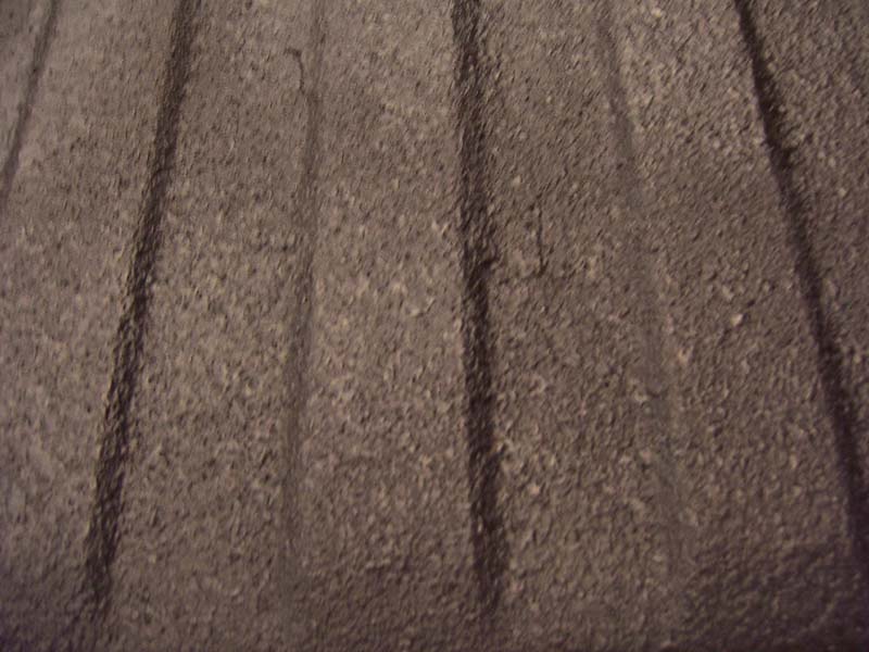

this is up close shot
another up close to show texture
as for a review.. this stuff is AWESOME..
it was very easy to work with, went on very easy.. If I get another truck I would buy this and do it again.. well worth it..

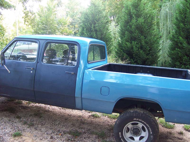

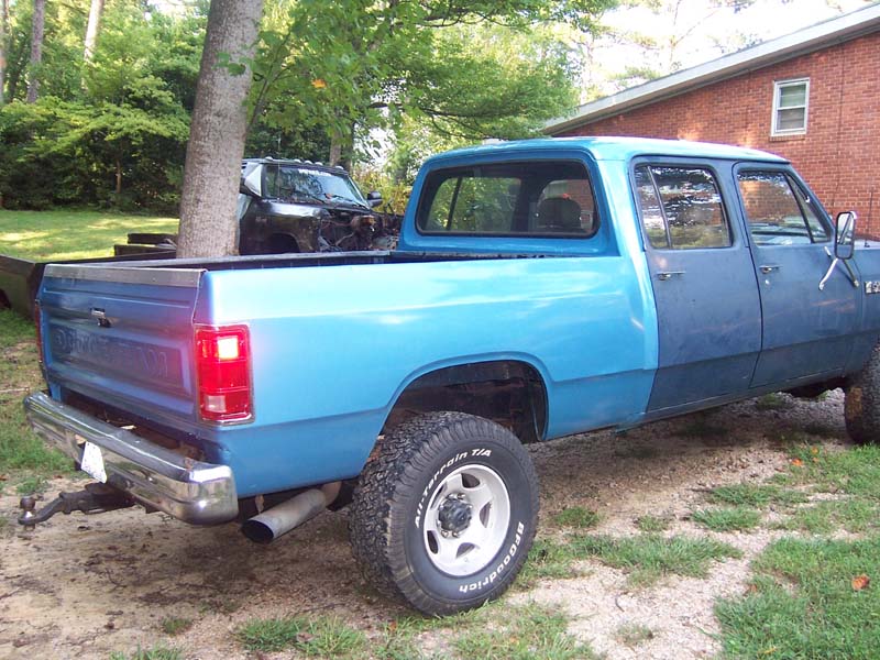

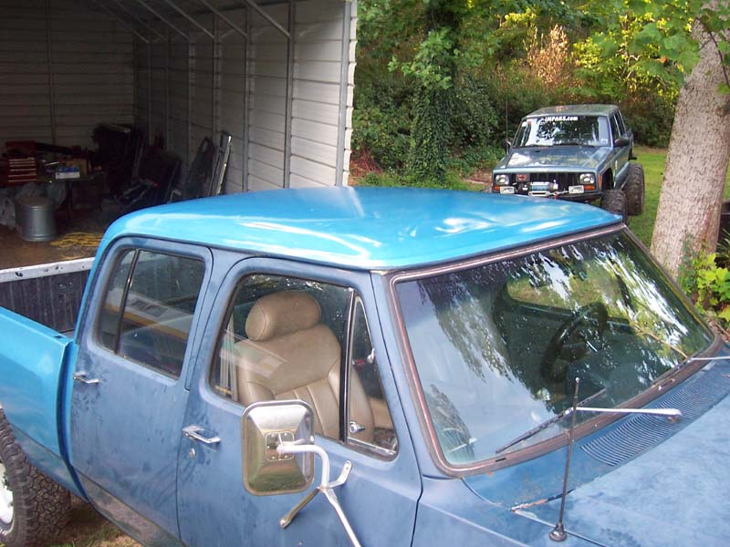

Here are some more pics of the painting I did today..
So far I have entire bed, tailgate, back of cab, and now roof painted..
