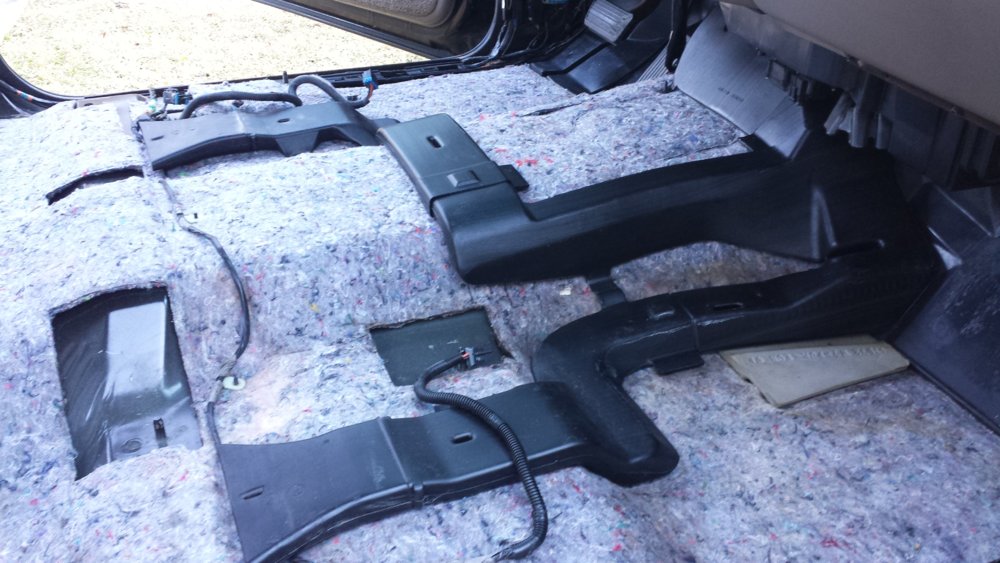

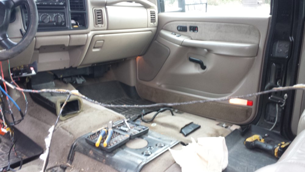

Dude...that floorboard is waaaaay too clean. You need to add about 15 pounds of dirt to it so I feel better about mine. :lol:
Is the clamp to tighten up the bearing/bushing so it doesn't rattle?
Yep. It doesn't fit very tightly in the lower part of the steering column.
I just dumped it out before I was all up under the dash, don't worry.

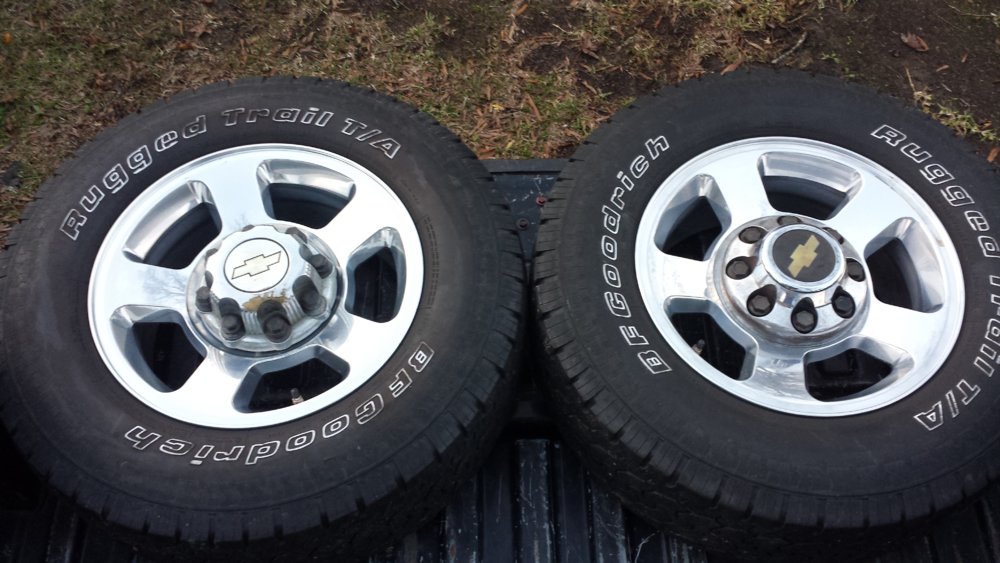

I picked up some 09 Dodge wheels. They look very similar to the 03-07 3rd Gen wheels, but ever so slightly different. These are 17x8 and around 6" of backspacing. Hopefully it'll pull the tires just inside the fender flares. We'll see.
I just can't decide which center caps I want to use....so here's some pictures!
So, which ones? I like them both...
Black truck, black center caps
Good point! I kinda like the "retro" look of the 90s center caps. I need to see how well they clean up and decide if I need to try and find another set in better shape or not...
So I like the look of the old center cap better by itself, but the newer cap looks better on those wheels.

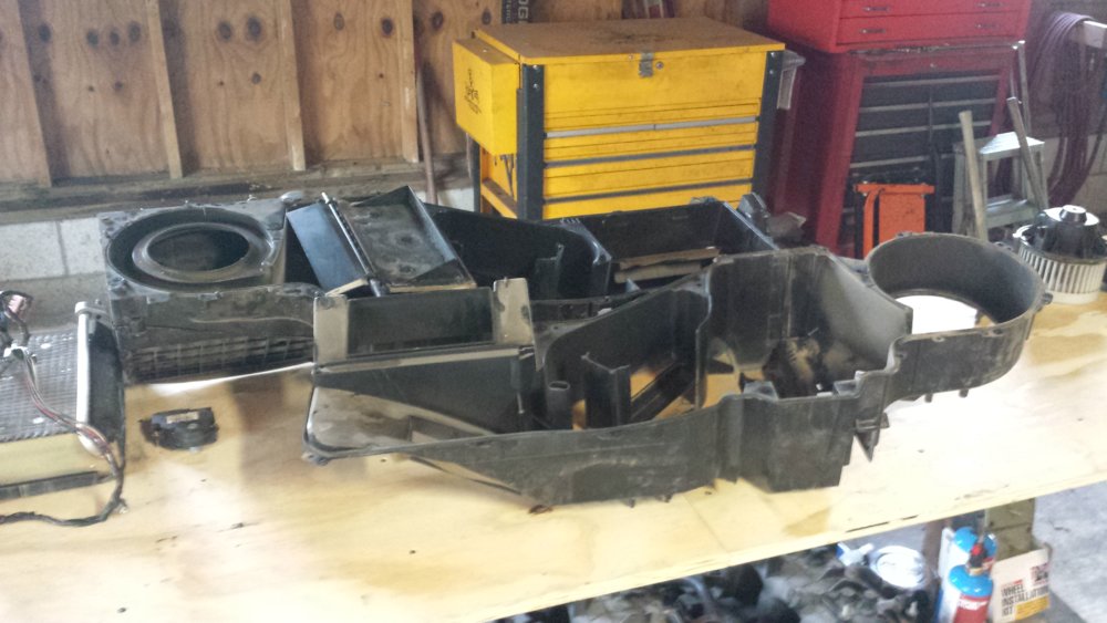

Anyway, I finally picked up a new HVAC box for this rig. Mine has been cracked since I wrecked the truck. I'll just clean the new one real good and swap everything over to the new one since everything still works. There are two small holes busted in the new on that I'll fix with some plastic cut from the old box and epoxied in place.

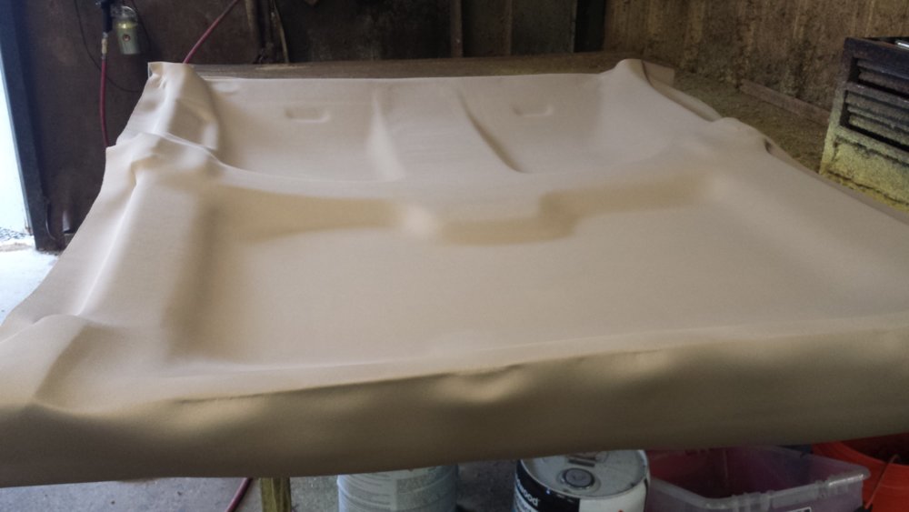

I called to get a price on having the headliner done. The local place told me 185. Sold! Doesn't matter if I take it out and give them just the headliner or if I drop off the truck and they pull it out. I'll definitely let them have the pleasure of removing it if that's the case!

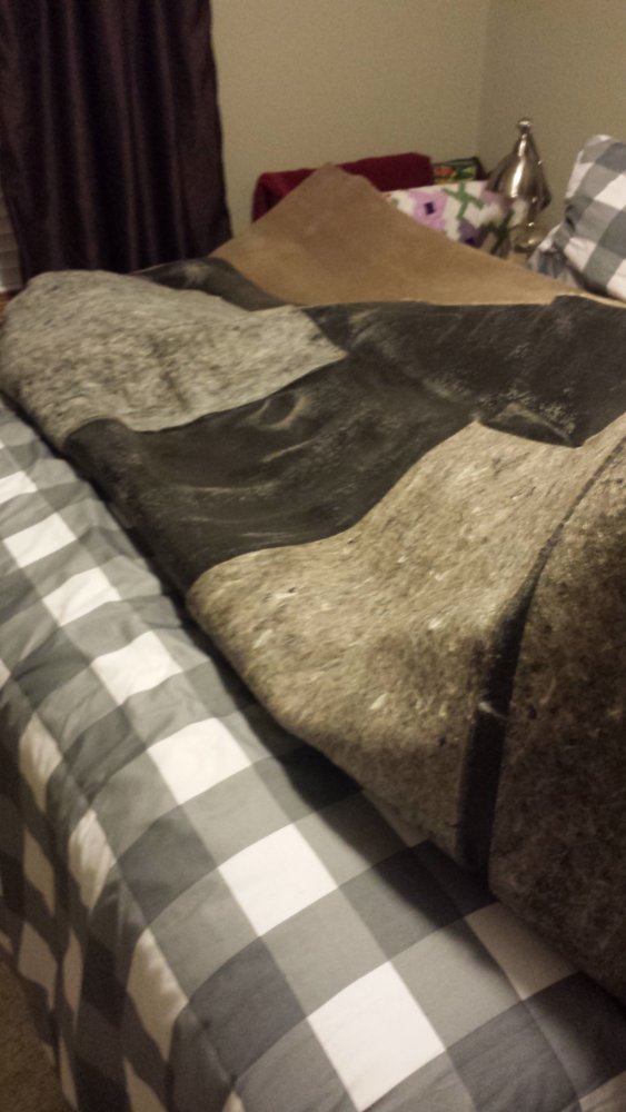

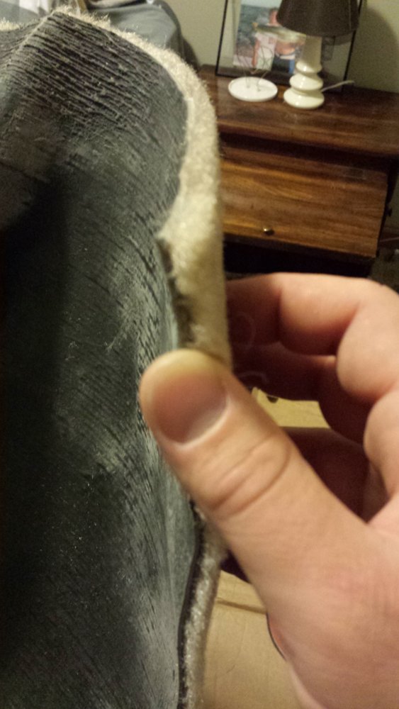

Well sheet far! I didn't expect my carpet to get here this quick, but it was on the front porch when I got home. It looks like some nice stuff and the mass backing is hefty and I feel like it will quiet down the cab a bit. I'm also planning to snatch the factory firewall insulation off and stick some Fat Mat on it that blocks noise and heat. Once the transmission comes out to be built, the trans tunnel will be Fat Matted as well.

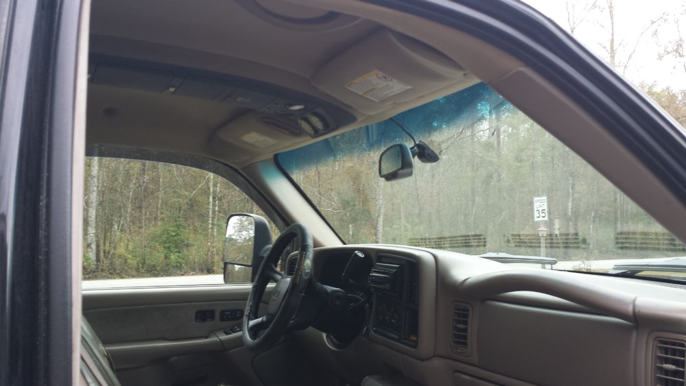

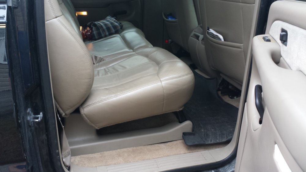

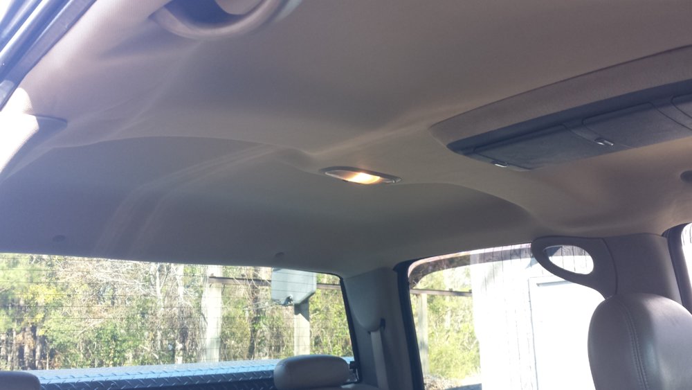

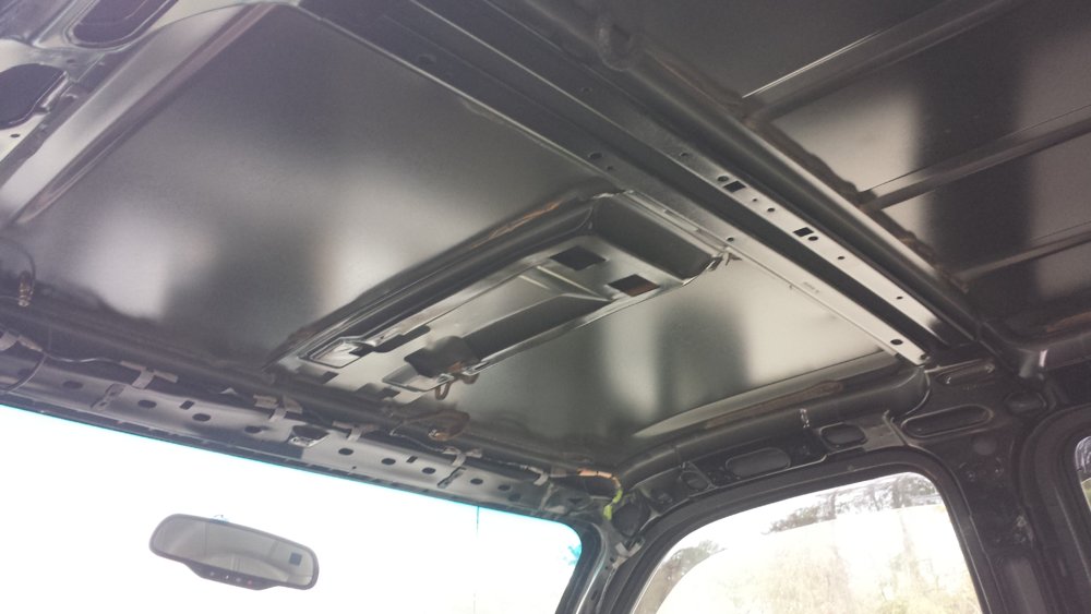

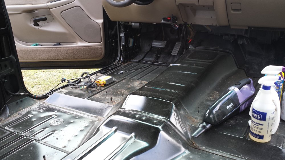

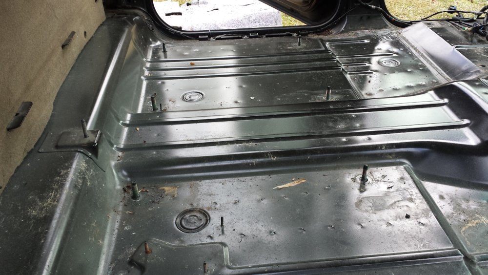

I had some comp time to burn, so I took last Friday off and headed to the local upholstery shop at 8 am to get the headliner done. When I came home I started taking out the rest of the interior. The back seat came out in four pieces because I was working by myself. The seat bottoms come off and then two bolts let it come apart at the 60/40 split. It's MUCH more manageable that way.
All of the removed interior pieces were painstakingly cleaned too...holy hell.

The headliner doesn't match exactly, but it's a muuuch better material and I'm not that worried about it. The new carpet is a lighter color too and you can't see any of it once the WeatherTech mats are in there anyway!
The last thing to do is pull the dash out and replace the HVAC box. I just have to clean up the new one and get the time to swap them out before it's time to need the AC again!
You ever put these wheels on? I had no idea that was an option and I’m curious to see how it looks!
I love this truck and love how much you love this truck btw!
Thanks, if wfo had put the hole even 1/4" lower it wouldn't be an issue
Or if it was moved forward a little...possibly a slightly shorter pitman arm.
@77GreenMachine Not yet! I'll get there one day though. I've got a few pictures of them on some other trucks. One has the earlier 8 lug center caps and the rest just used the PYO center caps. Both look equally awesome to me.

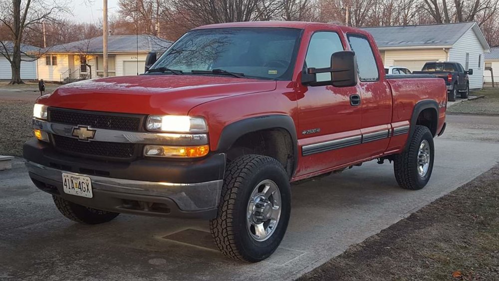

This thing desperately needs a winch bumper up front, but I'm having a hard time finding one that isn't huge, gaudy, ugly as sin, and somewhat affordable. The one that ARB offers probably looks the best to me. I don't think I'd be opposed to having someone build one for me either.
You might of said already but are you opposed to a tube style bumper?
Where’s the intercooler/radiator stack on these trucks?
Sent from my iPhone using Tapatalk Pro
I don't think it would go with the look of the truck. They usually look unfinished to me too.
The intercooler and radiator are right where you'd expect them to be. The trans cooler is right behind the grille, then the condenser, the intercooler, radiator, and fan.
