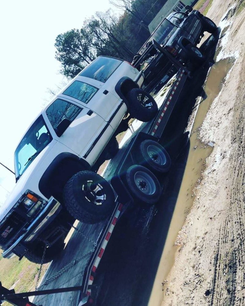

Got a chance to try out the tow tune today. Hauled a 3/4 Suburban back to New Bern from Elizabeth City. I averaged like 13 mpg running 70. Not bad.
I also ordered the internal parts for the transfer case build and I can get moving on that soon.

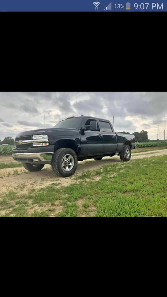

Sorry for that stupid half sideways picture that my buddy took.
What length is your trailer again? Makes the burb look short
It's a 26 footer.

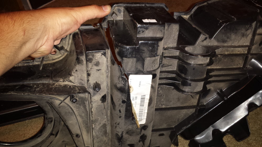

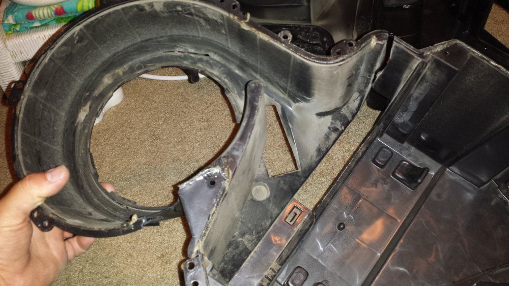

For now, I'm more worried about fixing the AC again. If you remember from several pages back, I wrecked the truck. When I did the HVAC box was broken from the fuel filter housing making contact with the drier/accumulator and pushing against the evaporator core which busted the box.
In the winter you get cold air blowing on the passenger's feet and if you run the AC you get a wet floor. So since the AC has leaked down again, it's a good time to fix it for good. It's getting a heater core, evaporator core, and a high side conversion fitting with a schrader valve instead of the stupid rubber ball.

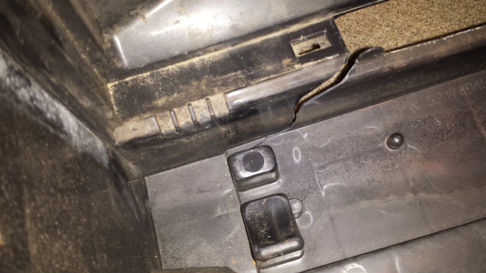

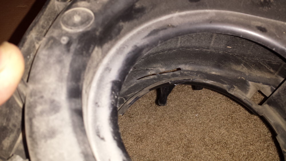

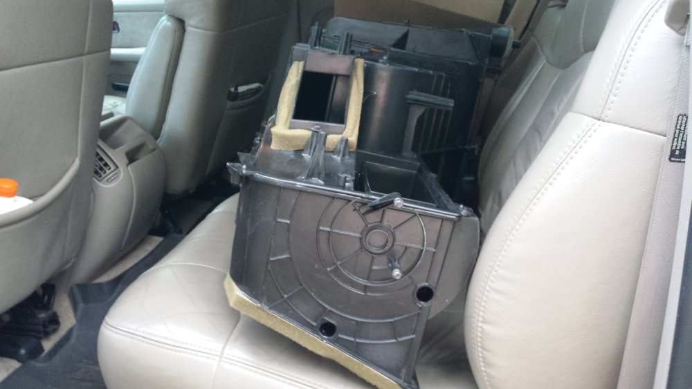

I had two small holes busted in the bottom of the new box where screw bosses were broken off. JB Weld has some plastic epoxy and it works damn good!

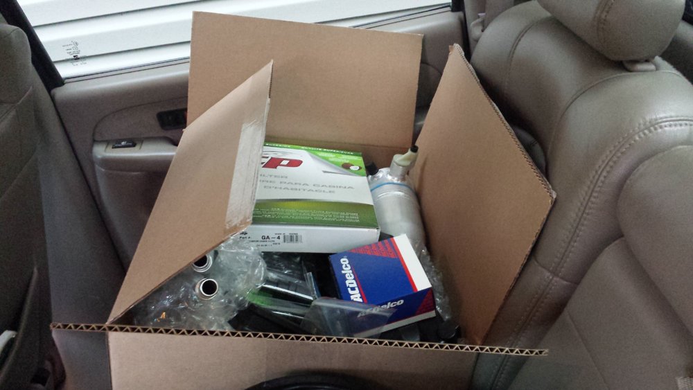

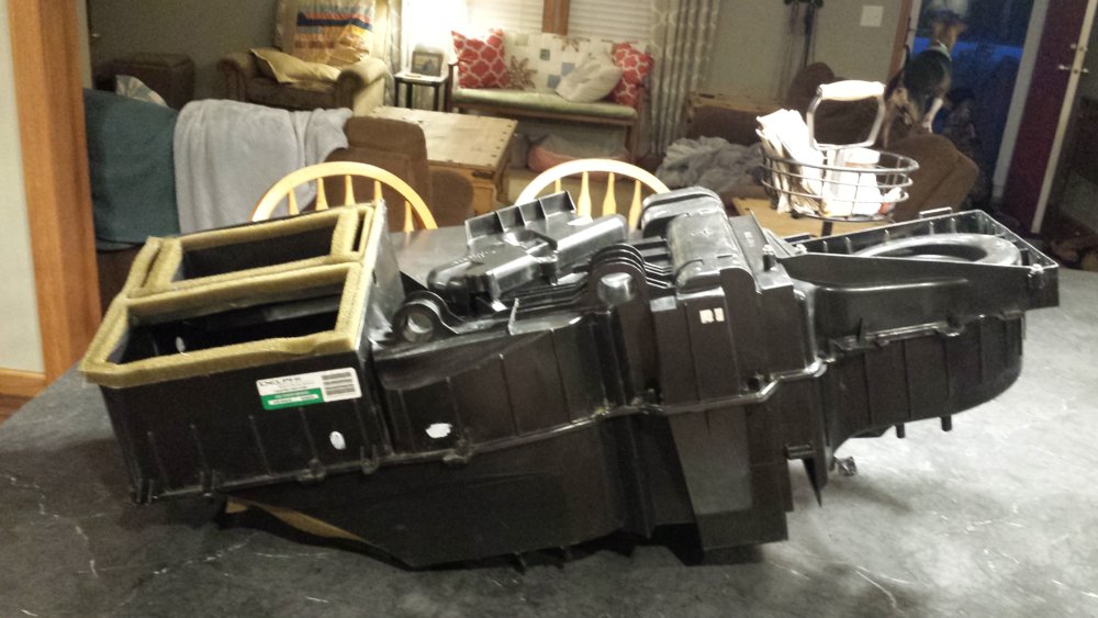

I've also got a new evap core, heater core, heater core quick connects, drier, Schrader valve conversion fitting for the high side, cabin air filters, and the top door actuator that you can't get to unless you take the dash out.
I'm headed to drop it off with a buddy tomorrow after work. He works at the local GM dealer and will assuredly be quicker to fix this than I would be, even if he's only messing with it after he gets off work.

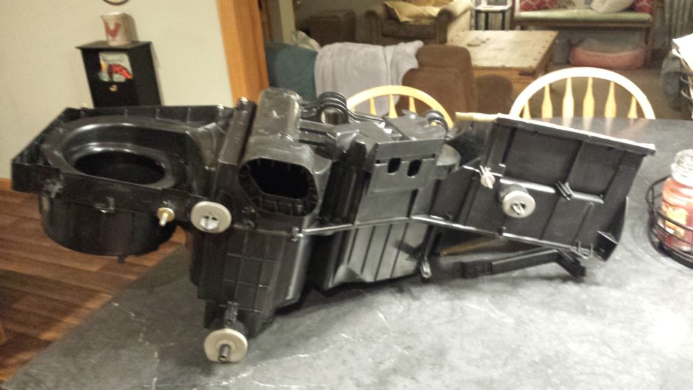

You can see my currently cracked HVAC box in the pictures and then there's the new box and a slew of parts. I'm ready to have AC again!

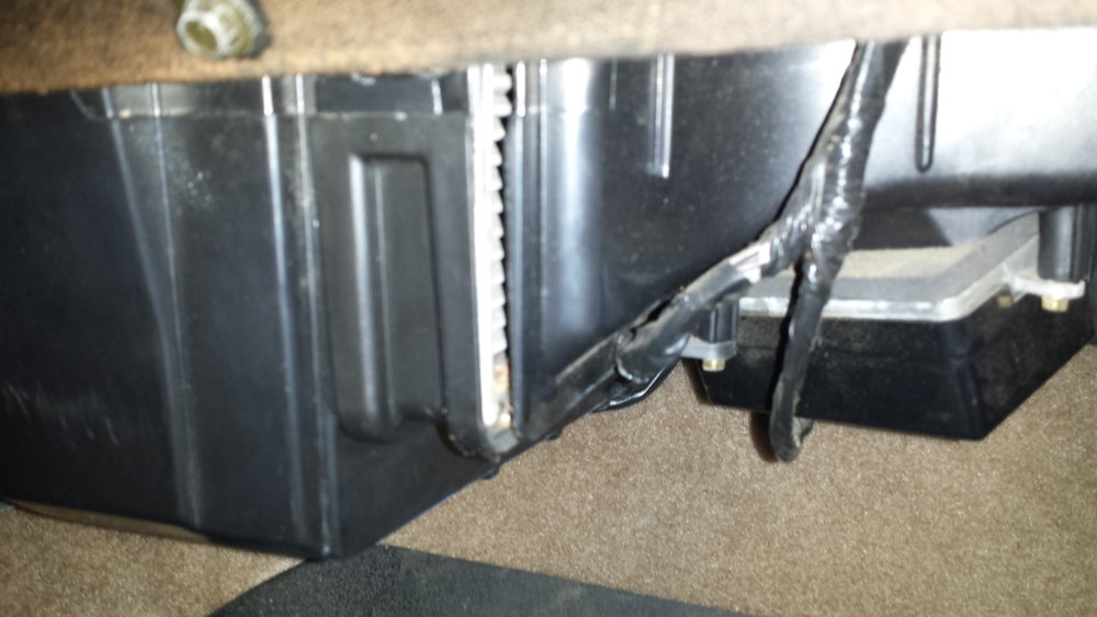

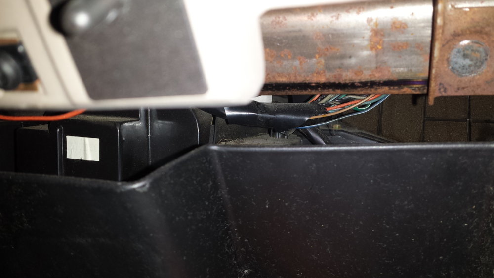

Good news....the dash and box came out this afternoon.
Bad news...the firewall was buckled behind the insulation from the wreck. My buddy hammered it back as best he could. Hopefully everything will go back together like it's supposed to. We'll see!
I may have to hit it with some great stuff to seal it up a little better, but that's not the end of the world.

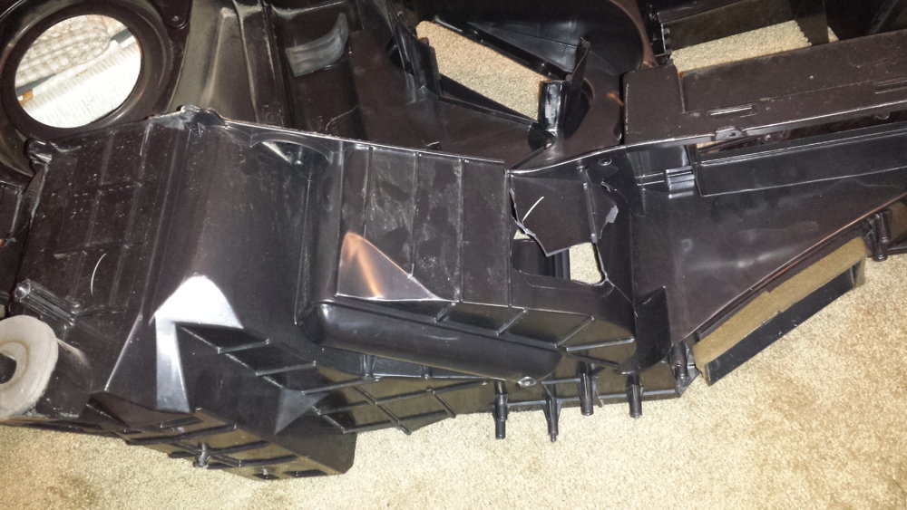

Here's the carnage that is my old HVAC box. I'm surprised it came out in one piece.
No wonder it leaked in the floor and the air came out the vents weaker than hens piss....

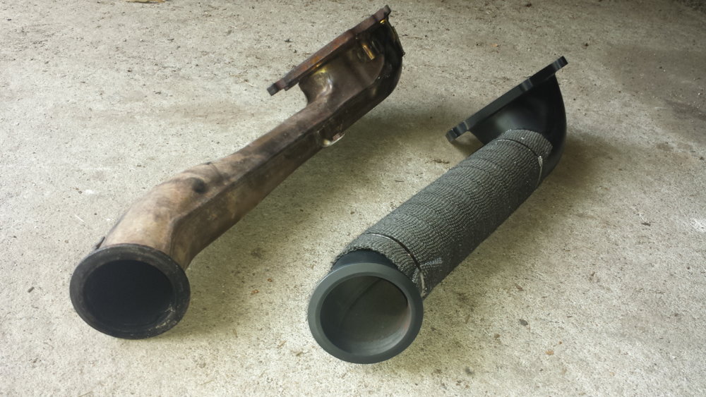

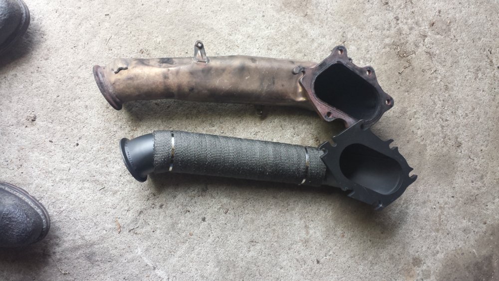

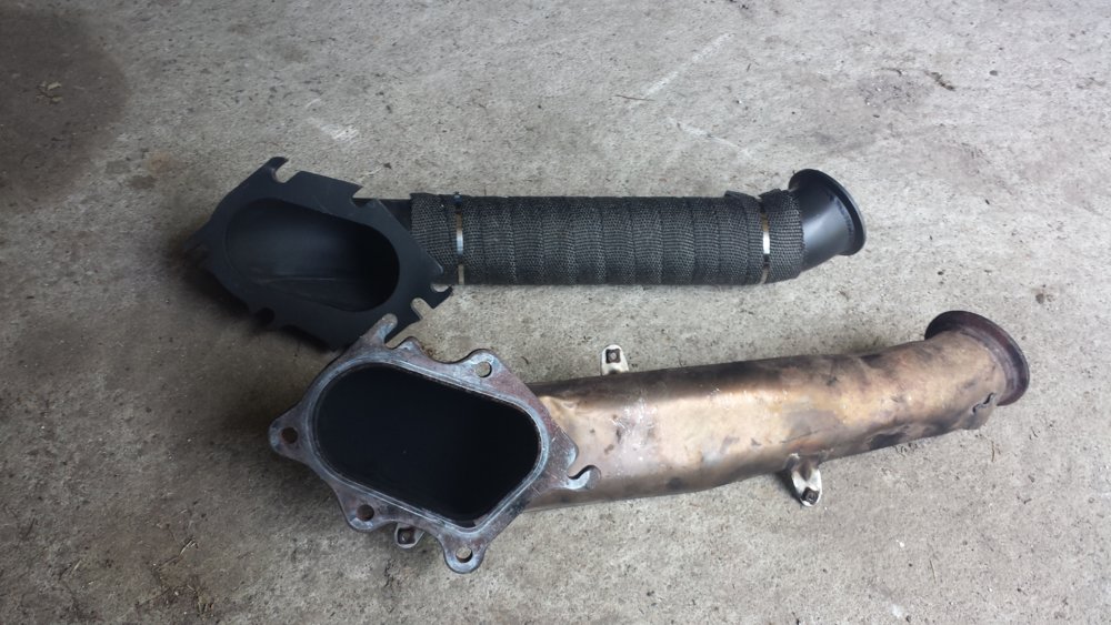

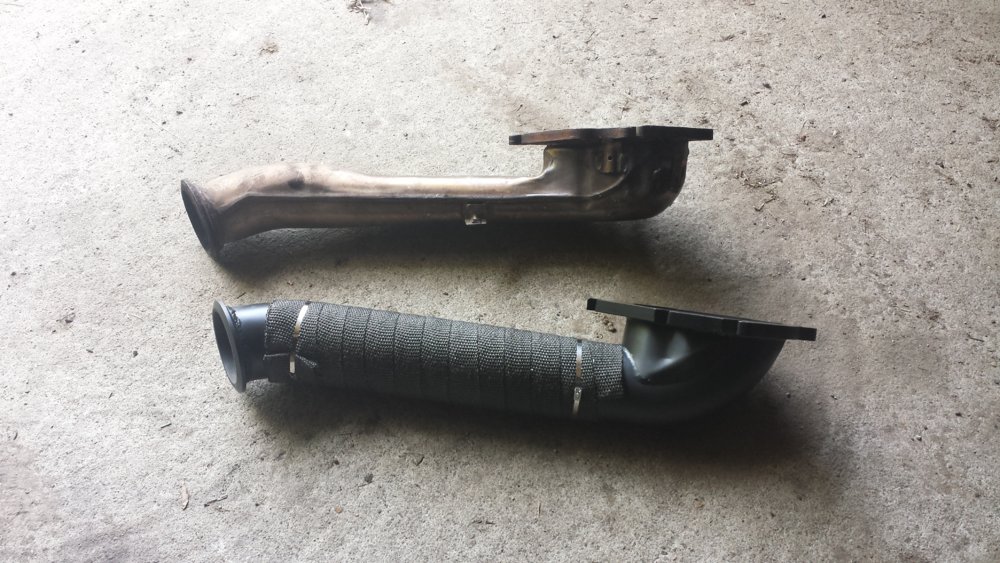

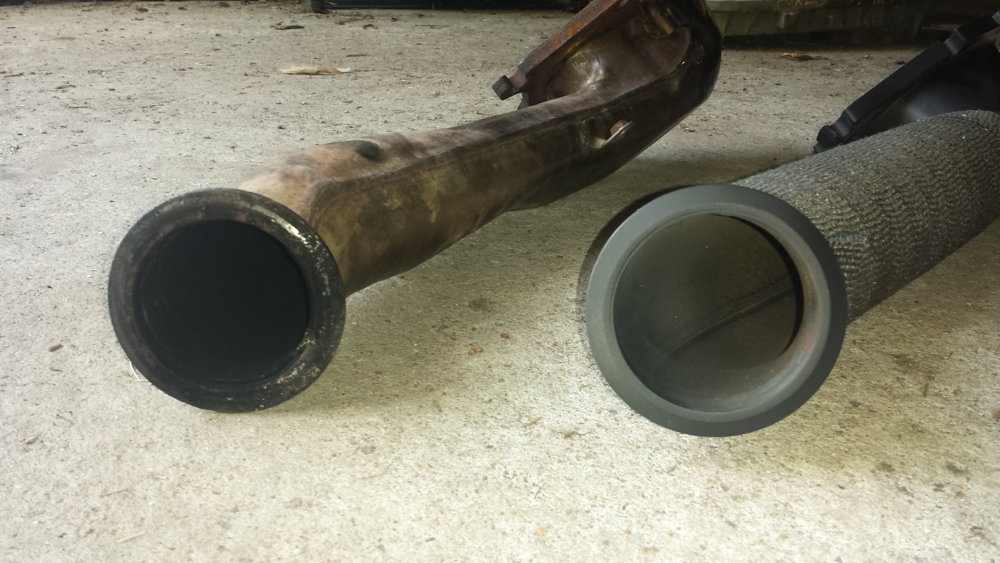

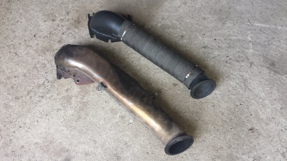

Anyway, today I FINALLY pulled off the stock downpipe and put on the ProFab one I've had for over a year. It definitely sounds deeper, turbo kicks off easier, and the EGTs cool off quite a bit faster. All in all, I'd say it was worth it.
No pics of the install, just the stock one vs the new one.
Still thinking that I need to vac the AC again and put in a new orifice tube. It's working decently, but I think the low side has a restriction. We shall see.
So have you removed something that limited the shape of the stock one? I can't see any engineering or manufacturing reason to have made it the stock way unless there was a major clearance issue on both sides.
who knows, it may be like the 4.0 down pipe on the xj's, crushed and no apparent reasoning for it, except maybe easier to bend or crush into shape.
I didn't really see any reason for it to be shaped like it was either. The transmission dipstick needed a slight bend and it's got clearance on the up pipe. There's also plenty of room between the back of the motor and the firewall.
Probably had something to do with these being initially designed for the previous body style trucks. That's why the driver's side exhaust manifold has a spot in it for steering shaft clearance, but it doesn't need it and they didn't change it until 2010.

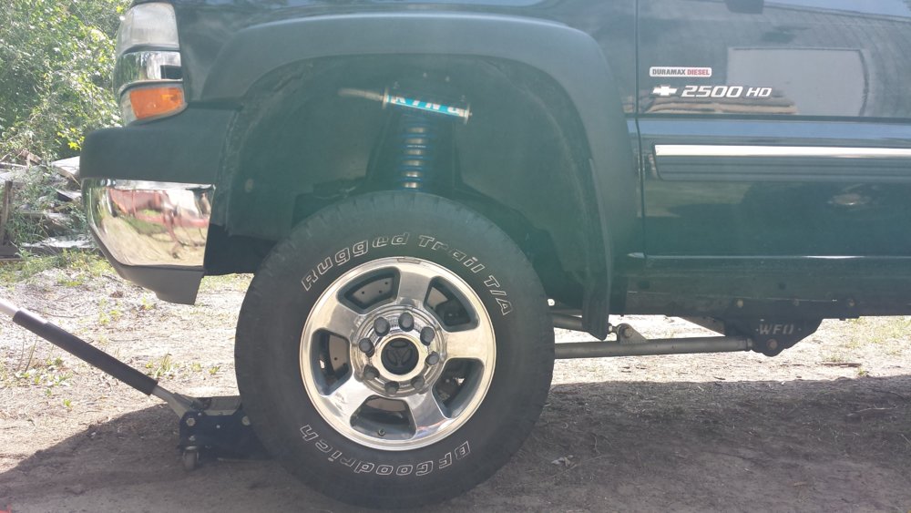

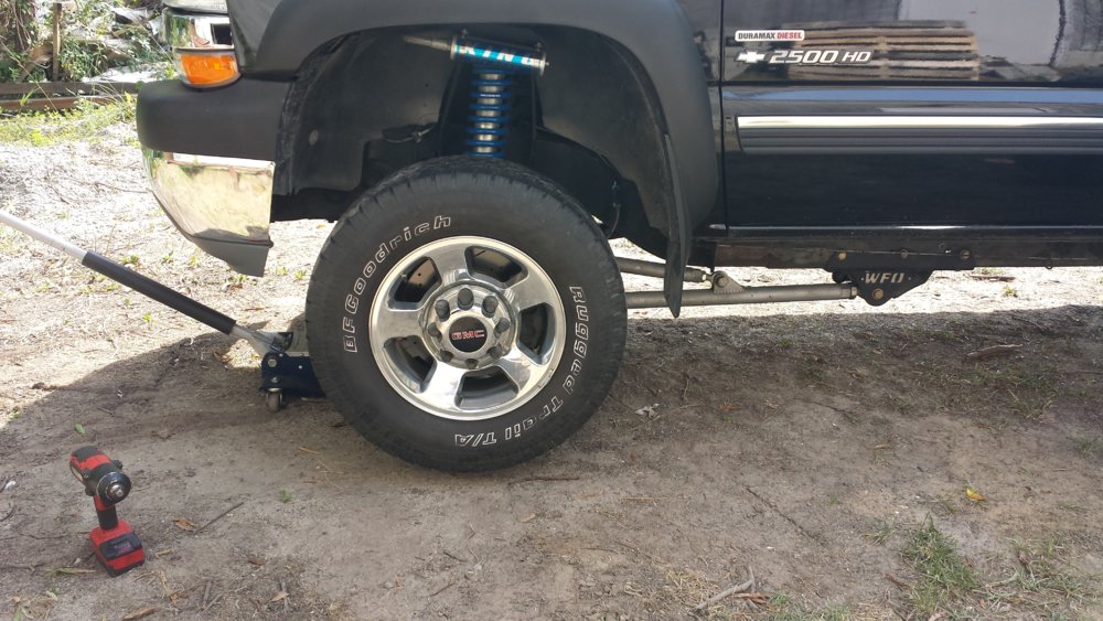

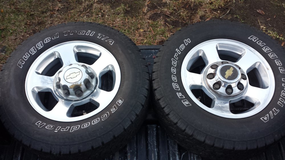

I think I'm going to swap to a set of 09 Dodge wheels. They're 17x8, chromed, forged aluminum, with 6" of backspacing, and a 43.18mm offset. Lighter, stronger, less sticky outty :D
The current H2s are something like 33 lbs a wheel, these are 19 lbs. The current 295/70-17s on H2s stick out 1.75" past the fender flares up front. The Dodge wheels will put me around .75".
Plus, they look pretty good, I like that they're more open, and I've got my choice of two different style center caps.
They look weird off of the truck, but sooo much better when they're mounted. Giggity. I had a GMC center cap laying in the shop and I think it looks a lot better with some black in the center cap to offset the brightness of the wheel. So, I'm leaning towards the 90s Chevy caps.
The H2s will then be put to use on my CUCV so the new 40s can get bolted up and I can drive it again!
They look very factory with the chebby center caps. But you need bigger tires now!
I'd definitely use my current 295/70-17s on the "new" wheels. Those 265/70-17s are way too small, for sure.

I dig the 295s. I can still keep the nice WeatherTech mudflaps and not rub. I'd have to crank the front up some more and lose the flaps with 315s more than likely. Then again...the way they're making tires now, they might be the same height once they're installed :D
I'll definitely run Chevy center caps, but I'm leaning towards the late 90s set I have because it's black around the bowtie in the center and it breaks up the brightness of the wheels along with matching the truck.

I think they look pretty good! I saw this one for sale a few months ago and happened to have a set of the same center caps and that's what gave me the idea.
