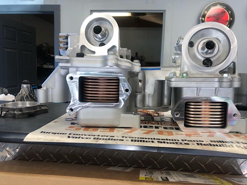

Nope, oil to water cooler. It's an oil cooler from a 2020 L5P Duramax. They're twice the size of the factory LB7 cooler. New one on the left (20 plates) vs the old one on the right (10 plates).

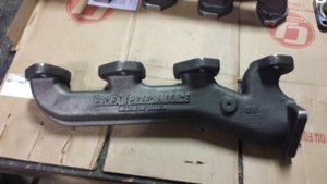

I'm really thinking on getting some ProFab manifolds and up pipes as well so I can replace everything at once and prepare for when I get the transmission built.

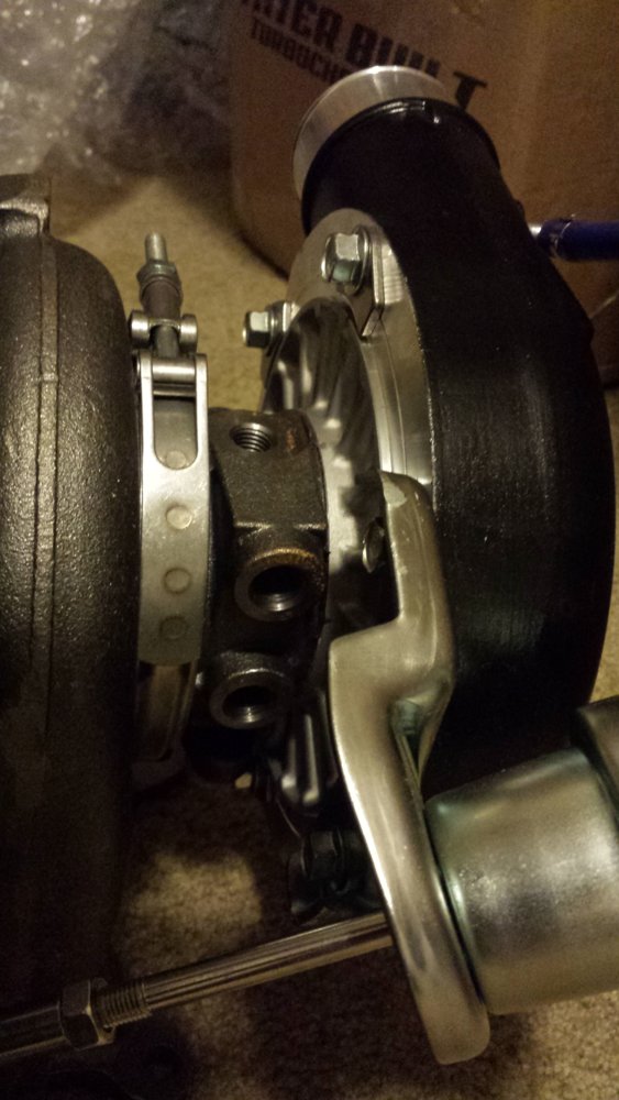

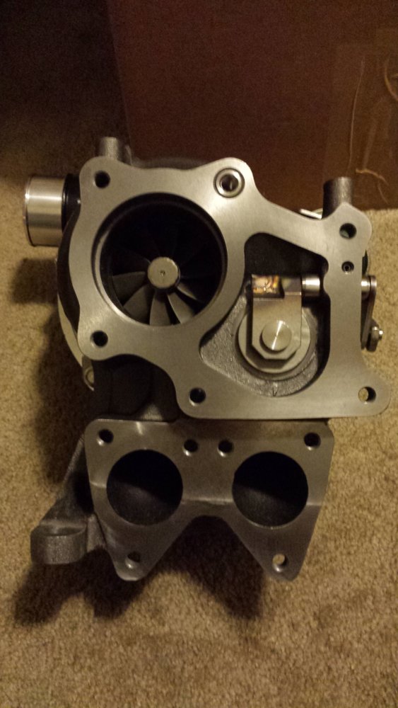

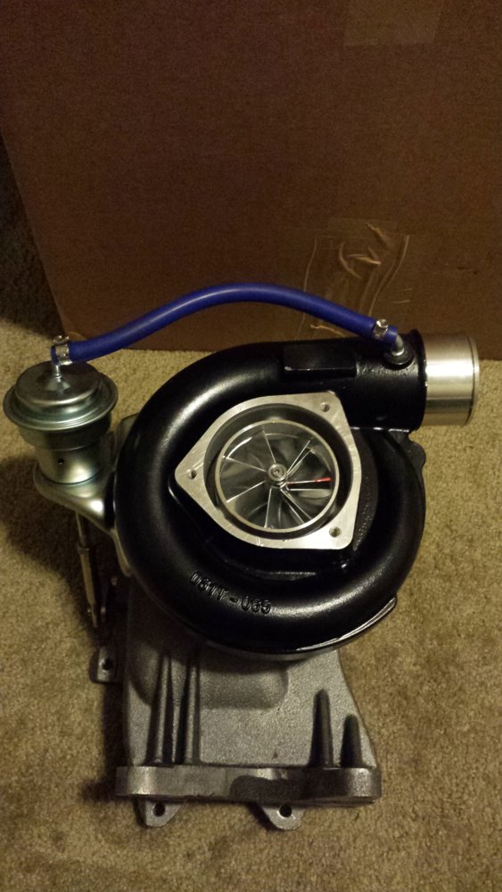

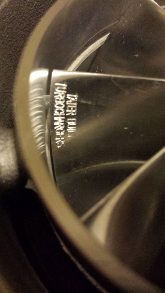

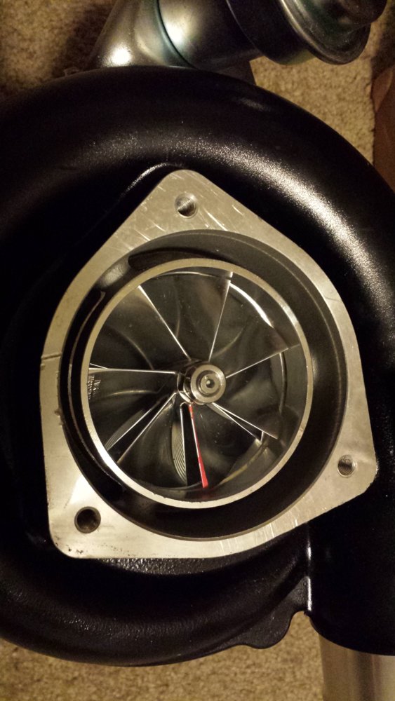

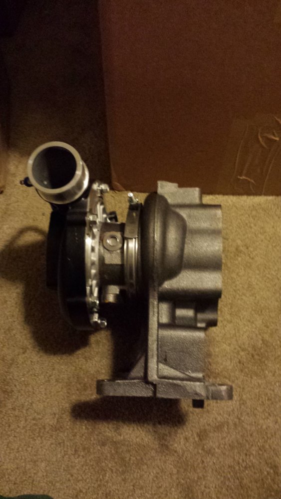

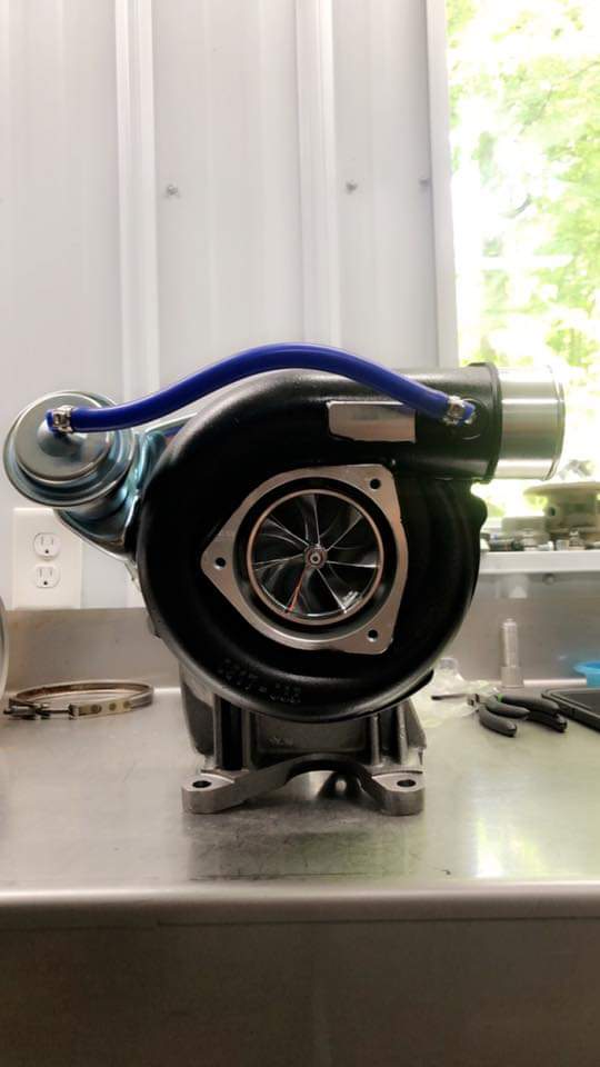

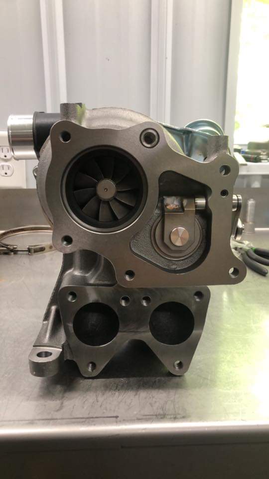

The new American atmospheric amplifier is from Tater Built Turbos. It's a 67mm compressor wheel with a 67mm turbine in a stock appearing IHI housing and built from new castings. Even with a 67mm compressor wheel, it's lighter than the stock (60mm) wheel by almost 20 grams, so it should spool quite nicely and work well for towing and take less drive pressure to get it moving.

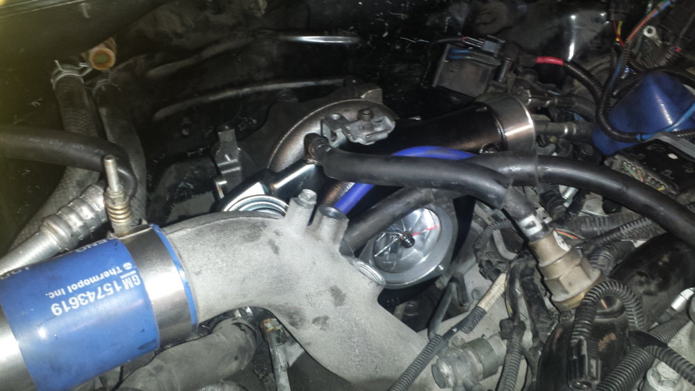

Looks like the rest of the parts won't be here until next week, so I may go ahead and swap the turbo to see how it feels with the stock manifolds and up pipes.

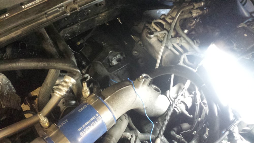

LB7 turbos suck ass to change and don't let anyone tell you different. Pretty labor intensive and it involved numerous stops to figure out how to get more leverage.
Anyway, old one is out and the new one is in there. It sounds crazy and spools pretty damn quick. All in all, still glad I did the damn thing.
I almost forgot to mention that I only broke one heater core fitting (it was original and very brittle) and the AC manifold that bolts to the top of the compressor. You kinda have to lay on top of the motor and it's right there....plus, it's 17 years old. Oh well!

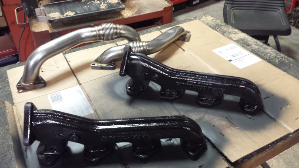

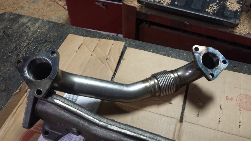

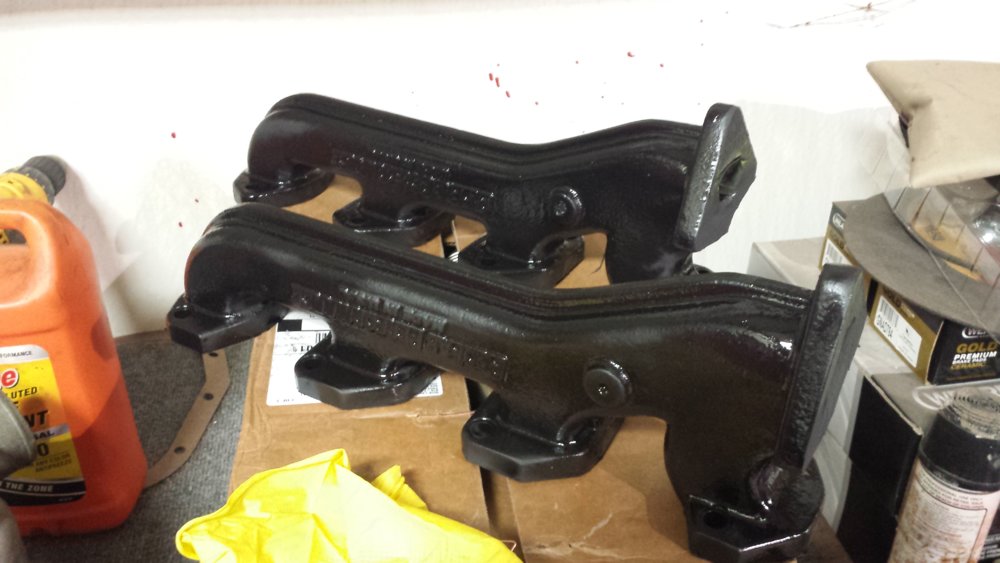

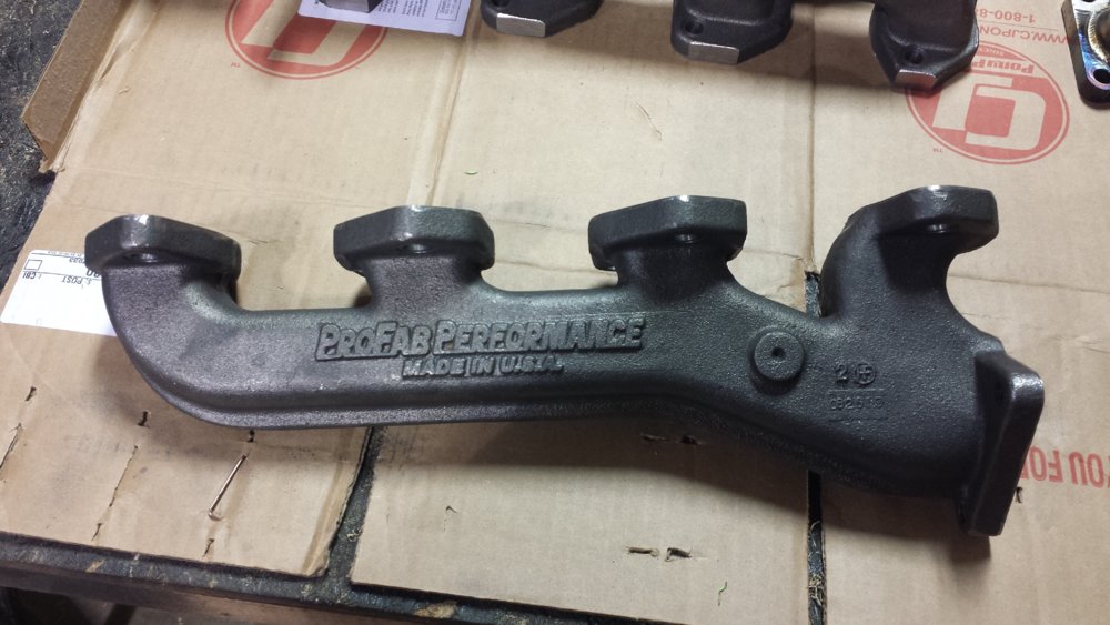

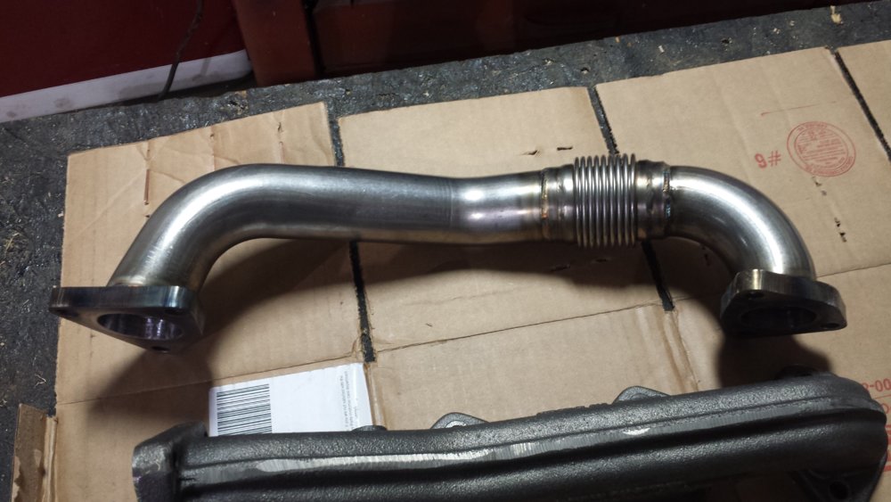

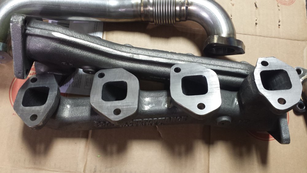

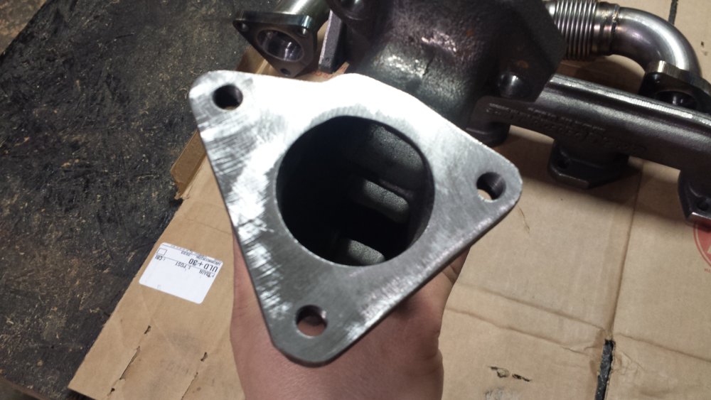

The exhaust manifolds and up pipes came in Friday (11/29), but were scheduled for Monday (12-2). That was far more convenient since I could go ahead and get some paint on the manifolds well before they get installed. The up pipes are stainless, so I'll probably just leave them be.
I'm using the 2200 degree Rustoleum paint. I've used it on headers and exhaust parts on my K30 also and it holds up quite well once it bakes on. It sprays kinda like powder once you shake it up real good.
You can see the nice flowing radii in the new manifolds and up pipes. That's really more of what I'm after. The stock stuff is pretty abrupt with short bends, 90 degree dumps, and a choked off driver's side manifold. I'm in it for the long haul, so I saw them as an investment.
I've seen a little reduction in EGTs with just the turbo so far and I'm hoping to see some more with these and a little bit of tweaking to the tunes.
Looks good. I've had good luck with the vht header paint. Probably a very similar product. Don't remember the temp rating off hand, but I'm sure it's similar. Really smells the first time it gets heated up, which bakes it onto the metal. I'm sure the Rust-Oleum product you have is the same way.

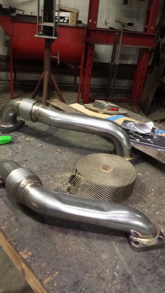

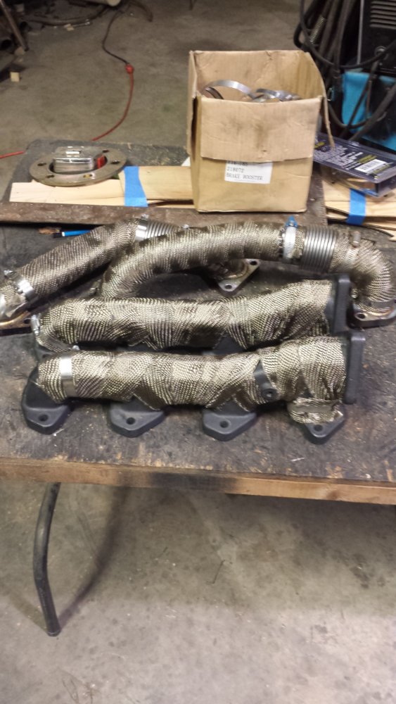

Finally got around to installing the ProFab exhaust manifolds and up pipes last night/today. Definitely nice pieces with lots of attention to detail. After lots of scrapes, scratches, cuts...they're bolted in and I wrapped everything first just for shits and giggles. I can feel and hear an improvement, but I can't comment on EGTs just yet since I broke my thermocouple. I've already got another one on order.
No pics of them installed. I was tired, disgusting, hungry, and you can't see the damm things anyway...but here's the before/after of wrapping them.
