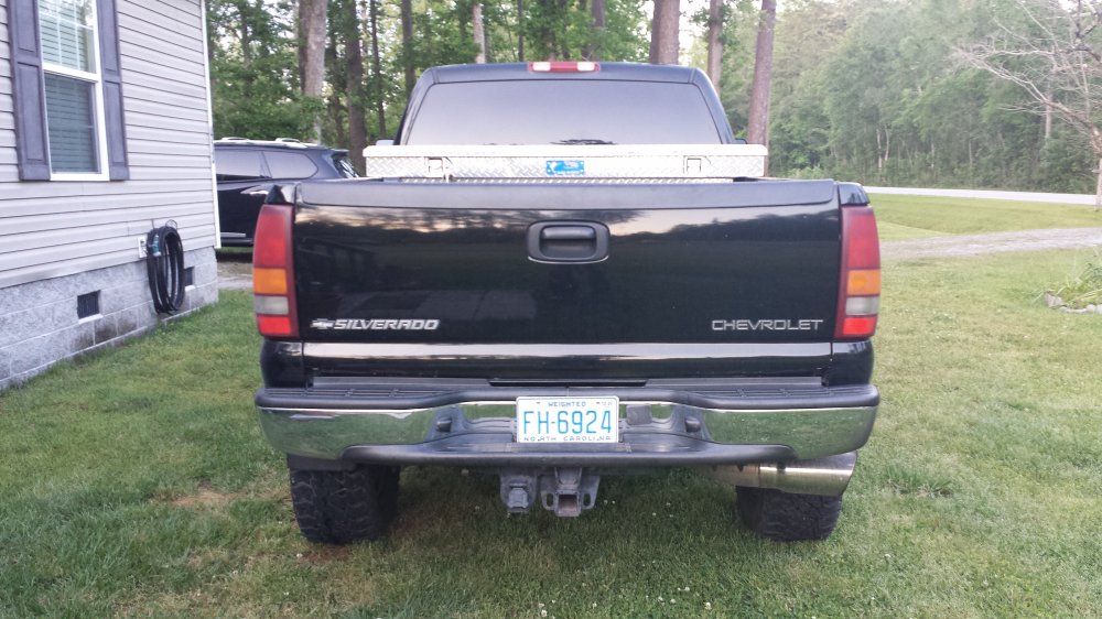

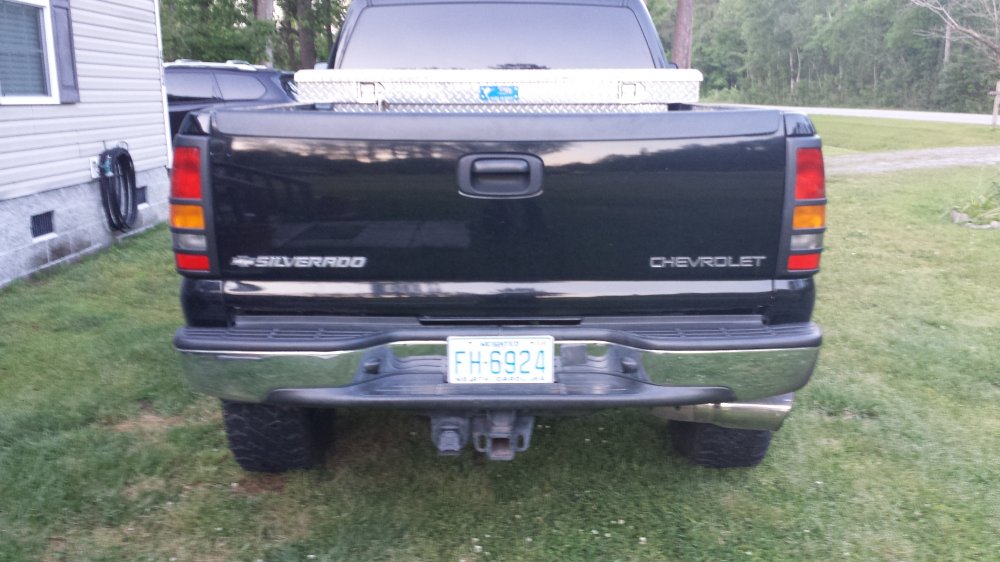

I decided it was time for some better looking tail lights and always like the black trim around the ones that came on duallies. So...I made it happen. Looks much newer and they're much brighter now. Now bad for 100 bucks. I got some new fog lights too. One of the lenses fell off a few years ago. I think they'll be here tomorrow. Probably time for a new third brake light too.

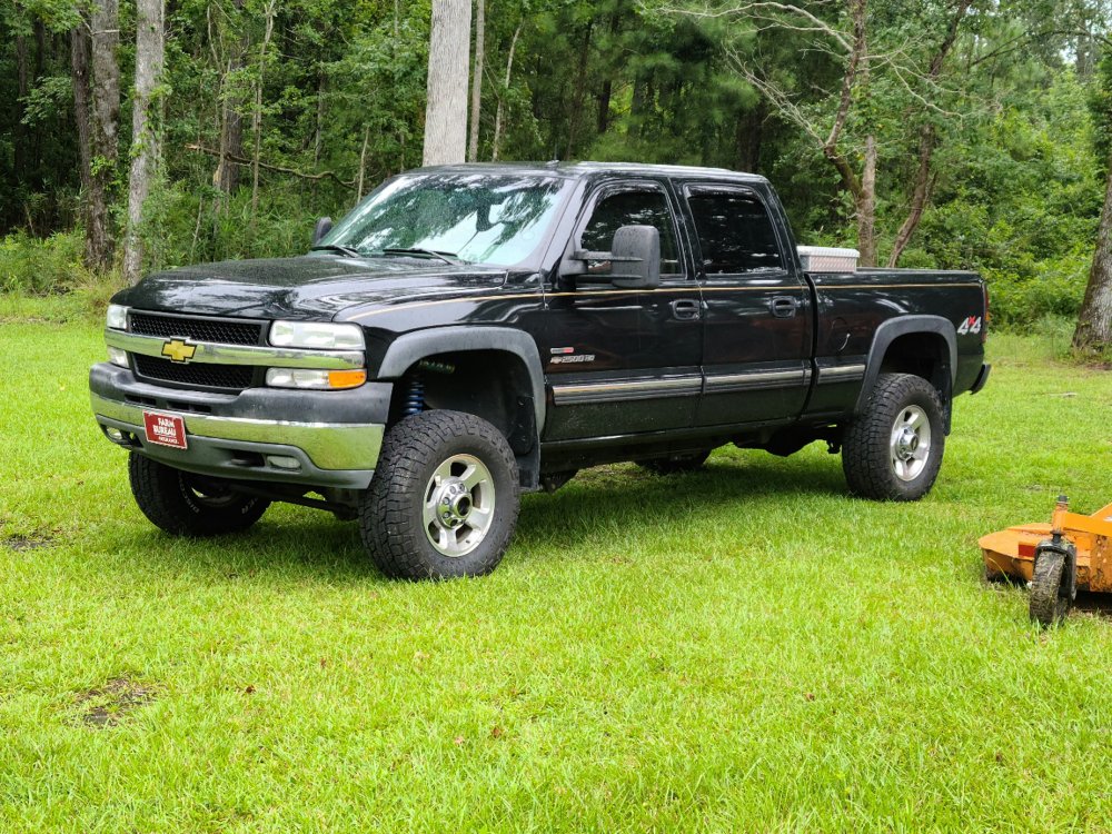

Oh, and I clay barred and waxed it the weekend before last. It's smooooth as silk now and shines up pretty damn good for an 18 year old truck with 293k miles on it.
It's just that big ol' wide ass that makes them look fatter :D
Never been much of a fan of painting plastics...plus I don't want to spend more on the painting and tinting than I did the lights themselves

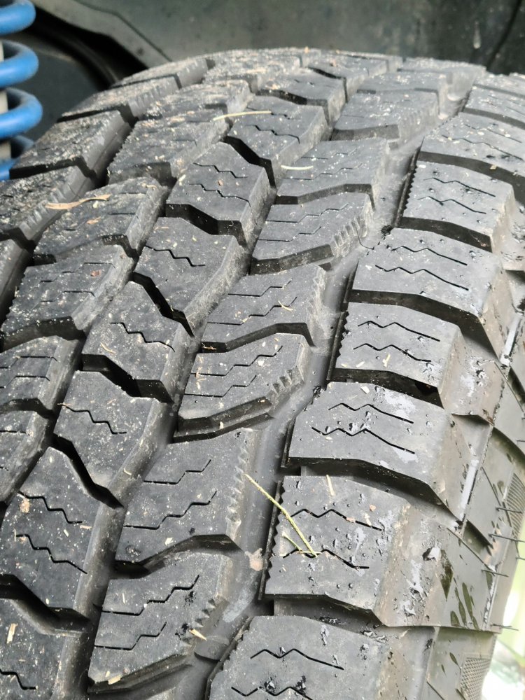

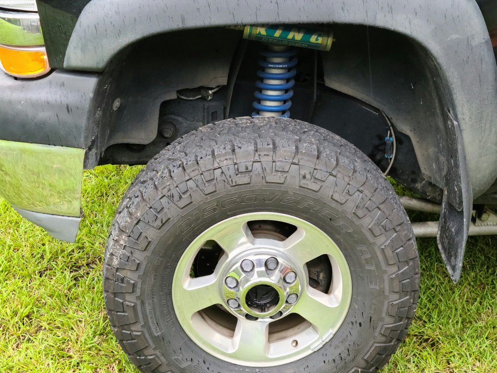

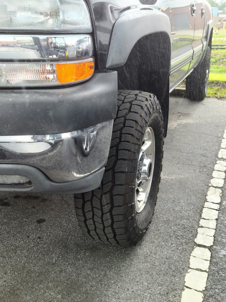

It'll soon be time to change the oil again and send in another analysis. This go 'round has 20,000 miles on it. I'd imagine in the not toooo distant future it'll be time to put the new set of tires on. I've had a set of 295/70-17 Cooper AT3 XLTs sitting in my shop since last August. These ST Maxxes have been surprising me though. 48,500 miles on them and looking like I may get 55,000 or so before they're gone. No complaints here!
They probably had another 10,000 left in them if I had run them bald, but I got tired of listening to the old tires and swapped the new ones on. I know it's irrelevant in an LB7 with 5" exhaust, but damn, these things are quiet!

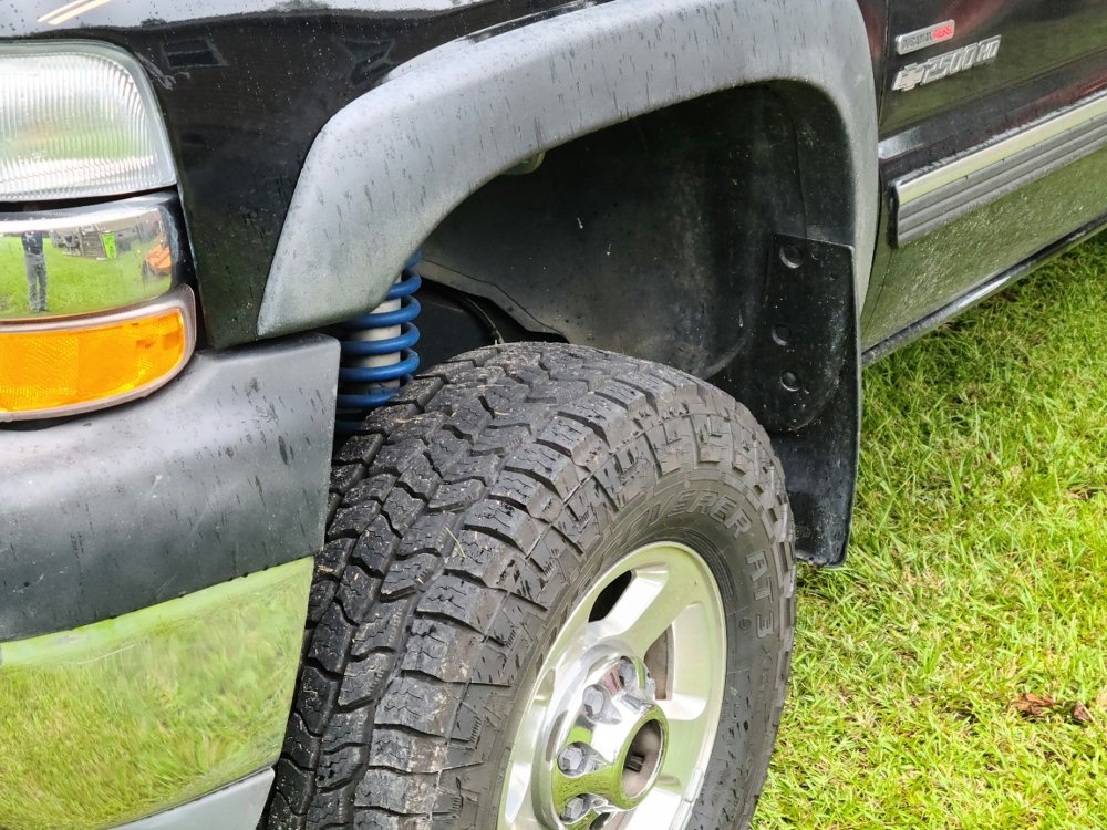

Took off the old Cooper ST Maxx with just over 55k on them, so I have high hopes for these too. Plus, it's nice to get the tire height back and have my speedometer correct again. They're not quite as squared off at the shoulder and look a little narrower, so they make the truck look a hair taller to me. I like it!

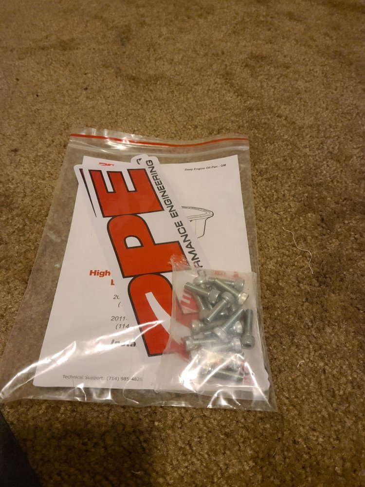

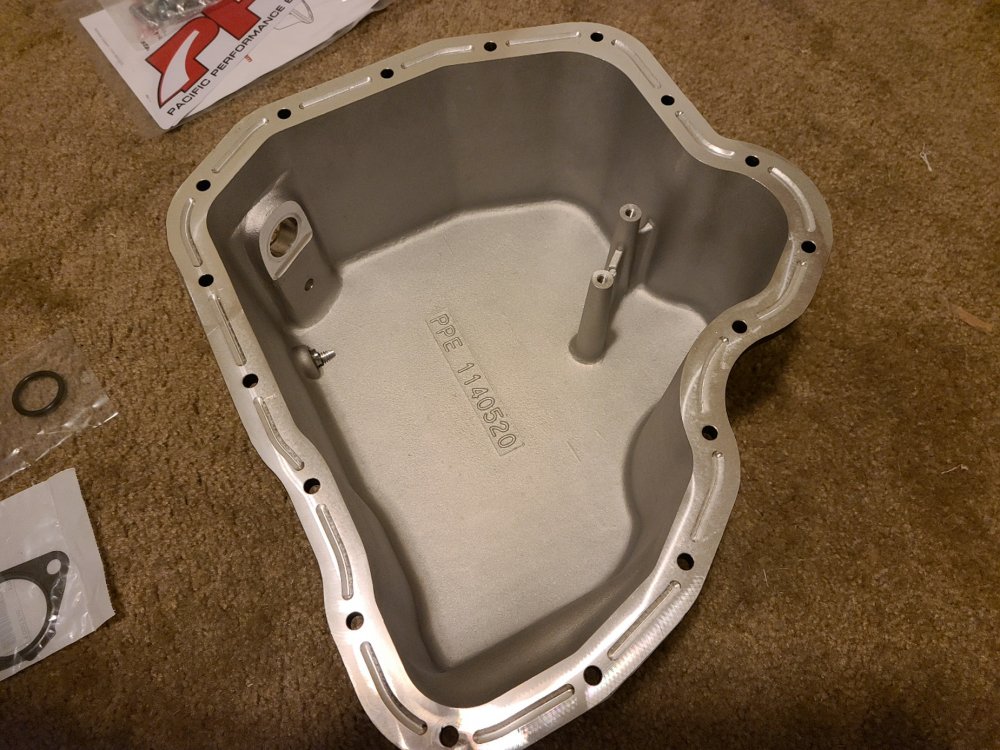

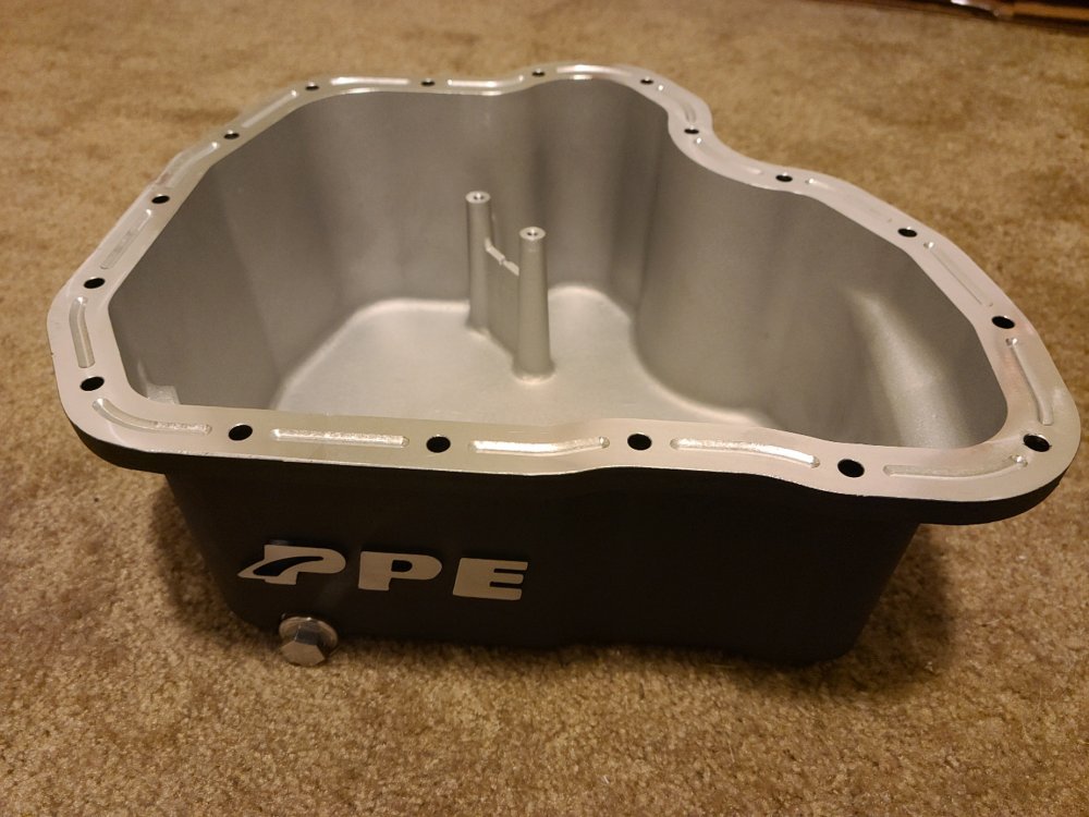

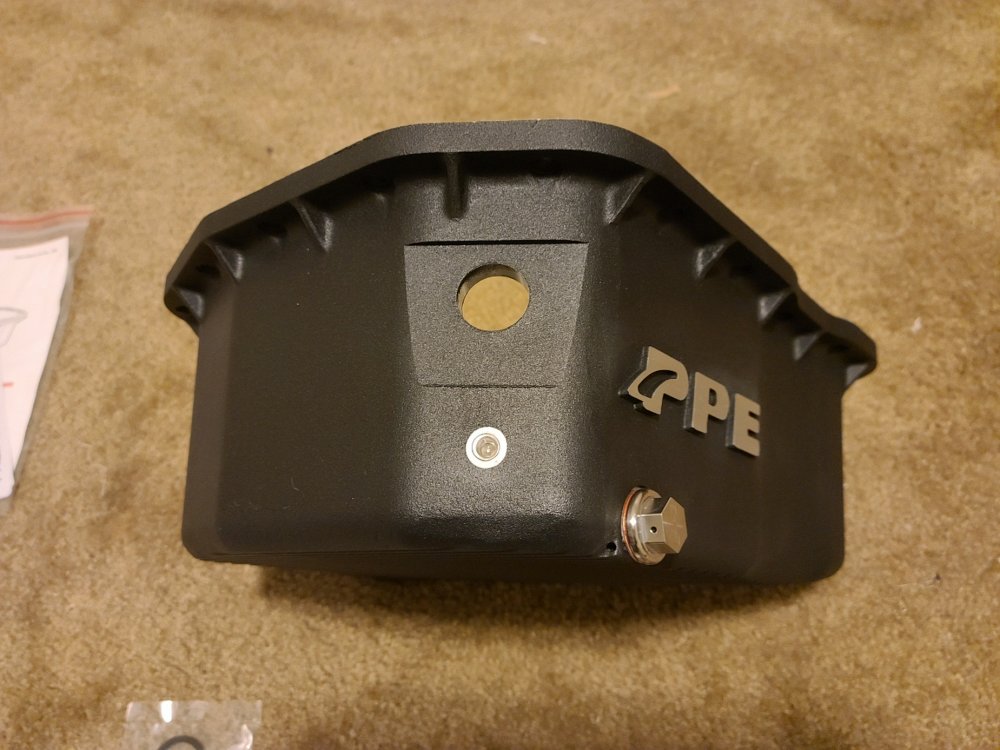

Since I'll need to change the oil anyway, I figured I'd splurge and replace the lower oil pan. PPE makes a nice one that adds another quart to the sump capacity and has a flat bottom so all of the oil actually drains out. It's just one of those things I wanted to do, so screw it...why not? It also has a threaded hole for an oil temp sending unit. That means my next project will be buying a temp sending unit, EAS expansion cable, and starter cable for my Edge CTS2 monitor. Then it will monitor and display oil temperature. Since the harness will adapt two sensors, I'm planning to get a pressure sending unit and let the CTS display oil pressure too. I want to nerd out and study the oil pressure vs temp with the new cooler. Ideally, I'd do a before and after, but screw it.

- PPE hammered black finish oil pan

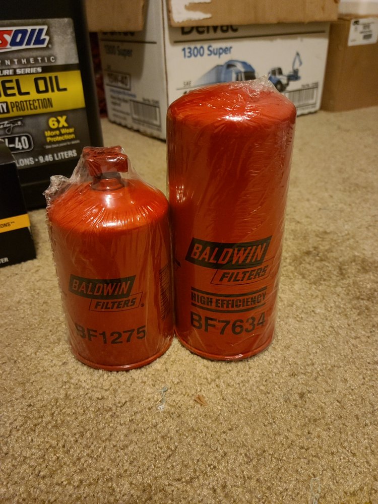

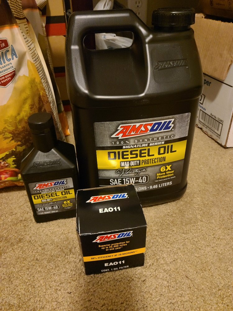

I run Amsoil filters and their oil. Old filter was an EA052 and the new one is an EA011. Sump capacity is now 11 qts vs 10. I wish it was an even 12, but whatever, right?

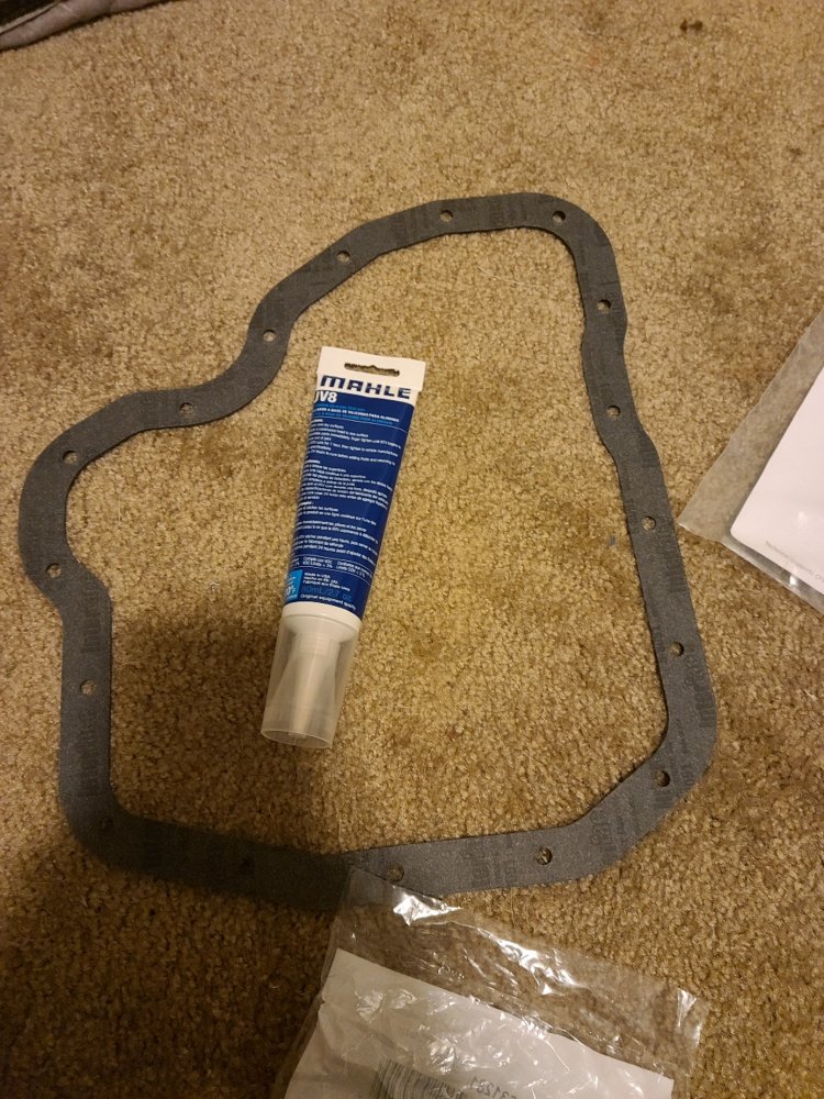

I took some pictures of the oil pan and other items I have for the oil cooler install that I'll include. I'm pretty jazzed about all of this. I'm hoping to get the fuel tank and have it installed before next Thursday. I have to go to Maryland for work and it'd be a nice maiden voyage. We'll see though.
Once the oil cooler and associated items arrive, I'll be changing the oil, putting on the new oil pan, swapping the oil cooler, rotating/balancing the tires, and changing the fuel filters on the lift pump. I will likely have to relocate the lift pump to make room for that big ass tank. It'll either need to go as far forward as possible or be relocated to the outside of the frame rail. We shall see!
The oil pan has a flat bottom and all of the oil can drain out. The drain plug is magnetic. "Supposed" to offer some extra cooling. Pretty straightforward though. Take the old one off, swap in the low oil float, and bolt the new one in place. It was one of those "just because" purchases. Although, it does have that 1/8th NPT hole for a temperature sender. Comes with some nice stainless SHCS. I went ahead and got a Mahle gasket and sealant kit for it. PPE sells them with a hammered black finish or raw aluminum. I thought the black one would be more aesthetically pleasing.

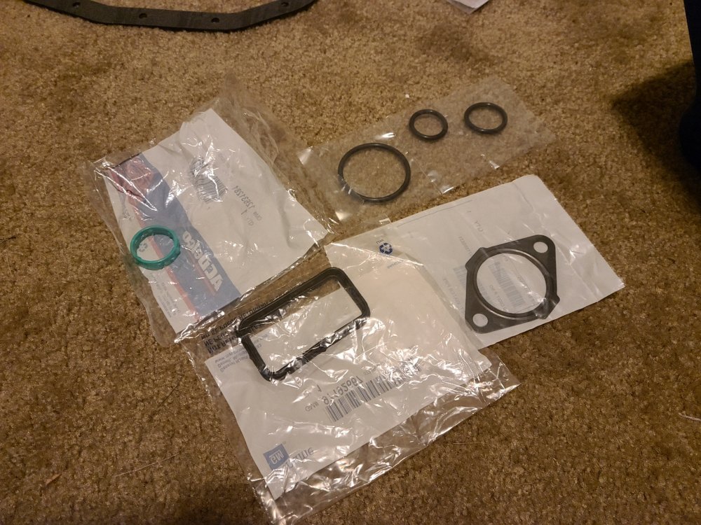

The various o rings and gaskets are for the oil cooler install. Only other thing I need are some different length 8x1.25mm bolts.
Then, obviously, you can see 11 qts of Amsoil, the Amsoil filter, the Baldwin fuel filter, and Baldwin water separator.

Much to my surprise, I got an email from GM Parts Direct this afternoon. My oil cooler, the coolant elbow, and gasket will be here tomorrow! That was much faster than I expected them to get it directly from GM. I'm stoked!
Coolant Elbow PN- 12675428 ($8.91)
Elbow to Cooler Gasket PN- 12676826 ($3.14)
2020 L5P Oil Cooler PN- 12706188 (Replaces Part Number 12701592) ($209.87)

Can confirm that all of these part numbers are correct as I received the proper parts. I will likely do a link back to this build thread from the General Tech area like I did with the transfer case so it will make it easier to find for those who Google "2020 L5P Oil Cooler Upgrade". I found information on it, but nothing with definitive part numbers or pictures of what you ordered. I was astonished that the coolant elbow was only 10 bucks. The one for the previous generations is like 70 bucks. Plus, yall know how I love a good tech thread with lots of pictures :D

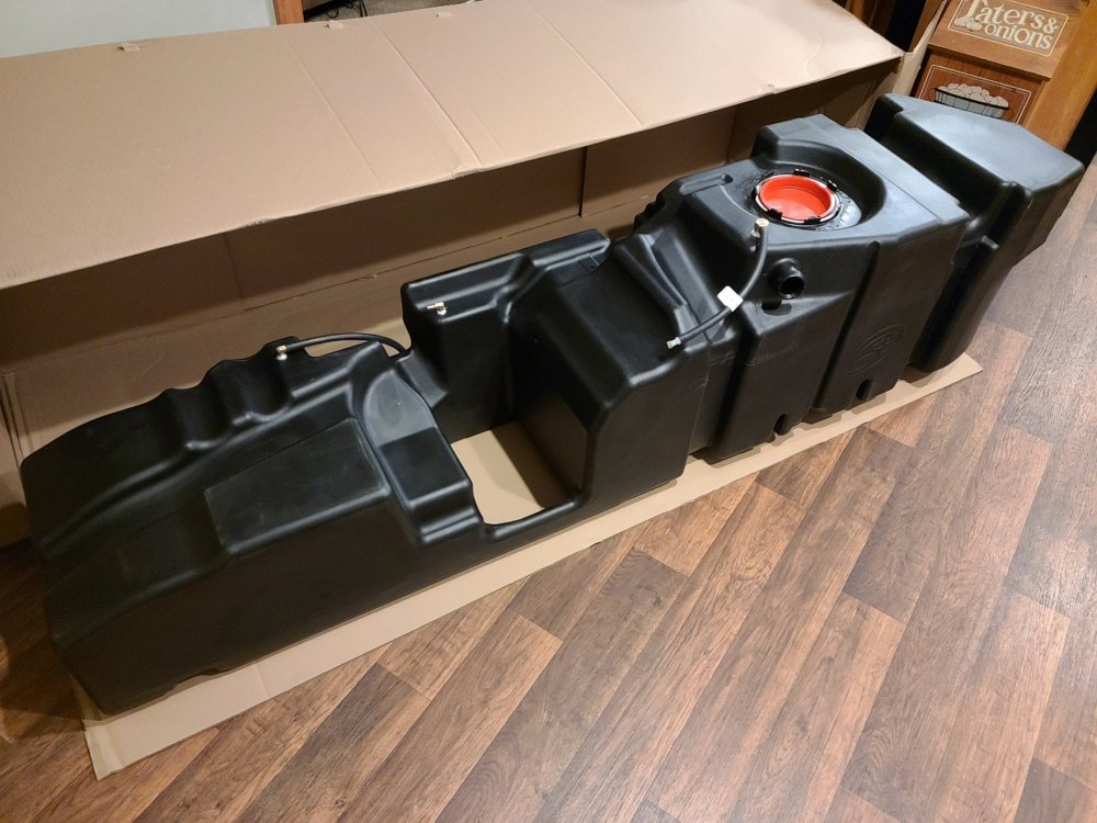

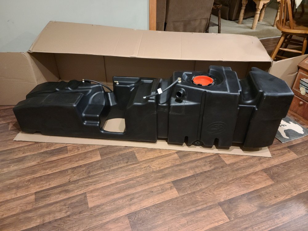

The last new, nifty thing I ordered showed up today!

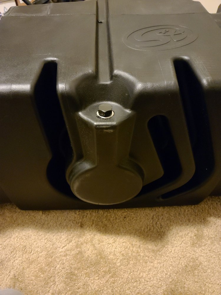

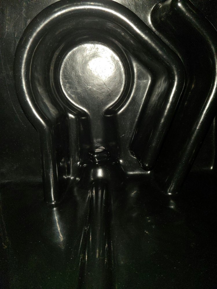

Ha! Not any more! This is a HUUUGE bitch :D Note the thought that went in to the built-in sump and baffles with a threaded hole on the side of the tank for those of us with aftermarket lift pumps! There's even a molded slot to tuck the fuel line in to and run it up and over the tank. This is a really nice and well thought out product. I think they'll do quite well. Especially since every other tank like this is only 52 gallons.
Oh...it also comes with new tank straps thag are powder coated, a front crossmember/support since the tank is so long, a new sending unit o ring, new lock ring, and a really nice, aluminum topped, pickup assembly that has a new fuel level sending unit on it and a new float/arm to match the tank as wellnas clear the baffles around the sump. The only other thing they COULD include that they didn't are some 1/2 NPT to AN fittings. No big deal though. I'm sure everyone's setup is different and I ordered a 1/2 NPT to -10 AN fitting and a few 1/2" double barbed hose fittings from Summit just to make sure I had what I need and could extend a few of the AirDog fuel lines if need be. Still, a very very excellent product!
Picked up one of S&B's new fuel tanks. 62 gallon capacity. Stock short bed tank is 26 gallons and I have an issue with the little rubber seal in the bottom of my fuel pickup cup and can only reliably draw about 19 gallons out of it. It's really annoying and I hate going to the gas station every couple of days. Now, with a 1000+ mile range, it'll be more like once a month. Plus, it's reallllly annoying on road trips or any time I'm hauling anything.
I'm leaving in the morning for Pax River, MD and was hoping to get this in the truck before I left, but I'll probably do it this Saturday or Sunday after I get back. It'd be really nice to up for 1.86 a gallon here and not have to get fuel until the middle of next week. Oh well...next time.
I can't wait to get back and get this thing bolted up in the truck! I am going to keep an eye on fuel temps with my Edge CTS2 monitor since the tank goes around the fuel cooler. I can always move it if there's not enough air flow across it...or add a fan to it.
Gawd dayum that's a big bitch! She ought to be a ton of fun to hoist up into her new home.
The tank itself isn't all that heavy, believe it or not. I'll probably go to the hobby shop though just so I can use a lift. I'll likely do the oil pan and new cooler while I'm at it. Oil pan first so I can let the RTV set up for a little bit while I do other stuff and before I fill it up with fresh oil.
