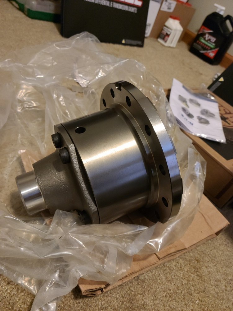

They'll swap, but, the AAM version is a 2:1 bias and the True Trac is a 3:1 bias...from what I've read. In a nut shell, the Eaton version is tighter. Plus, I'm not entirely sure, but there may need to be a spacer involved to take up the space for the tone ring. Does Dodge still do that? I can't remember...
Plus, I don't think ECGS has any of those in stock right now. Even when they do, they're still close to 850 bucks. I'd just as soon have the same rear unit as the front.

Basically every traction aid for an 11.5 is 1000 bucks. Give or take.
I kinda wish they made an E-Locker for the 11.5s. That'd be the best of both worlds.

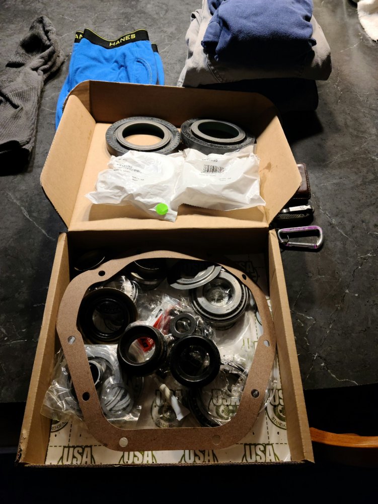

Anyway...got my stuff in from ECGS today! I'll probably ride up to @iwaxmyjimmy 's house to do it. I don't have the stuff to pull and press bearings. Other than that, it's pretty simple. I did spring for the knuckle seal install tool when I originally put the axle together. It makes life a lot easier.
Nevermind my freshly cleaned drawers on the kitchen island :D Damn using RTV on a diff cover any more...ever since I got the AAM cover for the rear and it came with a Lube Locker style gasket, I'll use them on everything from now on! BTW, True Tracs are hefty! Then again...there's a lot of steel all up in there. I'm ready to get this thing put together and not leaking.

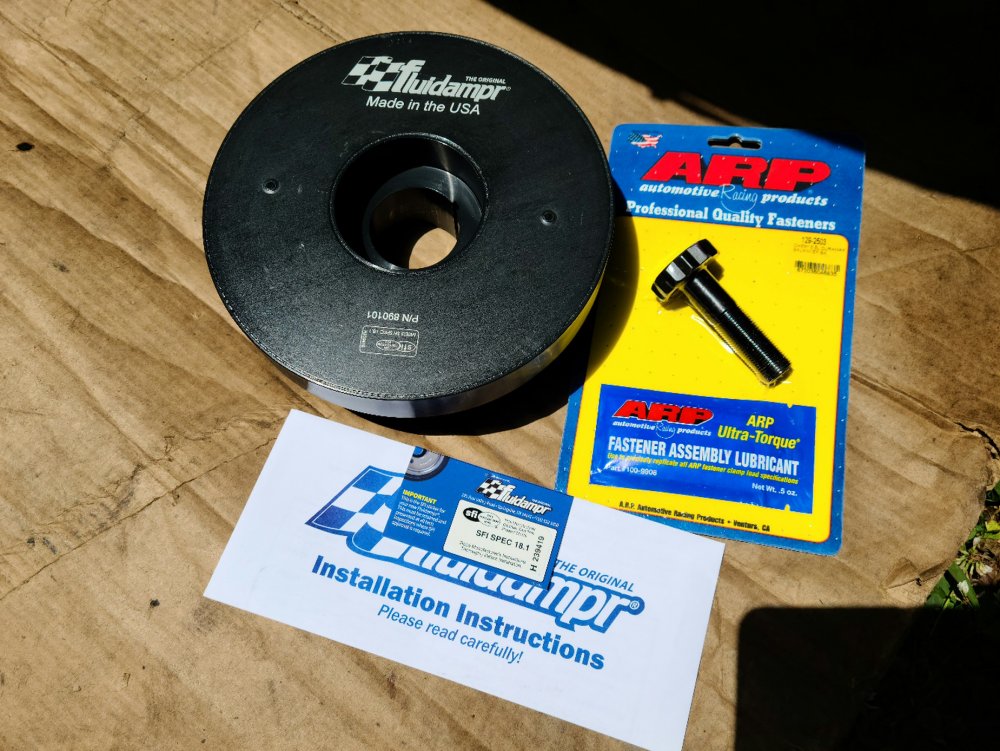

Totally forgot to post this, but I picked up a Fluidampr for this rig finally. Had to make several calls to find anybody that had one sitting on the shelf that they could send me. I also got an ARP crank bolt because...why not?

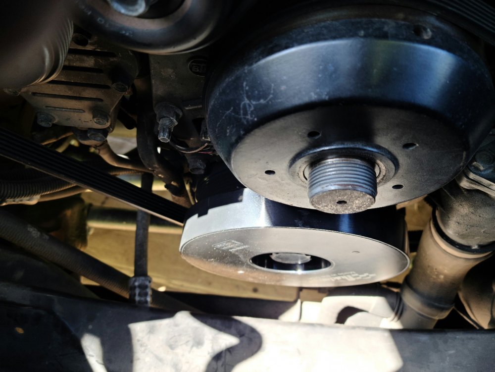

Results thus far: idles smoother and much less rattle in the interior. I noticed what little bit of driveline vibes I had are all but gone. The truck just feels smooth all around now. I doubt it'll change the fuel mileage any, but I check it every time I fuel up, so we'll see.
ARP says to torque it to 325 ft/lbs. My torque wrench goes just past 250, so I set it at that, it clicked, and then I went until I couldn't turn it anymore. Good enough. The stock balancer that came off looked fine, rubber wasn't cracked up any more than I'd expect, and it wasn't spun in comparison to the inner hub...however, it's definitely more better now. No complaints.
It's still a slip fit like stock, although all of the Fluidampr instructions say it's supposed to be a .0005-.0015 press fit. I'll make a drill guide or pick one up and pin it eventually just so it won't ever be able to shear the tiny little stock crank pin. That'll be as good as having the crank keyed.
I should also mention that this was one of those mods made 10x easier by being able to access it from the bottom without all that pesky IFS crap in the way :D
