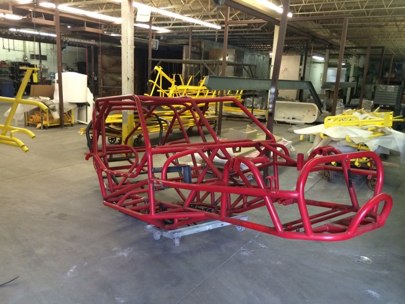

Powder coating relieves the stress from being welded, but is a real pain to touch up from what I have seen, unless you go with a easy to match color like black.
But, what ever you decide, can't wait to se it on the trail!
I like it Guffey!
I think I am going to go with hammered black for the chassis color, haven't decided on the skins yet

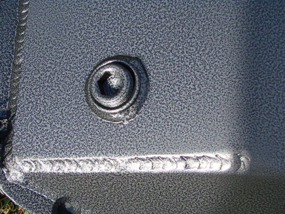

Well I bit the bullet, got a good price to blast it and powder coat it, went with silver vein
It's hammered silver with a black vein

We use the same people for axle housings and control arms on streetrods and restoration builds and when I started discussing my chassis and its intended use they actually talked me out of it.
Pretty much come down to when it starts getting scraped off it just leads to a big mess to try to clean back up. But I will say they do excellent work and cheaper than most people would think.

He gave me an awesome price, $750 to blast, prep and powder coat, the guy I talked to said the hammered finishes are more resilient than some others
I had several other companies quote me $600 to just blast it
I think the silver will be a little easier to match up

Green panels.
Or orange.
I only said that to piss you off! Now, stay with the red and gray theme.
It was your dream, let it roll.
Blue would look really good on the panels
Are you planning to go with the pre painted sheets on the panels?
If so b&h in Asheville can get them for a decent price so thats what im going with on Bernadette.

I thought about blue, but some of my accessories are already red, harnesses and such
