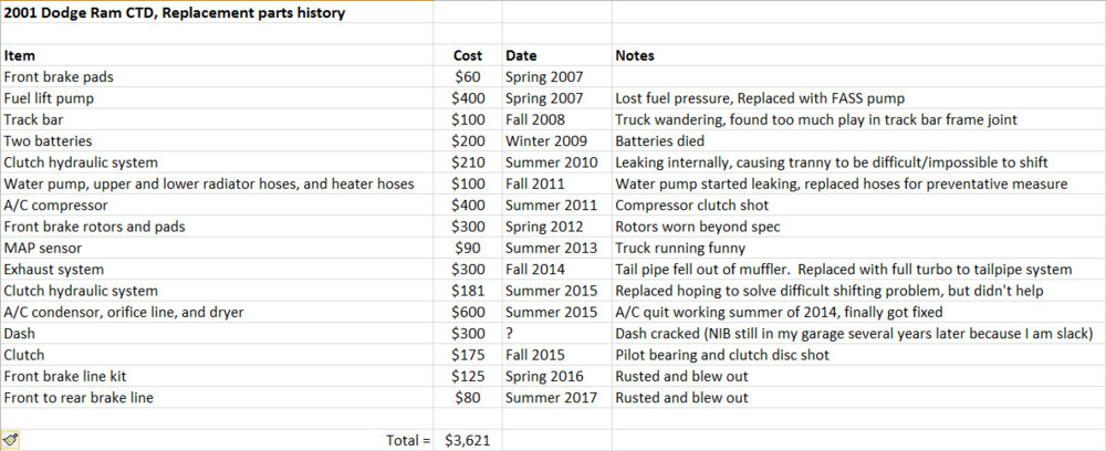

I bought my 2001 Quad Cab, 4x4, 5spd, short bed, Dodge CTD in the fall of 2006 for $15,000 with 166k miles on it. I've still got it and it now has about 230k miles on it (not my DD).
Regarding Matt's post about $50-$250/month in expenses, here are my results. I put this together some time back, and updated with the latest repairs:
$3,621 in repairs over 11 yrs doesn't seem too bad to me.
I've been considering selling it and upgrading to a newer truck (5-8 yrs old) since this one is about to be 17 yrs old. Every time I look at newer truck prices though, I am shocked, and decide to keep it another year or two, LOL.
