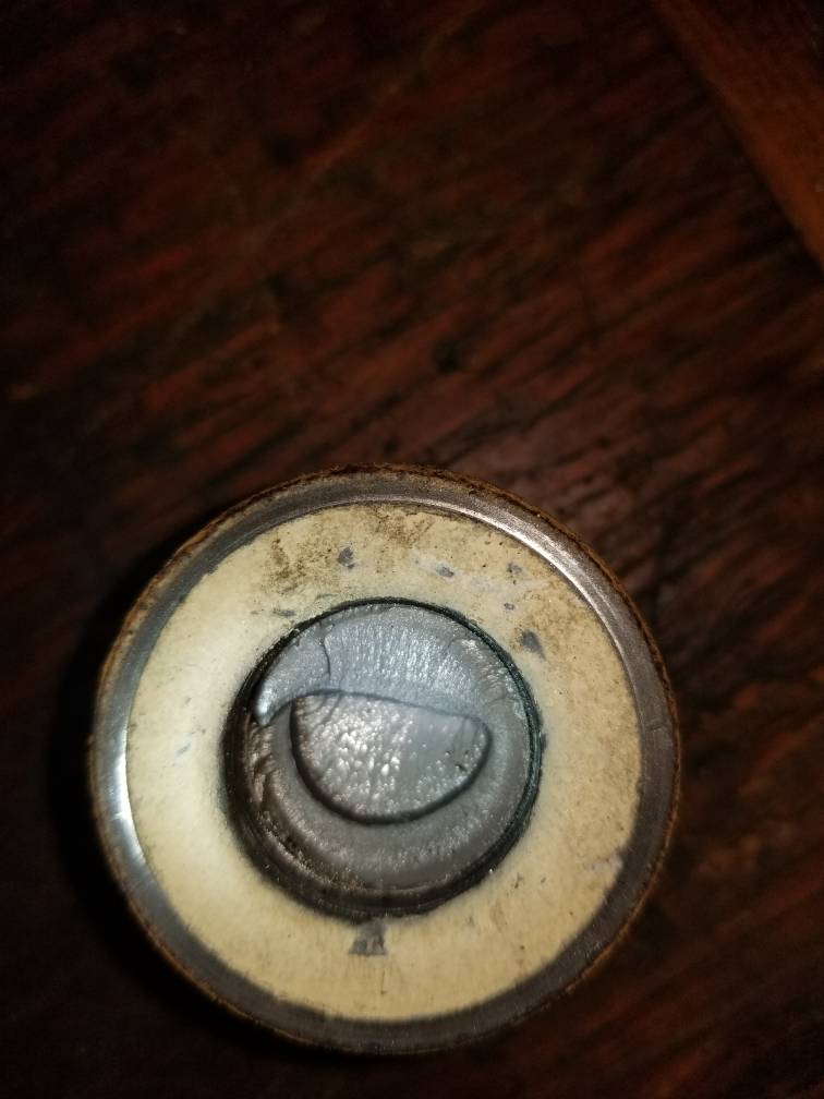

20k miles later and cavitation has eaten through the front cover and put water in the crank case. (no evidence of wear on 50k mi cover upon bottom end rebuild).
I drive it home 2 hours after changing the oil in a truck stop parking lot. Put a new $1000 front engine cover (single pin hole in cover) on over the weekend. Run 3 oil changes through the block before I put it on the asphalt again. On following Monday I drove 100 miles, and now have a knock in the top end....smh.
