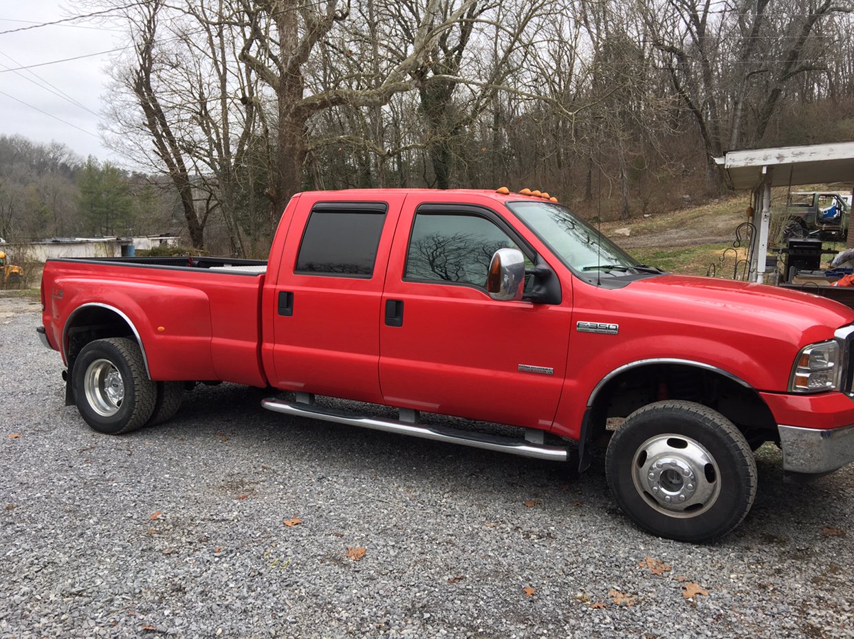

Picked up a new (to me) 06 F-350 CC w the 6.0 today for tow and family haulin duty's.Truck only has 85K and is all stock,Im talking full exhaust w converter,egr system.never been tuned or tinkered with.Lookin to put a tuner of some sort on the truck and,at the very least,do an EGR delete.My old 7.3 has a 6 position DP tuner on it and its been good.Lookin at tuners for the 6.0 and it seems everything now is monitor style and have gone away from the twist knob or push button w display I currently have.Mostly what I have saw are Bully Dog or Diablo sport units.Whats everybody running and what would you do different if you were buying a new one?? Truck has a factory boost and trans temp gauge in the cluster.Are the gauges reliable enuf to just use those and just add a pyro or is that part of the programmers features???If so I assume these unit's monitor all the temps that the pillar gauges use to???
