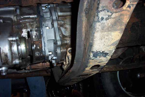

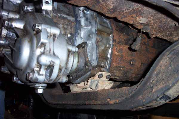

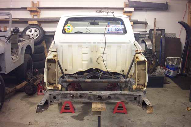

Well we went back to the shop tonight

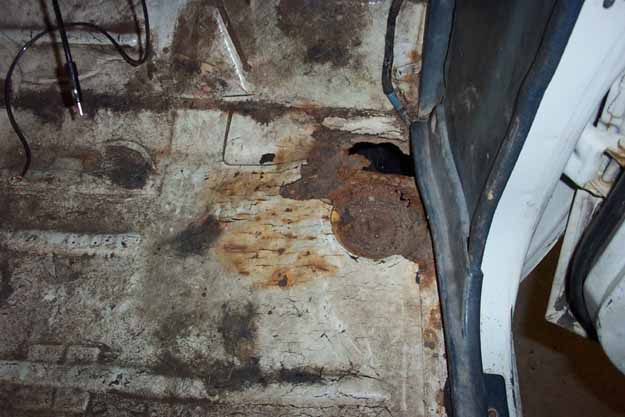

Stripped Cab and figured out what we will cut out and replace due to rust and what we wil cut to raise drivetrain in the air..

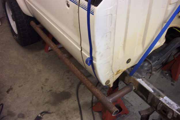

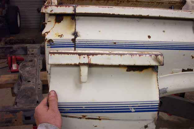

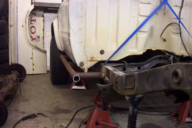

we also took 13 inches out of rear bed sides and tacked them in place to see how we want to dovetail the rear so we can start with some tube

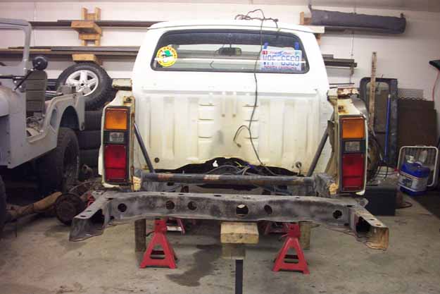

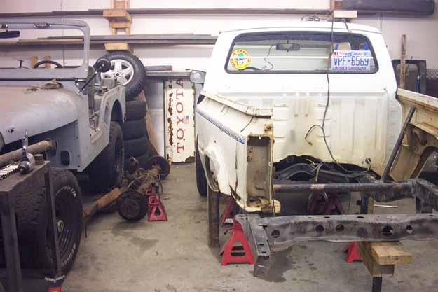

Here is a straight on shot from the rear

looks like a good time to tub the cab/firewall while you're at it.
I will be selling the axles when the front comes out, I think they are 4.10 but I have not double checked.
For the cab we will skin a new floor, and build a new tunnle for the drive train.

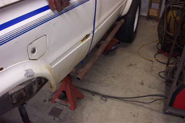

Well we got the Rock rails welded on...
So now we can start the Exo Cage :)

Just curious, what's the blue tape for?
Looks like a good start but if you cut off and replaced the rusty frame why weld rusty tube to a clean frame????:huggy:
Just bustin your chops......dovetail looks cool,whats the plans for the 44/9 combo? You can tell us.:)
StudNuts said:
its a yota....the tape holds it together :flipoff2:
You''re just jealous that nothing will hold your Ford together!:flipoff2: :D

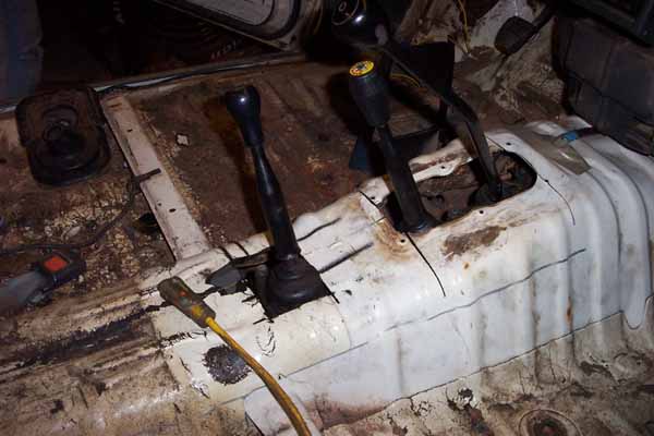

Well We got B Hoop on but I forgot to take pics. we also cut floor and put in a Marlin Crawler Box..
Next we are gonna work more on cage and raise floor to get drivetrain higher up to make flatty bely skid
Well Here are some pics I took tonight of the Drivetrain back in and our temp cuts on floor to get it back in.. we also cut out the entire center section of floor tonight but camera ran out of batteries
