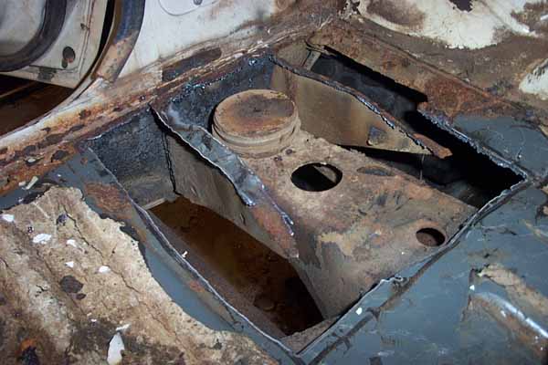

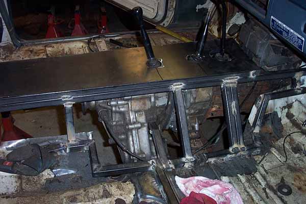

We have a small shop in North Raleigh... (Near Scooters / IE:Twin Specialities)

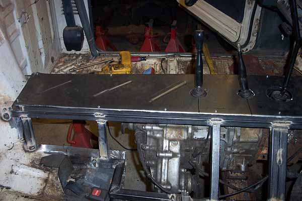

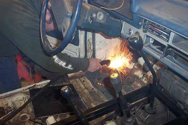

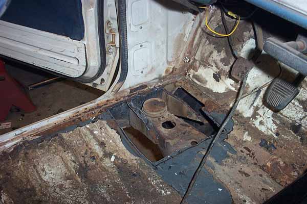

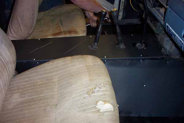

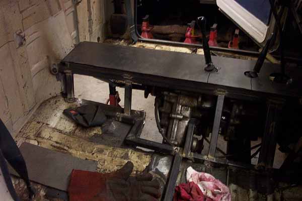

and since JOhn raised the drive train up he had to make a new floor and tunnel.. so here are a few pics of tunnel in progress.
Maybe it's just the angle of the pics,but it looks like the shifters are gonna be waaay up there! Maybe time for a short shifter.

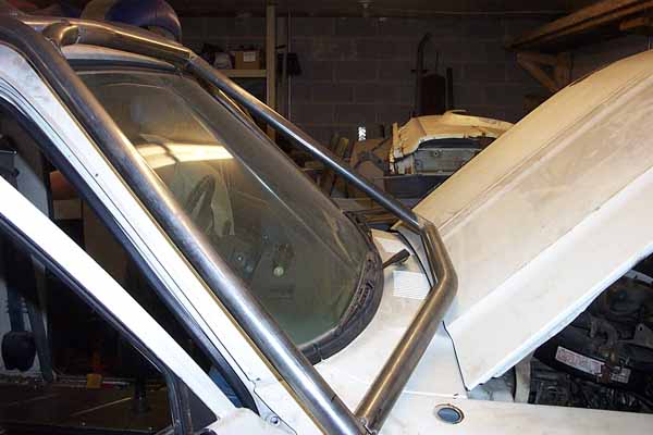

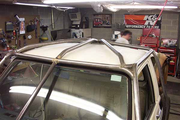

and here are some more updated exo pics

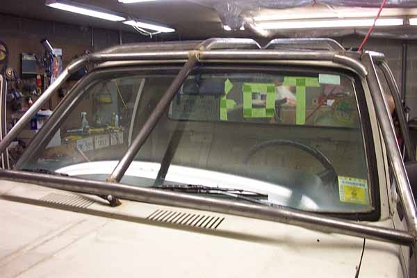

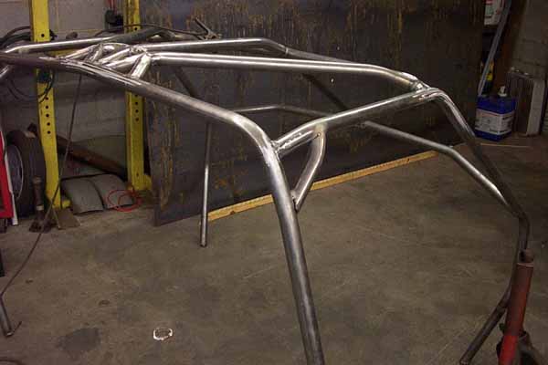

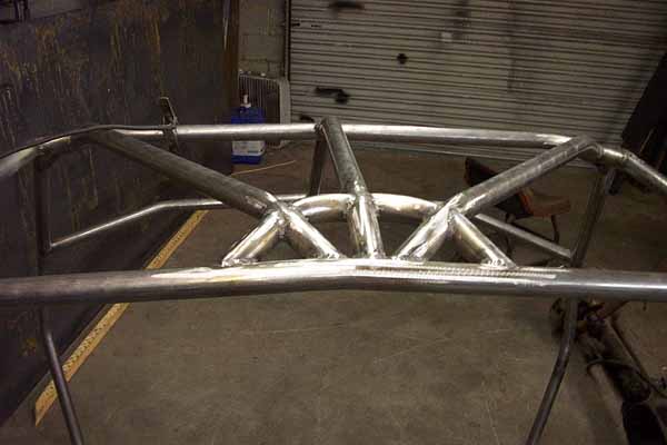

Metto said:
dude...huge gaps are unacceptable :flipoff2:
top center bar
As it is, in my professional opinion, you would have a hard time loading the top center tube in a shear situation thus negating the need for the perfect notch..
in tension and compression, this minor flaw will be undetectable.....as long as the tube is welded per industry standards....:driver:
hey, that looks just like the one I built for shawn(metalmangler):flipoff2:
top center bar
All the juctions will be gusseted, so im not as worried about that gap.
Buggy builder, thanks for the insight.
Unbreakable, i "borrowed" some ideas. its different but not by much.

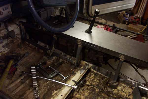

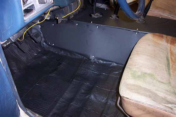

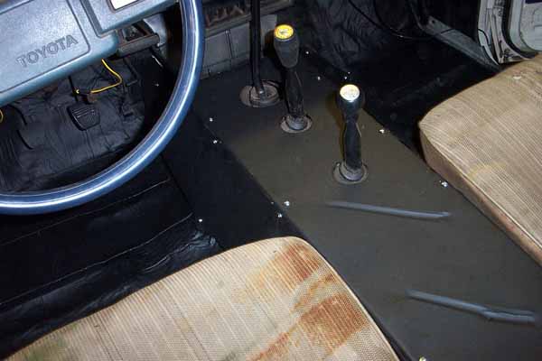

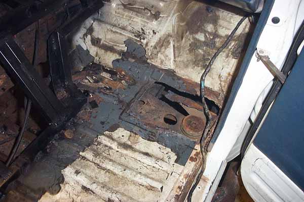

Well doing a little floor fixing tonight

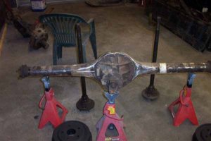

Well we have been working on the toy again.. so things are starting to look up..

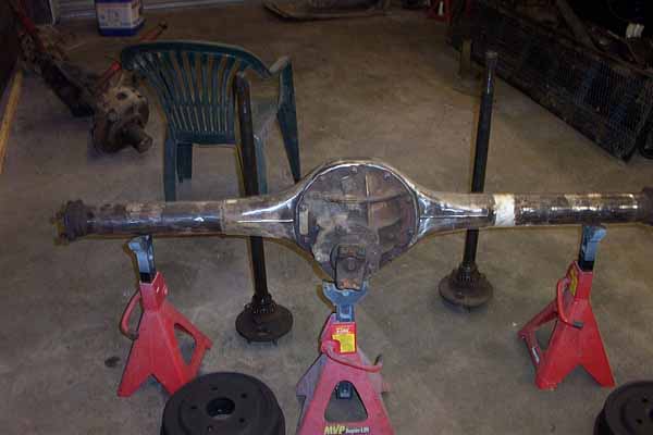

rear 9" axle is cleaned and ready to be rebuilt

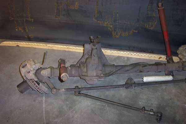

We got front 44 axle.. time to clean that one up..

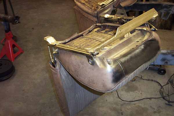

we got seats ready to go in and could not resist the pimp gold paint

add to top it all off we got the interior 90% done :)
Those are sweet seats too - I recognize them from somewhere... ;)
That sure is a fancy floorboard....Much better than when I had the truck. You could see the ground.

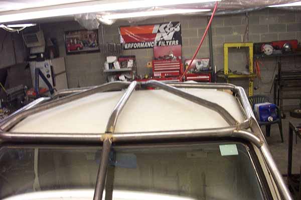

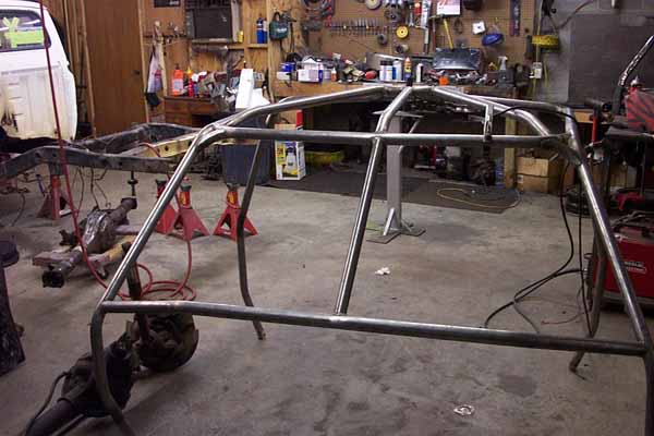

JOhn and his Brother cut off the exo and finished welding it all up.. and tonight John and I painted it to get it ready to go back on..
