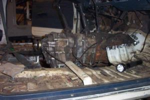

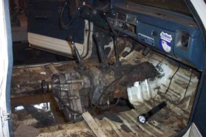

Well we got floor cut and drivetrain raised so it is Flat at bottom of frame rail :)
Looks like we may need to cut out that crossmember and make a new one :)

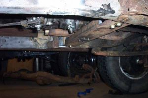

here is bottom showing full flat with NO body lift

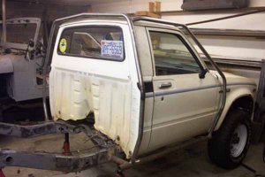

And we started on Exo Cage.. cage looks kinda away from body in pic but it is just the andgle it is at.
Stupid question: Can you "flip it" ? I mean a flat one would impeed the driveshaft movement wouldn't it?
which cross member are you talking about????
If you mean the new one we made we have a way around that - using a 2 piece driveshaft..
The one I was talking about is the one behind the cab that is in the way of the rear driveshaft.. that one will be cut out and we will make a new one that is not in the way anymore
When we do the 4-link, a new cross member will be added to mount the links to. It should be just behind the output flange. The stock one will be cut out.
Ken - a better option IMO would be to clock the second case up. This would let you bring the rear of the cases down, and give you a lower CoG & better rear output flange angle.
I bet BudBuilt can hook you up...
Lowering the back of the t-case down an 1 3/16" is not worth me changing out to the clocked dual case adapter. I dont think that it will greatly effect the COG, but im no expert.

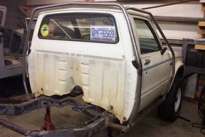

Ok well finally here are some more pics...
We got drivers side bar on and top roof bar and center bar.. so Exo is coming along... hopefuly gonna work on it some more later this week and start setting up rear axle also..

here are the pic showing drivers side and front top roof bar getting ready to be tacked in .

Here is top roof bar, middle bar and little gusset bars :)
