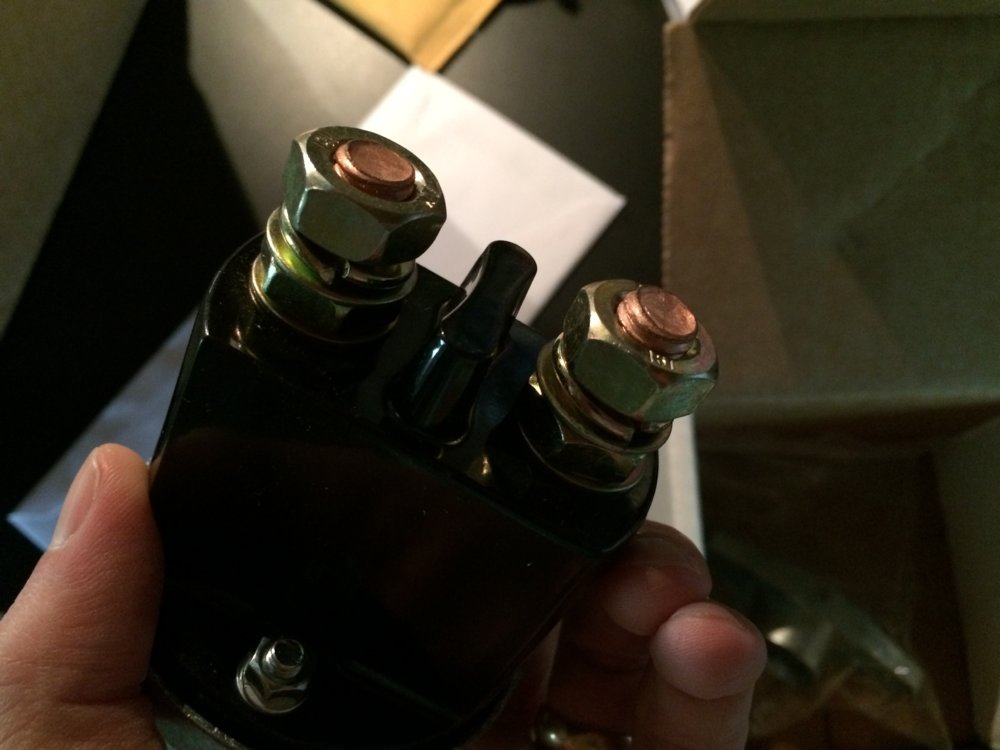

A few small things arrived today from Amazon Santa... Amazanta?

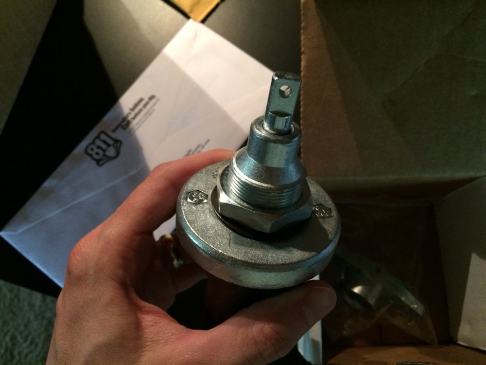

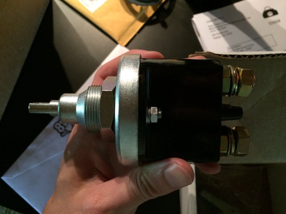

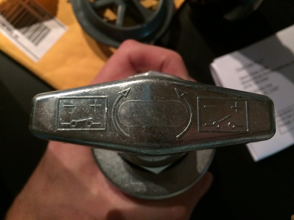

Battery Dr 20257 I'm going to use this for the main disconnect for my winch. I was originally planning on mounting it directly to the winch plate on the bumper, but I think I'm going to install it under the hood, on the passenger side fender.

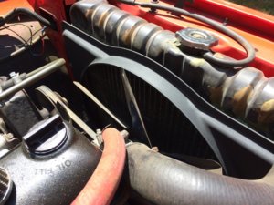

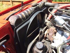

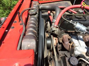

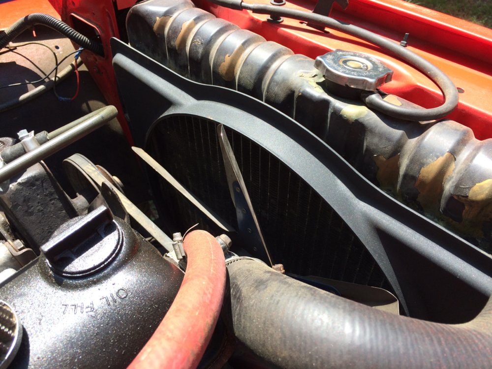

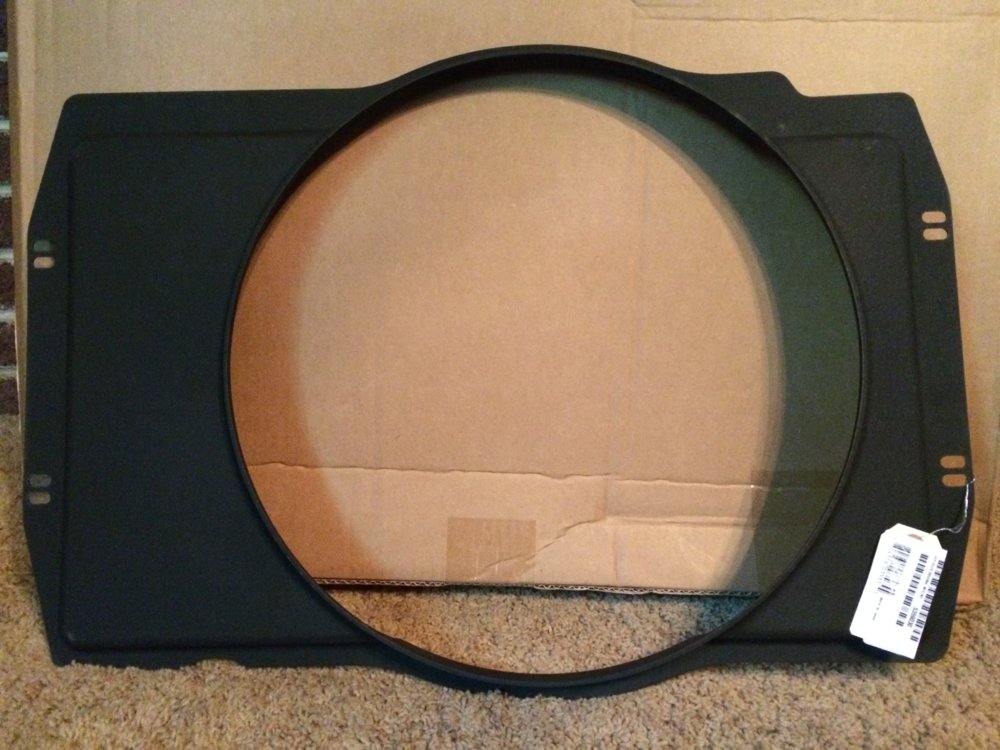

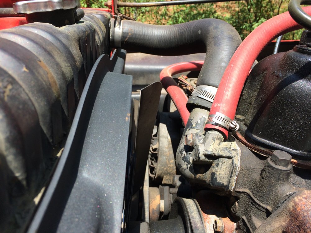

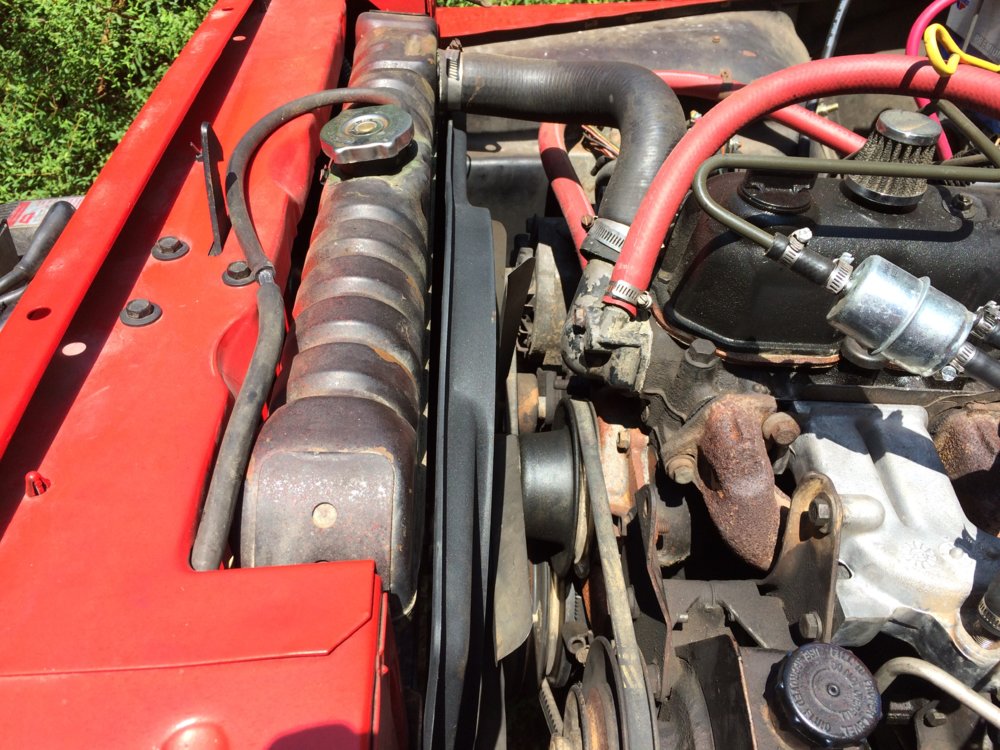

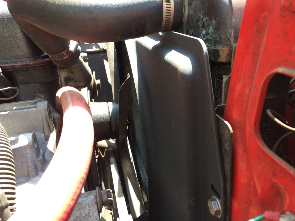

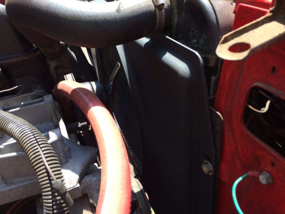

I also ordered a fan shroud. My Jeep didn't have one, and some didn't come with them from the factory. With the heat we've been having I can't imagine it won't help though.

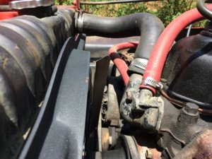

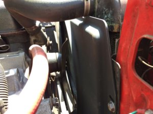

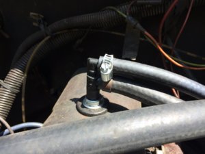

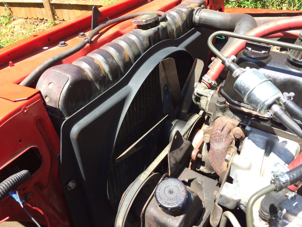

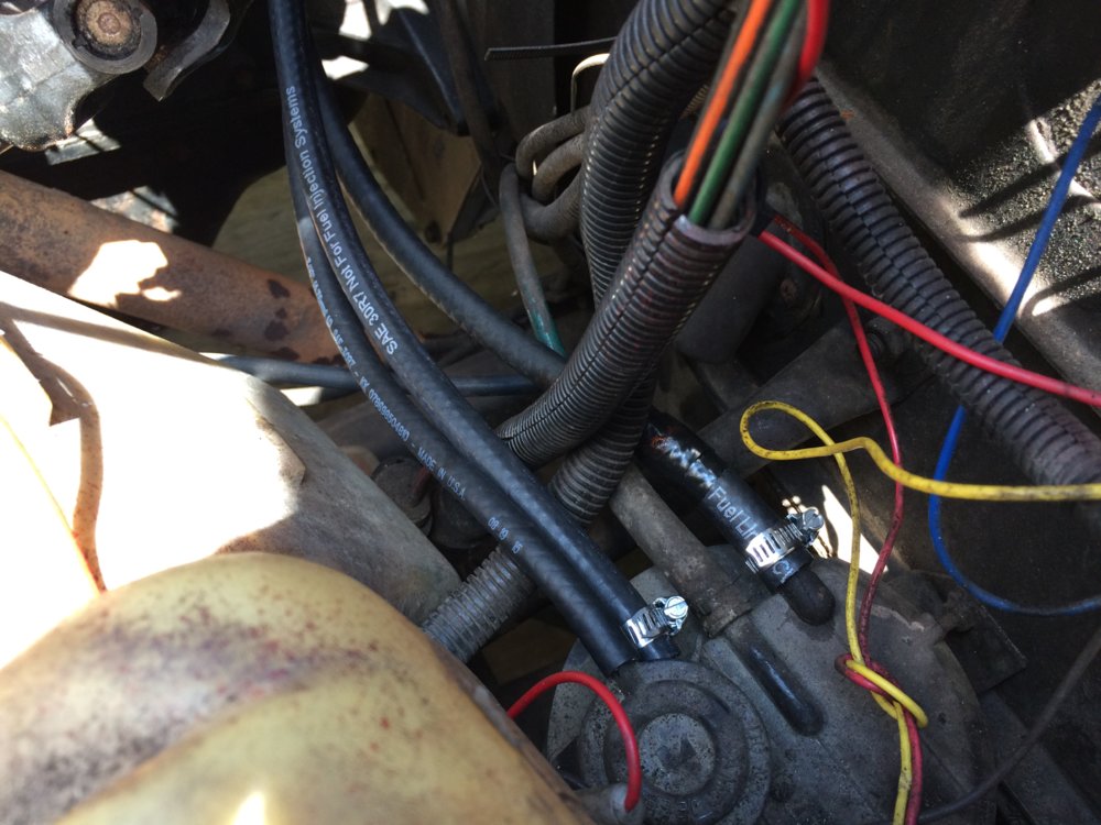

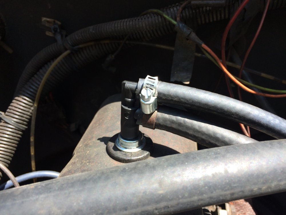

Got the fan shroud installed, and a new PCV valve so I can finally hook my charcoal canister back up. I'm tired of smelling gas fumes.

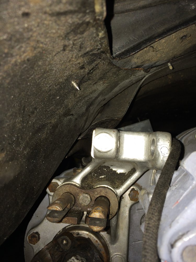

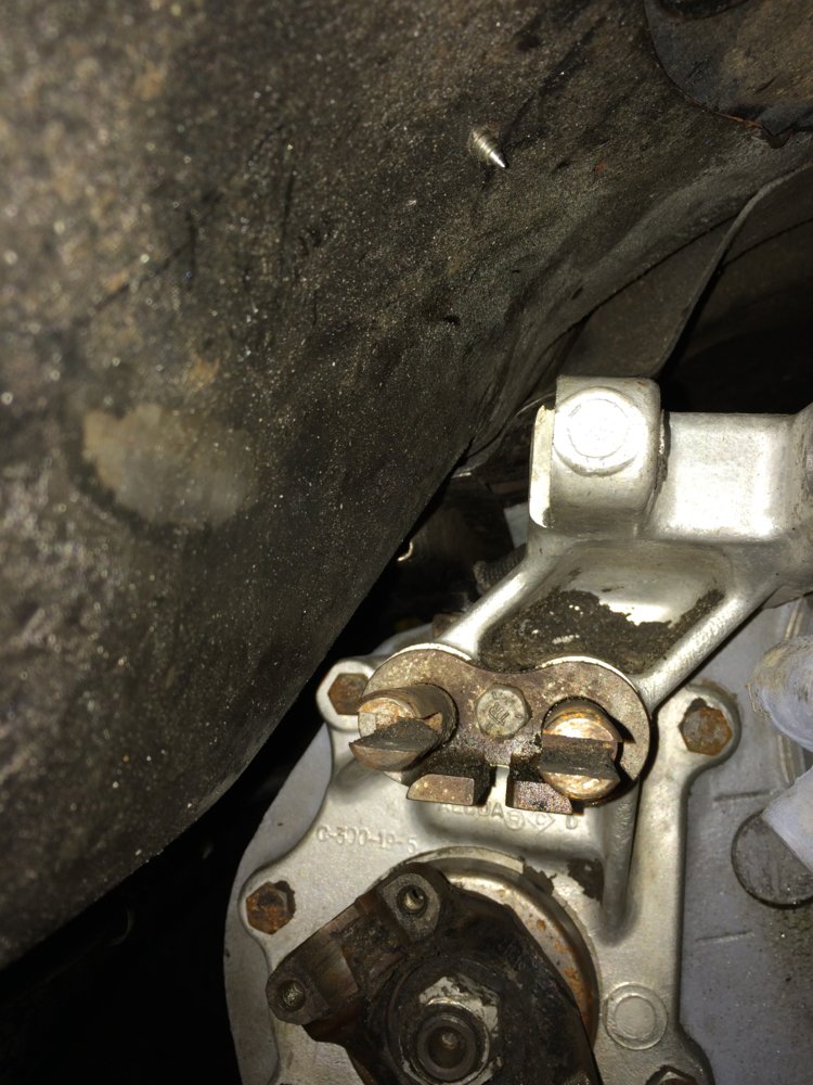

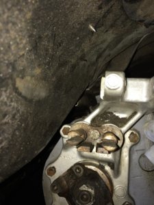

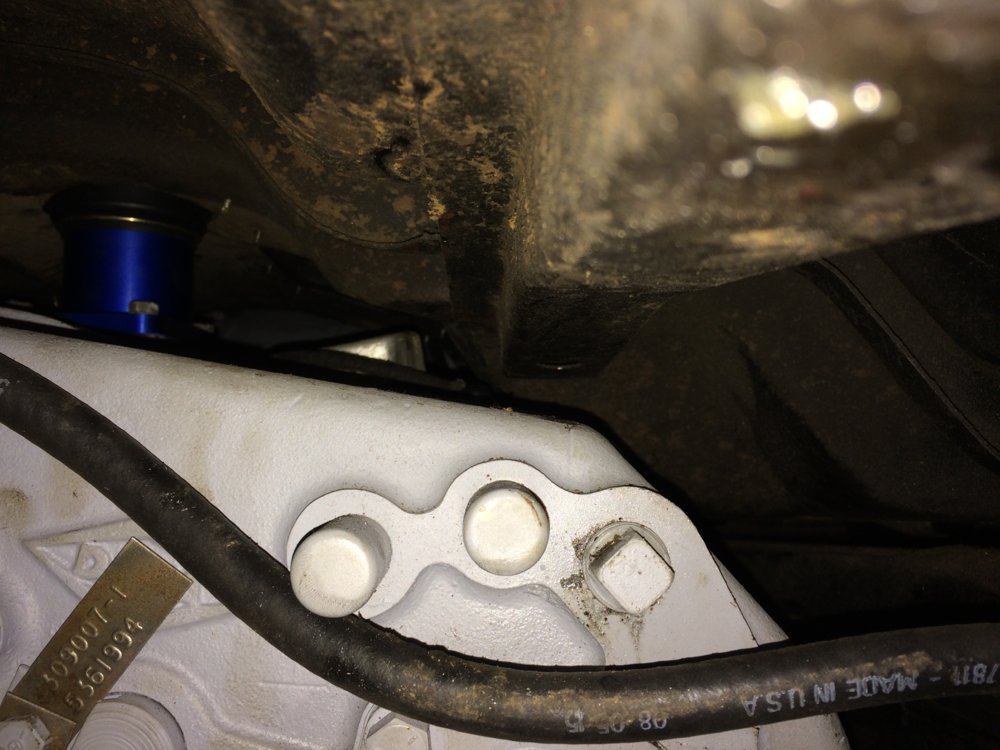

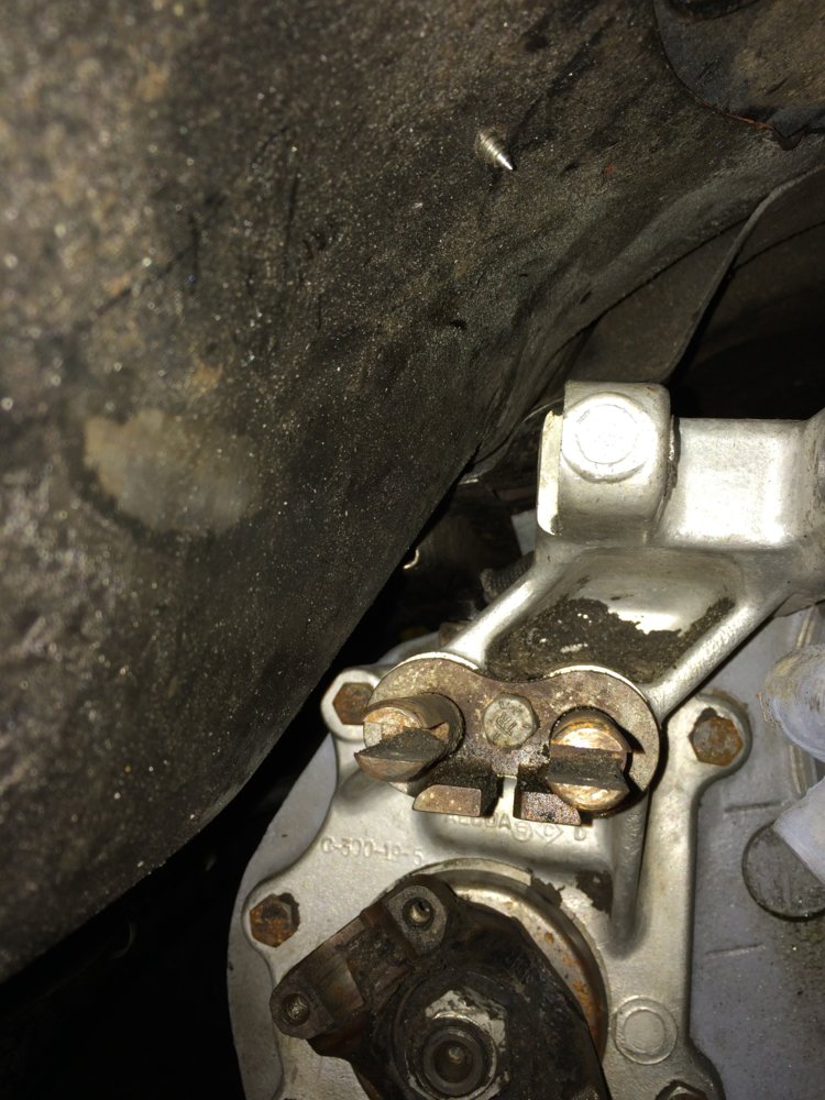

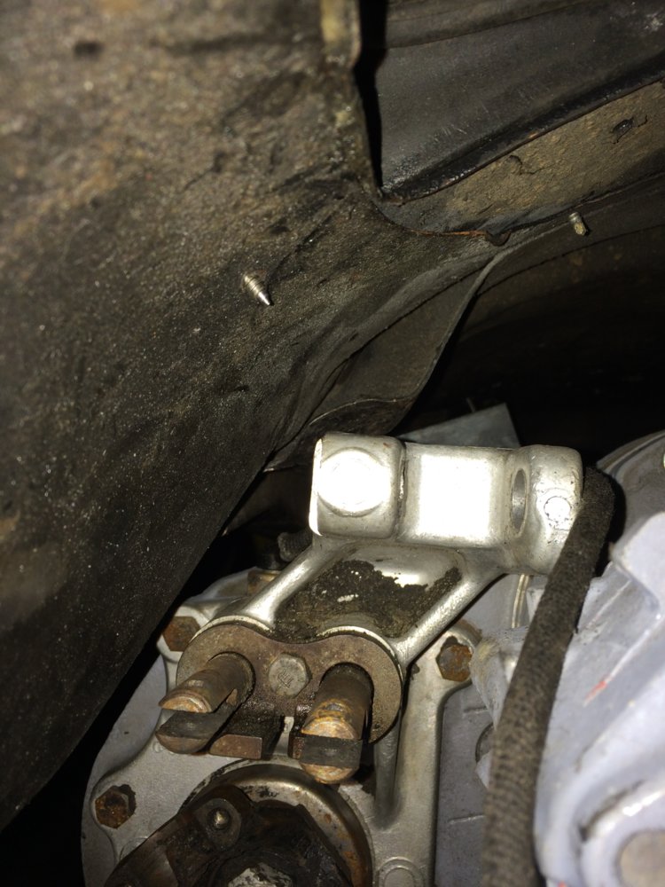

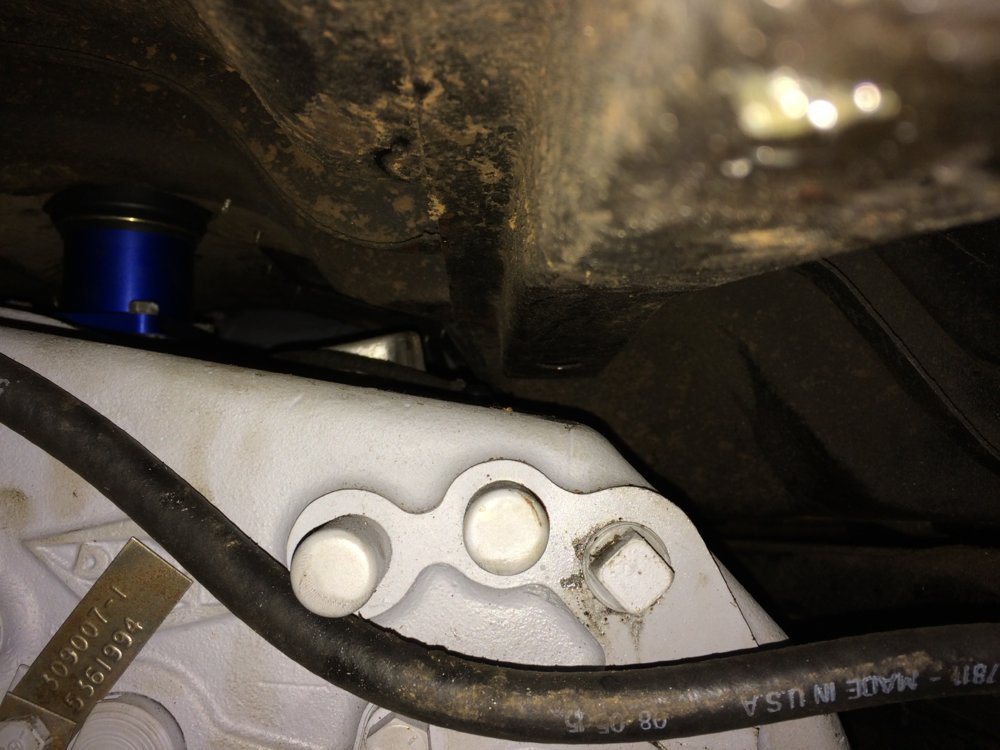

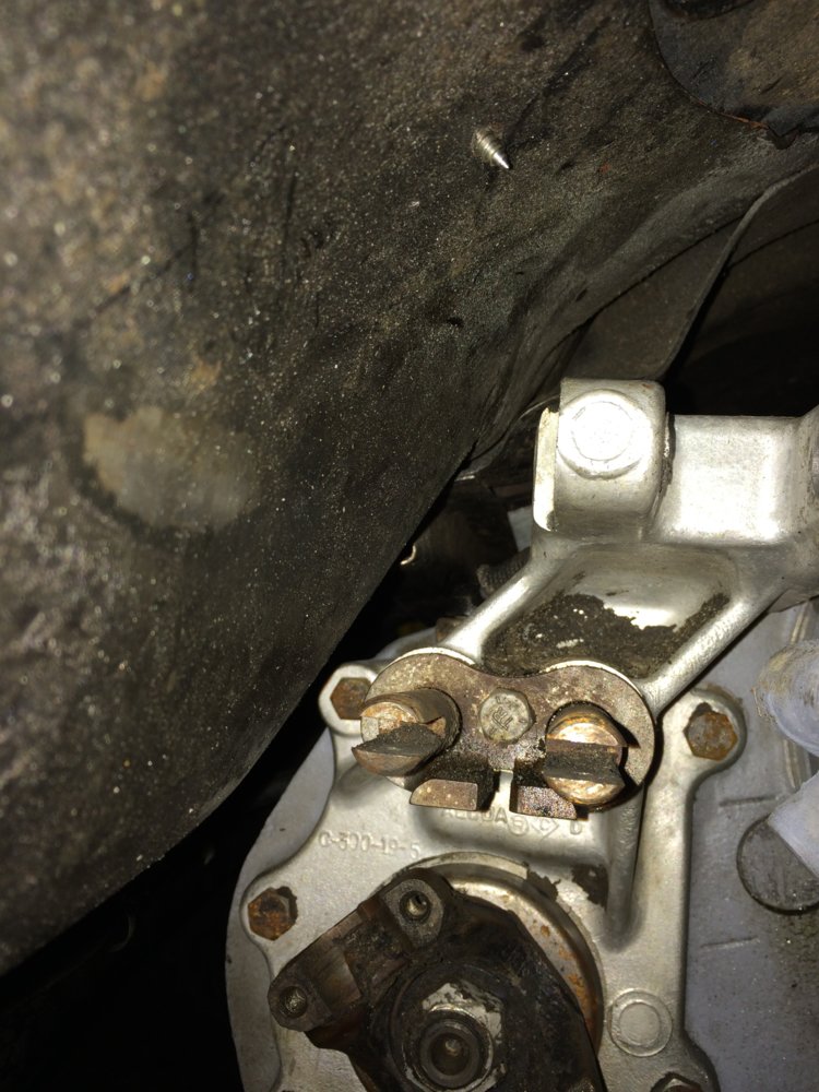

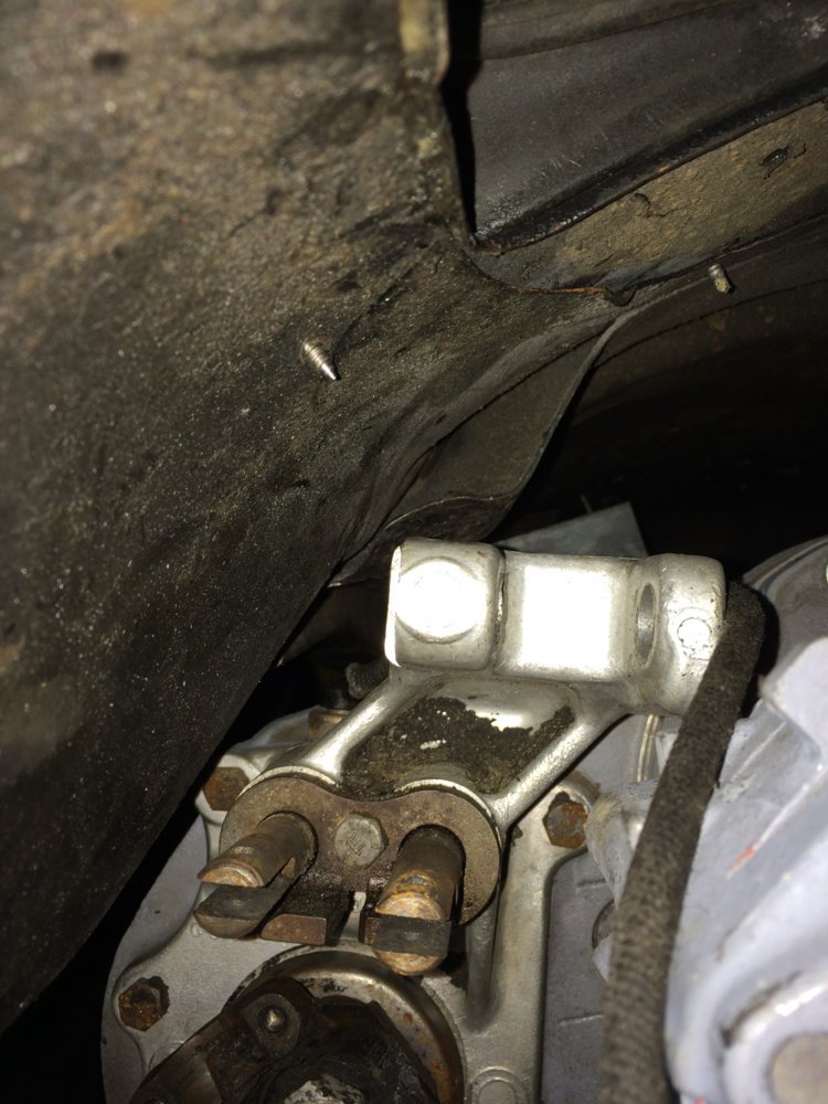

Been back and forth with Northwest Fab about their cable shifter assembly, and bounced the idea I found on google off of him, of doing something like this:
He has worries about that not being structurally rigid enough, and while I do agree, I think I'm out of options for getting my shifter hooked up unless I hack the body (not happening) or give it small body lift.. something I really don't want to do.
Anyone have any ideas? It is pretty tight in there..
View attachment 232602 View attachment 232603 View attachment 232604
I would use the center bolt like you show and use the inside bolt like the NWF kit and use a thicker mount plate for the cables, say 1/4" and run with it.
You need at least 2 mount bolts for the cables to mount to. Otherwise the plate and bolt assembly will tweak over time when you put a cantilevered force on them over time.

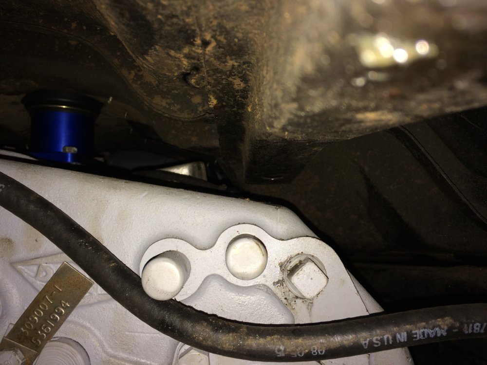

Why not throw a piece of flat stock on it. Top or bottom.
Something besides one bar in the middle to connect those two pieces of plate.
x2. Change the flat plate where the cables mount to a piece of angle or C channel also to get even more strength in bending.
All good points, thanks guys!
@rockcity I'll see if I can squeeze a support rod on the drivers' side of the t-case housing like you mentioned.. Might need to 'clearance' the AX-15 a little to get it to fit..
