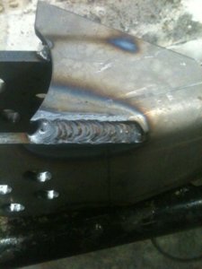

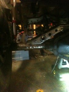

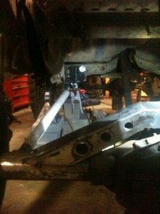

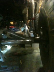

Got a little more done tonight. Finish welded the upper brackets and got them tacked to the frame. Lowers are mocked up.

Hahaha. thanks. Got a ways to go though. Still have to finish weld all the brackets, tabs, truss etc. Extend Driveshafts, plumb and mount the full hydro, plumbing brakes, Swapping to SRW hubs, installing propane etc. Getting the 4link done was the big hurdle so now I can roll it around when its time to go get the plumbing done.
Finished and at full bump. Just need to charge the air shocks.
Steering, propane and brakes and it's ready to test.

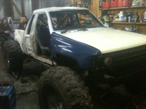

Came home from vacation to a bunch of packages including the first shipment of joints and brackets from RuffStuff that went out back in November.
Going to try and get the propane install done tonight and move onto the steering. Hopefully I'll roll it onto the trailer next week sometime to go get the rest of the brakes and hydro plumbed.

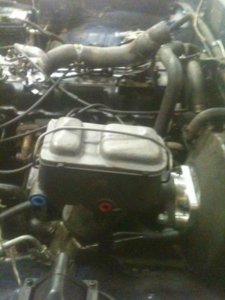

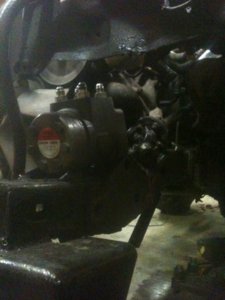

Hit a few snags tonight. Needed another adapter to make the propane mixer work (Impco 100/125 bolt pattern to the larger 200/225 mixer I have) and need to go get the right master cylinder to work with the Sky MFG Adapter. The one I have will not accomodate the pushrod extension that comes in the kit.
I did manage to get the rest of the engine bay "cleaned up". Old brake, fuel and vacuum lines are gone as well as a bunch of accessory wiring that I removed. Stripping it down to basics. With the Toyota gear and I had a bunch of rust in the brake lines so I am just going to re-plumb the whole system when it is time to make the brake lines for the 1 ton stuff.
Engine bay cleaned up, propane lockoff and vapoizer mounted, master cylinder in place and the orbital mocked up.
