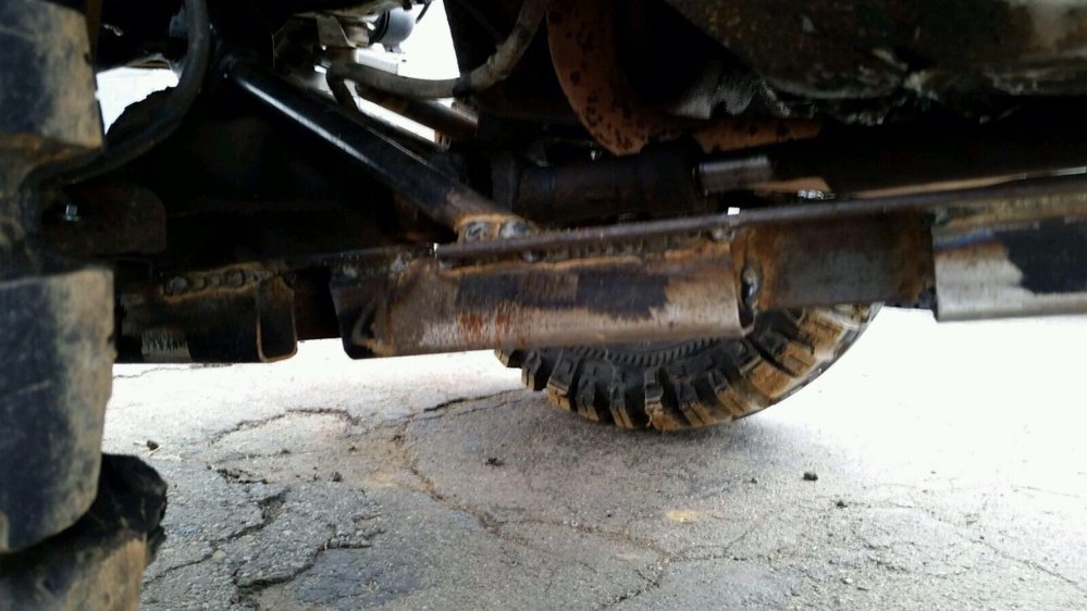

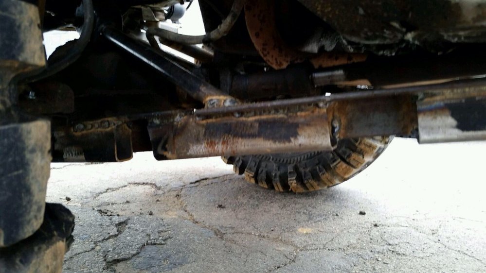

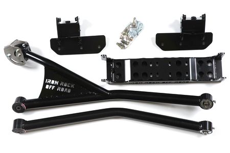

is this how you mean to bend the arms and joints...this would be ideal for my setup and should work perfect if i can get it done
is this what he needs it to look like? Sorry I am a toyota guy! Lol
looks like it could work..so now the real question..if i'm using the JK arm ends/bushings is there a way to weld to them without ruining the bushing or am i just SOL and need to start investing in heim joints for custom arms?
I'd bend them inward for tire clearance as opposed to upward which gives them ground clearance.
that's the plan for my setup...so are the Iron Rock arms in the picture a good example to follow for the bend and such
You seem to have a custom application. Don't copy someone else's and try to make it work.
Do your own arms made to suit your own needs.
ten for..i'm sure i will come up with something interesting as always. well off to the drawing board and thinking booth. thank you for your help and time.

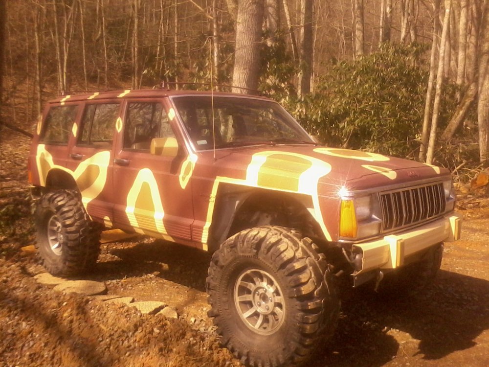

so my friend wanted his jeep painted camo over the weekend and after his turned out pretty good...couldn't help to do mine with what little leftover paint i had...his looks great, mine is weird...but i like it. flashy for sure lol don't pick at the Bunny Ears...my little girl likes them!!

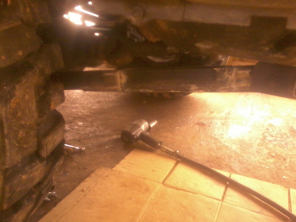

hey at least i've improved from combining 2 stock sets lengthened to make one into using at least some strong angle iron LMAO...hope to have my new ones done tomorrow unless i get busy
Do us all a favor and go to tripplet and coffey and buy some some real tubing. Stop butchering factory JK arms and angle iron.
better yet buy the tubing from them, cut it to length yourself, tack it together how you like it and they will probably weld it together for you for less than $30

yeah i know i know...this is only first set i've ruined..(think my ADD was acting up real hard lol). i actually was dealing with some crap that weekend and thought i would try to work off frustrations but didn't turn out too well. everyone has a bad day here and now and that was mine. trust me i'm mad as hell cause i'm the one that ruined $40 set of arms!!

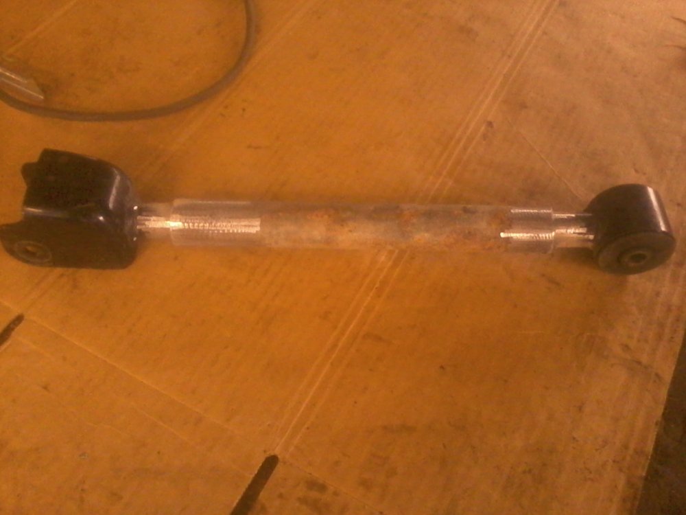

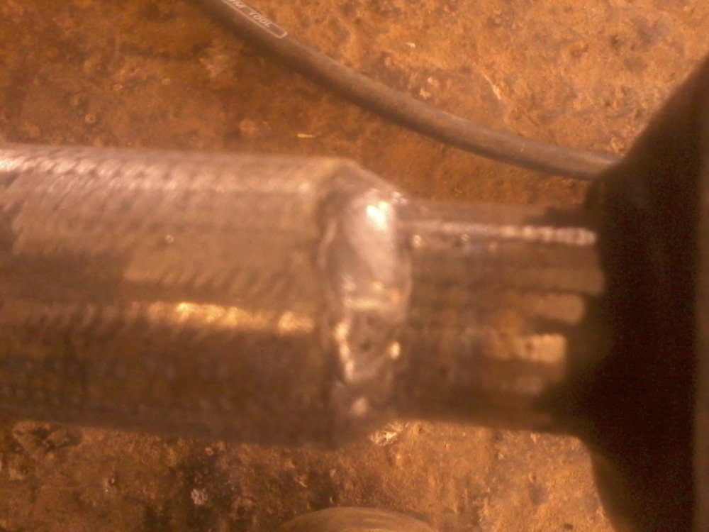

so got my new arms made today and i decided to keep the original 4 link setup which does ride smoother and now i can turn full lock...WOOHOO!!mission accomplished. also decided to mount a power steering cooler with extra trans cooler laying around and modified the piston on the P/S pump which surprisingly both things made noticeable difference in turning the 35s and much easier so at least for now its better steering while saving up for the hydro.
the lowers are only one cut, lol, and angle iron to "box in" the 2 halves where cut...at least i got my full lock steering back and they don't look so trashy lol. probably could've made them prettier but ahh, looks is overrated.

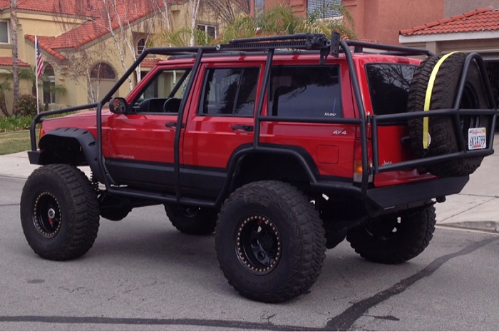

hey anyone got any advise on tire carrier on these 88xj with the "fiberglass" hatch? i got a spare 35 today and would like to make a carrier for it on the back but being fiberglass, would that hold up the weight of a 35" tire...i know i could put it on top but i like the back end idea because it protects the back hatch/glass a little more. any ideas would be great. thanks
for real or joking
someday, God willing, this would be my dream exterior for my jeep
and for those who might have run rear tire carrier...how annoying does it get, if at all, not being able to see out of the back window..cause i just really gave that some thought
