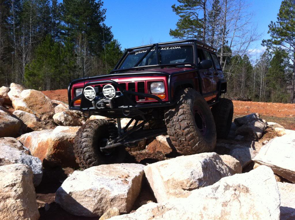

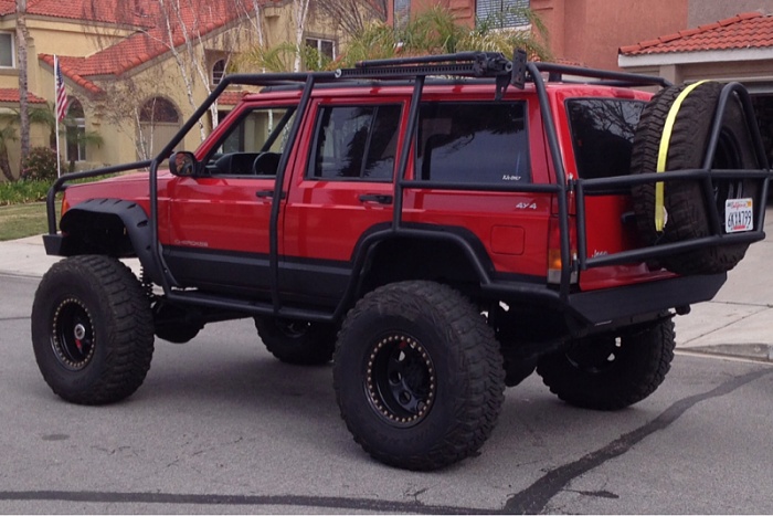

You could buy 99NCXJ's rig: http://www.cherokeeforum.com/f70/99xj-toyota-axles-3-link-full-cage-39-5s-etc-198811/
^ that's one of the better XJ exos I've seen!
I hope like hell if you ever have an exo cage its a little tighter to the body than that one. Dream a little bigger haha
ohh i would def put it closer i just meant i liked the looks of it

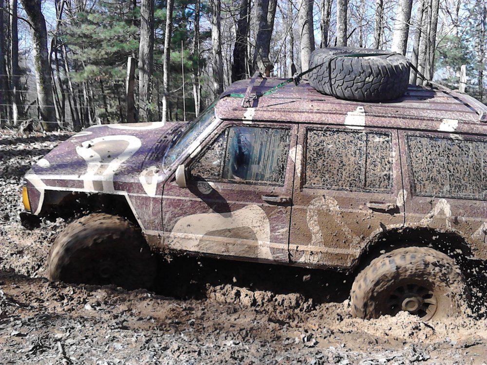

that's what i figured..thank you and i guess on top for now...i like my back space empty for picnic items, parts, chains,etc...so on the roof for now. thanks
i have to admit a funny gesture that my friends gave me when i pulled up in the jeep yesterday at their work: so i pull in with the jeep and he comes out and i hear "The Abomination Is Here" LMAO. it gave me a really good laugh. the "abomination" they named it LOL

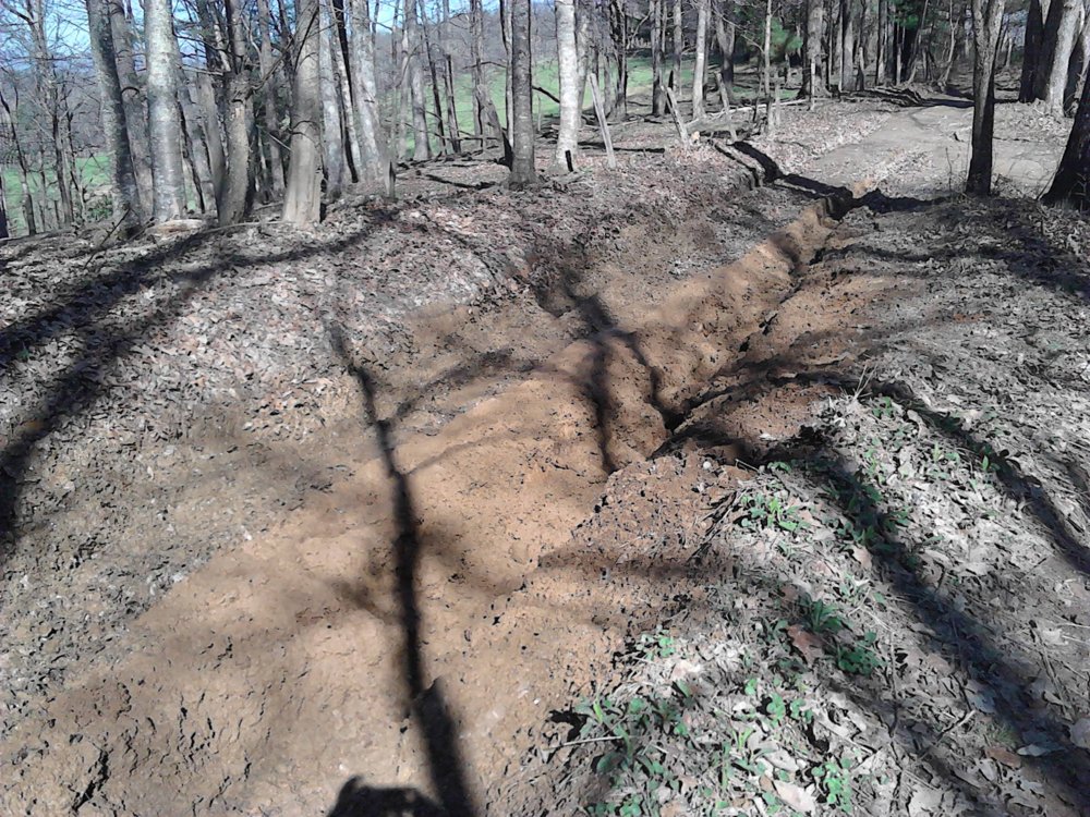

got to test out jeep today...i was pretty happy for what the trail has to offer, boy these tires DIG and wow they dig fast when spinning...i really can't wait to go somewhere awesome but here's a few pics...also picked up 16"trailer today(friend from church donated it to me) so now i have one down...just need something to haul with lol. tried uploading video of a ravine/washout i went up but couldn't..i'm amazed at how True 4x4 really performs.

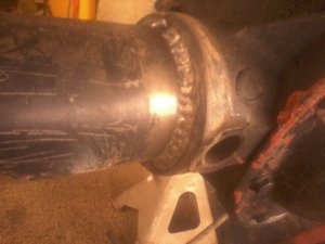

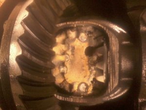

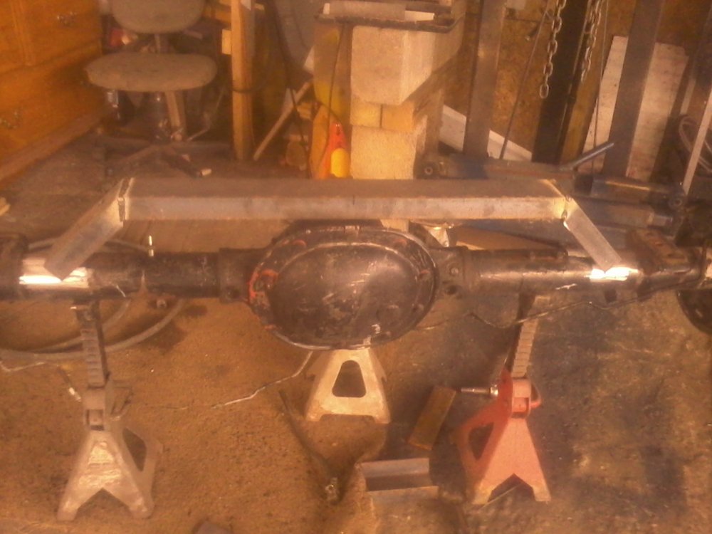

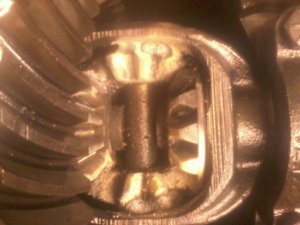

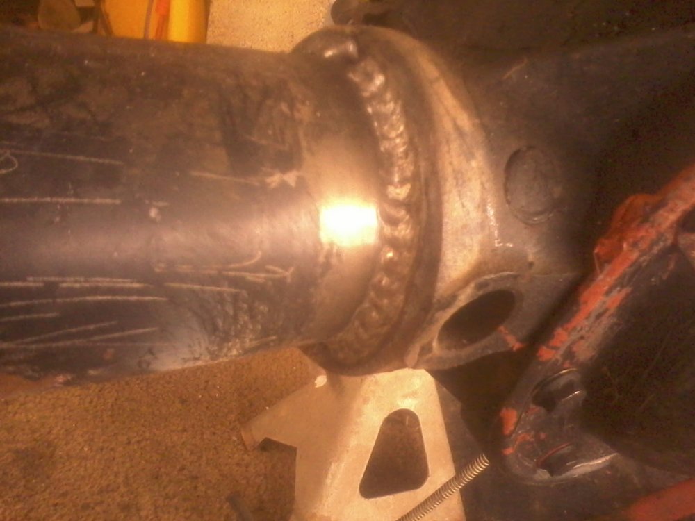

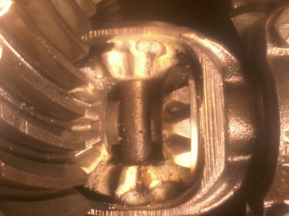

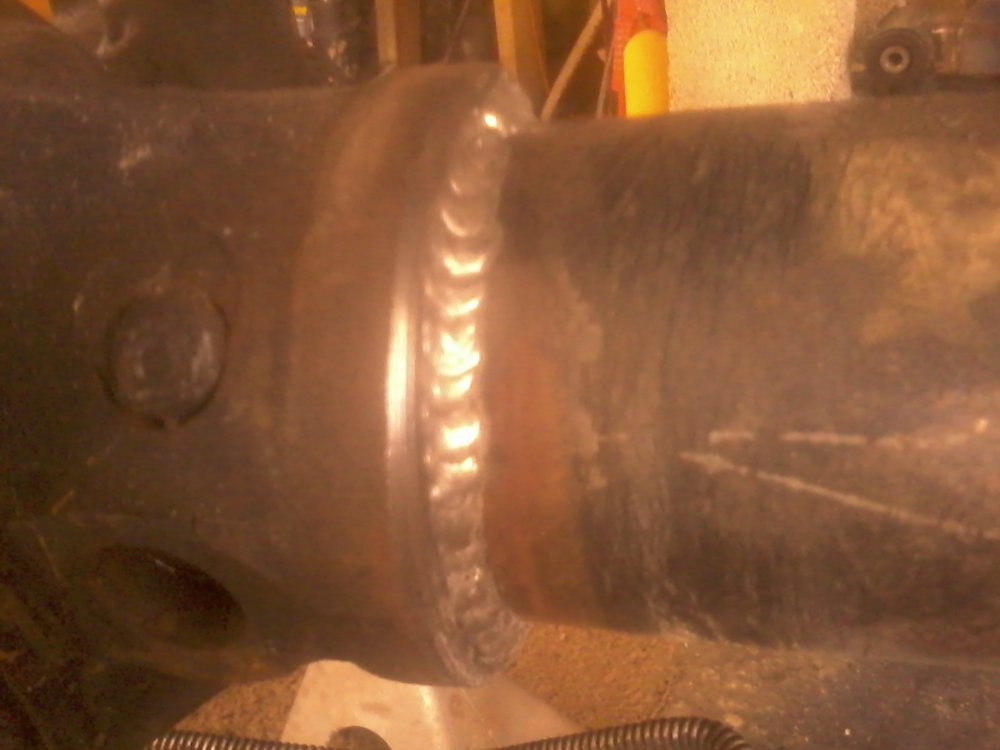

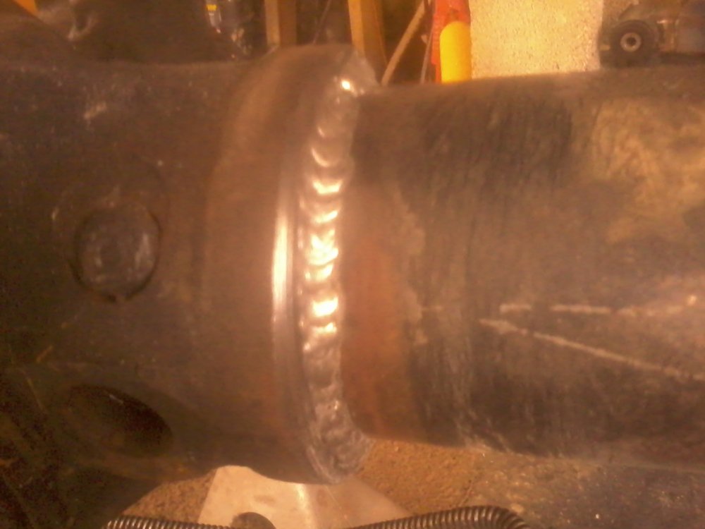

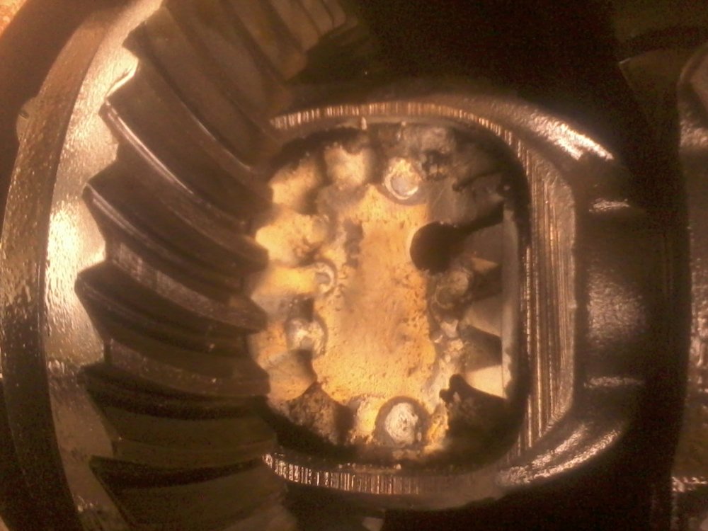

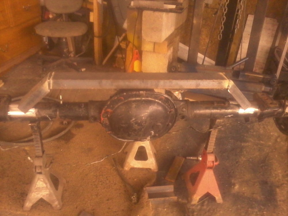

got my new rear diff today almost complete...gusset and welded gears, shock mounts cut off, gonna shave it 3/4 inch and add some custom shock mounts. what i got so far: at least i know for "my" style wheeling, this diff will hold up and IF it ever breaks, it would have to grenade into million pieces or suppose a shaft but from what i hear many many say, the shafts can take pretty good abuse so i think i'm gonna be happy with this setup. 29spline 8.25
View attachment 186501 View attachment 186503
looks like you need more weld
was that a joke lol, cause i don't think i could possibly add more weld to the carrier. both sides are welded on all 4 corners then second round on top of that (which has never broke) then i put the plate in there and welded all sides of every tooth to the plate on both sides and welded the spiders to the carrier also lol...this diff won't eve break unless the shafts were to go which i won't ever give it enough abuse to do that so i think i'm plenty plenty.
