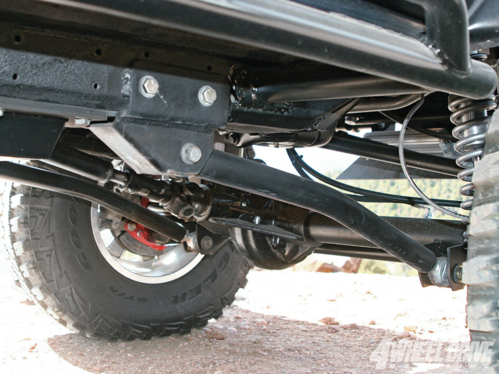

so i just now drew this on paint lol...is this what Jody is referiing to for lowers with bent dom and still lining up the eyes?
Turn the joints 90* from now they are pictured.
The bolt holes would need to be in the same plane as the bend. Meaning the bend would go towards the engine side as would the attaching bolts for the links.
ok i feel stupid but you lost me...my add must be kicking in(why i never went to school and learn everything hand on lol)
