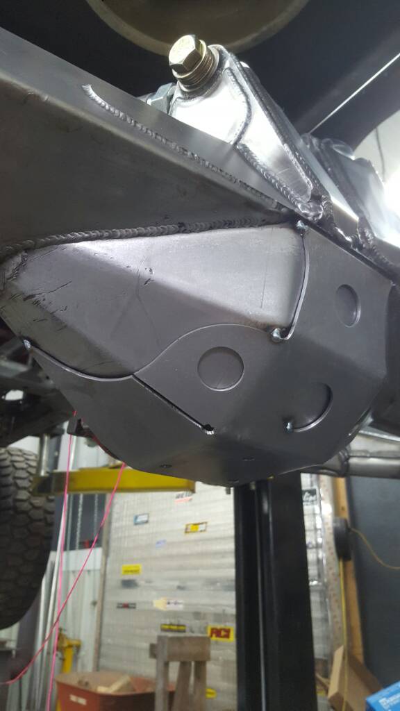

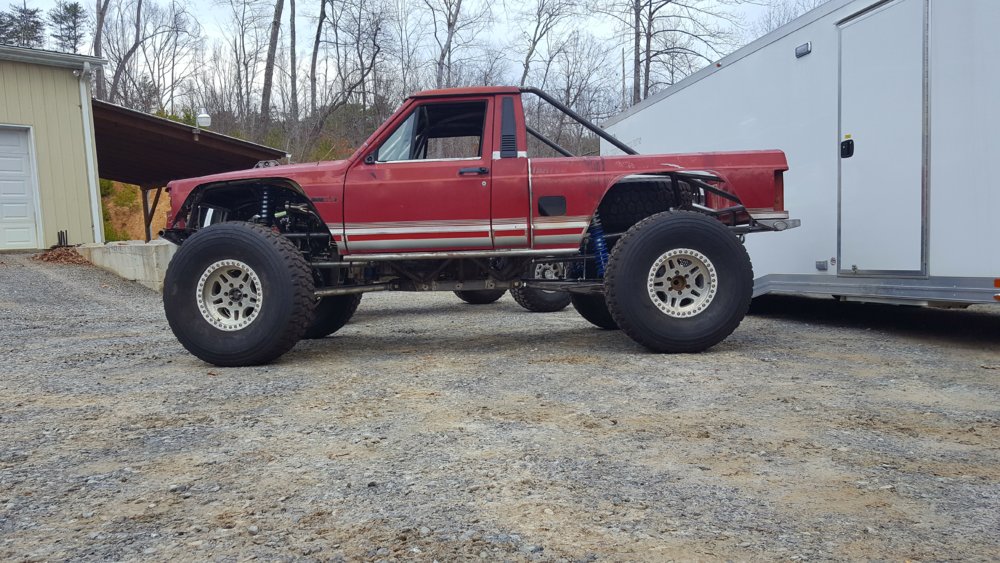

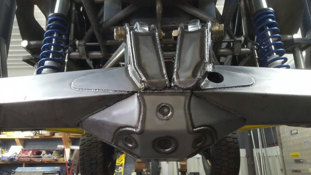

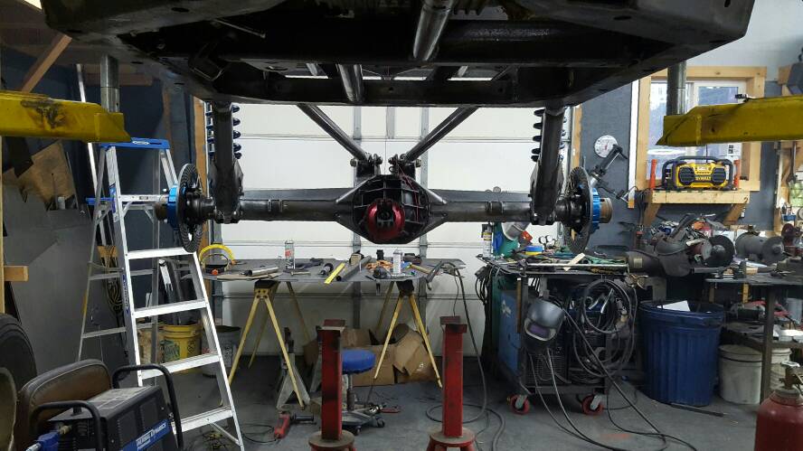

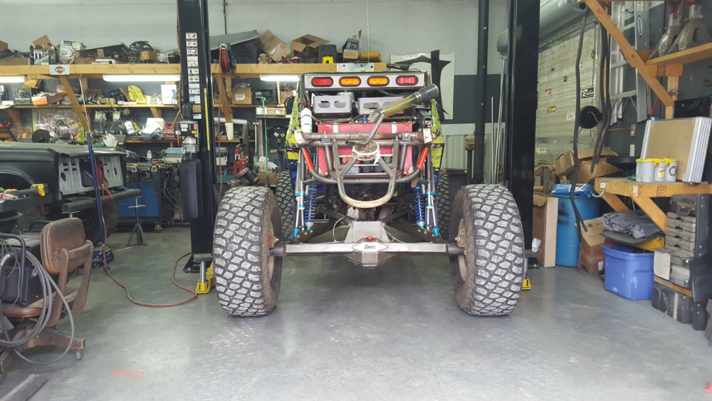

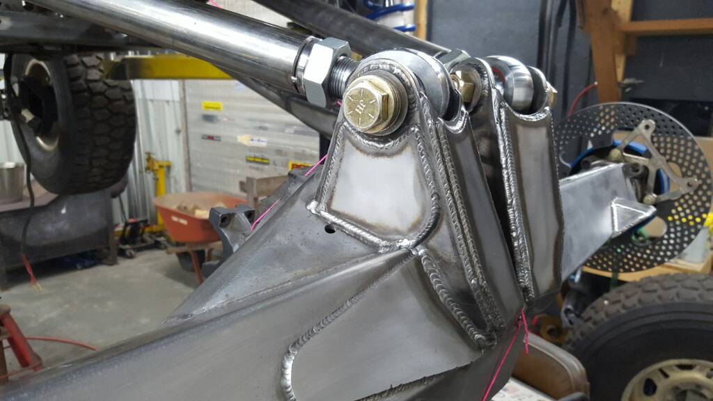

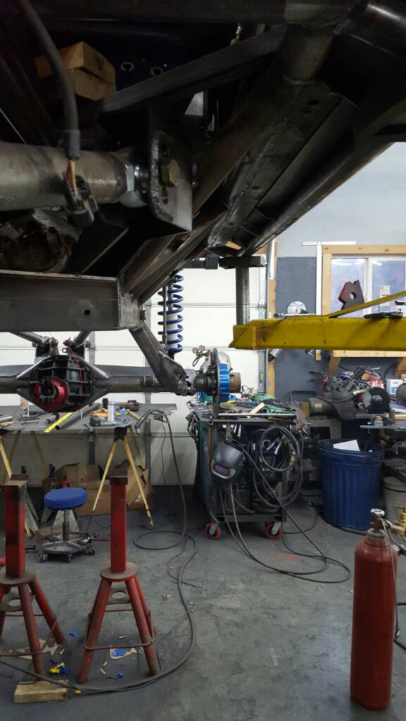

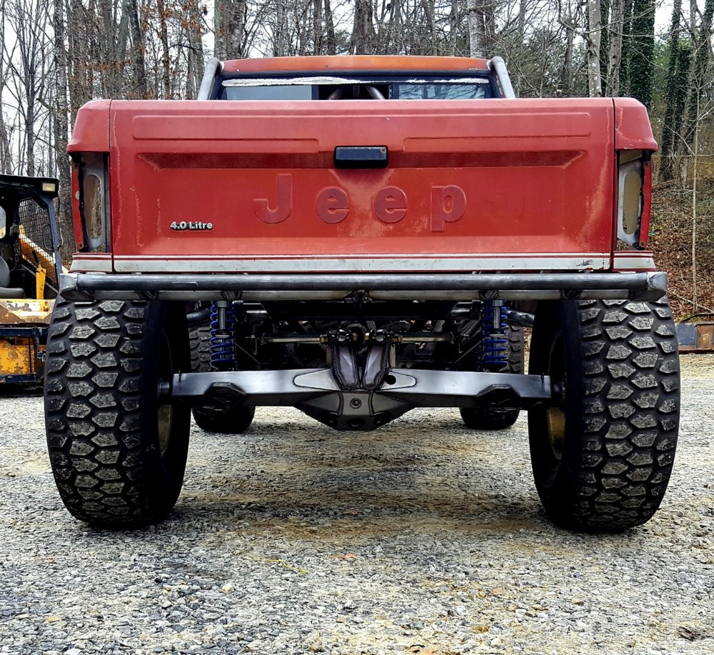

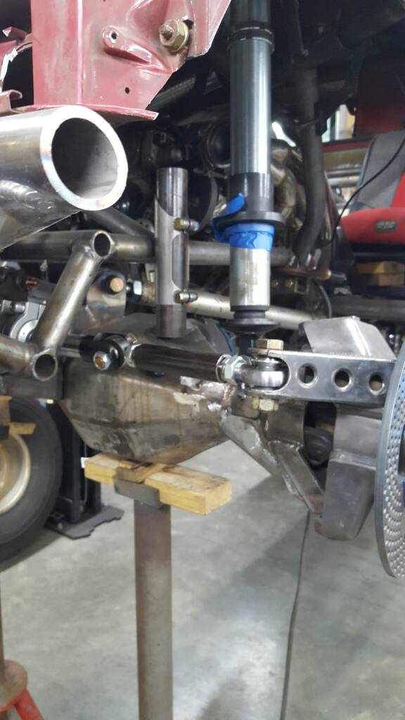

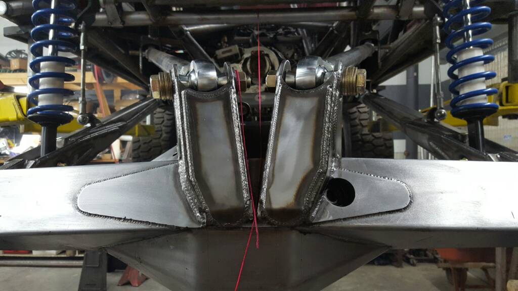

Rear end is tidied up. Upper link mounts complete, old tabs cleaned up. Only thing I may do is add some bash plating on the rear lower diff.

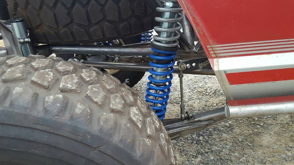

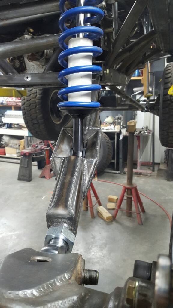

Also charged the shocks and threw a couple springs on to be ready to determine corner weight a little later.
Matt

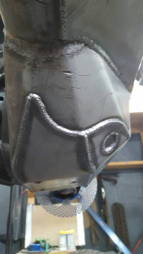

And you just won the killer welds thread too, awesome work dude.
Sent from my iPad using Tapatalk Pro
Thanks, but I'm just a one trick pony when it comes to welding. Haven't held a stick electrode in many years, and my tig needs many more hours behind the helmet to be proficient. I just stick with what I know...no pun intended.
There are some great welders here, that I have learned much from.
...I only show my best[emoji6]
There are a few I'm not very proud of, you'll have to find them-but I will own them.

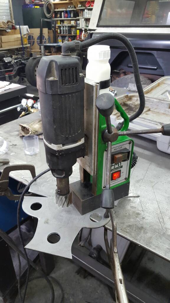

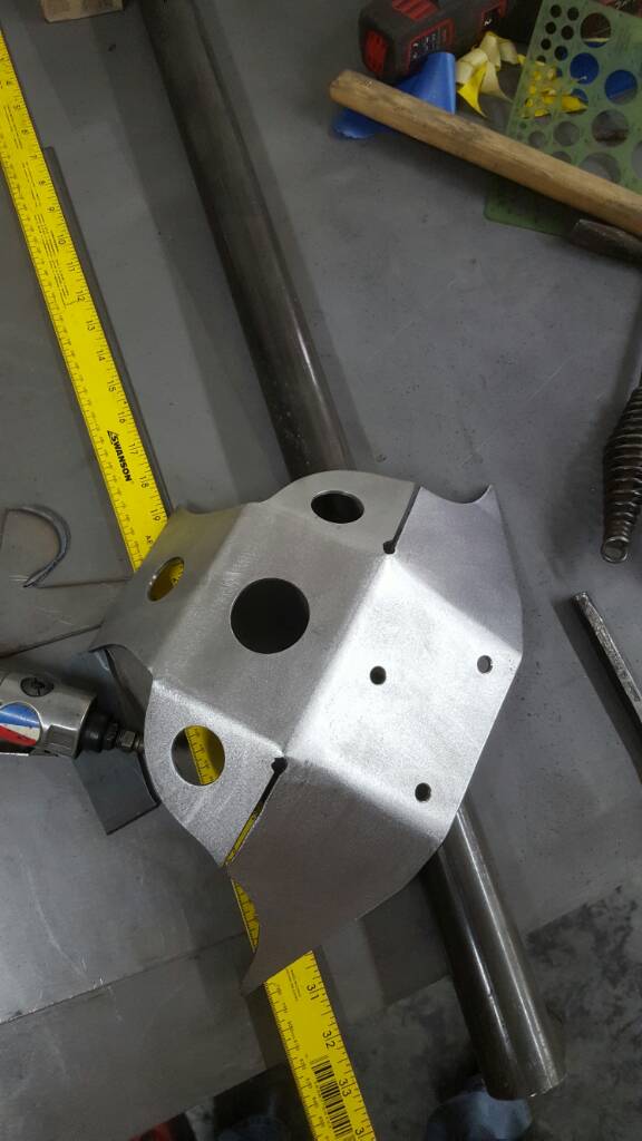

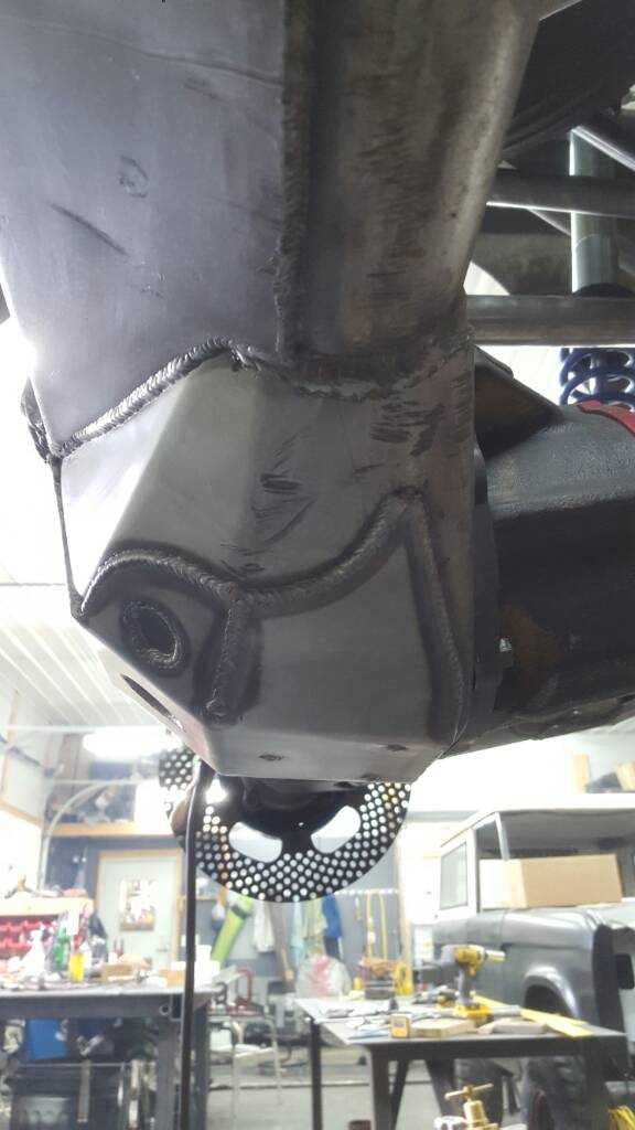

Finally received the Hougen bits for my newly acquired mag drill, (bought in a load of scrap tools- fastenal had it brought up to snuff for $150!) Had to test it out, so I went ahead and knocked out the bash protection on the rear diff.

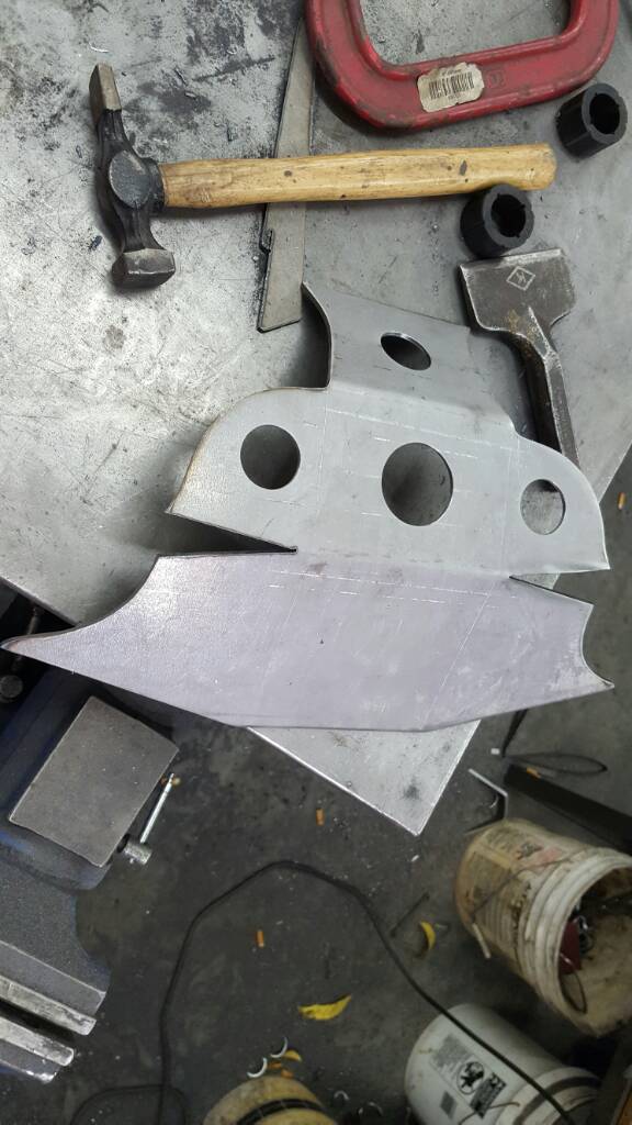

First two bends done on my swag brake
Next four done by hand with the vise and a hammer...then of course sanded and scotchbrite treatment.
Matt

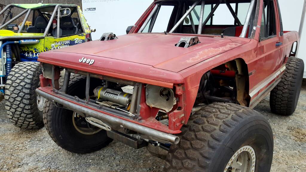

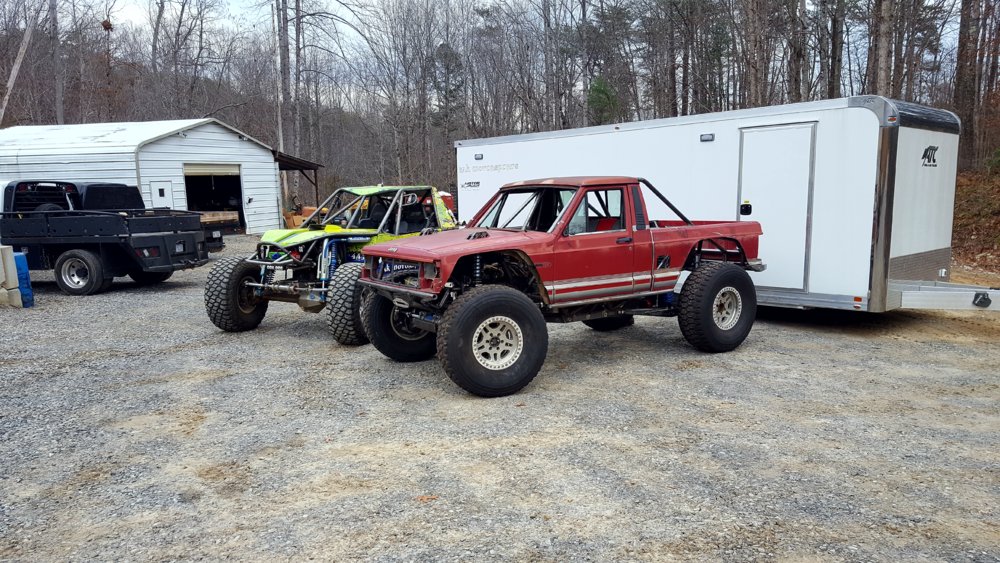

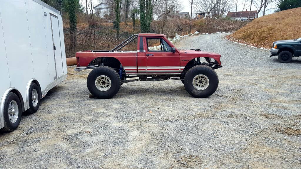

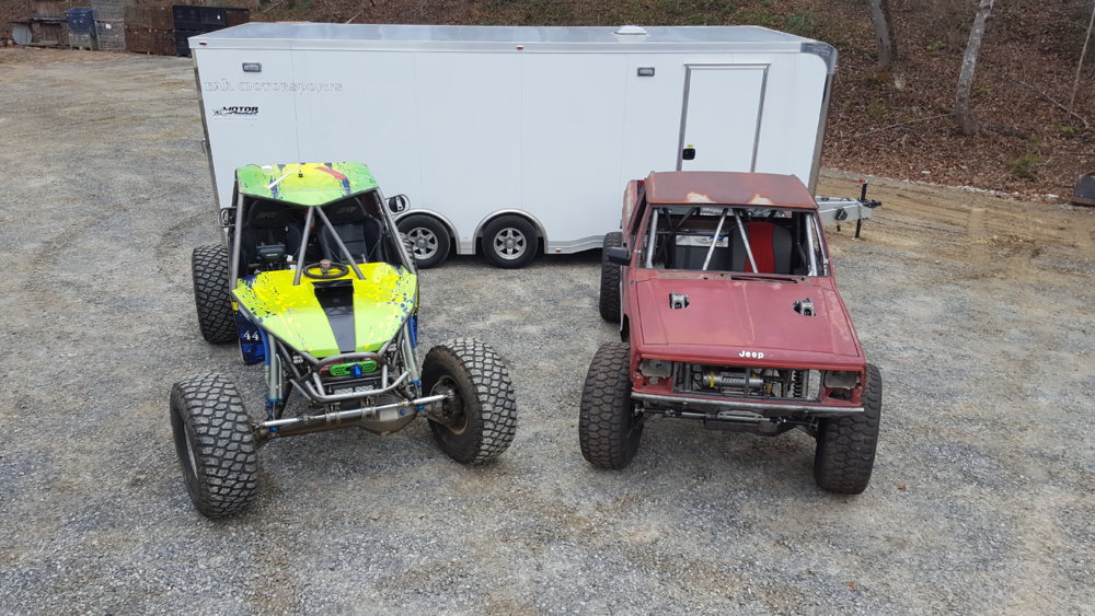

The manche got to step outside and take a break today. Had a play date with its new roommate for the week.
The mall crawling 4410 is coming in for a nut and bolt general inspection to prep for KOH 2017. I appreciate the confidence from Jay and Redlyner Racing for the opportunity. Looking for a podium finish from our local team!

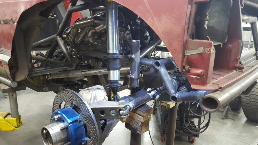

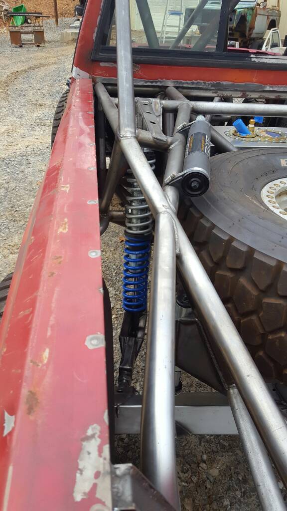

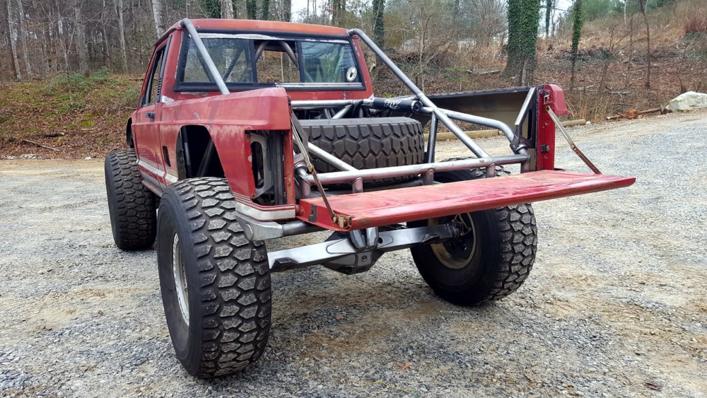

Plenty of points to simply wrap a tow strap around a tube.
Matt
Sounds good, but in my experience it can be difficult to stop a strap sliding down an angled tube unless its a strait pull. If it slides that might mess up your cab. I'm not trying to say your'e going to roll over, just that it's possible. Even A small loop of 3/8in or 1/2in rod on the inner side of the tube, to slide the strap through when it goes around the tube would work.
Also this thing is awesome, Can't wait to see it wheel. You've definitely given me some ideas, from this thread and your buggy build.
