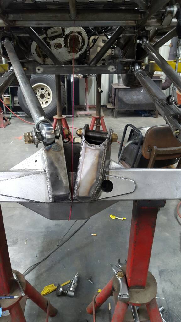

Oh shut up you web wheeler. Go back to Facespace and GQ.Just a ? Is the torque not multiplied on the sway bar the further away from the axle? If so you might need a bigger shaft to compensate
Just a ? Is the torque not multiplied on the sway bar the further away from the axle? My dick is as small as a babies finger so i might need a bigger shaft to compensate
Don't get mad because your shaft may be inadequate I will still let you put on an apron and cook for me
Yes you are correct. But at the same time I have shortened the arms by 7 inches (changing their motion ratio to nearly the same as the trailing arms/ shocks), thereby increasing the amount of work the levers must do in a shorter range of motion; virtually increasing the rate of the bar. Time will tell, I may have to change bar diameter...we shall see.Just a ? Is the torque not multiplied on the sway bar the further away from the axle? If so you might need a bigger shaft to compensate
