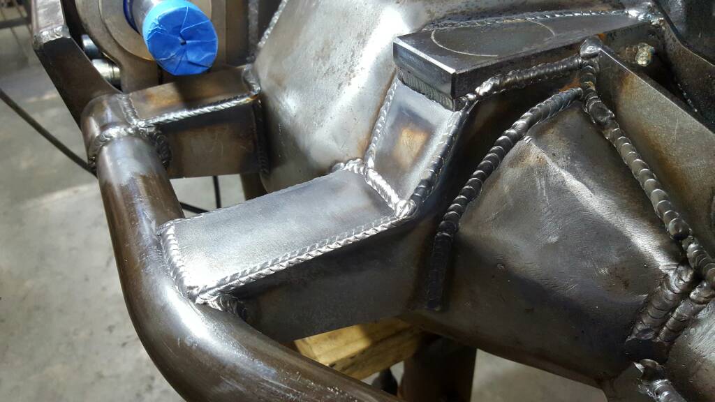

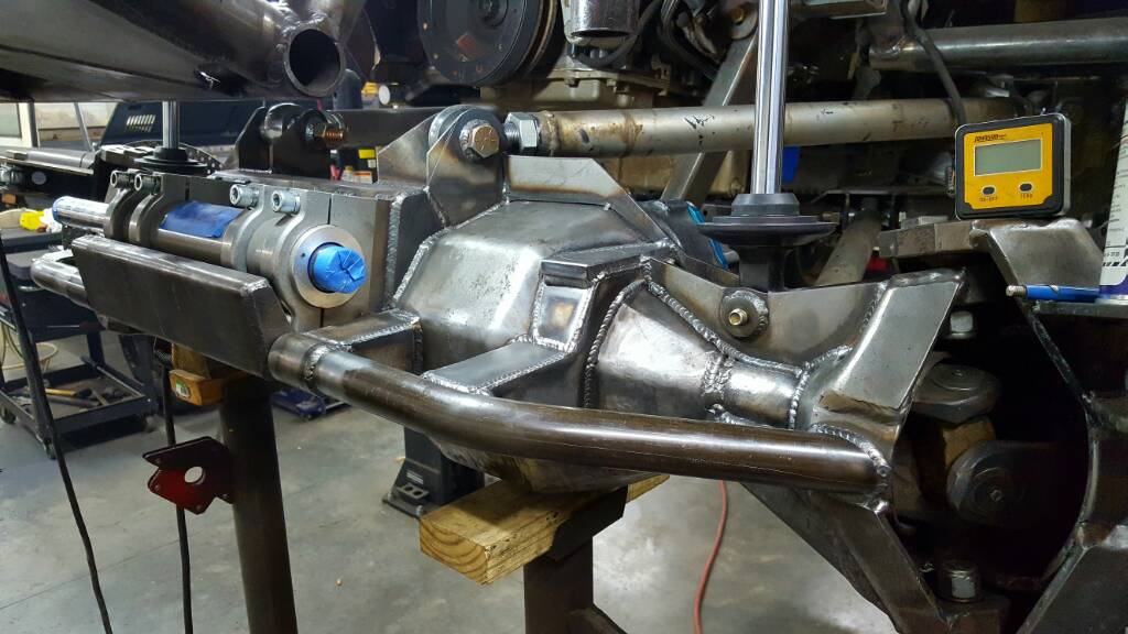

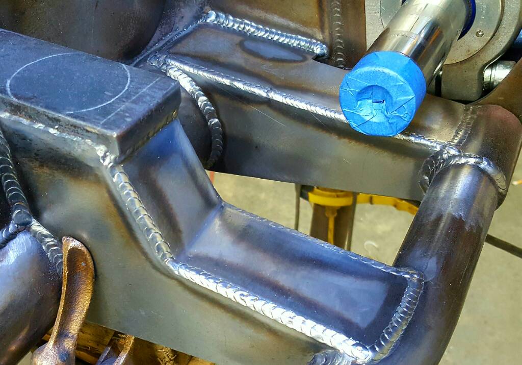

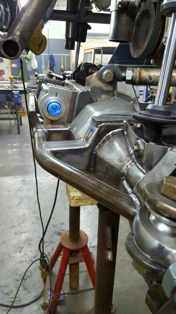

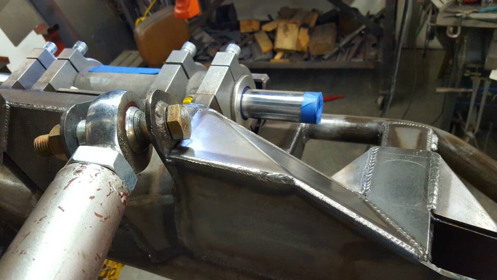

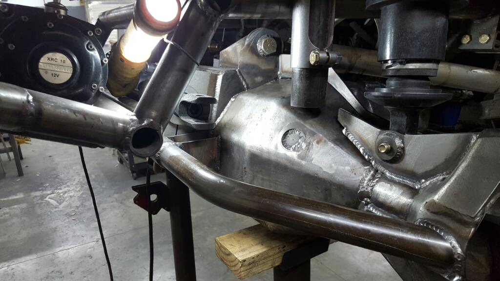

Thanks for the compliments, glad your enjoying it. I learned from watching others, that's why i devote much time to maintaining these threads.Sounds good, but in my experience it can be difficult to stop a strap sliding down an angled tube unless its a strait pull. If it slides that might mess up your cab. I'm not trying to say your'e going to roll over, just that it's possible. Even A small loop of 3/8in or 1/2in rod on the inner side of the tube, to slide the strap through when it goes around the tube would work.
Also this thing is awesome, Can't wait to see it wheel. You've definitely given me some ideas, from this thread and your buggy build.
