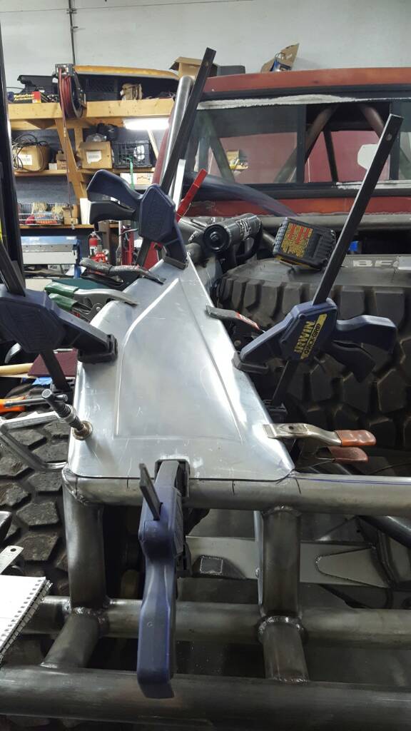

90's throw back.....Manche build
Probably be artwork for a few more months....lol
Going on 2 years since wheeling, longest I've been out of the woods since I was 19 years old.
This is exactly why I'm building the old ecor's rig and not donating parts off mine to build it. I swore after I built my current junk I built in '07 would have something to wheel at all times.

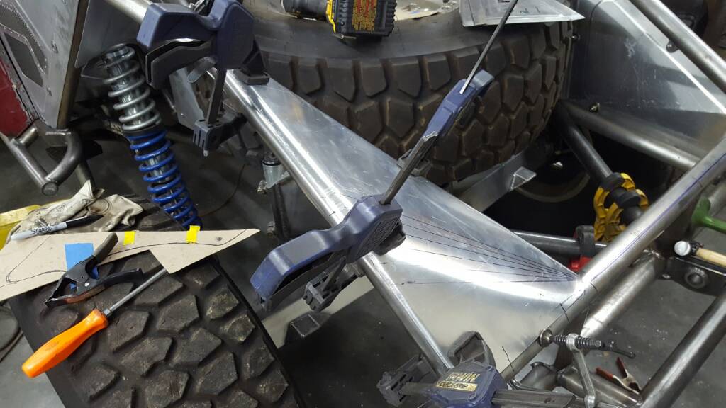

Now you're just showing off. I couldn't cut those templates out of paper, much less metal. Definitely some of the finest work I've seen. :rockon:

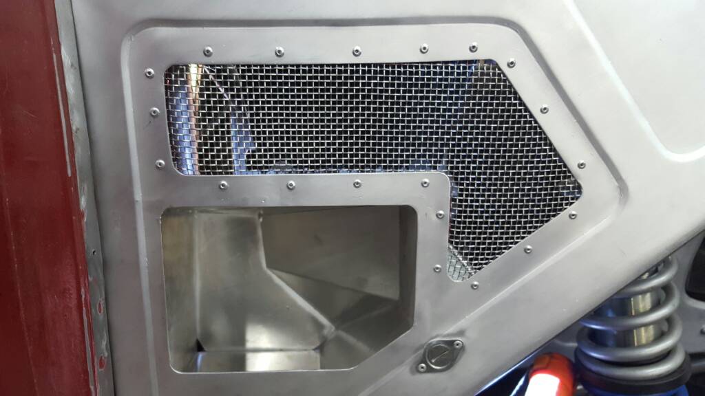

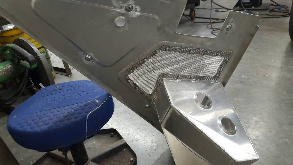

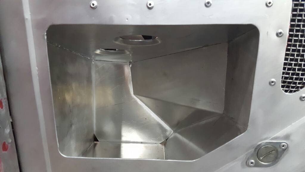

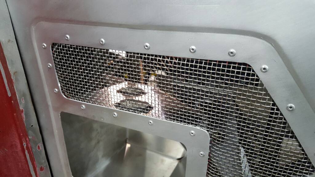

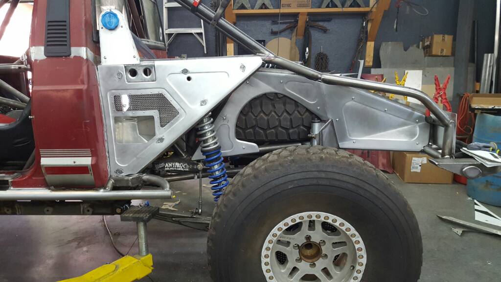

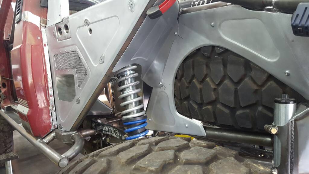

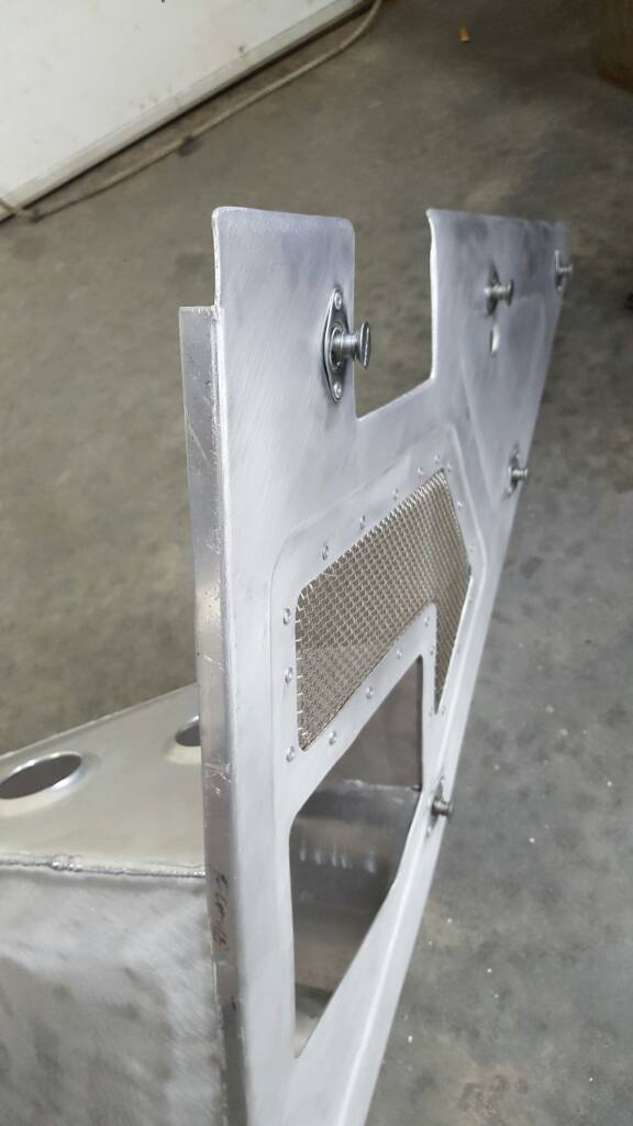

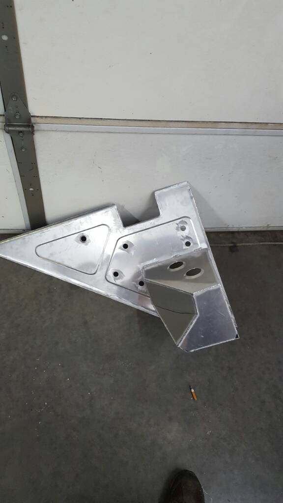

Finally had a few hours to compete a panel. This one has some functional details. Of course the mesh serves as ventilation for the trans cooler. The cubby hole is designed to be directly behind the factory fuel fill door. It will be used for storage of the tree saver and d-ring. It has its own ventilation and drain ports. Hard to see it in photos, but I also bead rolled the mesh to raise it flush with the surrounding aluminum cut out. The dimpled hole is aligned with the upper shock mount bolt for checking torque or for service, if for some reason the panels and bed are not removed.
Matt

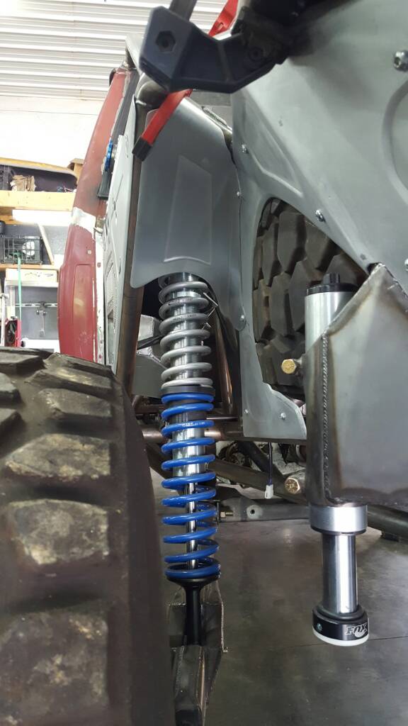

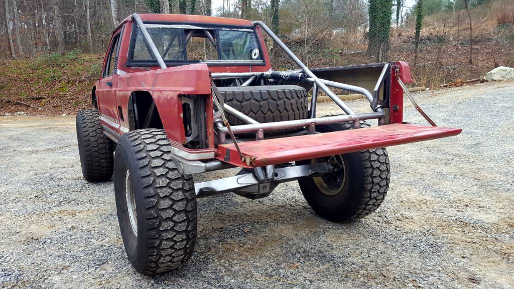

Are the MJ bed sides going back on or no?
Yes, but they will be removed for the 'get stupid' days..and nights. It's a lot of work but I like the finished look of having inner fenders...added benefit is it will look good on naked days and it will be easier clean up on the innards...

Absolutely agree it will look good. I really like the attention to details like this. Forward planning goes a long way and you've done a fantastic job.

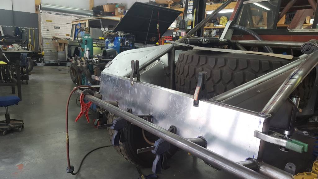

Sure does look good though! Good jobs and glad to see it coming along so quickly, if I get one panel done in a week that's a success!
That big panel took me about all week, an hour or so at a time (maybe 7 hours total)...the other two I did from 12-4 this morning.

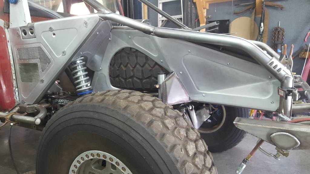

So let me see if I understand this? All this is inner panels and you're gonna cover it up with a truck bed side? That's straight dedication to detail right there. Huge fan!!
Yes sir that's the plan.

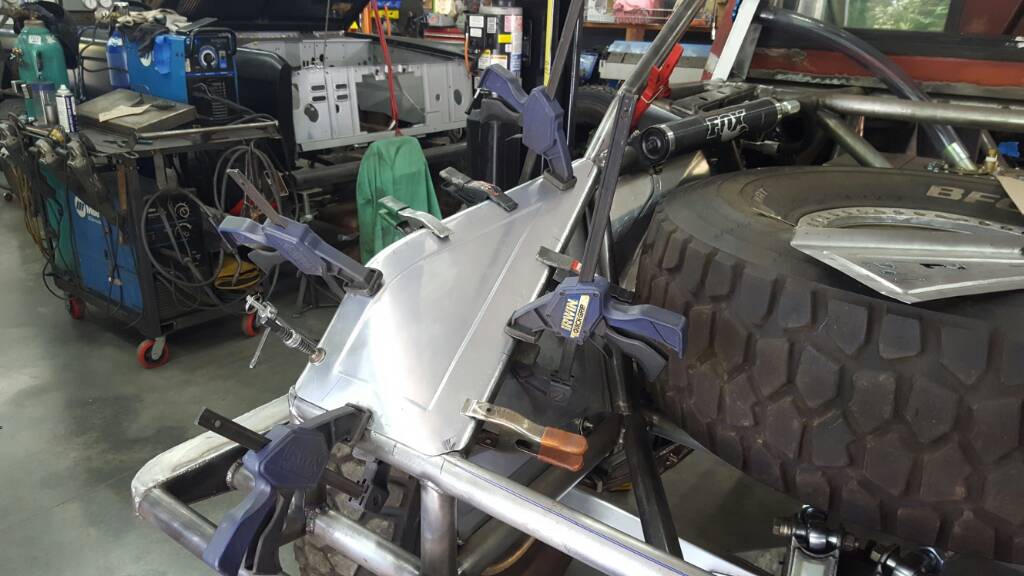

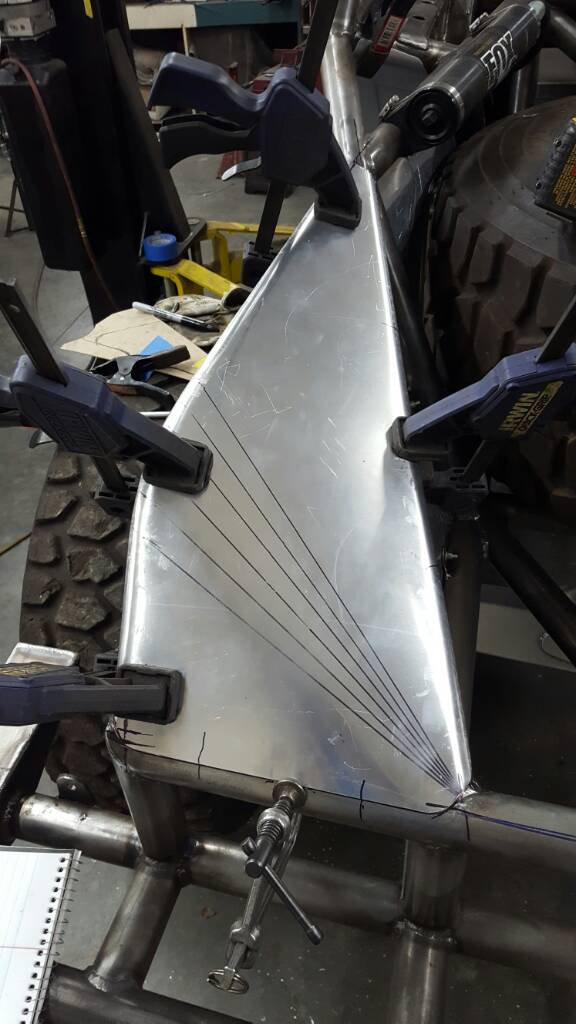

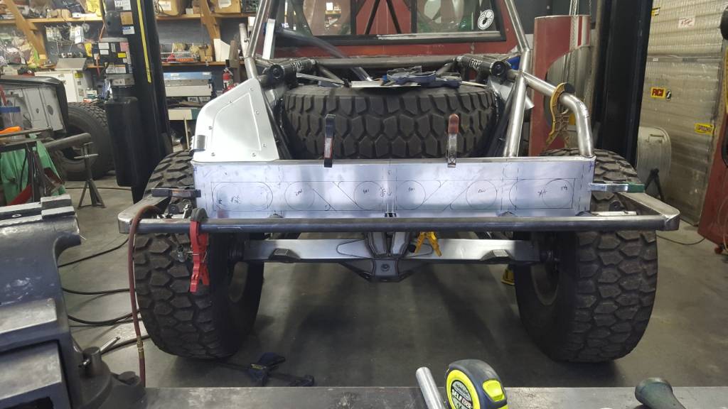

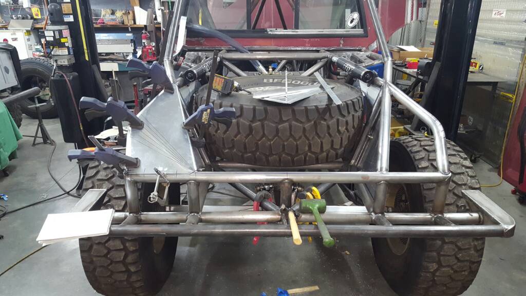

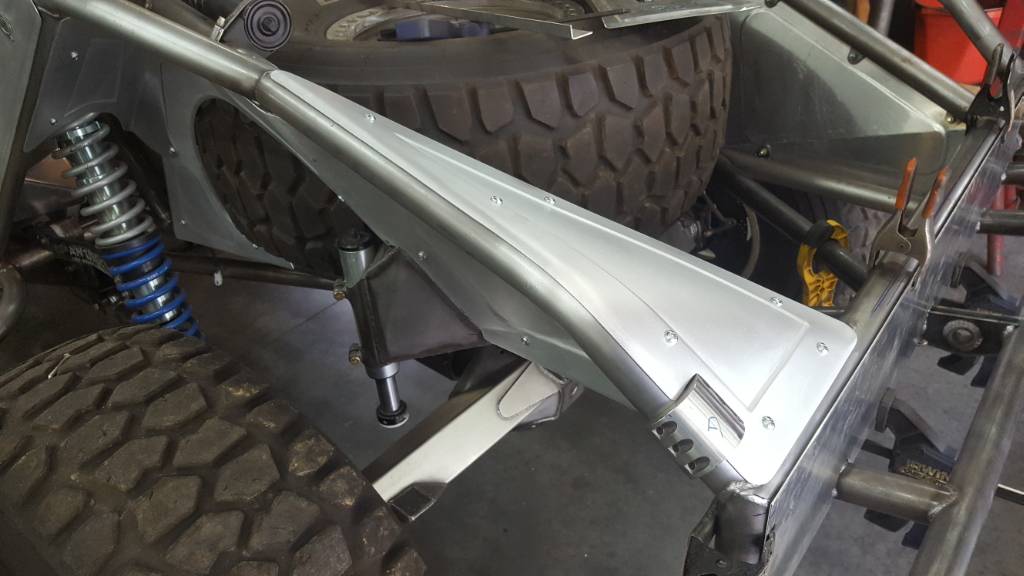

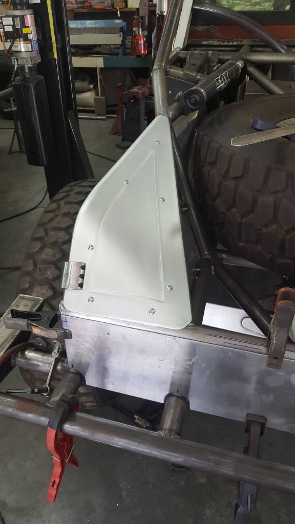

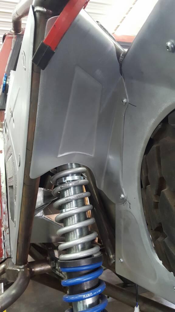

Finished a couple panels today and began layout of the rear taillight panel. The factory taillights will be functional when the bed is on but these will be lit when the tailgate is removed.
Drivers side rear panels are officially done.

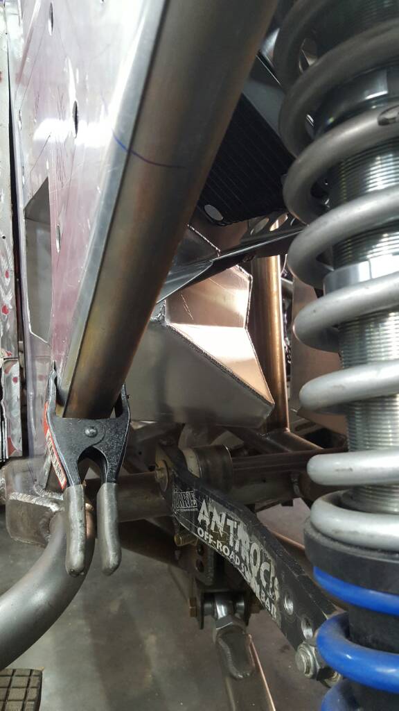

Would be trick to have the light in that angled panel, and a projector/reflector for it behind the factory taillens vs 2 lights.
Yea i thought of that, and would be super trick, but the factory taillights are outside of all the panels, and only a half inch of clearance between the closed tailgate and light panel.
