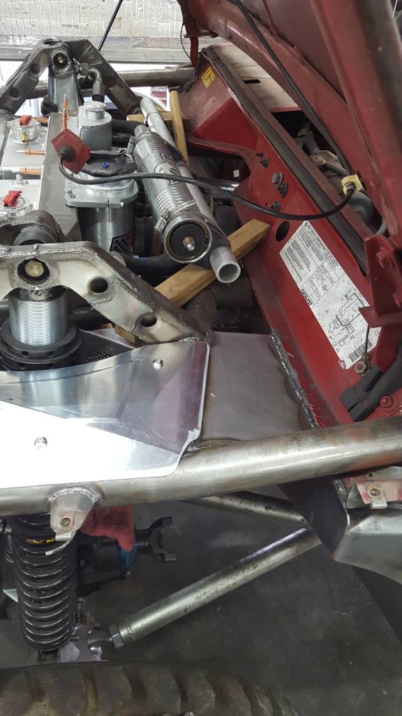

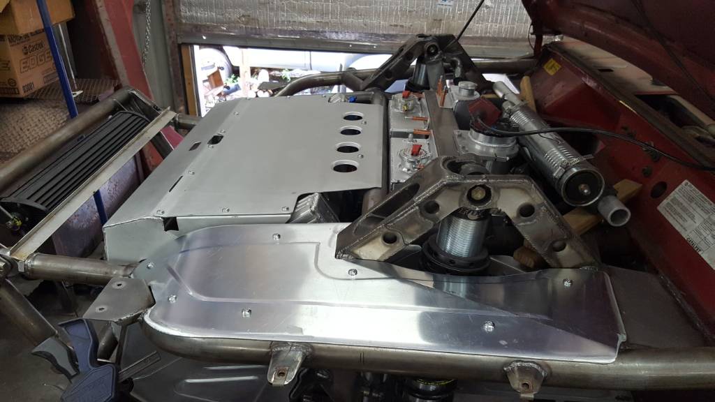

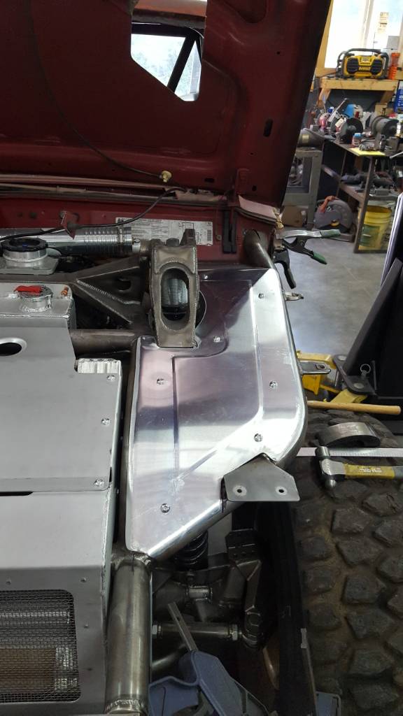

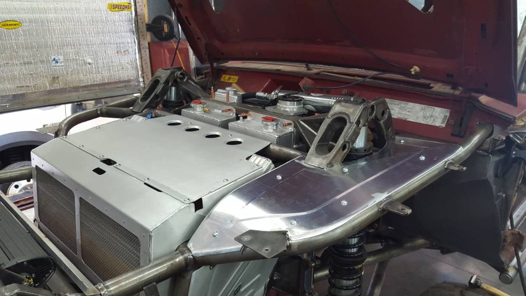

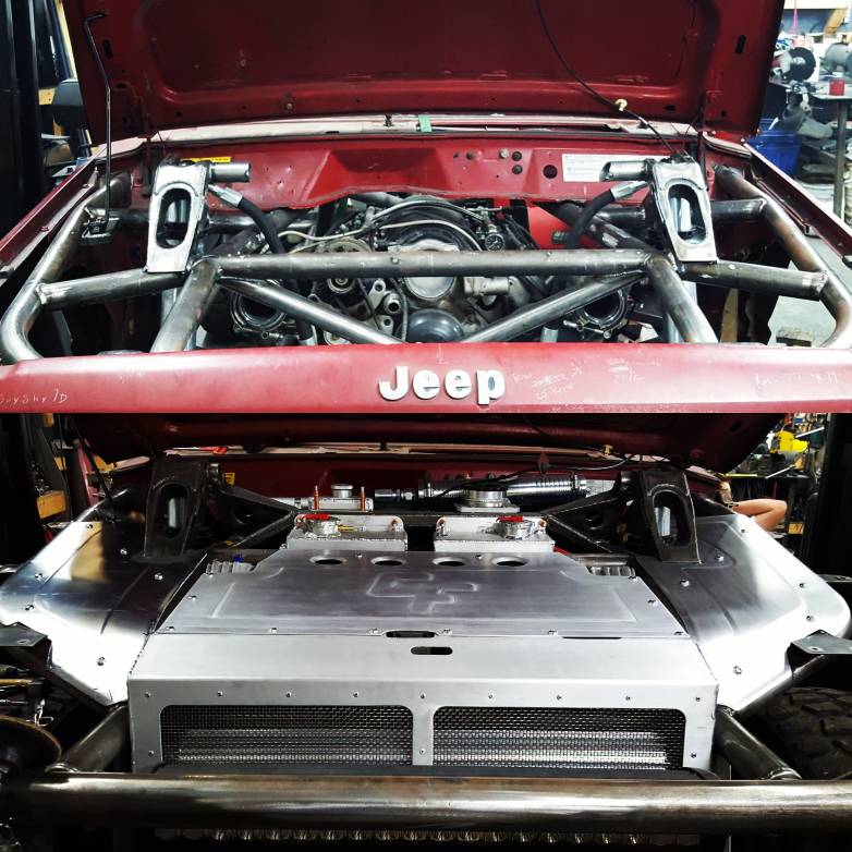

Spent some time in the shop today to get out of the fog ...
Working on the last two exterior pieces of tin, to fully close the front inner fenders up.

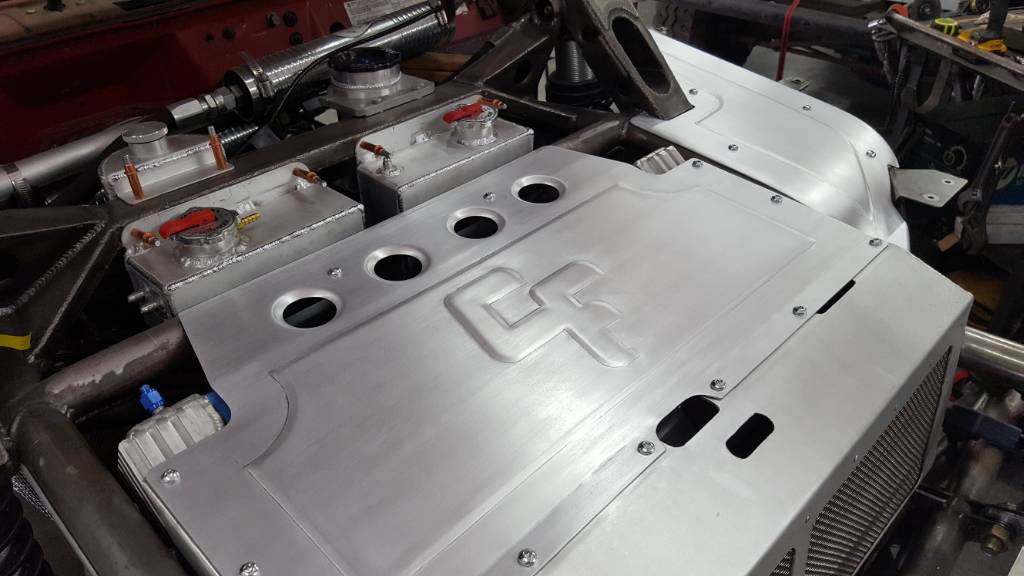

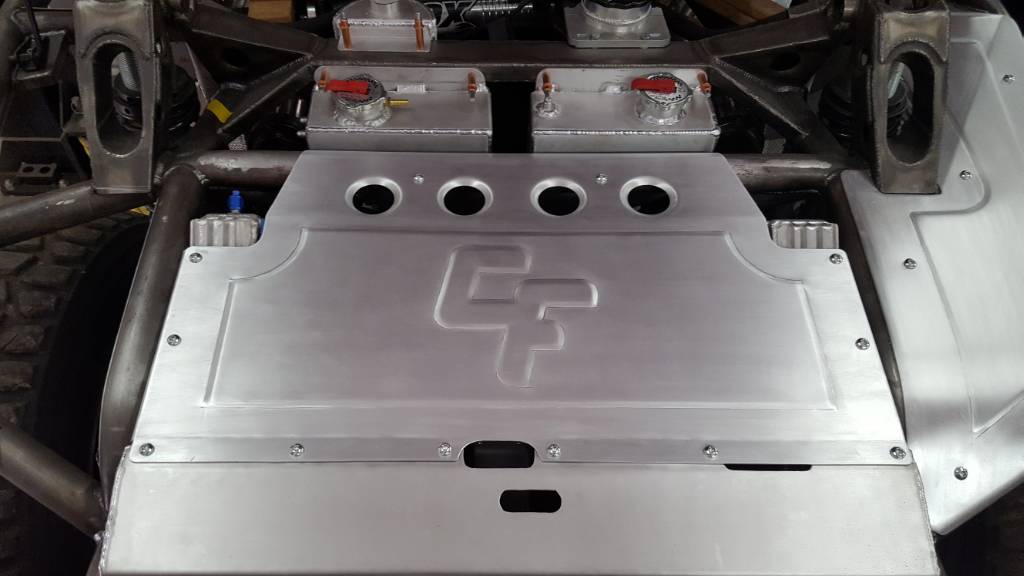

Also decided the radiator cover looked a little plain, so I added some branding... my first attempt at script with the bead roller. Turned out pretty decent, even though it was on .090 aluminum, awful thick for rolling.
Matt
Badass like a mustache with titties
Edit: serious question, does bead rolling shrink the material or stretch it? Just curious if you had to make a whole new panel.
Same panel. Kind of does both, depending on if you go off the edge or run a closed pattern. It didn't affect this panel more than a few thousands on the perimeter, didn't even need to enlarge the bolt holes.

Same panel. Kind off does both, depending on if you go off the edge or run a closed pattern. It didn't affect this panel more than a few thousands on the perimeter, didn't even need to enlarge the bolt holes.

Okay, cool. Never used a bead rollers so was curious
That bottom pic looks very "Chrysler" more specific stripped down "dodge truck".
That grill and flat fender line is really cool.
Your gonna half to park this thing at some cruise ins.......some old timers gonna drop their teeth.
I see that now that you mention it. Kinda early 90's dodge truck, lol....'90's throw back.
Yea, car show, go all Batman evil doer nemesis, Two Face, and strip the passenger side sheet metal off, and keep the drivers side on... old dirty bastards won't know what to think.
