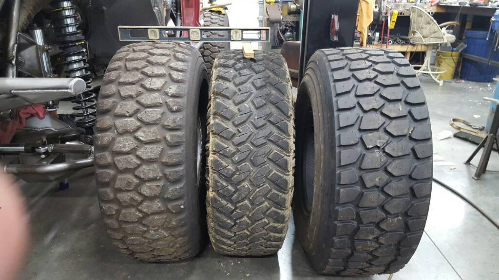

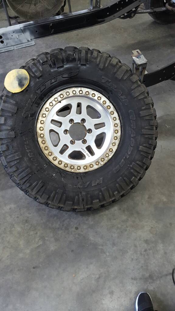

I now have my dot/4800 class tire package started...and as a plus all 9 wheels are the same, (retired pro comp bead lock from a few years back). They are wrapped in 37" Nitto's with a respectable 85-90% tread.
Mattix and I even broke out the rubbing and polishing compound to see if they would wake up...and they did. Well, the first one has anyway...only 8 more to go.

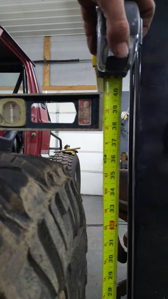

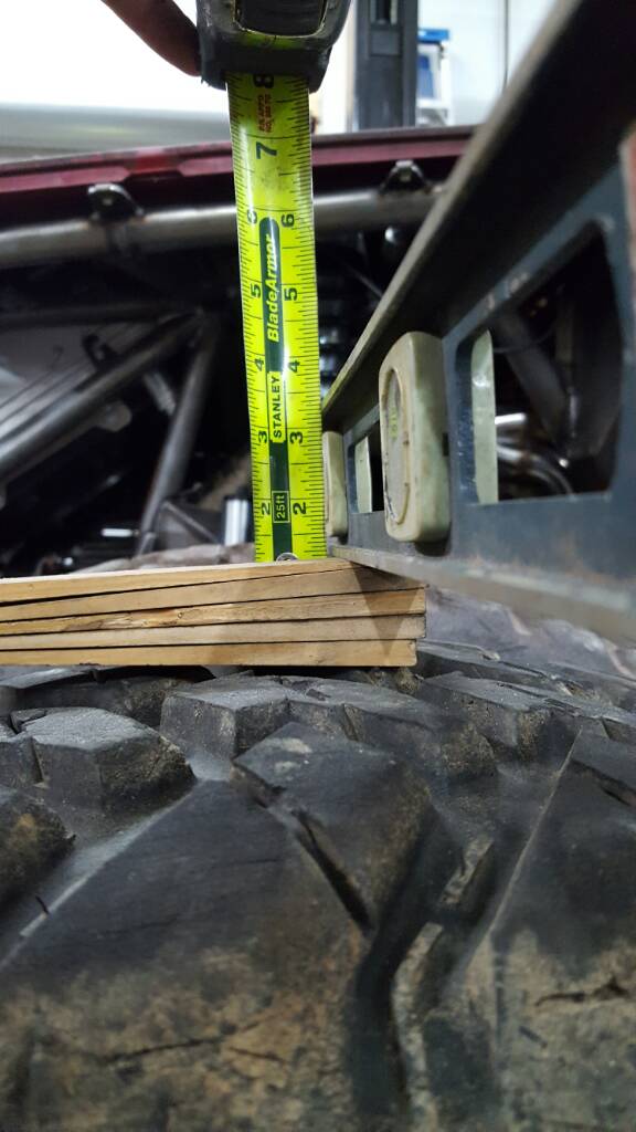

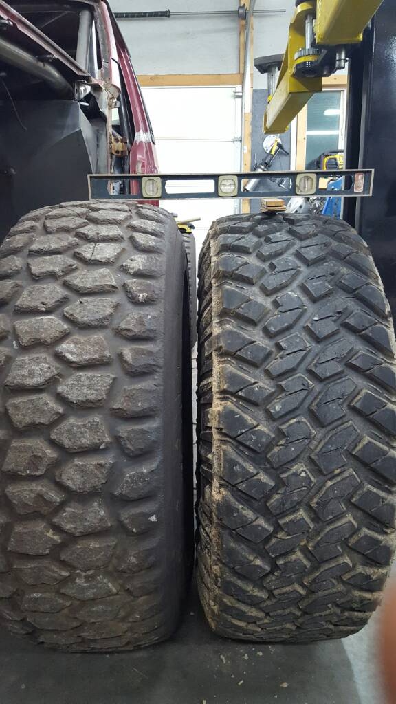

And for those interested in measurements. Here's the tale of the tape...both sets mounted and 20 psi on 17x9 wheels; although the bfgoodrich is mounted to the truck. Both sets are near 90%, even though the bfgoodrich are half tread comp tires. Section width on the bfgoodrich is a full 15" at the bulge, while the nitto measures 12.75.

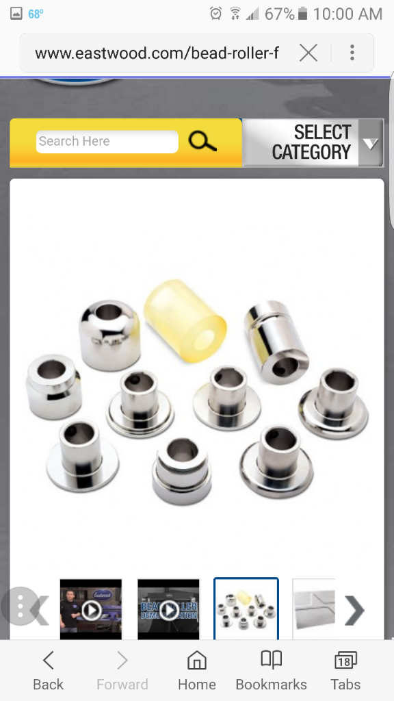

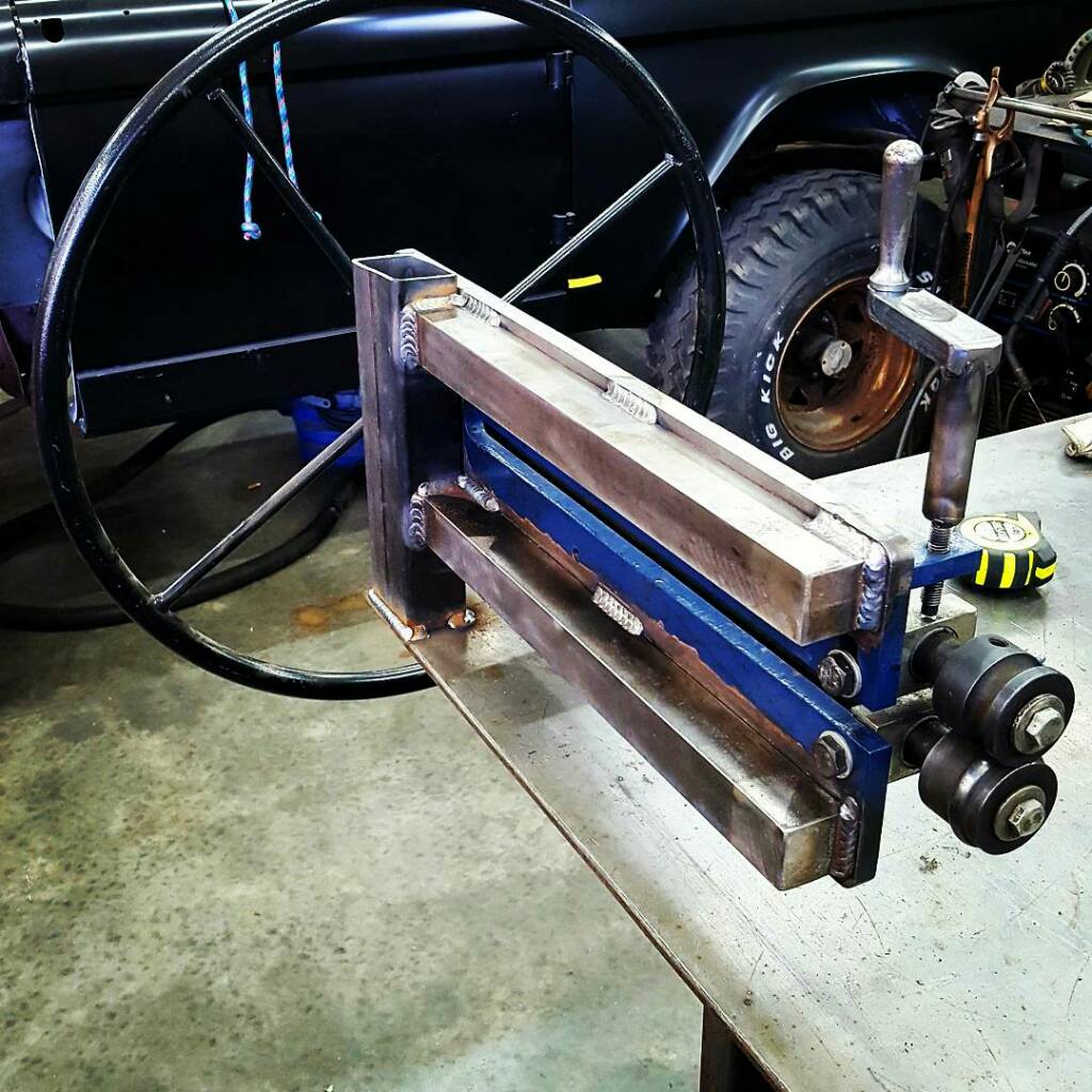

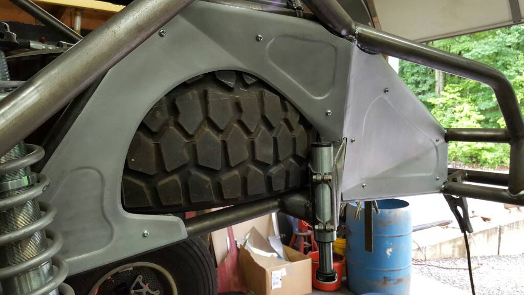

Great looking work, what bead roller are you using and do you want to sell those bead locks that won't fit over your rotors ?

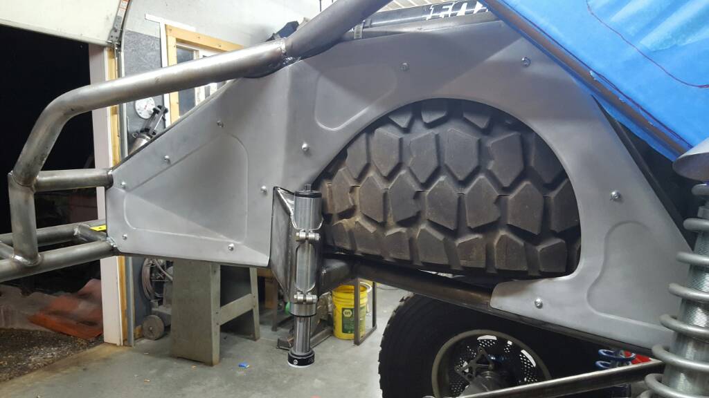

Eastwood economy roller that I've modified with a wheel, stiffening and tension handle. Their included dies, but hope to purchase their artisan dies before I start interior.
Traded the wheels for the used nitto/ pro comp combo.

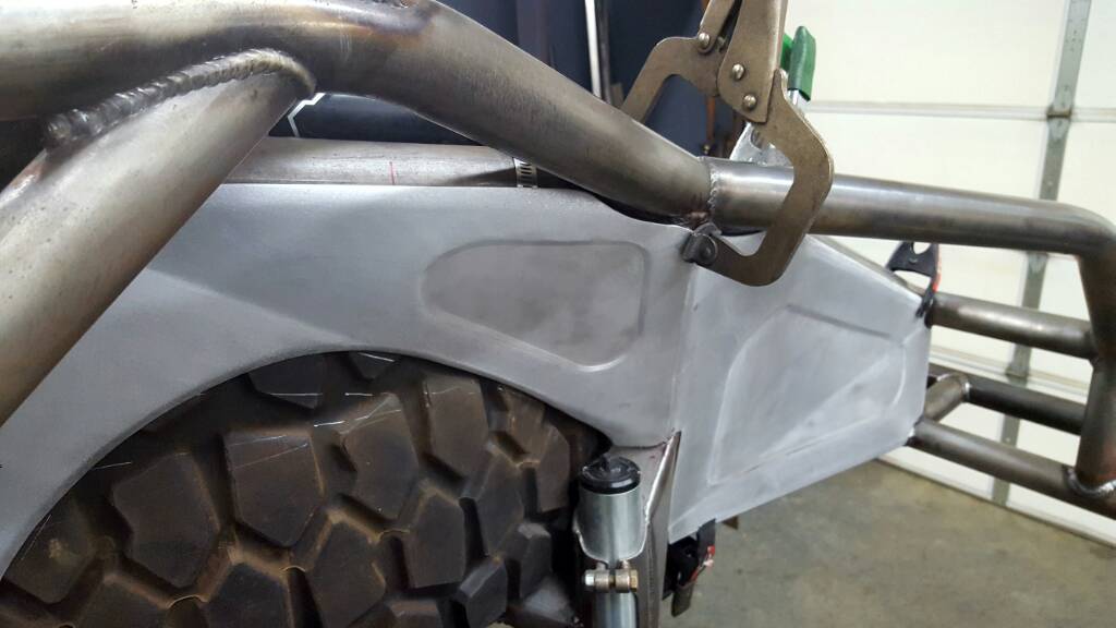

Lots of forming done here also.

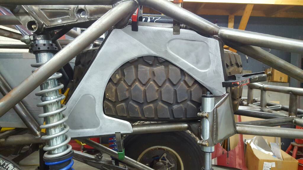

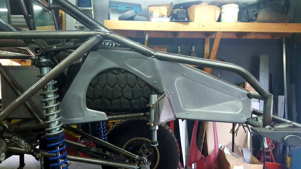

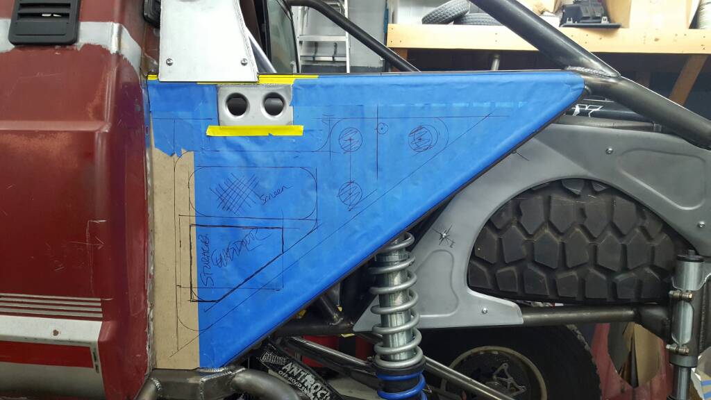

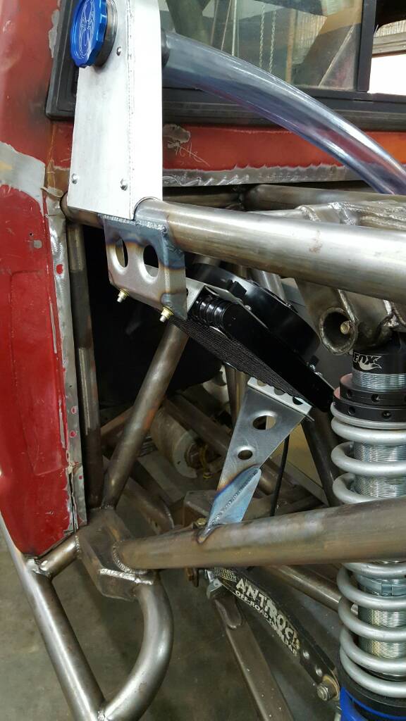

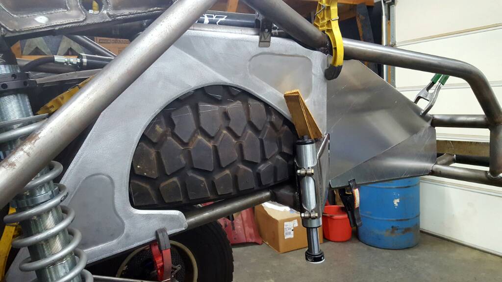

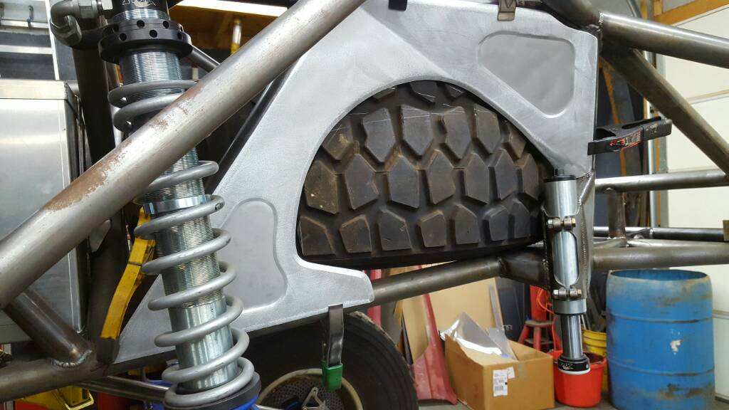

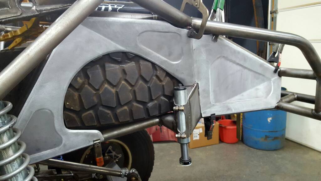

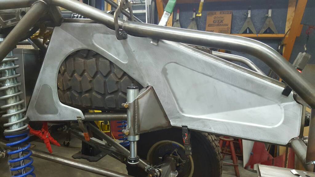

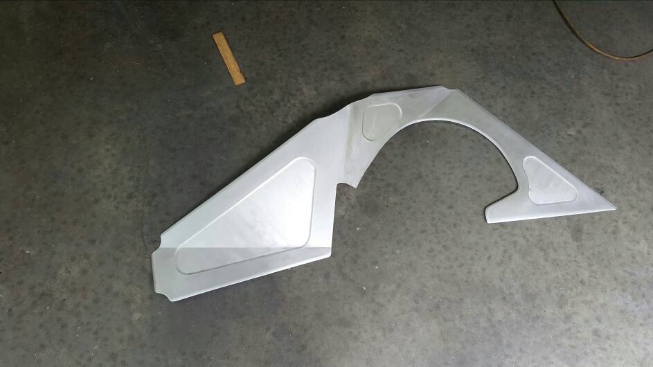

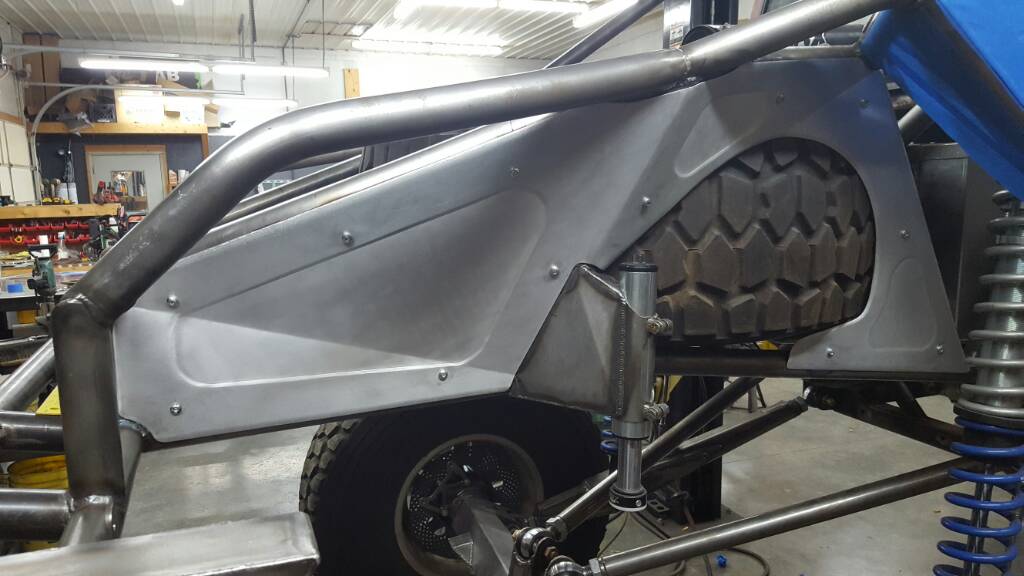

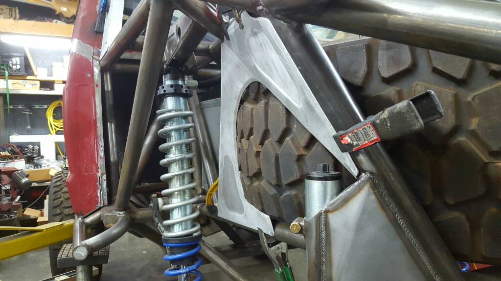

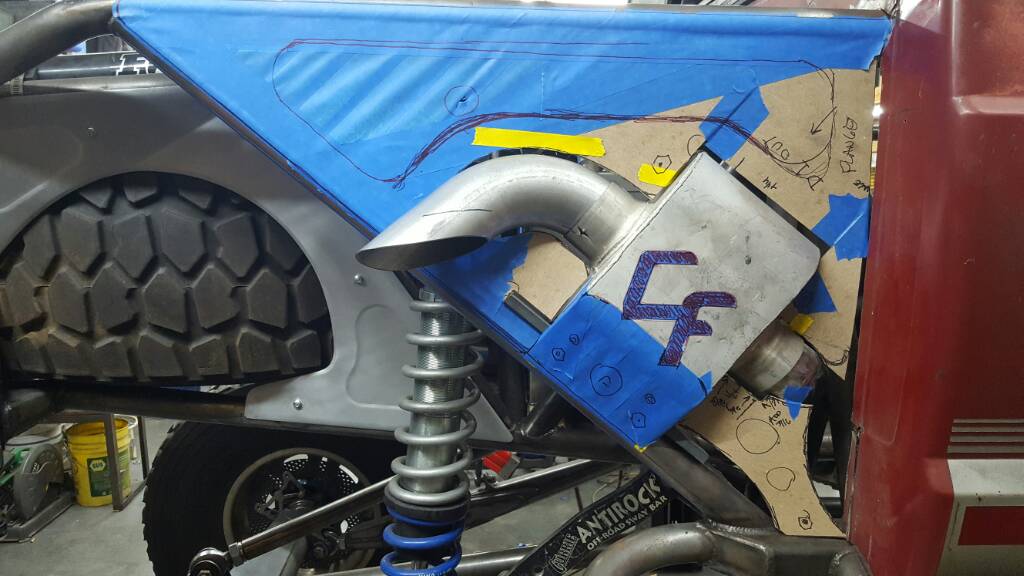

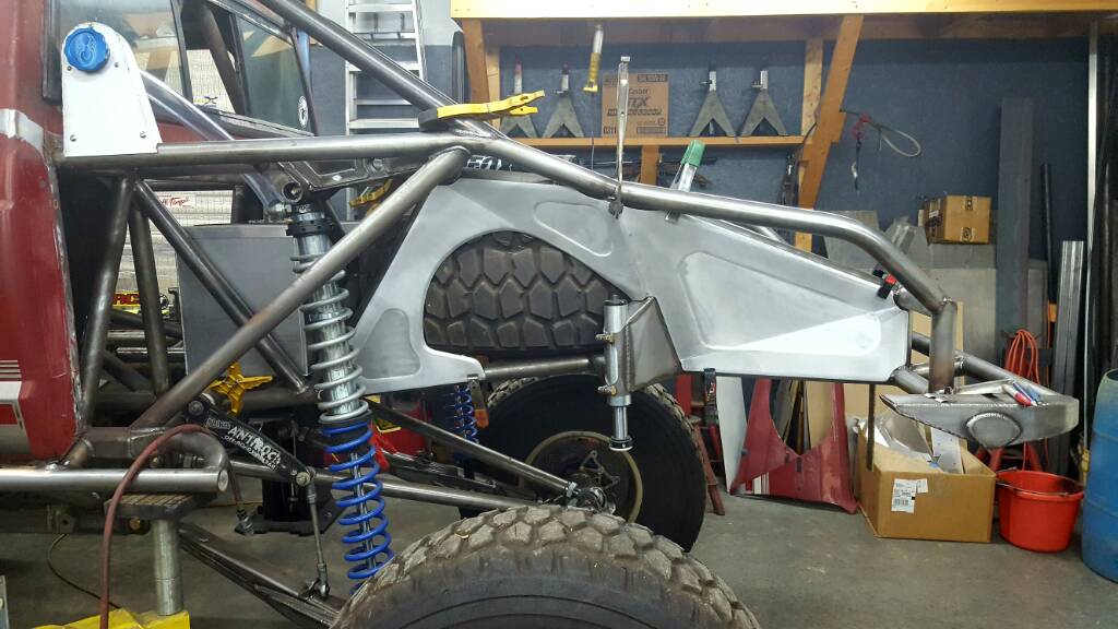

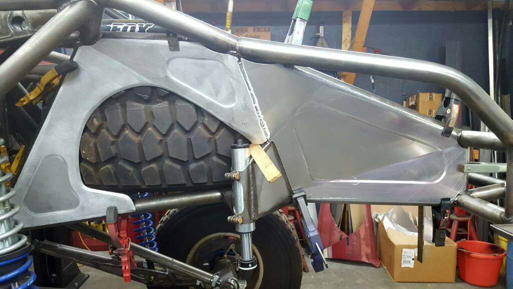

Nothing much new to see, finished the passenger side rear half tins. Started the templates for the front section of the rear tins on both sides.
The area between the forward and rear tins (around the coil over) will be covered also.
