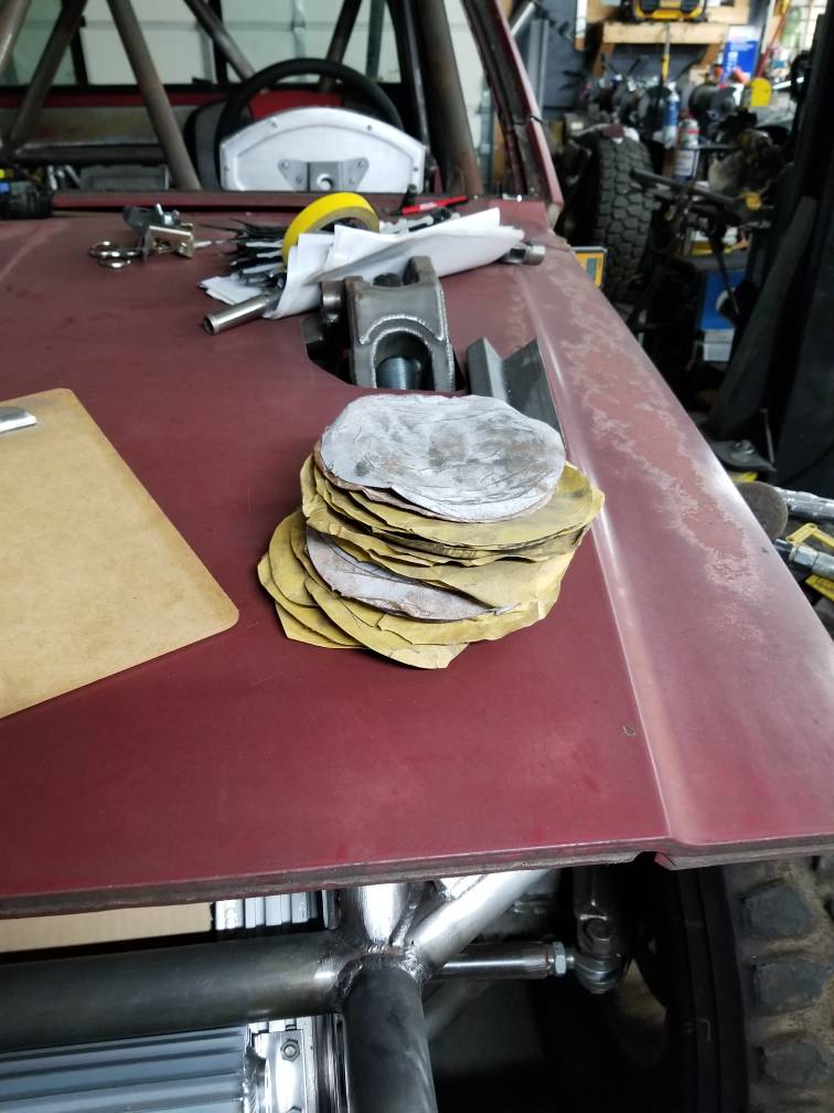

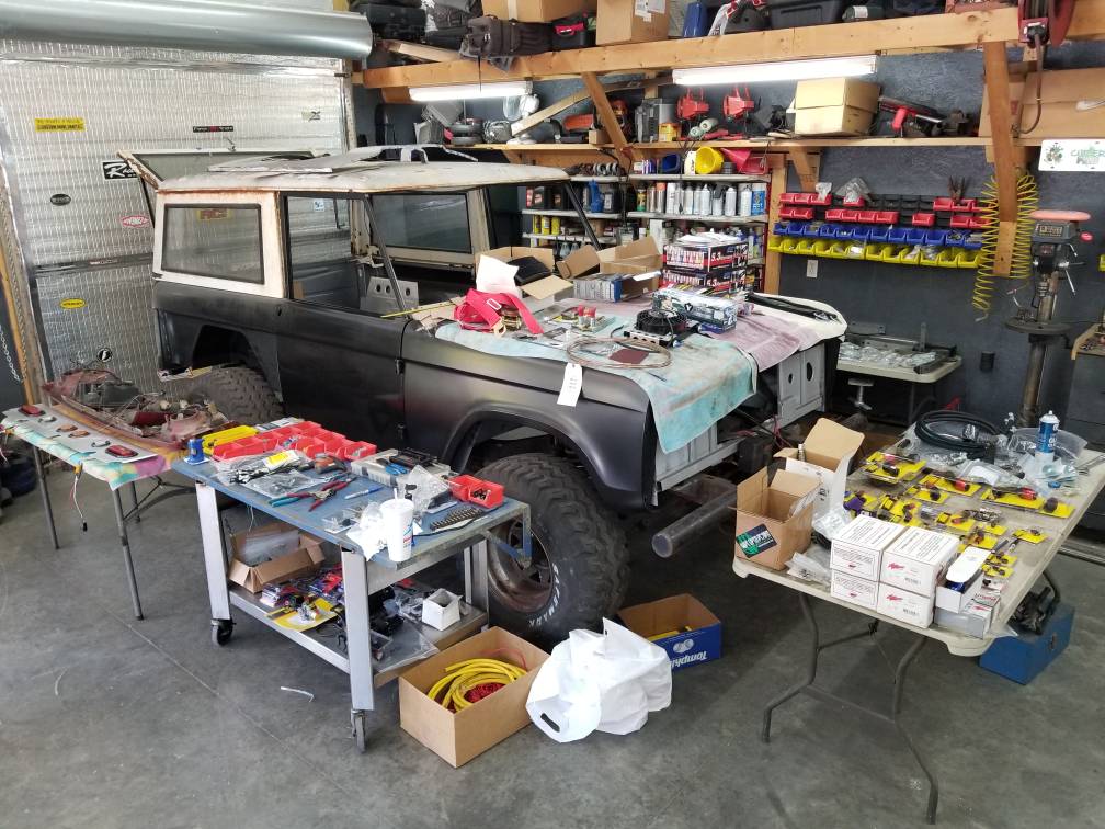

I put Carter to work Monday sanding and cleaning the metal work... he didn't use too much consumables...

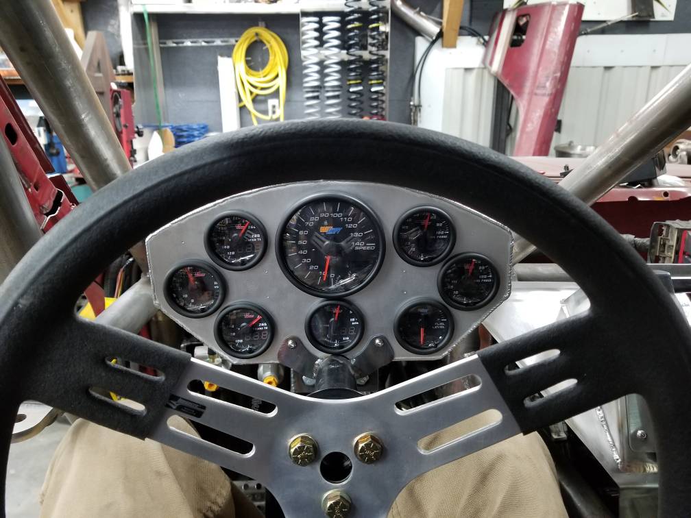

:eek: Speedometer reads 140. I expect nothing less.
I was thinking airplane cockpit.....with the Speedo comments I wasn't far off.

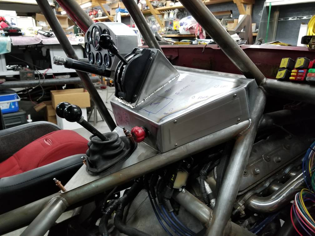

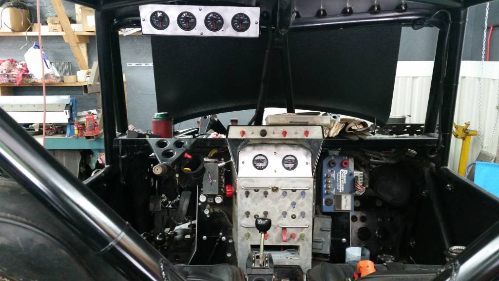

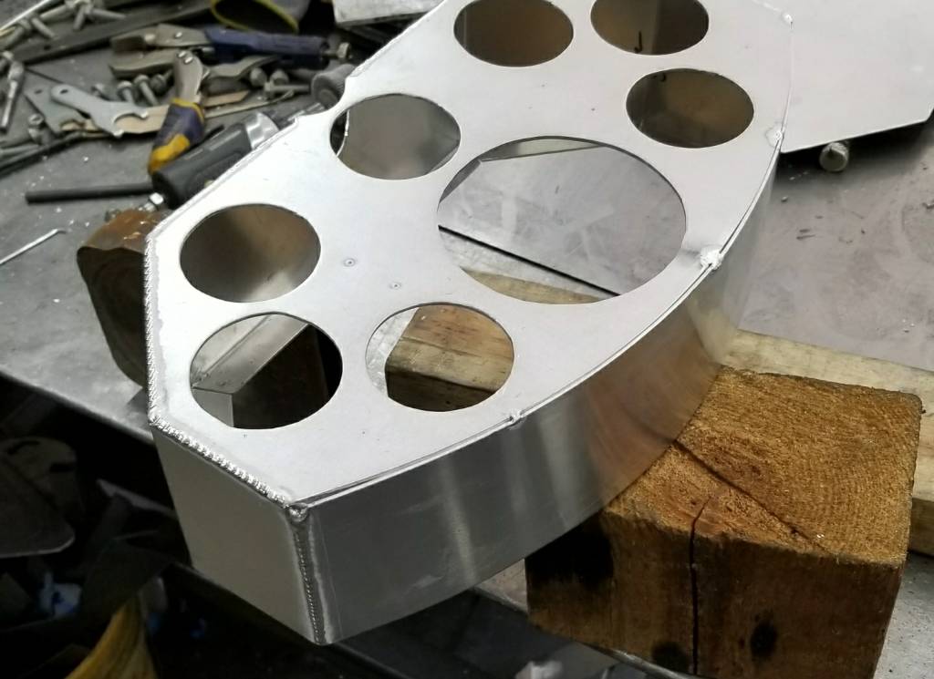

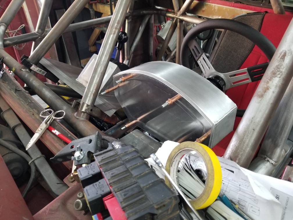

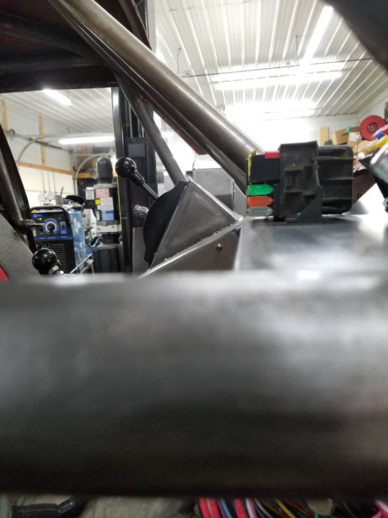

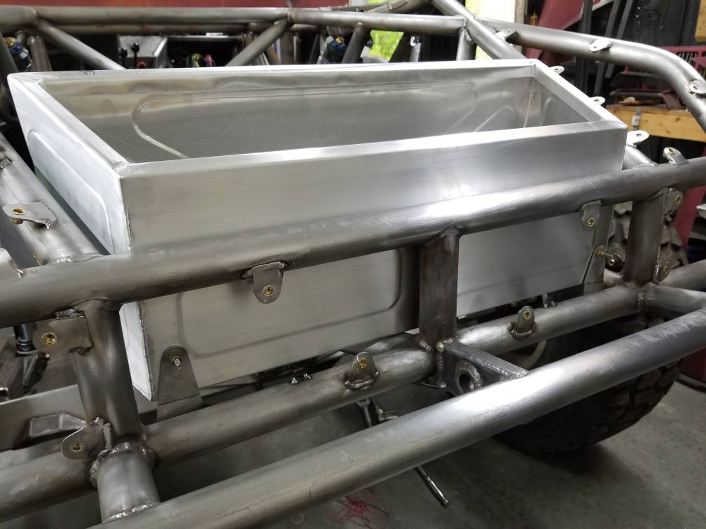

Console done- (it will be permanent after plumbing and wiring completed), fixed section of dash complete- (last two sections will be removable). Fuse panels have a home, left is the mast motorsports relay/ fuse panel, right is kwik car 14 circuit chassis harness. Rear half of chassis was tabbed out with Ruffstuff zip tie tabs, the toolbox is tabbed and no longer homeless, still need to weld the hinge and add the latch.

All this sweet metal work and your'e just going to bolt the fuse/relay panels to the top of the dash? :shaking:
I know there's probly a plan for after Dixie.
Nope. I have always put the fuses out there where I can see then blow, and replace easily.
Sent from my SM-G950U using Tapatalk
Fair enough. I was thinking some recessed pocket where you could still see them from the top, but not the outside.

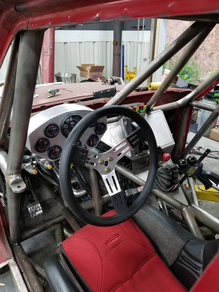

From the beginning, I intended to do a luxury pre runner type interior, but I kept getting drawn back to a more race inspired, nut and bolt, wartime aircraft minimalism, essentials only design. Which became more realistic due to the confines of this tiny cab. Those who might be alarmed by small spaces should not ride with me...
There will still be much artistic element in the interior over the next two weeks, there are many panels left to complete to seal her up. There will likely be modifications over the years of ownership... See above....

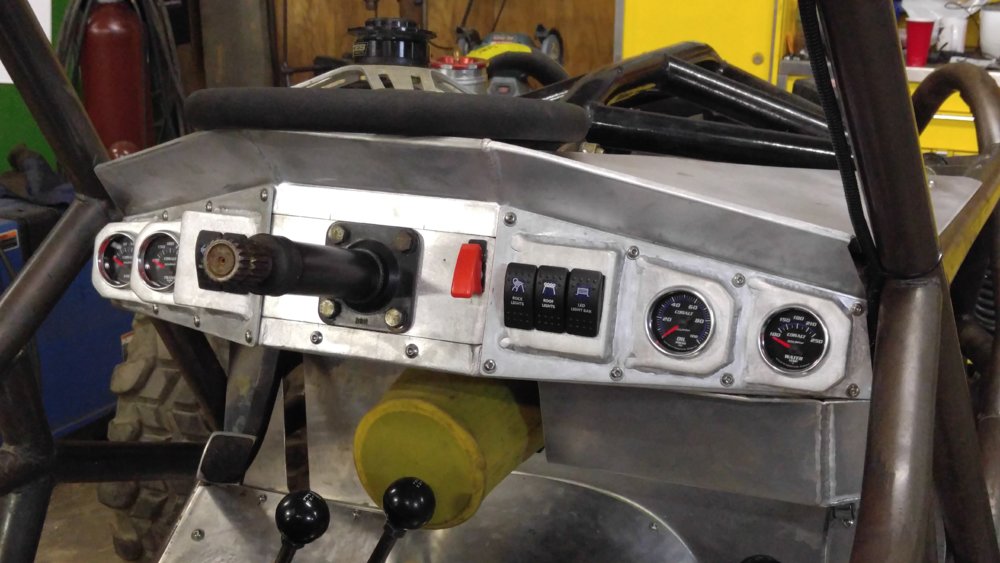

Notice the fuse panel where my right knee would be...
I do miss her... but not too much...

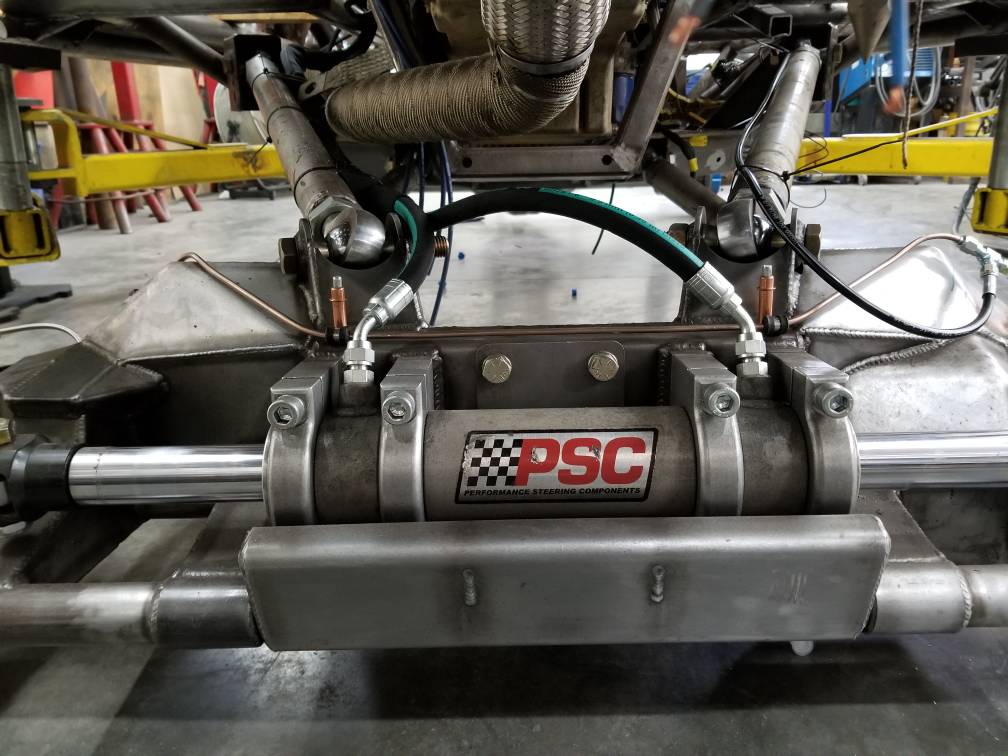

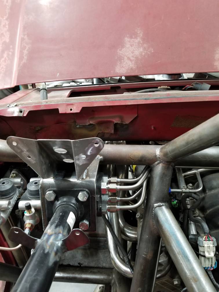

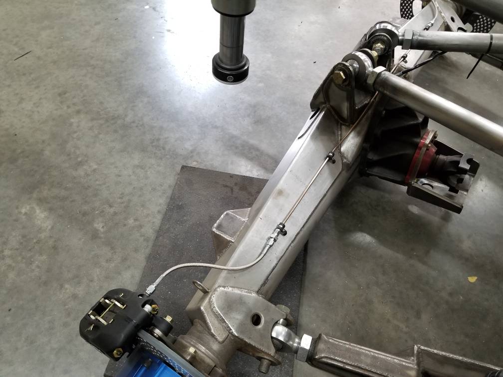

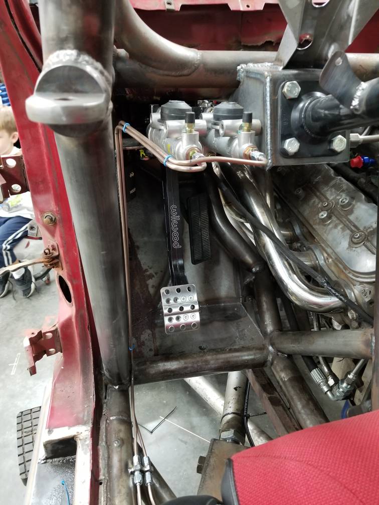

Plumbing
-steering 90%, two lines left for cooler/ reservoir; stainless hardline, hydraulic hose
- brakes done; ni/cu hardline and flex
-water pump heater ports tapped for -AN fittings

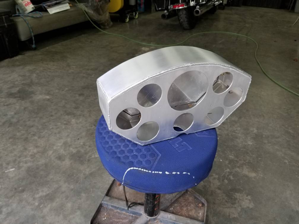

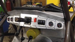

- gauge pod pre wired, ready for cannon/weatherpack plug

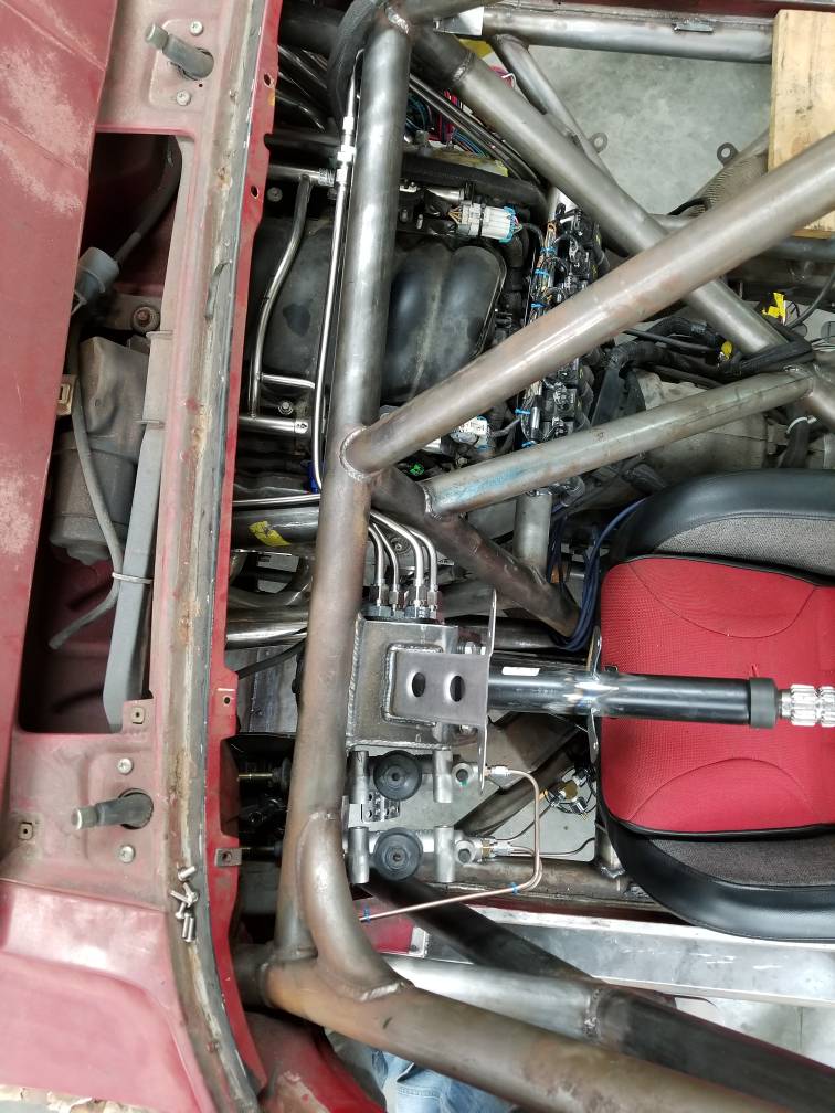

And for those that have had concerns about the foot room/driver comfort; ask Scott... he spent about 4 hours in the driver's seat while the truck was suspended 4 feet of the ground on the lift, plumbing stainless steel steering hard lines. While I did the cutting, bending, flaring, he was patiently reclined there, constantly attaching and re-attaching said lines till we had it just perfect!

Plumbing, (and the steering is now complete.) Fuel and trans cooler left to do, ran out of -6 unions.
Steering ram lines are same length, flex lines down the links for brakes are the same length, spares already here as well. Spare for ram line I will use for differential vent hose on rear.
Matt
Matt
Illusion I'm sure, but those lines attached to the upper look looker they might get awefully close to the exhaust during travel?
I loved the use of hardlines on the steering, not sure why more folks don't use it.
Sent from my SM-G955U using Tapatalk
Plenty of room, just camera angle.
Hard line is definitely the best in my opinion. They can certainly be more work initially, but you can forget about them after install. They can be more economical also, after you have the tools.
