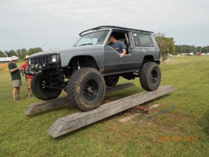

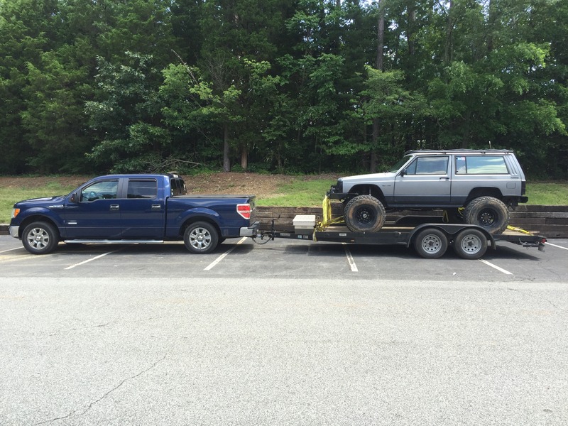

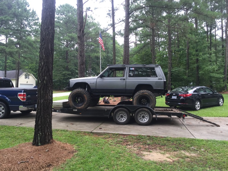

So this weekend I picked up a trailer to borrow for an upcoming trip to Pots Mt. Did a test fit of the jeep on it and it barely fit. Tires squeaked as they rolled past the fenders. It tows straight and feels good behind the truck. It's a little far forward in this pic. I moved it back about 8 inches to take a little weight off the hitch.

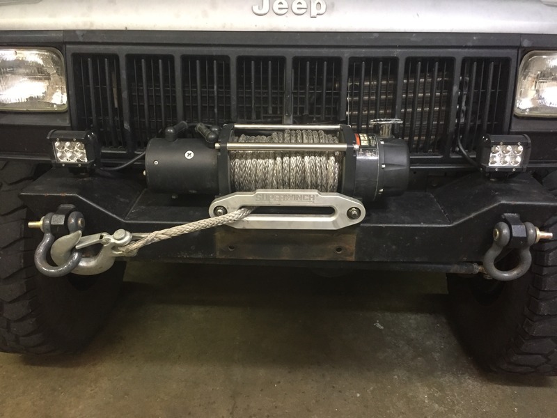

Superwinch 9500lb with synthetic rope

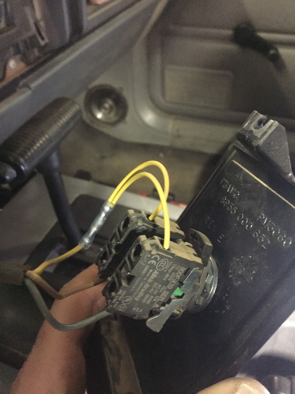

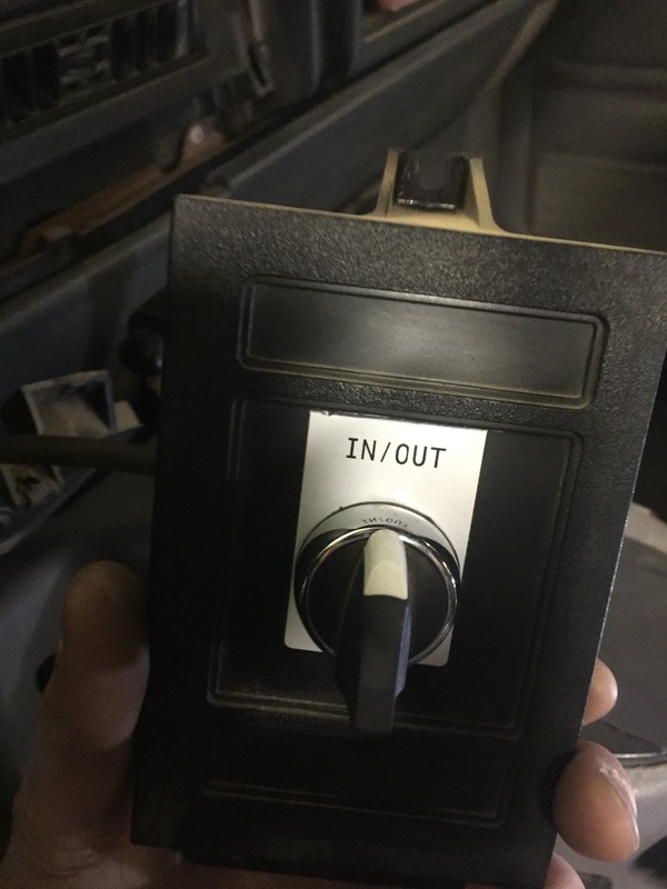

Redid the in-cab controller

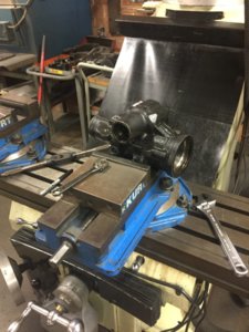

I've got some harnesses on the way and will hopefully be ordering the 2x6 tubing needed to replace the rockers.

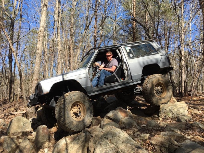

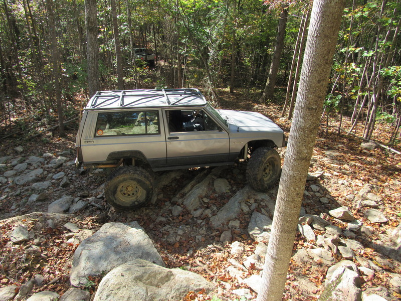

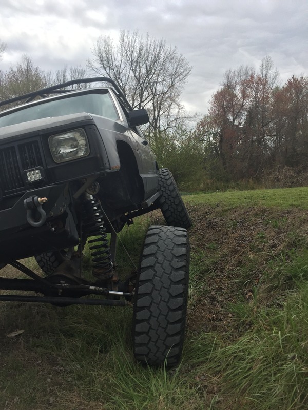

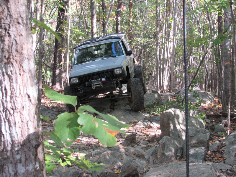

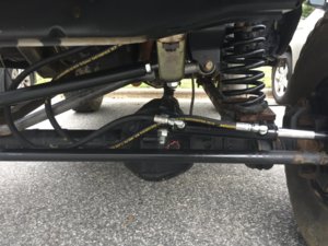

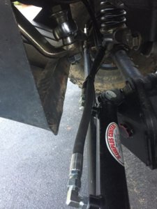

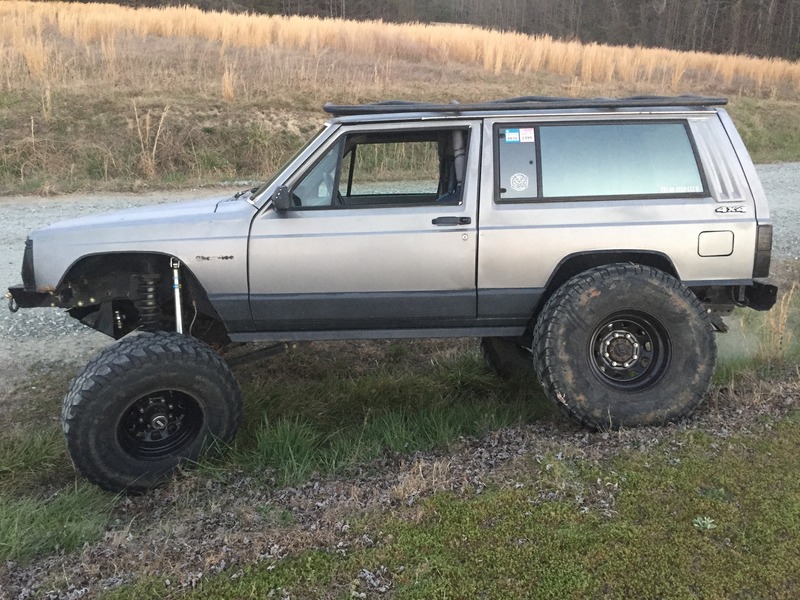

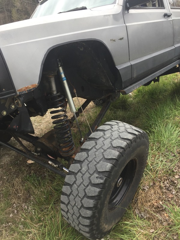

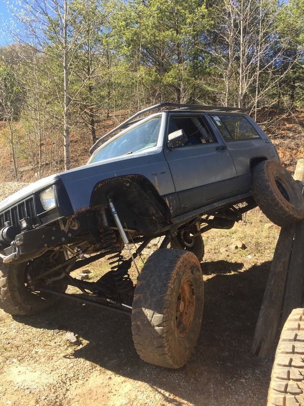

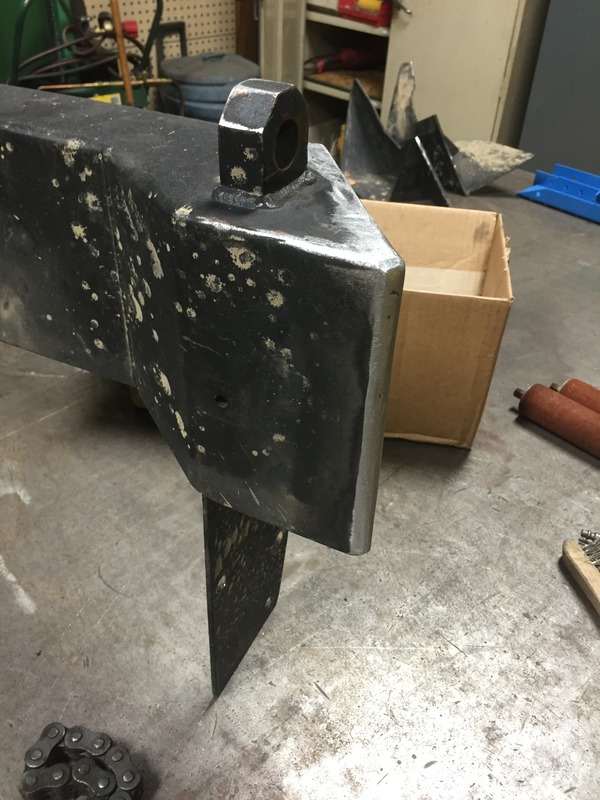

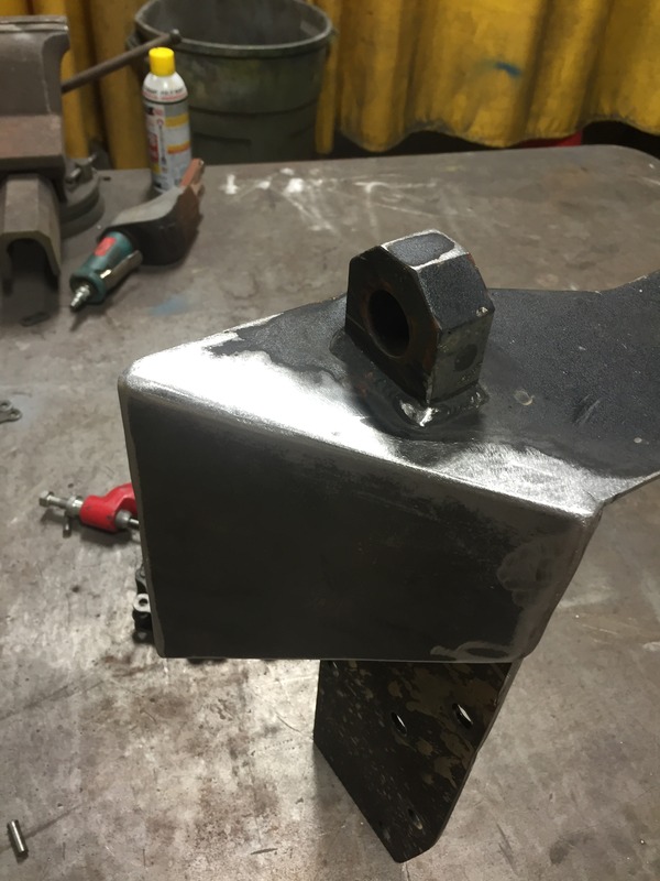

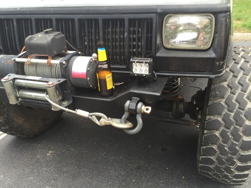

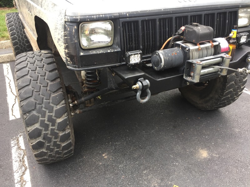

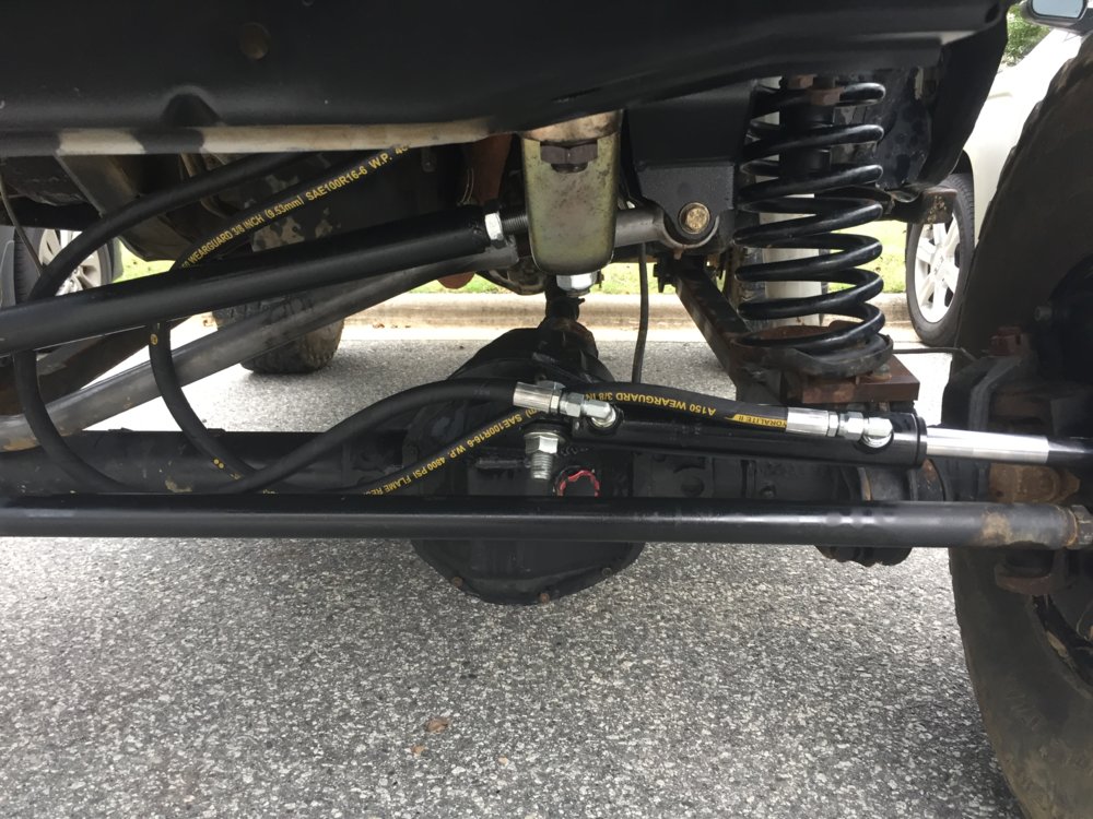

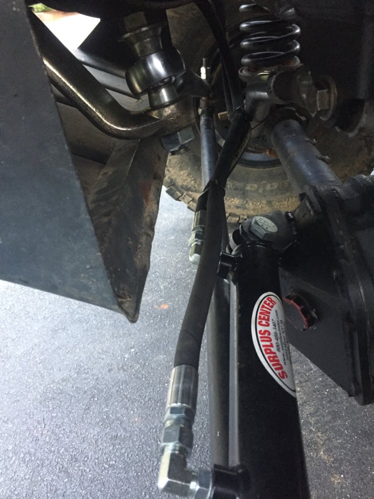

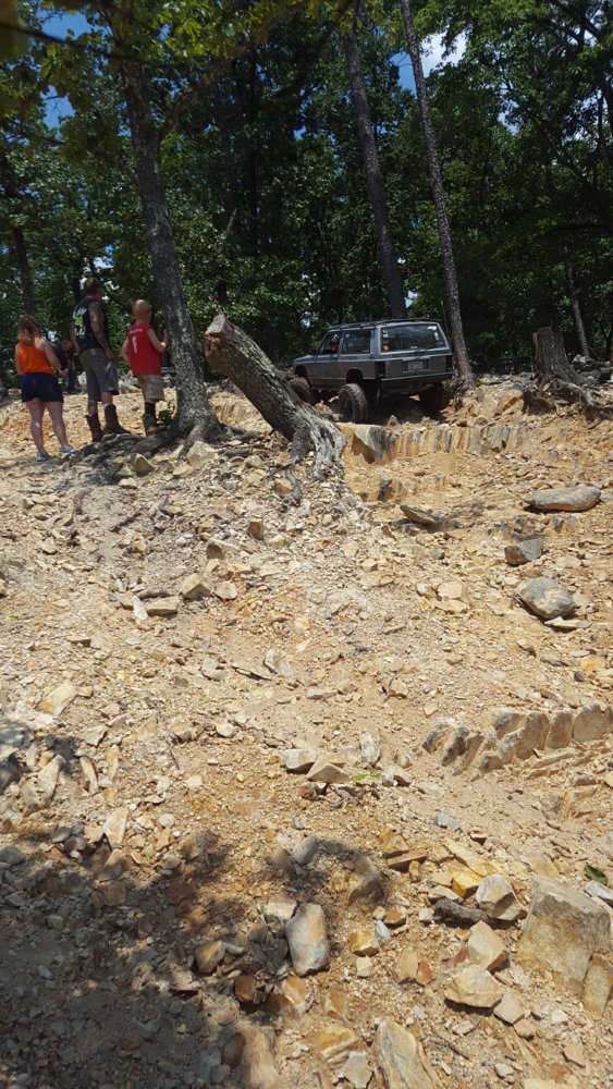

After installing the new shocks I looked over the whole rig for any issues before loading up for this past weekend. Unfortunately I found that I had spun the passenger side tube on the front axle. I cleaned it up, welded the plug welds and then the tube to the diff. After that it was time to take care of the real reason the tube spun...the radius arms. While Ford's radius arms work very well for on road vehicles, they really hurt articulation for offroad rigs (unless you make them very very long but thats another story). So, my plan was to install the wristed arm that I've had for well over a year now. I started work on this Wednesday night and finished it up Thursday evening, just in time to load up for the Jamboree. The increase in articulation was incredible. I am now in need of longer brake lines and limit straps.

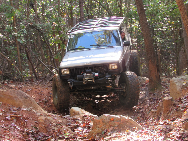

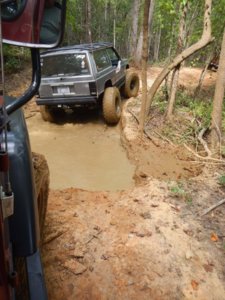

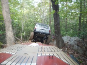

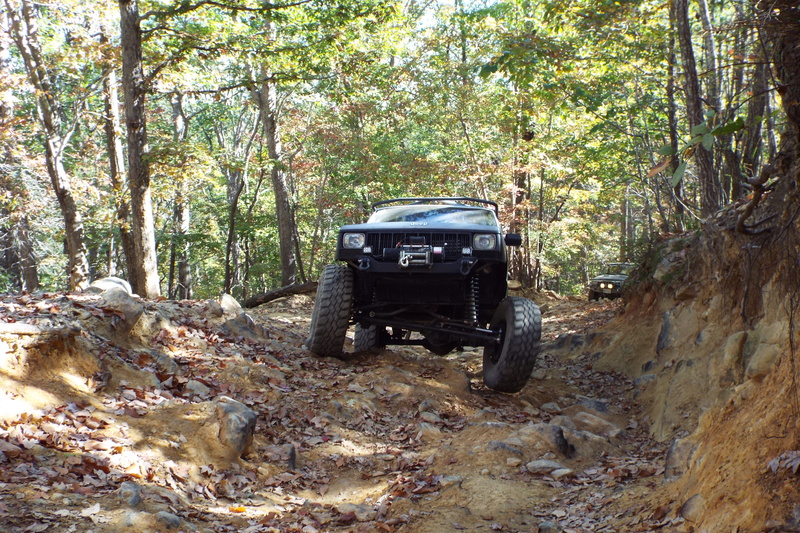

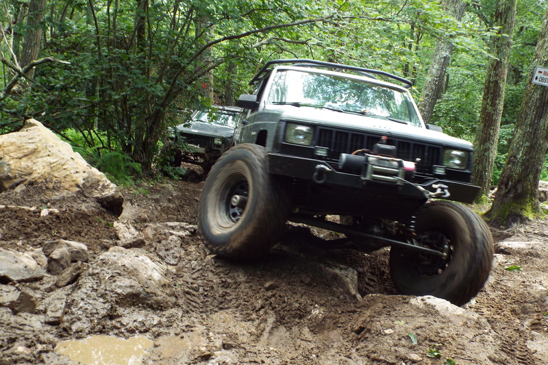

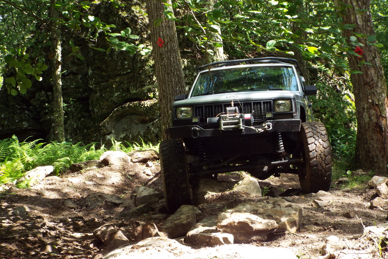

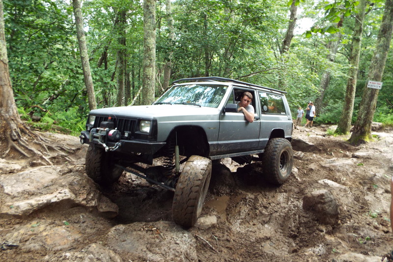

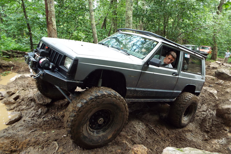

We wheeled Big Creek during the day Saturday so that we could avoid all the traffic on the trails in the forest. We then ran trails in the forest Saturday evening as the sun was setting and late into the night. Unfortunately there are no photos of the evening run but here are some from Big Creek.

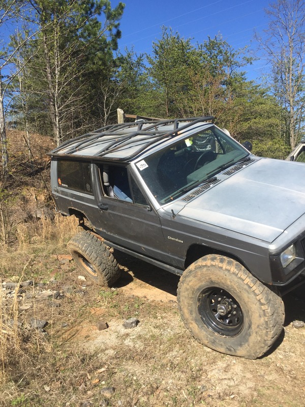

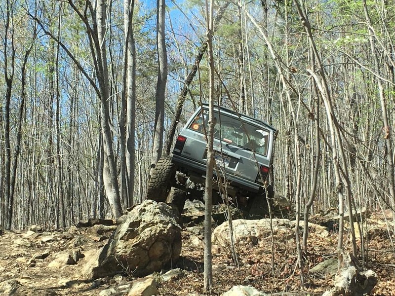

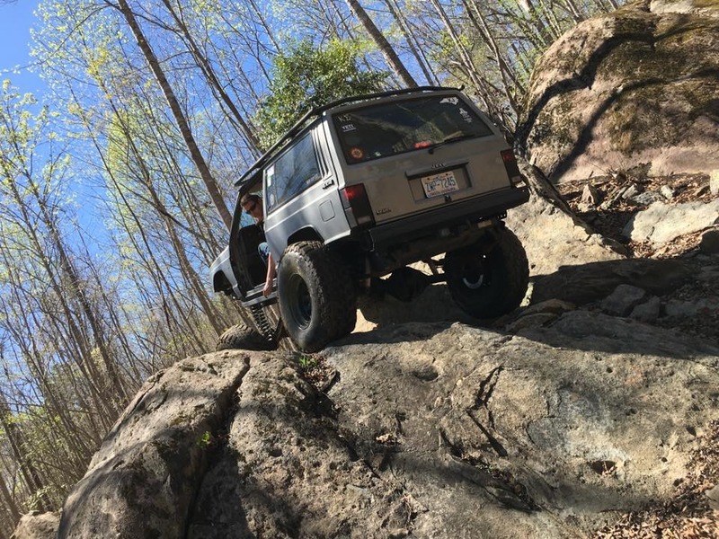

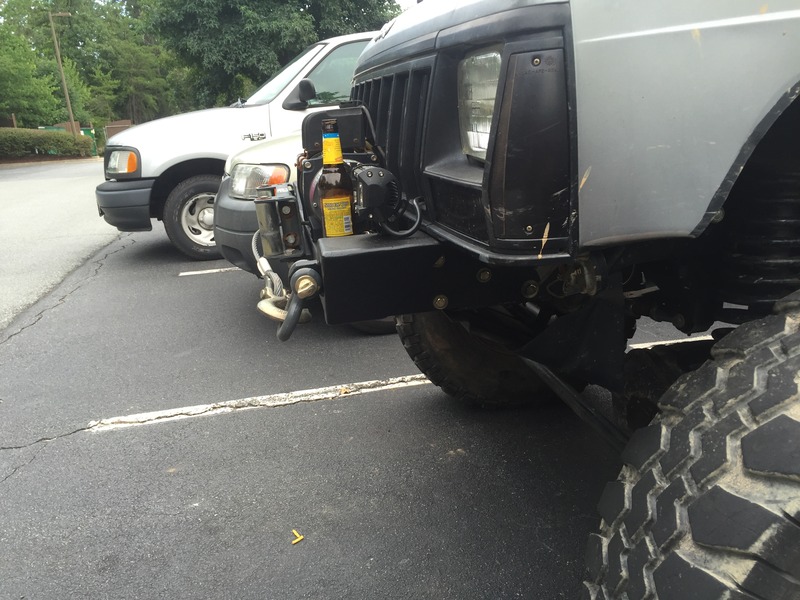

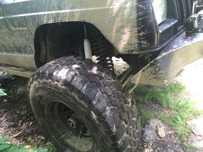

Wheeled the Flats this past weekend. It was an absolute blast. Damage wasn't too bad. Here's the list:
Busted tail light
Bent driver side slider
Hole in power steering hose
Dented rear diff cover
A Solid cover and new PS hose have already been ordered and will hopefully be here by Wednesday. The sliders will get replaced with 2x6.
Not many pictures were taken so here is all I have.

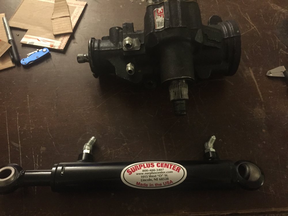

Doubtful. As of now I won't be wheeling the rest of this month but if I do, it will probably be a day trip to Uwharrie. I have a few things to get done before I really wheel it next. On top of the list earlier, I've got to replace the TC output seal, remount the CB, order harnesses, and move the hydro assist ram. None of this is difficult or time consuming, it's just finding the little bit of time here and there to get it done.
