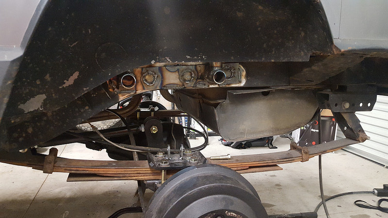

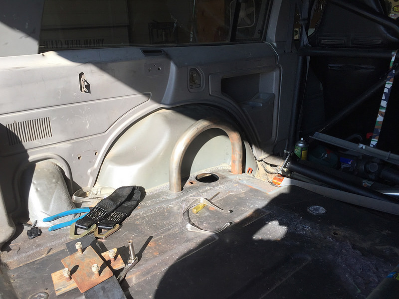

You remember how much you stretched the rear axle backwards before you got close to the tank?
It wasn't the tank that was the issue. I'm stretched 2" right now and still have plenty of room for the shocks mounted in the factory orientation. At 3" of stretch, I would have to tub the rear fenders and, at the time, didn't want all the extra work. I would also have to have a longer driveshaft made. There is still plenty of room between the tank and diff. I can take a pic this evening if you'd like.
I'm stretched 3" but did a lot of cutting in the rear before I just chopped it off a couple years ago. flipped xj springs net 5" stretch but require fuel tank modification. With my skid plate and tank I'd say no more then 3" or 4" before you come into contact with them. I used 2wd f150 springs for my mains and built my pack. MJ spring will net a 3" stretch too.

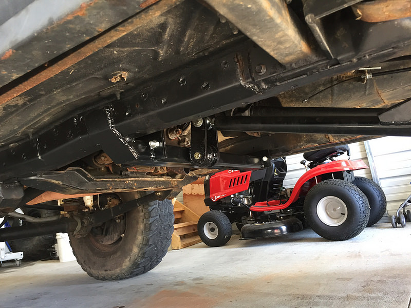

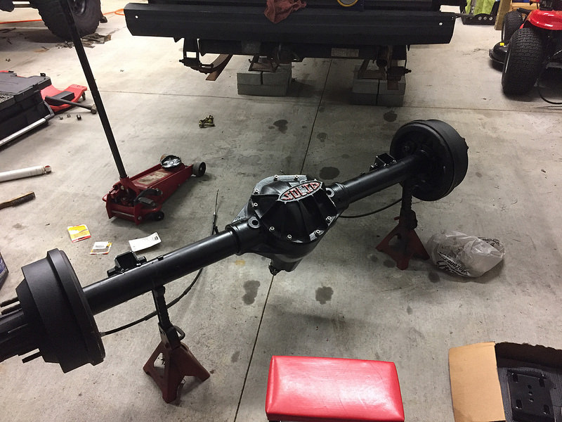

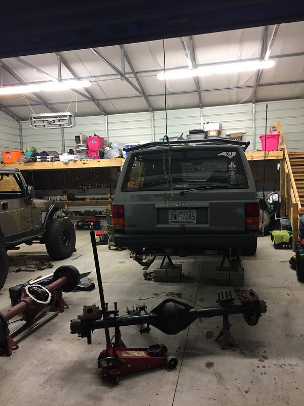

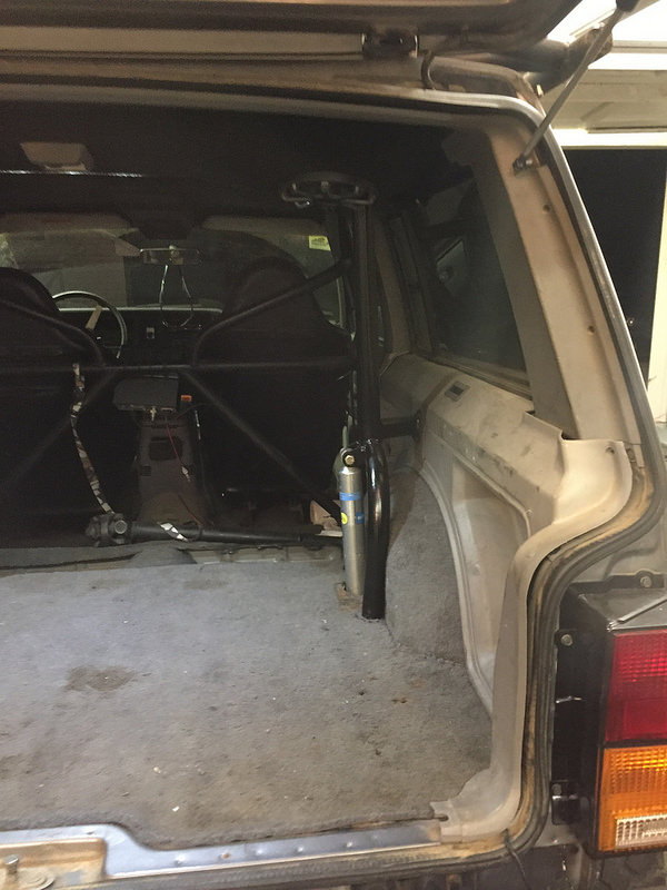

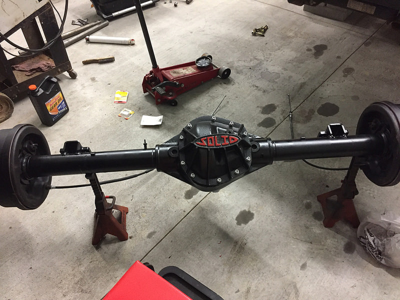

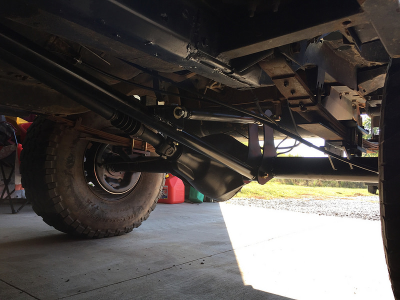

Been working on the jeep a lot as of lately. New rear axle is in. New traction bar is in. Shock hoops are under way. I've got until Saturday to finish everything so I can have a week to break in the new gears before Jeep Jamboree.

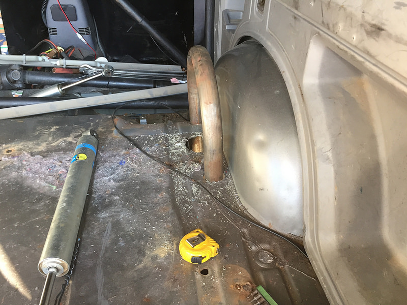

Saturday was a productive day. Finished the shock mounts, painted, traction bar set, shocks installed, ebrake cables set, and started on the exhaust. I had to stop to head to Raleigh for my mother's bday. I have to return the muffler I bought since I didnt pay attention to the inlet/outlet locations. I bough an offset in/centered out instead of a centered in/offset out. I did get the rest of the exhaust welded up so all that's left is to install the muffler.

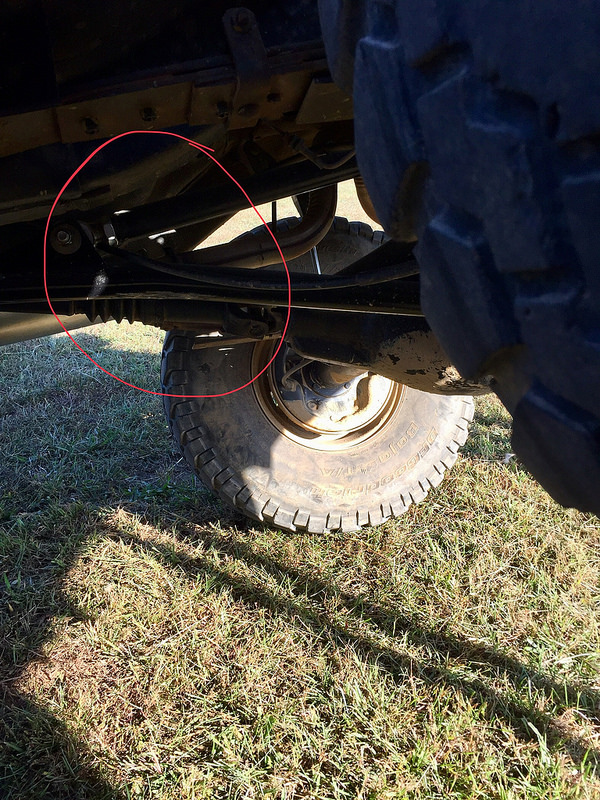

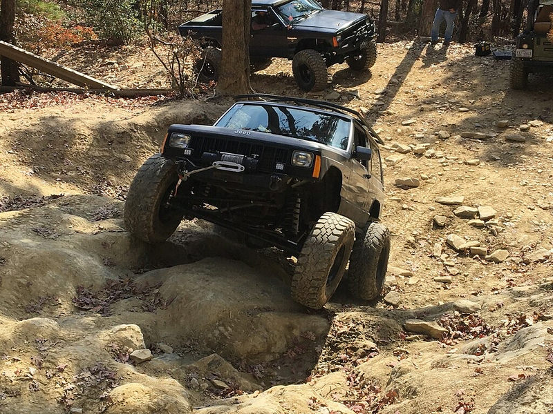

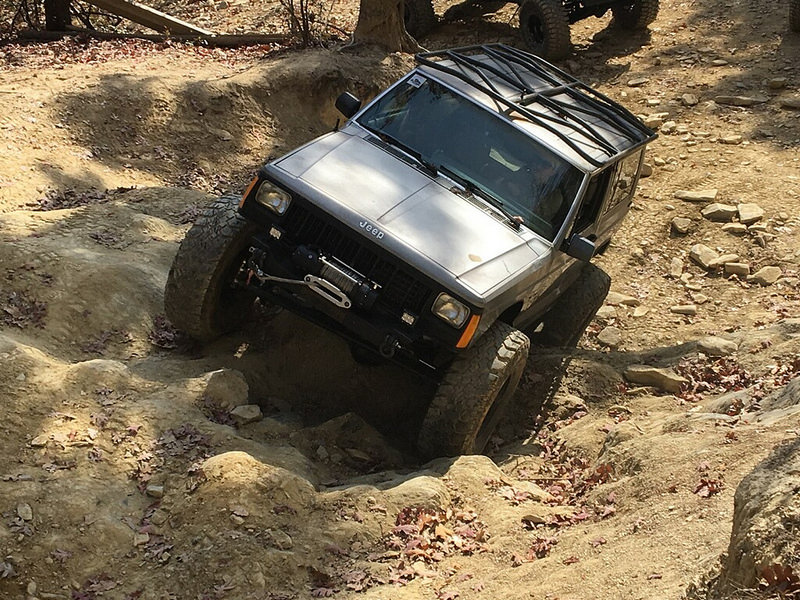

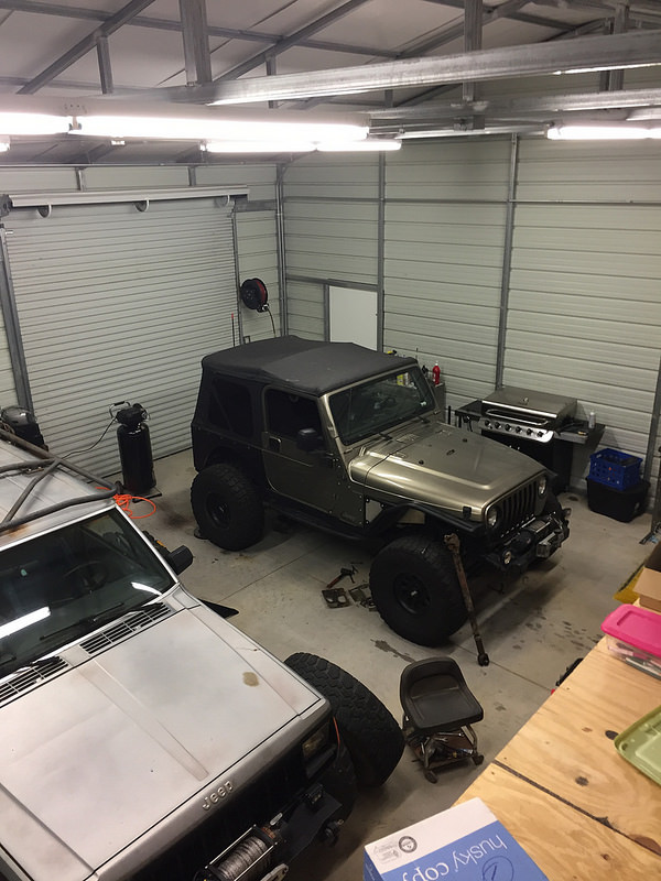

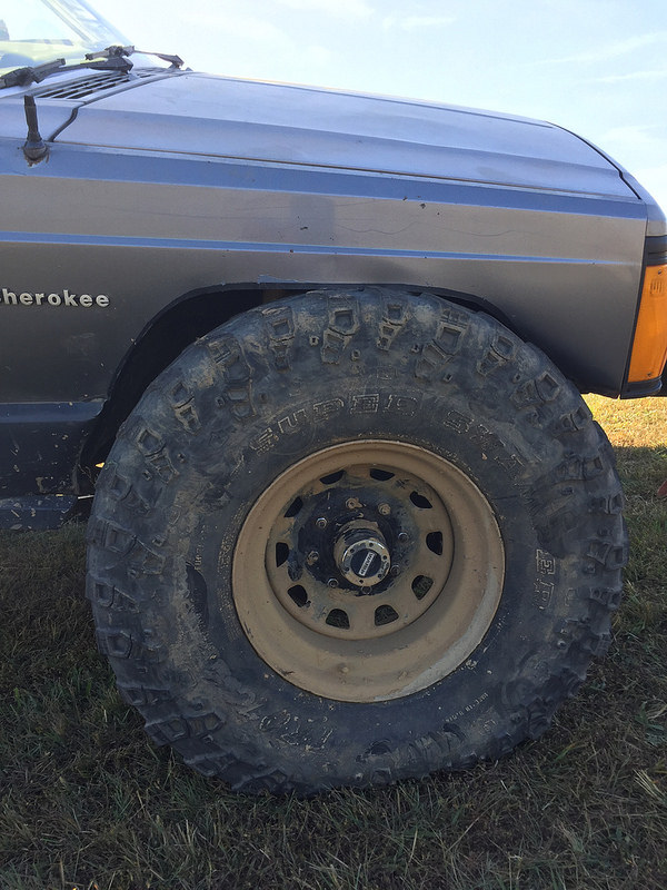

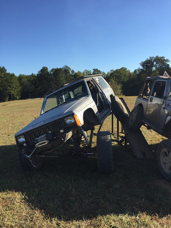

Here's the only pics I have from this weekend. I still have more fender trimming to do. In the last pic I have circled the bend in the antiwrap bar

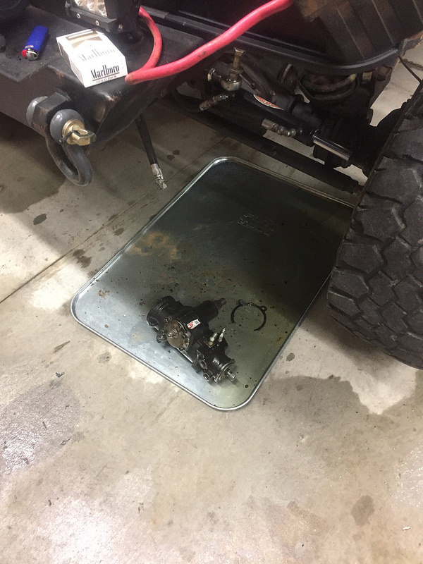

The line I had on the D60 fell through as the guy stopped responding to me. So, I think I'll just run the 44 for the remainder of the season. I've already found an XJ steering box and hope to pick it up this evening. I've also ordered a rebuild kit for the box and a new non-keyed pitman arm. I'm still trying to decide what I want to do with the rest of the steering. I may end up welding up some bracing on the stock chevy knuckle for now.

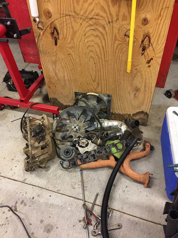

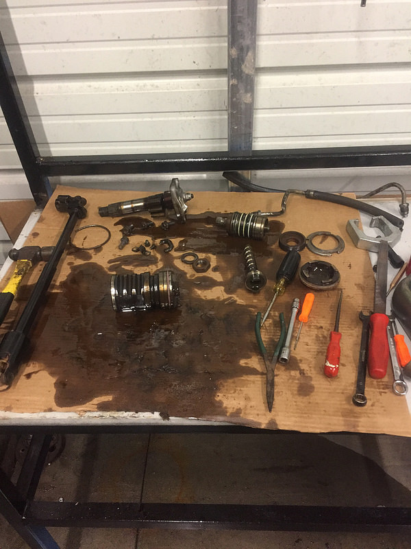

Tear down of the motor for a rear main seal and new header will begin this evening. I hope to start the tear down on the new-to-me steering box tomorrow and have it drilled and tapped by Wednesday night. I'm debating about throwing new seals in the tapped Durango box I currently have and putting it up for sale. On the other hand, it would be nice to have a spare box already tapped just in case.

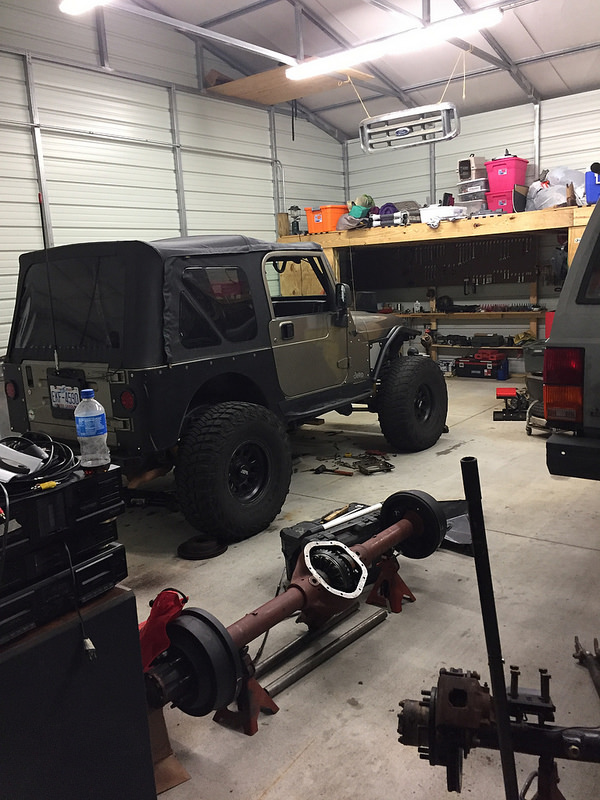

Sure does. This is the first major overhaul on this motor. The header is the factory original and finally cracked back in July. I've had the parts to fix it for months now and just haven't done it. After Jeep Jamboree and the damages incurred there, I figured I'd take the whole rig back down and get everything that needs attention straightened out. I'm hoping to have it all back together before the Veterans ride. Many late nights are ahead of me. You should come down and hang with us again.

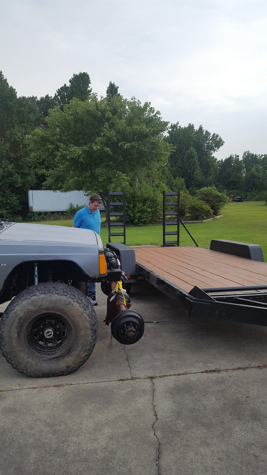

Hard to do with half the front disconnected. My son started the axle swap this summer then life got in the way and we've both been too overwhelmed frustrated to get back at it.

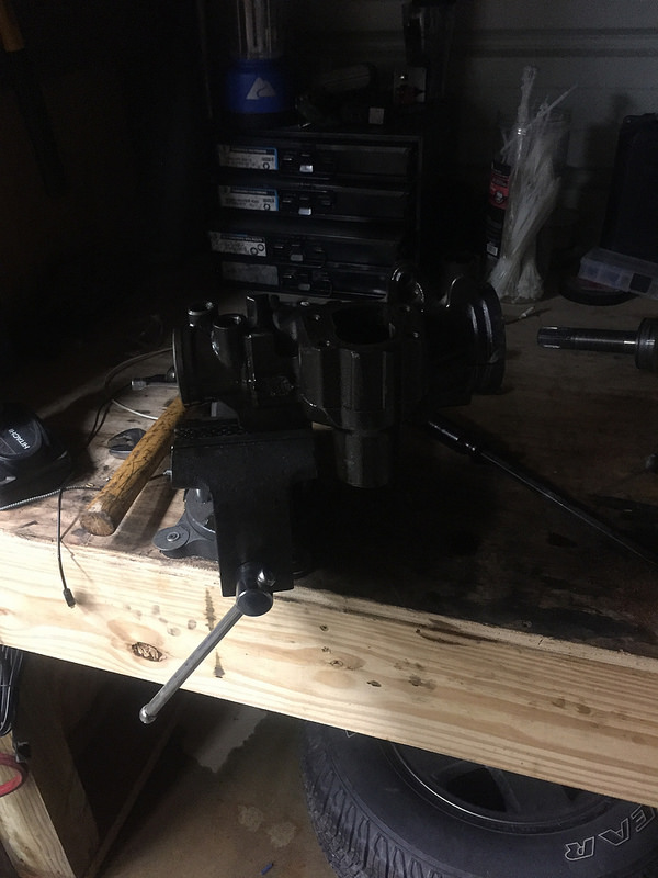

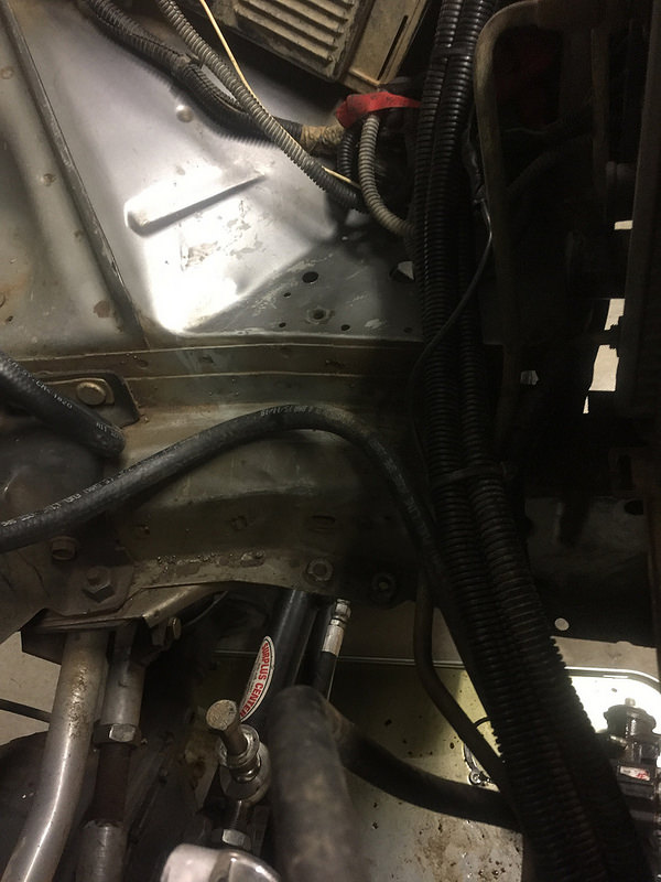

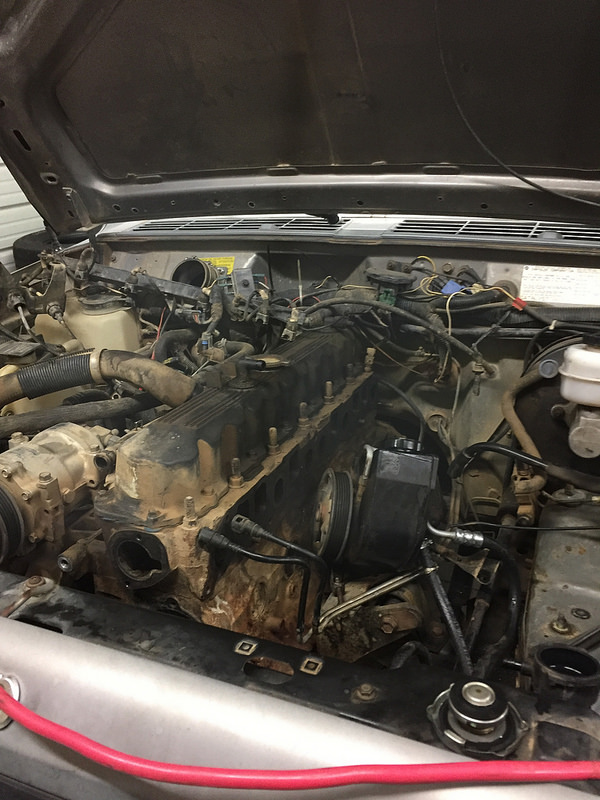

Put in a little more wrench time last night. The Durango box has been removed and I inspected the frame for cracks. It's still nice and clean. I got the new thermostat installed and a couple of the hoses hooked up. I then started disassembling the new to me XJ box so I can drill and tap it for hydro assist. I'll end up rebuilding the Durango box and selling it most likely. I also removed the steering shaft and welded the shaft to the coupler at the the steering column. There's an overmoulded rubber bushing there that likes to dry out and crack. Once that happens, it creates slop in the steering.
No pictures but the new box is assembled and installed. The whole right side of the motor has been reassembled. Below is the to-do list. Hopefully this week I'll get it all finished.

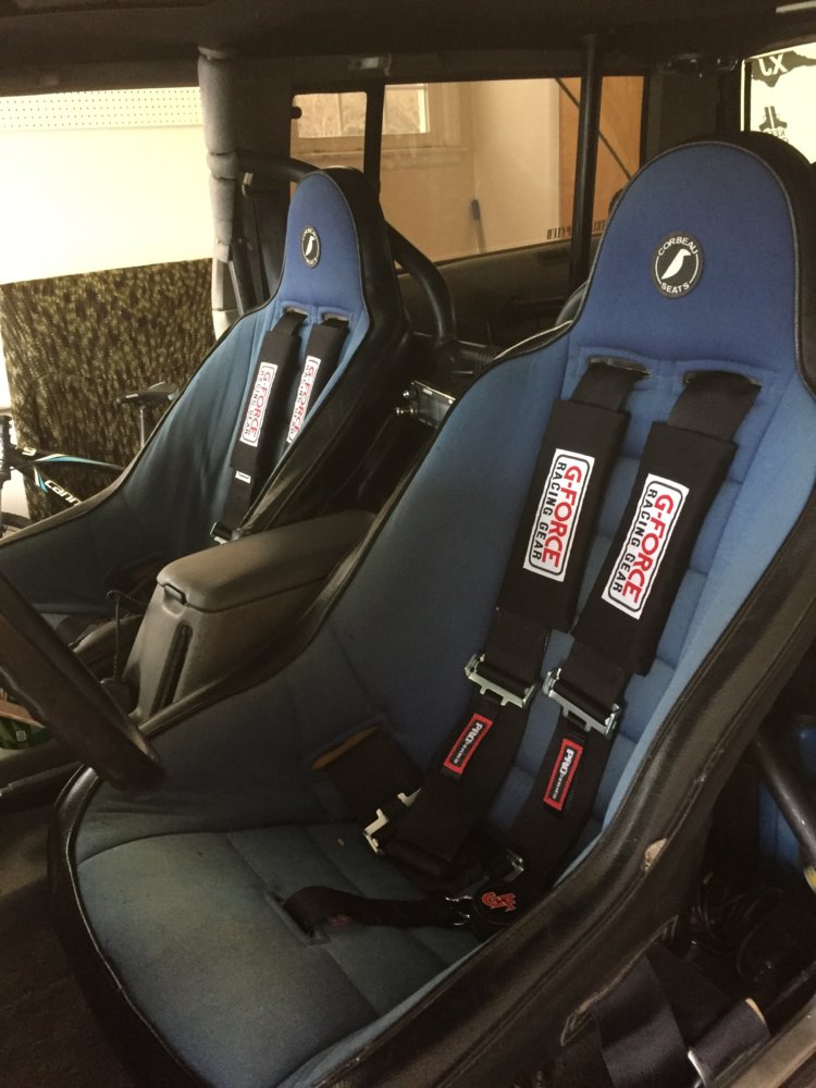

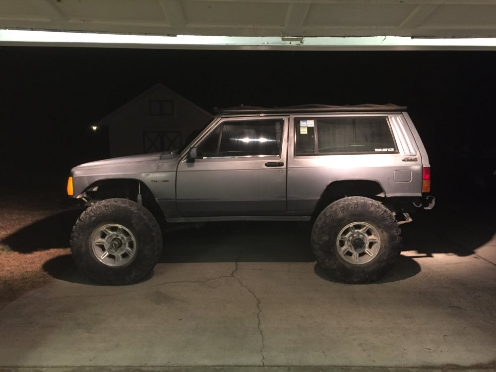

Well I finished the jeep before the Veteran's Ride a few weeks ago. Didn't take any pictures at that ride. I did go back out to Uwharrie Saturday. My fiance drove majority of the day and we took the pups with us. She ran the front side of Daniel for the first time and did great. The dogs really like riding in the jeep and love being out in the forest.
Bought some new (to me) wheels and tires. Got some harnesses. Wheeled Big creek.

Did you ever fix your anti-wrap bar? What do you think caused the failure? I have all the pieces to build mine and was planning on running my upper bar further up on the lower bar and adding some bracing.
I didn’t. Because the upper arm is adjustable, I just adjusted it so everything was happy again. I used 1.75” .120” wall for the bar. I landed pretty hard on it which caused it to bend. It’s still doing it’s job and working great.
