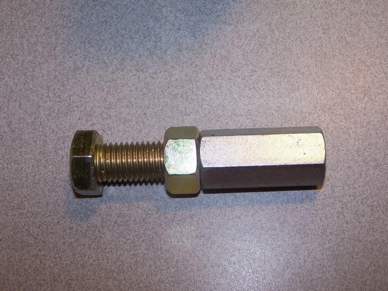

Next up on the list is to build the control arms...we are building them out of DOM tubing. The core of the links will be made out of 1.50x.50 and will be sleeved with 1.75x.25. For the end of the links...on the Unibody side we will use rubber bushings, on the axle side, the Large RE Heim Joints. After looking at the RK kit, I really wanted to make the joints adjustable...so I searched and this is what I came up with.
Now I know you can buy this exact joint already made like this, but we already have the RE Joints...so...a trip to Public Hardware(thanks Lauren:bounce2: ) and this is what I ended up with.
Its a 2" 3/4 bolt with a 3/4 coupler...I'm taking the couplers to
a machine shop so they can smooth the edges off...like this..
After that..Ill drill some holes lengthwise in the coupler that correspond to the holes that will be drilled in the CAs..and then plug weld them and also weld at the top of the nut. What do you guys think? chiefcherokke...I already know your response...:shaking:

just a few thoughts:
Not sure about a welder that builds something and doesn't clean the metal?
I do think I would sleeve the holes and reinforce the frame.

Just curious why run the joints on the axle and the rubber on the frame? Seams as though it would flex better with the rubber against the axle and the joint on the body side. I thought that is how RE and several other set up their Long arms. Going off memory so I may be wrong. Educate me as to your decision please.
^^My reasoning behind this is that, for ride quality I would think that you would want the rubber on the unibody side to absorb vibrations..if the rubber was on the axle, I would think it would wear out quicker...also I am pretty sure this is how RK has their kits, although I may be wrong.
edit: upnover-good idea on sleeving the bolts...already gonna reinforce the frame.
Zack
I was trying to see what the other companies do. RE uses the rubber on the axle side like this, http://www.rubiconexpress.com/Products.aspx?Cn=263&Pn=1982&XnPath=173,180,251,263&Vid=AFBB6D578482
I will look for RK set up. I know BigwheelBob used those kits on my buddies XJ's so he might be able to answer that question for me. I am sure he'll post up. Just remember the rubber bushing is a lot cheaper than the RE joints so if wear is a factor I would rather the rubber wear than the joint. Just my 2 cents. Keep in mind I am just a shadetree mechanic though.
