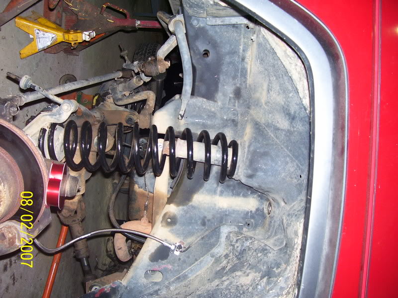

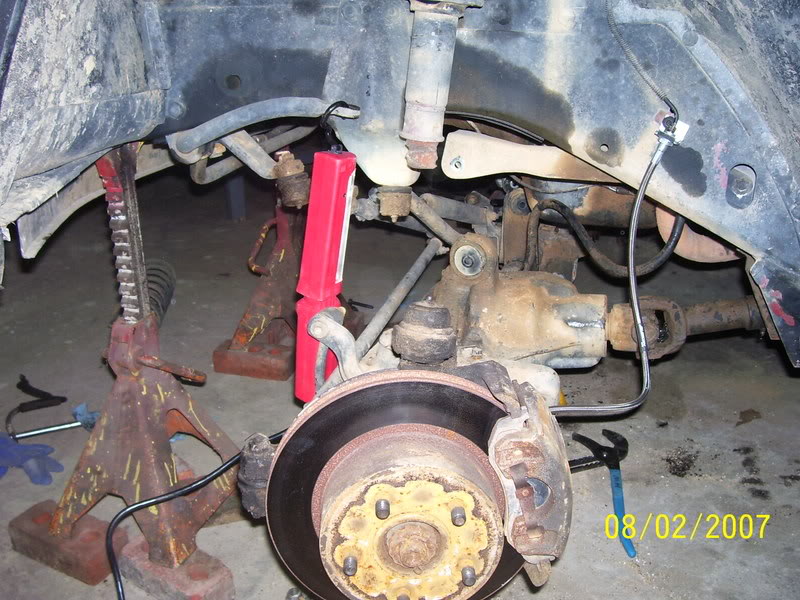

Got the RE brake lines installed

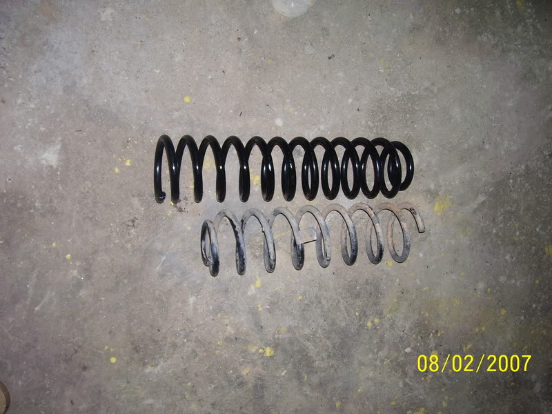

After that, we disconnect all the lowers/uppers and put the 4.5" RE coils in.
Heres a comparison shot of the old vs new

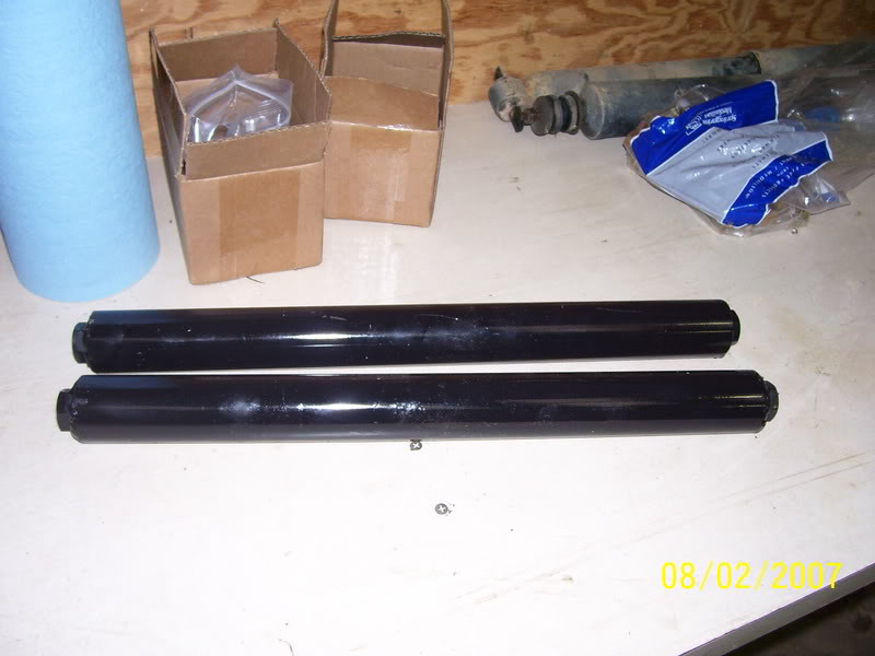

Also got everything painted. Control arms have been made. They are 1.50"x.50" DOM sleeved with 1.75"x.25" Dom

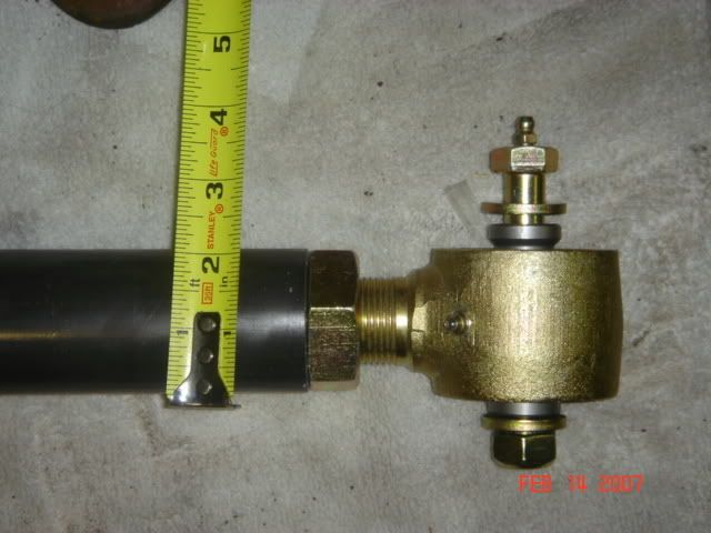

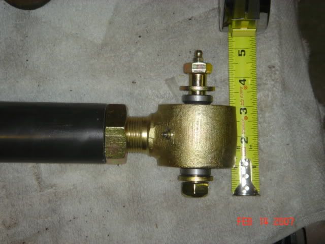

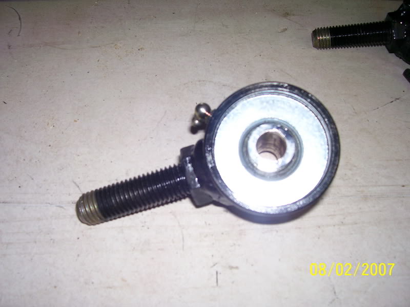

Also got some of the RE joints put together, all i need now is the tool for them and I can finish them up.

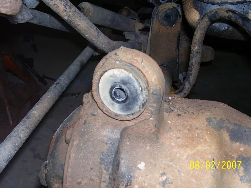

Well, we have hit a small bump in the road. For the one upper, we have the mount made for the unibody side, but i am trying to figure out how to hook it up to the axle side. here is the joint in question.
RK's kit has a U-shaped piece of metal that fits over the bushing and then a bolt gets put through it. However, could I just use that bushing or would I need to get a new one....or would I need to cut that bushing off, grind smooth and weld an RE joint to it? Any ideas?

I would probably use that bushing, and if you're on a very small budget...that's what you should do. Otherwise, just replace it and do what RK/RE/everyone does and use the stock bushing. Welding a link mount to the center section--especially with a single upper--is asking for trouble. Only thing that sucks about using it is the tiny-assed bolt that jeep saw fit to use. Make sure it's g8.
Make a U shape out of Box steel to go around the axle link for the one link on the Drivers side and use the rubber bushing. If your going with a 3 link. Are you going with 3 links like RK or 4 like the others. Those control arms are pretty beefy. I was trying to understand are they .50 wall or .75 wall? 1.50 won't fit inside of 1.75 with .25 wall. That 1.75x.25 wall would make the inside diameter 1.25. Looks pretty good so far. I am using the 2"x.250 wall and sleeving a piece of 1.50x.25 tubing. I will then drill and tap to fit my 1.25" threaded Currie Joints. Keep in mind I am using radius arms like the ford trucks so I only have 2 links. Pics for reference
The threads on that look small... What size are they?
They are 3/4"x2" grade 8 bolt. Family xj, im postive that those are the correct pipe sizes, took a sledgehammer to make them fit. And thats what i was thinking on how to make the bracket. All we need now are shocks, pitman arm is coming as is a RE HD trac bar/bracket.
