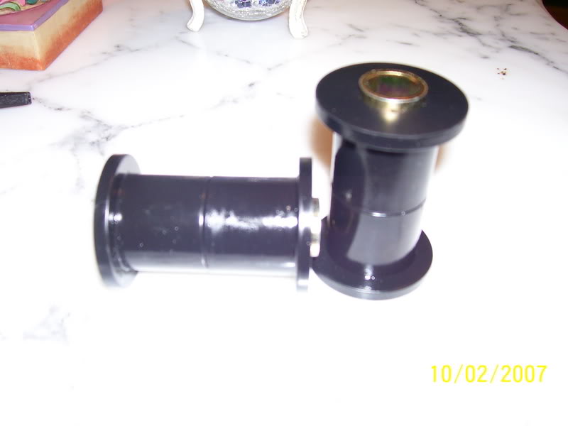

thats just weird. were you able to get the miss alignment spacers to fit in the control arm brackets on the axle? i am assuming you did. but mileshigh tried that first and they wouldnt fit but fit perfectly into the bracket on the frame end. i dont know why RK would put them on the frame end. like i said before every other company that uses rubber bushings puts them on the axle end, with the exception of full traction but theirs look like hard poly urethane almost. i mean my RE long arm rides a lot better than my short arms did and the same with mileshigh's jeep
The RK Monster bushings is hard poly. So I dont know. Were his lower mounts bent? Mine went in w/o any problems but were a tight fit? I am curious about how it rides/ flexes w/ the poly down there.

Hard poly doesn't flex well or absorb much of the road noise. I have them in my LCA's and have broke the sleeve around the bushings from it trying to flex. I was going to put rubber back in but opted to upgrade everything. Can we get picks of both setups?
the setup with the bushing on the axle vs the frame side. My reason originally was so that the rubber bushing would not see as much shock and would "cushion" the frame. But we aren't doing that, just running the RE joints, yeah the bolts do look small in the pics, but to see them in person..they are very beefy, might have some more progess done this weekend.

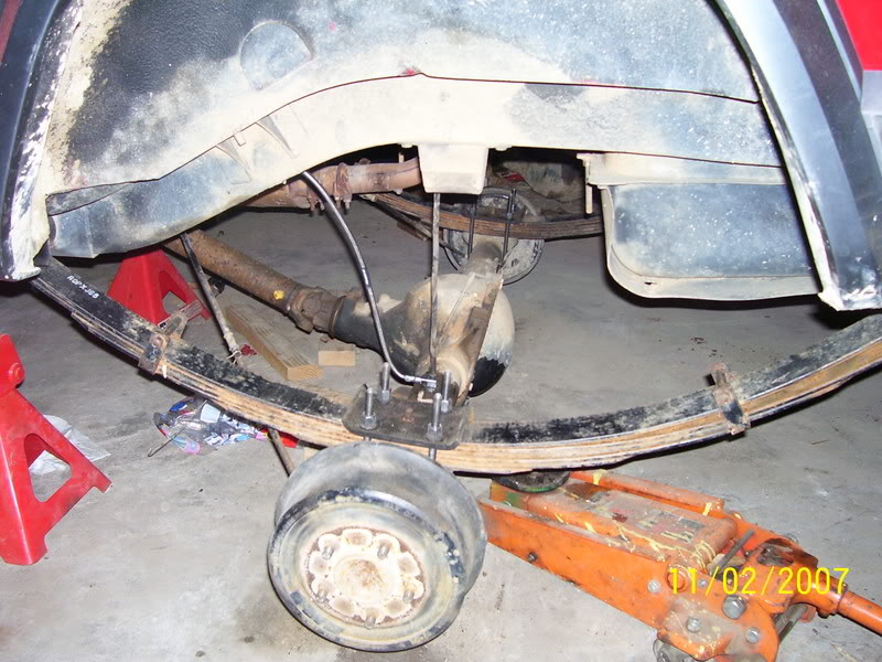

Got some more work done tonight, the rear bushings were a day early getting here, so we went ahead and installed the rear leafs. Pics are coming tomorrow, hopefully by this weekend we can put a major dent in the to do list.
Zack
Man I wish I coulod get started on mine. I have to wait until I get my Mustang done and drivable. Trying to put a motor together and installed along with a bunch of other stuff on it and gather the parts for the Jeep is hard. I think I have everything I need for the Jeep except the ds and some plat steel. Can't wait to see your girls when it is done.

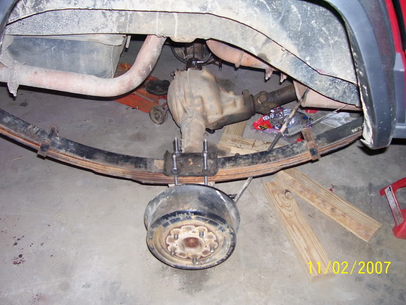

got the rear finished up tonight, all it needs now are shocks and the rear is done. Got the bushings from Rusty's in on Wednesday.
After that, I threw the leafs up under the jeep and got everything tight. Today, we went by Fleetpride and got some new ubolts made. Came back and got the leafs bolted to the axle
Also got the RE extended rear brake line installed. Hopefully tom we can start assembling the LCAs and get those mounted.

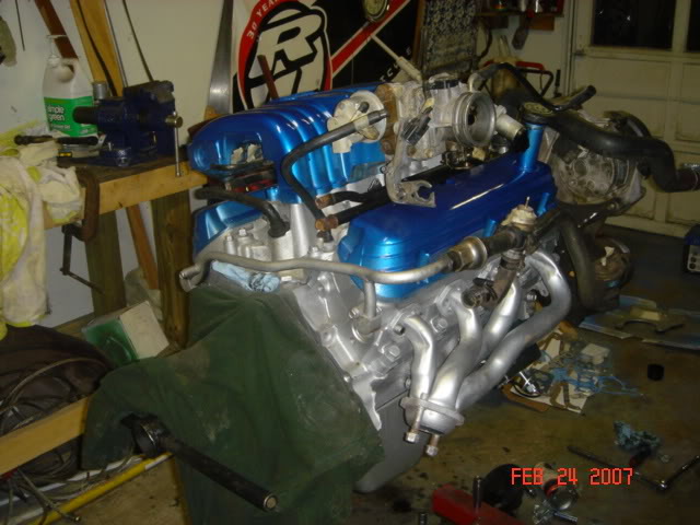

we are getting the last joint this weekend, so we should be putting them back together. Familyxj, that motor looks nasty...heres an idea..put that in the jeep:bounce2: . any numbers on that motor?
